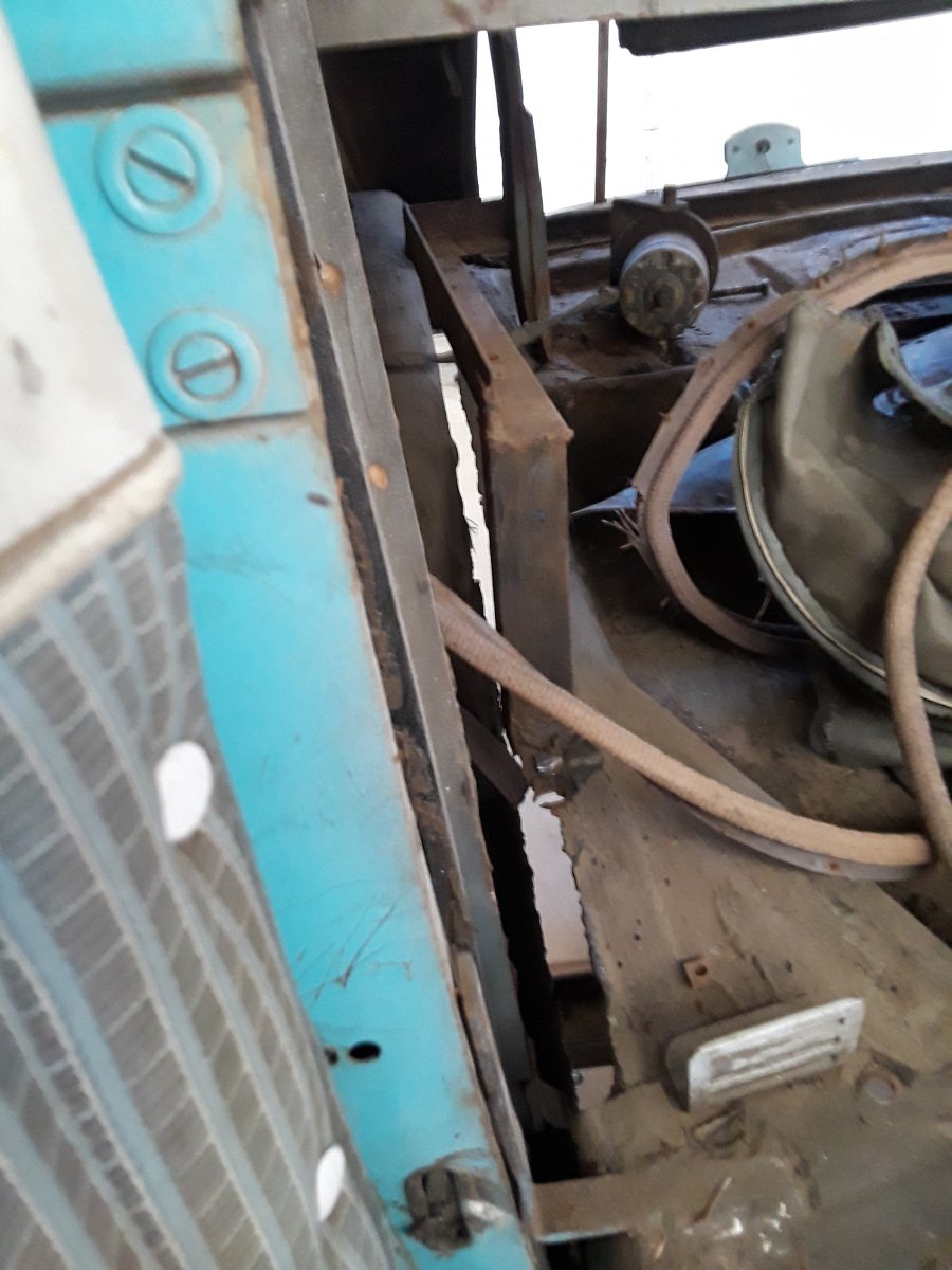

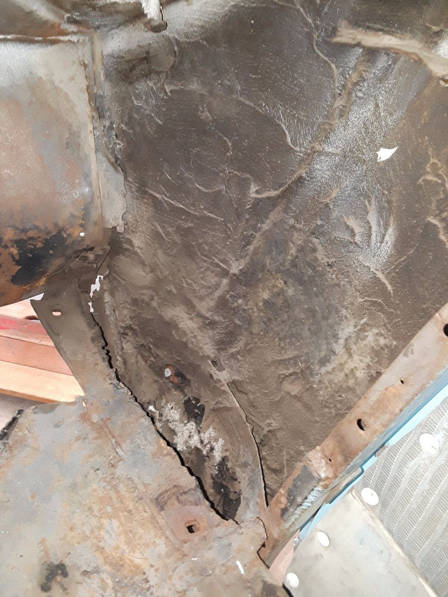

    20190316_133702.jpg 20190316_133702.jpg 20190316_133702.jpg how do I go about fixing this mess? I have a hole on each corner of this car where it was channeled. There is a panel in the middle of the car that goes from the floor pan to the bottom of the body but they left caps on each corner. 20190316_161847.jpg

  2. Do you plan to keep it channeled

    I think you just got good advice; it might be easier to raise back up to original position, trim back floor pan, and the weld in a new horizontal strip from floor pan to body. If you then wanted to drop it you could make a straight cut on the new strip and trim the bottom of the body straight. Then a cut could be made so the vertical channeling plate was close to vertical.

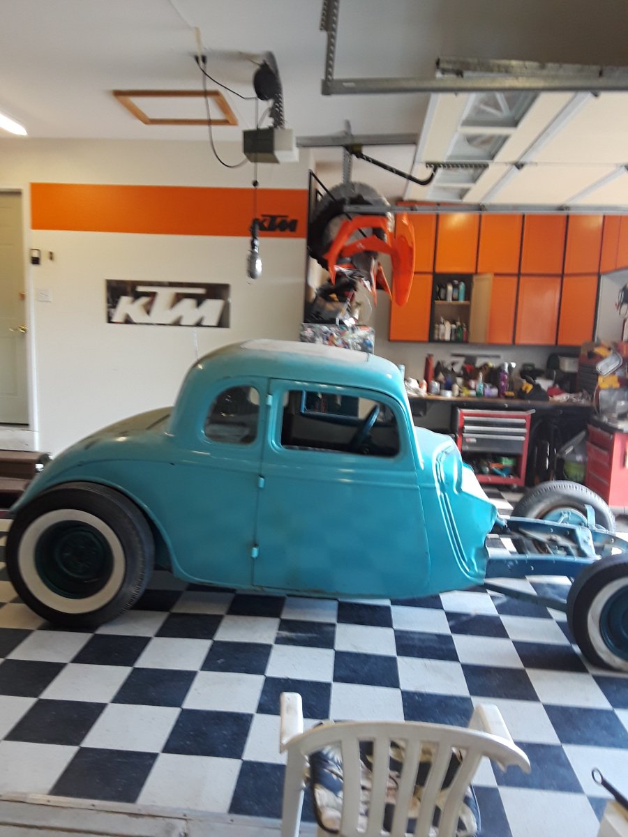

    Give us a wider view so we can see the surrounding area. ;)

    Pickies of the whole car?

    That is one problem, how does the frame look? You can't fix the body with a bad frame. Bob

    have the metal shop bend you some 16 ga. ZEE bends...
    2" along the bottom, x the depth your channel is tall, x 3" across the top...
    cut the horizontals where your frame calls for it... reweld... set the bottom of the body on the 2" flange...
    set the 3" flange onto the frame's top...

    Geez, it's only sheet metal! a brake, a bead roller, and a MIG welder can fix that so easily!

    Look where the fuel pump is located, need to find a better place to put it. Fuel lines don't belong inside a car.

    Gas is that a tar coating?...perhaps some thinners may soften it up for removing it to lessen welding problems.

    Try a heat gun and putty knife to get the undercoat off. I have dealt with for years in the body shop. Solvent makes a mess and you have clean it up and dispose of the rags that you use.

  21. I thought it was an image of the ocean. ALL of that stuff has to come off to expose the sheet metal underneath........take pics..........LOL....before you can repair the holes......
