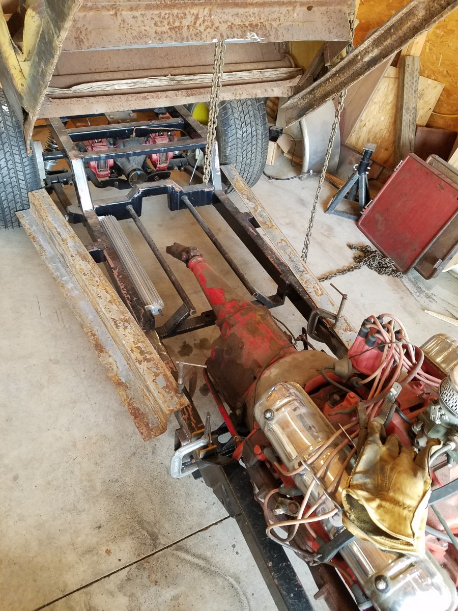

    I had some 3" x 3" x 3" Z bar concrete form left over from a job and used that. It's maybe a little heavier than I need but it was free. Since my frame is the same width front to back, I located the body on the frame, measured for out rigger supports and welded them in. I set the Z-bars in place, tacked them in and dropped the body onto the Z-bars. I still have to scribe the outside line of the body onto the Z-bar and cut off the excess. Done.

  15.
  16. I posted some photos of this instead of drawing. If you can't tell by them it's much the same only There was enough stock sub rails I attached the bottom flange to them with Plug welds. Worked well.

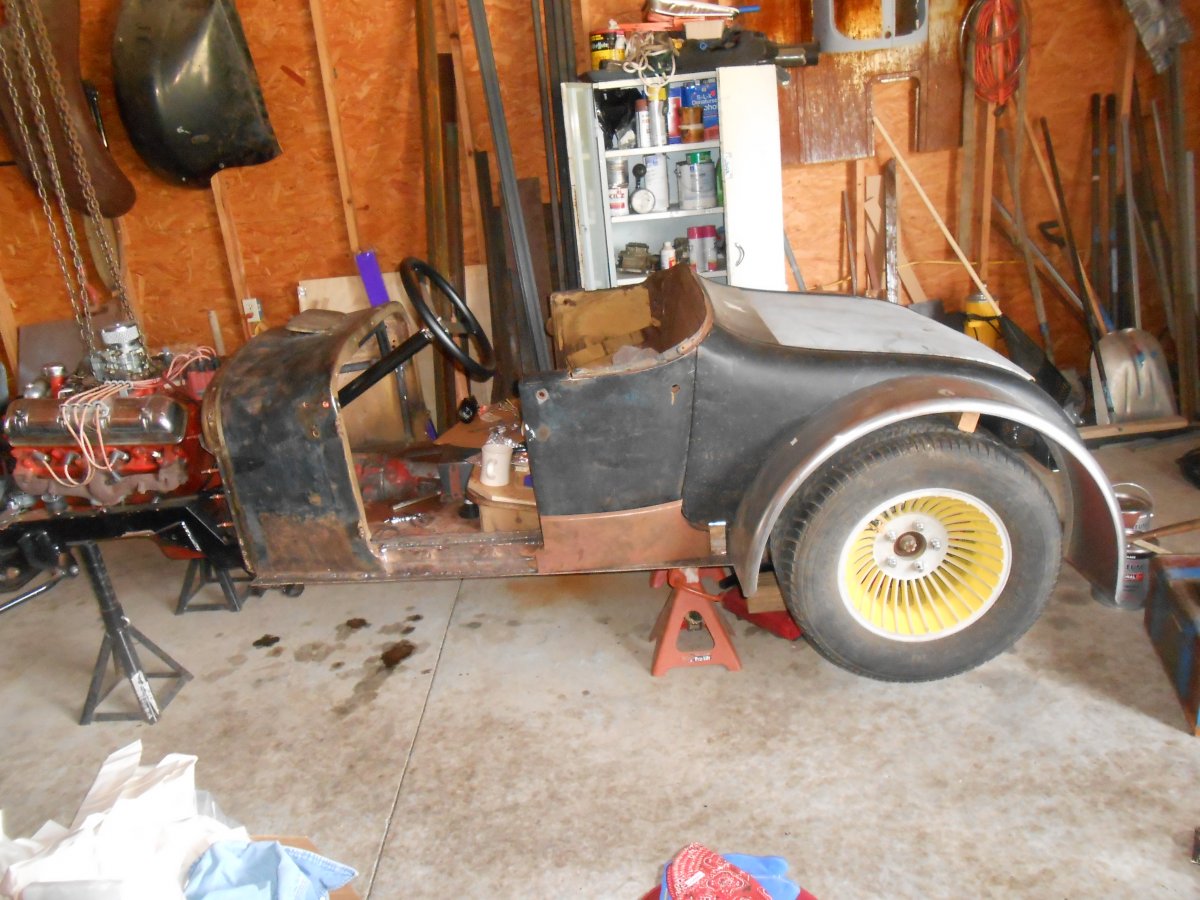

  20. GasGas300
    Joined: Sep 8, 2018
    Posts: 78
    GasGas300
    Thank you all for the great advice and encouragement. I amazed at what a great bunch of people on here.
    I understand that when my dad built this car he did the best he could with the torch and skills he had at the time. It's my turn to finish his work on how he would want it. He was a rancher all his life but always did fabrication work and he got very good at it. And I have his wire feed welder that he bought a few years before he p***ed away. I did get the chance to tell him I found his car but did not have a deal made to buy it before he p***ed.
    I have never done a project of this size but have the mechanical background to do this and a supportive wife that is just as excited about this car as I am...
    And the newfound support from this group!!
    Sloppy. Thanks for the drawing and the ideas. I plan to proceed in this fashon
    Nick. Good idea on the supports. The doors close fine and I want them to stay that way
    Missysdad. I hope to improve on the rake and position of the tires in the rear fenderwell. It should be fairly easy to do this
    Stogy. Yes bias plys and baby moon hub caps for sure. And the hemi is at the machine shop right now getting bored .030 over. I have a great 4 Stromberg manifold just waiting that is very similar to what he had on it. Also, I remember him telling me how he modified the rear wheels for the right setback. The rims have evidence of the rivits being removed and replaced just like he said. I just hope they are fairly true.
    Thank you for all your advice! I will keep you posted.

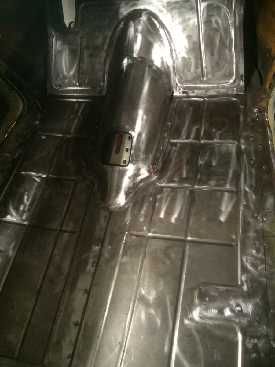

  24. floors are simple
    you can build the perimeter or the step for the channel with a sheetmetal break and some simple shrinker stretcher work. The rest is super easy and no fancy tools required
    all this is from a modified Harbor Freight bead roller and bench shear. The trans tunnel end was some simple hammer work over a acetylene bottle cap welded to my work bench the rest was just clever knee bending work.
    pitman, Stogy, GuyW and 1 other person like this.
  25. Odins parkhard
    Joined: Nov 19, 2018
    Posts: 23
    Odins parkhard
    Dammit man! That's one he'll of a nice floor pan!

  26. Thanks. Built with cheap HF tools and a hammer
