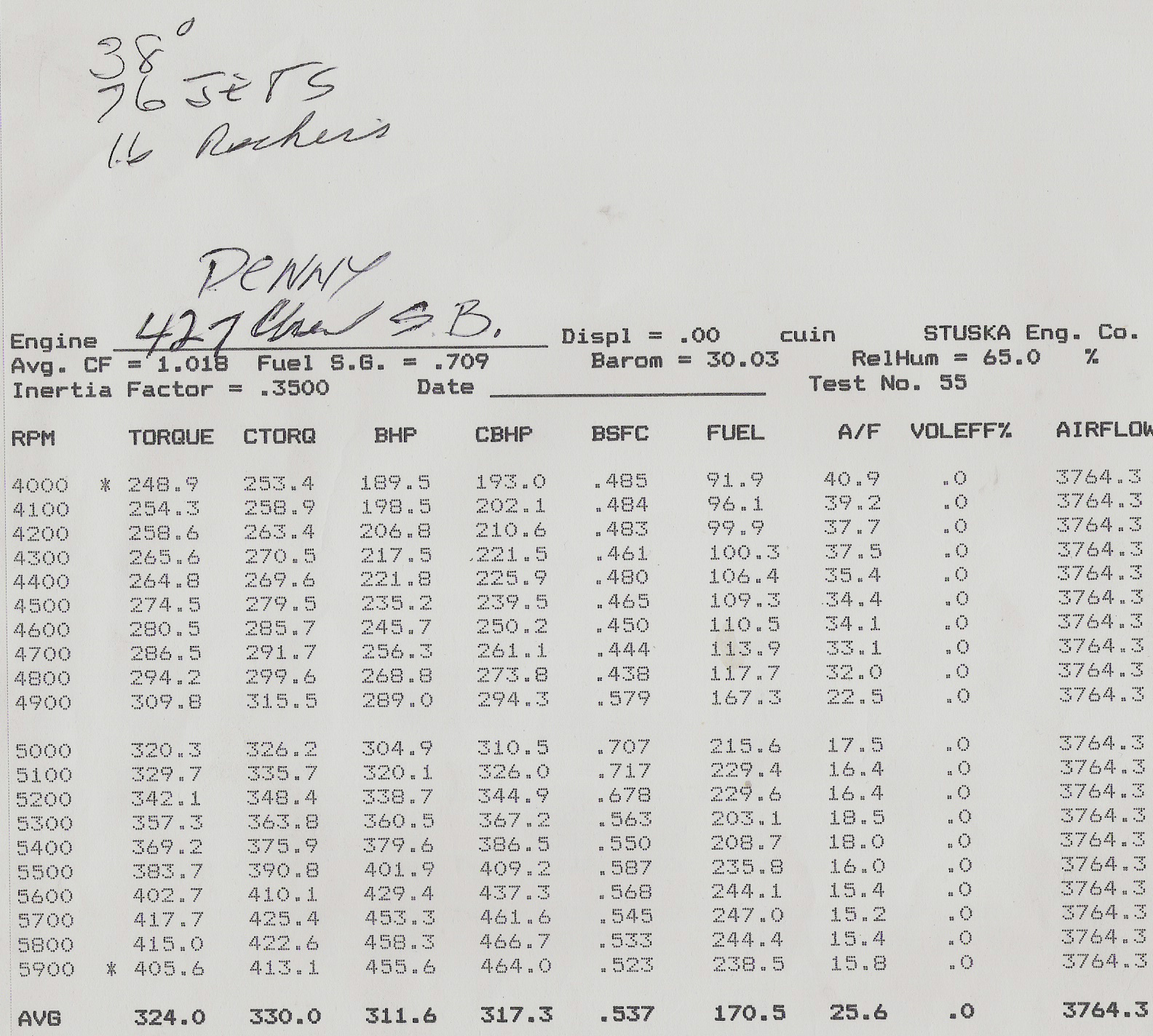

    You beat me to it. A/F ratio not even close.

    Just asking , your 427 should of pretty easily, made more torque & Hp then shown,
    Afr nowhere near correct ... those headers should've been glowing Cherry Red..
    Is this 8:1 - 9:25 compression
    & with a small head cfm, 170-180ish.
    Cam ?
    Carb size ?
    427 sbc like to breathe ,
    Heads 200-220 (23deg) mild
    Compression 10:5 -11:5 pump gas,
    Cam starting .560 up, duration depends on where you want power making ,
    Carb cfm 800 plus
    Denny , I would not trust that print out,
    You might Be disappointed under false information!!!!
    @ the beginning of the pull being
    SSSooooo Lean ,,, I would think popping

    I doubt the 02 sensor was taking a reading in the right place. If it were that engine would be detonating itself to death.

    Where could you put an O2 sensor that would allow readings that far off? For max power I think you want 12.5 - 13.5 AFR. Running super lean is a good way to burn a hole a piston or 8.
