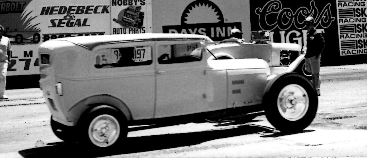

    Here's a little test I did years ago. First run with regular gearing . . .
    . . . and then a little gear change . . .
    Speed was about the same, but a second quicker E.T. (Notice how courteous I am while drag racing -- I've always let the other guy go first. Could be why I switched to Land Speed.) I wouldn't recommend this for everyone. It took a lot of arm power to turn off the strip with all the added caster.
