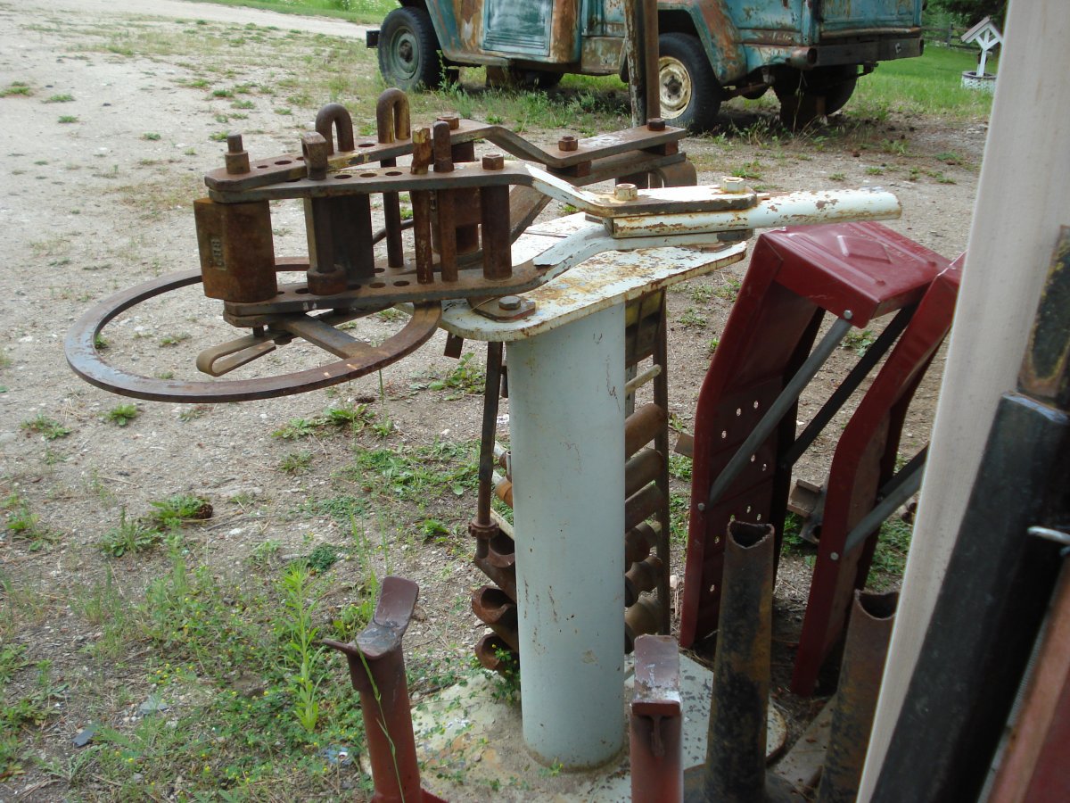

    Bought a bender today . Been looking for many years . I found a few but timing financially was always off. Got a good deal and made a new friend who is a talented builder as well.
    I found plenty of you tube videos on usage.
    Got any tips?

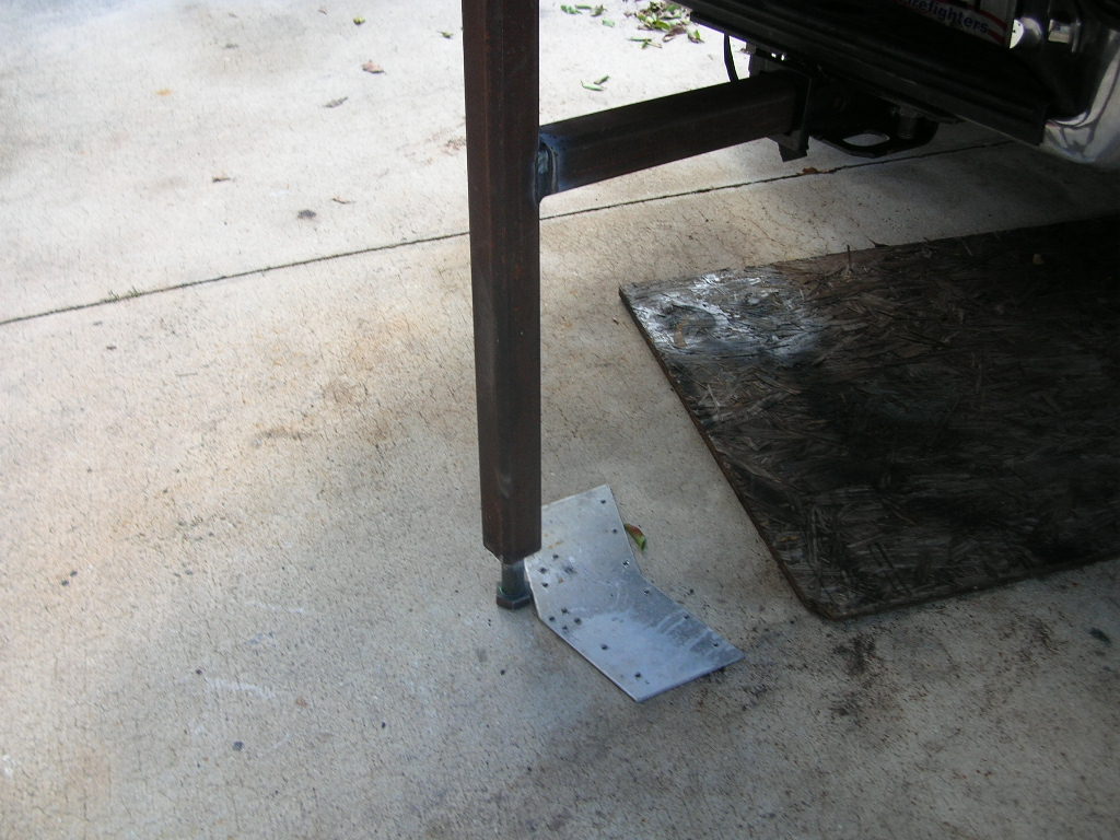

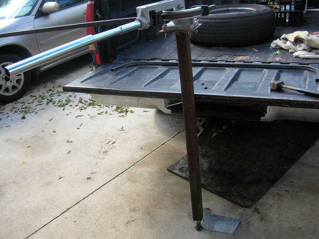

  9. I got this tubing bender and finally DSCN9467.JPG DSCN9468.JPG DSCN9469.JPG have a project where I needed to make square tubing bends. I made a mount that fit in my receiver hitch and use the tailgate as my workbench
    vtx1800 and kidcampbell71 like this.

    Thats a nice one rick . Square tube that size is useful.

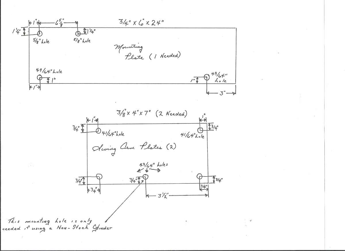

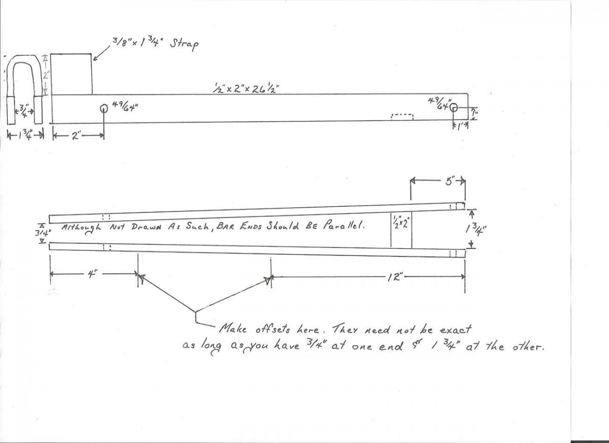

    Anyone with a hossfeld hydraulic ? I could use some measurments for a future upgrade.

    I know from the vids on youtube that the big plate the cylinder mounts to is 6 x ?? x 3/4"
    I got a pm from a fellow who can get measurments monday.
    If you have specific questions ask away and I'll relay them.
    So far all i need is the stroke of the cylinder and the rest i can extrapolate from pics.

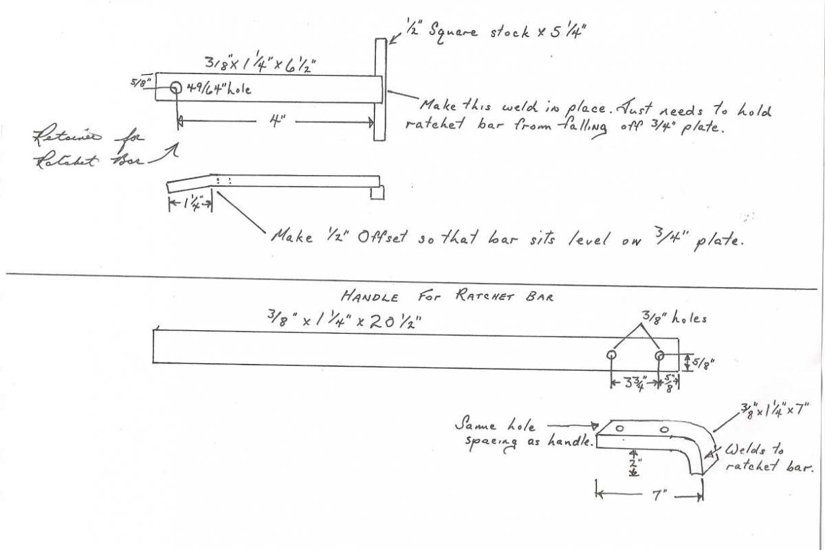

  15. bct
    Joined: Apr 4, 2005
    Posts: 3,198

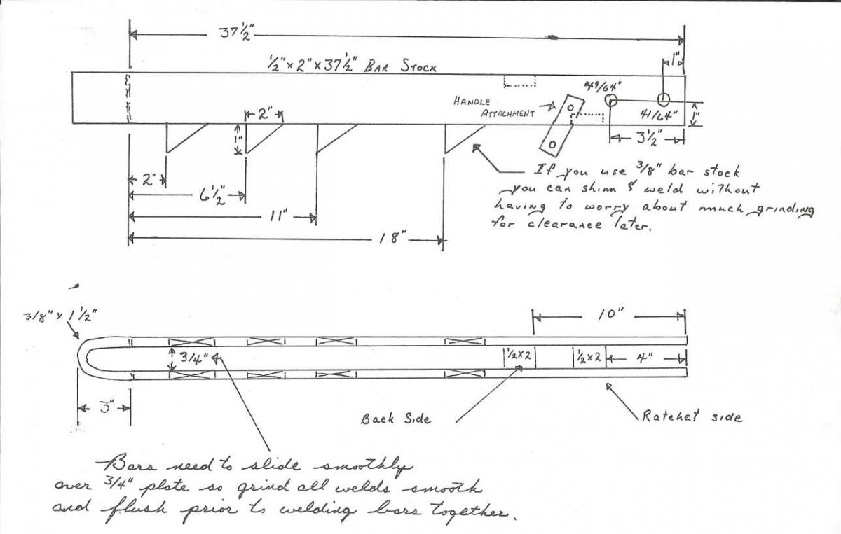

    bct
  16. bct
    Joined: Apr 4, 2005
    Posts: 3,198
    bct
  17. bct
    Joined: Apr 4, 2005
    Posts: 3,198
    bct
    No . I might get some info on that today. If not i may just build it then measure retracted length.

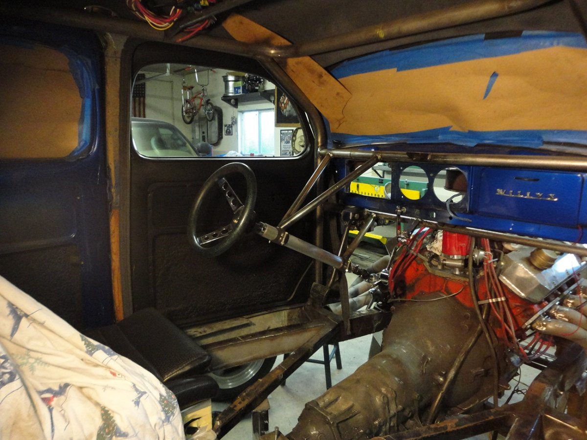

    Get yourself the factory manual, it helps. Hossfeld still makes these machines, check ebay for dies, or try Hallidie Machine in Auburn WA. My pedestal is similar to yours but I made mine so it will lock or spin while I am bending with the hydraulics , pretty handy when your bending up a main hoop or other long piece, it can make your shop seem pretty tight! I made full size flat templates of all my tubing bends, tubing O.D. and centerline radius, really helps when laying stuff out. An adjustable third arm/Christmas tree stand thingy will help too, Momma or the kid aren't always willing participants in my bending endeavors! My latest 39 Willys sedan, I typically build a halo style cage, like the access for the A pillar down tube weld.

    Thanks for the replies. I set up the bulldozer bender and did some 90° bends for no real reason. Found a decent spot and will be mounting to floor soon.
    Got some info on the cylinder
    " 1" rod, 2 1/4 body and 17" stroke."
