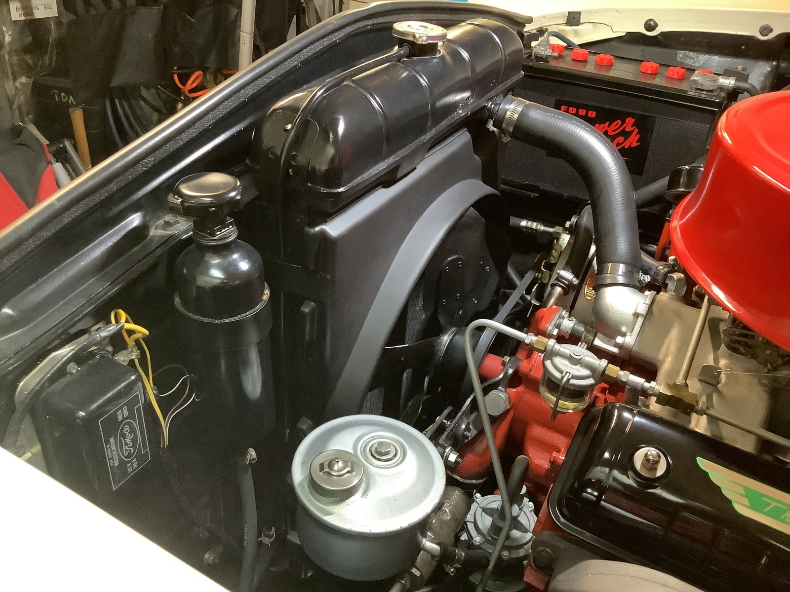

  17. jimmy six
    Joined: Mar 21, 2006
    Posts: 16,687
    jimmy six
    When I purchased a new U.S. Radiator 9 years ago I asked to the trans cooler in the lower tank even though I had an air cooled Ford-O… when I changed transmission to a 62 Cruise-O it was ready. I also use a plastic fan shroud from Southwest Thunderbirds and a 6 blade fan. The smaller Mustang 289 water pump pulley made the biggest change. No overheating at 90* plus with the AC on. From when these cars were new the only real change is the formula for gasoline…. I blame it for most of our problems but with the proper fix, band aid to some, our Fords will perform perfectly. My temp is never over 180.
    In the photo you can see the stock upper hood seal, fan shroud, 6 blade fan, coolant recovery bottle, and smaller water pump pulley. IMG_0212.jpeg

    AldeanFan likes this.

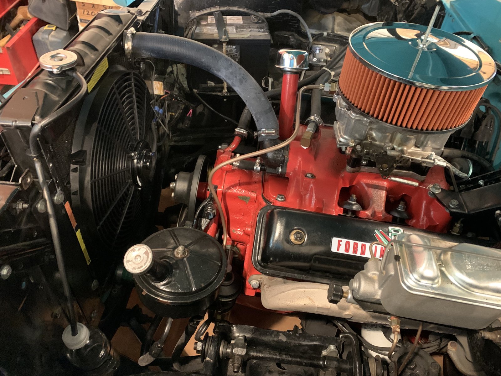

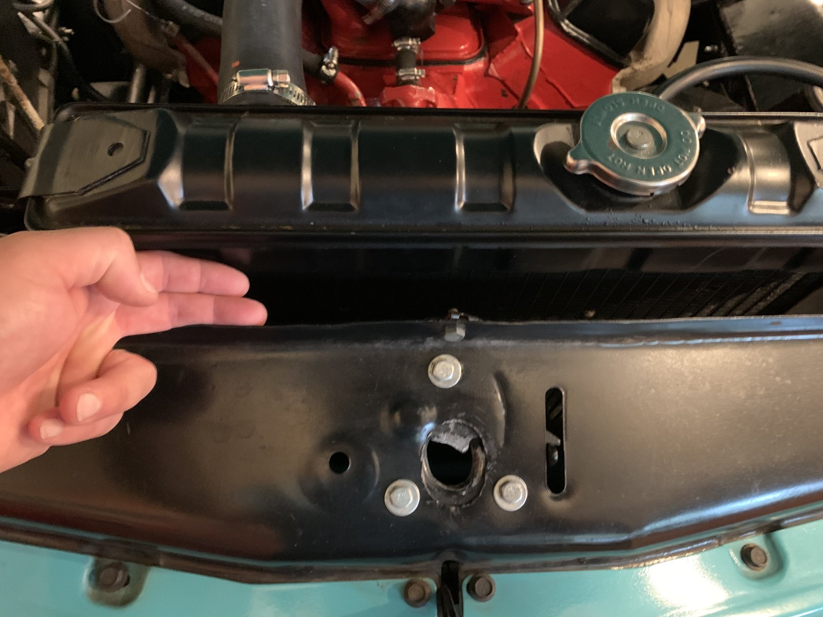

  24. AldeanFan
    Joined: Dec 12, 2014
    Posts: 1,128
    AldeanFan
    Here are some pics. I think I’ve got all the sheet metal installed.
    The car runs at 180-190° at any speed 50mph and below. It only gets hot at 60mph and above. I can drive on country roads all day long and idle till I run out of gas and won’t get about 190°.

    The core of that radiator is really small it only looks like a couple inches on either side but that's a lot fewer cubic inches of cooling area.

    That radiator looks really small for a V8 motor.
    The air gap between the sheet metal piece at the hood latch and the front and sides of the radiator is allowing a huge amount of air to bypass the radiator, and that bypass air could be what is raising up the back of the hood. The car was originally designed to flow the amount of air that could pass through the radiator to exit from under the hood, if you have a lot of extra air that does not pass through the radiator entering that air space, it could reduce how much air cab pass through the radiator because it can overwhelm the exit flow.
    Generally any space around the front, sides, above, or below the radiator of 1/4" or more is increasing how much air will go around the radiator rather then pass through the radiator. The air hitting the front of your car rolling down the highway at 60, will take the easiest path around your car. Going around the radiator is much easier then going through the radiator. The goal is to get all the air that enters the grille area to pass through the radiator, that means blocking off as much area that can allow the air to go around the radiator is much better.

    Sounds like the consensus is that I need the proper rad. I was planning to do that anyway.
    once I Get the new radiator installed I’ll bend up some sheet metal to block off the air that is passing over the rad.
    I do t think there is a problem with the tuneup, the car runs great and the plugs look about perfect after a long run.
