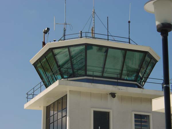

    The reflective phenomenon that you're experiencing is exactly why the windows in air traffic control towers are SLANTED, to preclude reflections as would be experienced by the humans inside. Probably something you'll have to live with in an A-bone. Opening the windshield slightly should help. DD
