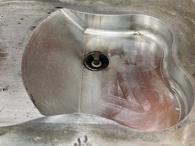

    I has a idea for a new head in billet aluminium from the concept of 'thermo flow'.
    I found out how the Jr dragster engines used for chamber deesign, and they used a flat top piston at deck and gasket clearance piston to head at 0.060" and CR was 7.5;1.
    It might be other ideas for a FH, but se picture of the Jr version.
    Engine concept ;
    Bore 3.25"
    Stroke 4.125”
    Custom 7" H-beam rods with 2” bearings
    Custom flat top pistons at a C-H at 1.385"
    Steel ring 1 mm top, 1 mm second cast napier and a 3 mm oilring.
    Deckheight at ca 10.45"
    Piston to deck = 0
    Cometics gaskets at 0.045” compressed thickness = ca 13 CC
    Ruff calculated chamber CC = ca 75
    Valve pockets 0.45”
    Cast mech cam at 0.40" in lift.
    That gives a CR at aropund 7.5;1
    The idea is to mill out a head with chambers and sparkplug holes and boltholes in a billet high quality aluminium plate ( based on cool effect around the exhaust valve )
    Then a plate above that to hold the water and copy the ORD design ( se picture ) and inlet as on the 59A.
    ( I has a neighbour that has a HAAS 5 axle machine )
    -What do you guys think of this idea ?
