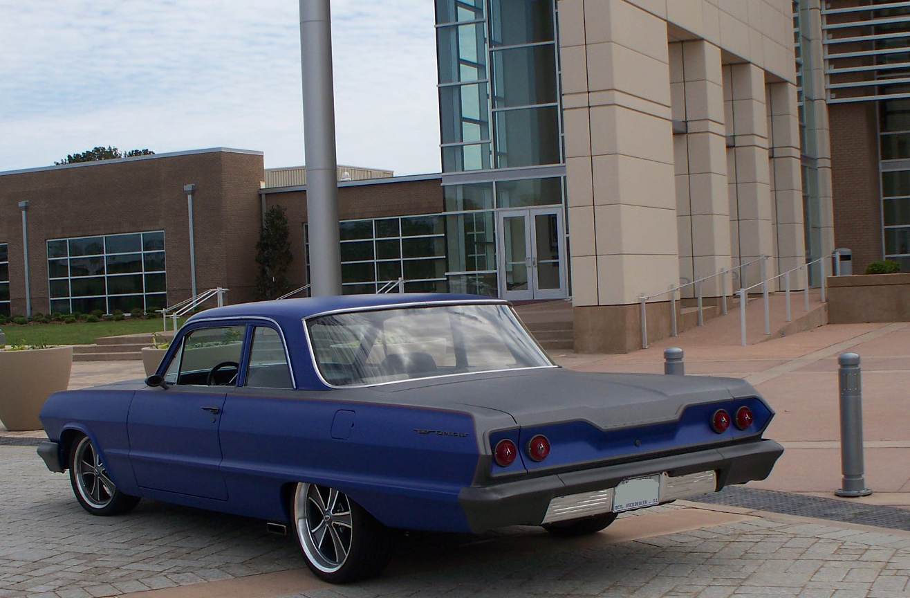

    Here's a Hot Rod Flatz Daytona Blue with Gunsmoke Metallic
  7. WoW What A Great Color Combination
    And ON A Frist Post
    Great Looking Car

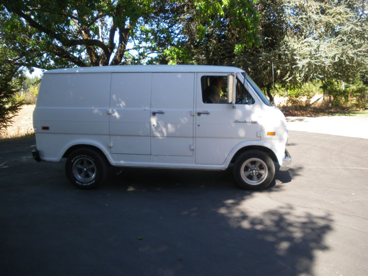

  12. I am going to order paint. Will a HRF "gallon kit" be enough to cover the exterior of this van? Not looking to paint any jambs or inner doors and NOT looking to run out of material during the job.

    I think it will. We painted my 55 pickup 3 coats including inside the bed and had some left over. HRF calls for 2 coats we just had so much figured 1 more coat would be good-we had plenty of coverage at 2.

    Thats still a lot of realestate to paint. Short van or not, that roof is plenty of area to shoot. If you're questionable on the coverage you may what to get an extra quart. Shooting a sealer that is close to the final color can also help if you have to keep it to only two coats. If you're going to spend the time to paint it why not spend a little extra time to shoot the jambs?

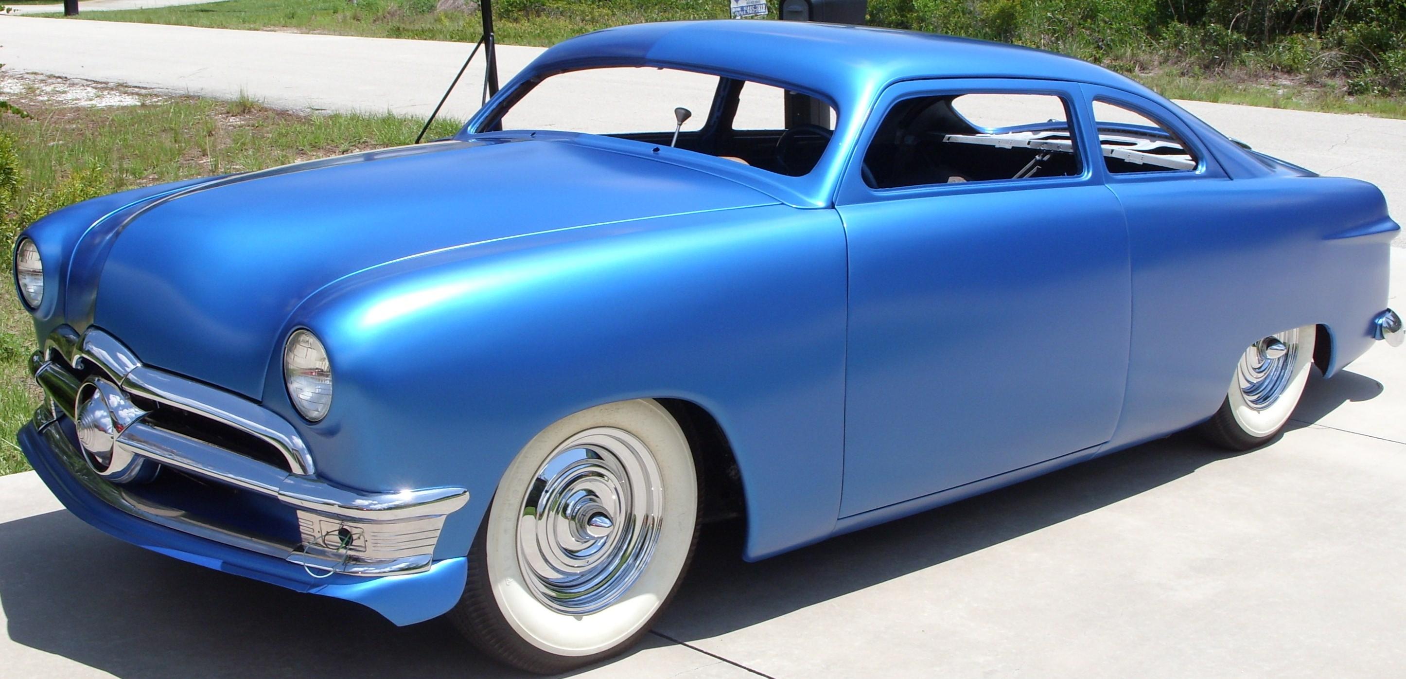

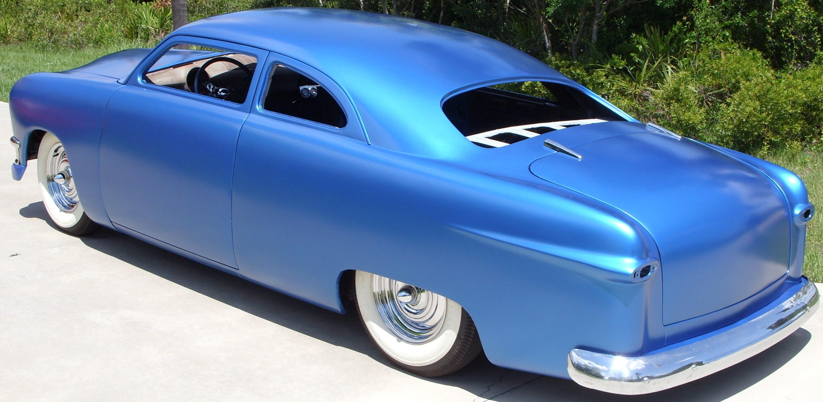

    My 50 with flattened clear.

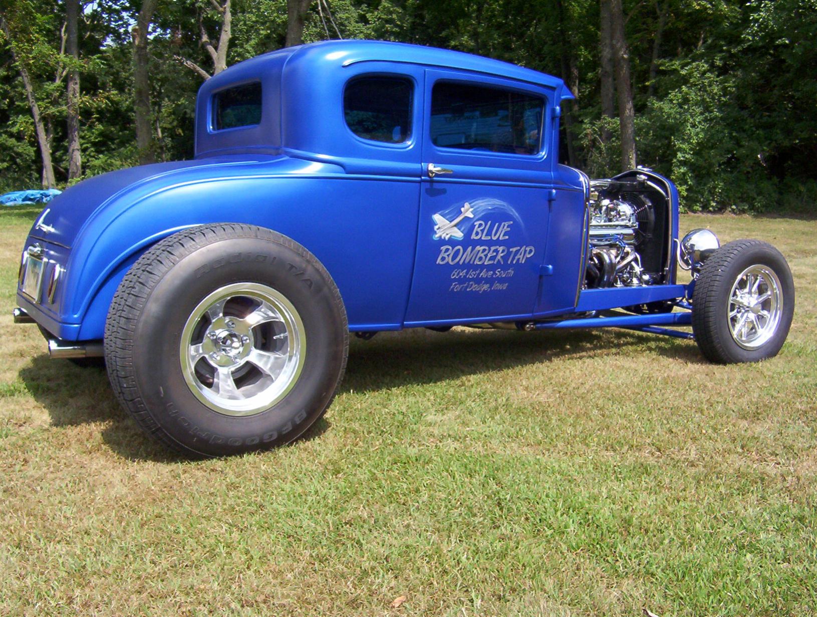

    have used hotrod flatz on several cars and have great results. very durable-cleans very easy with mist and shine. has nice sheen not at all chalky. sure beat primer. for the cost i am very pleased but it is kinda trickey to paint. my coupe has daytona blue metallic pearl
