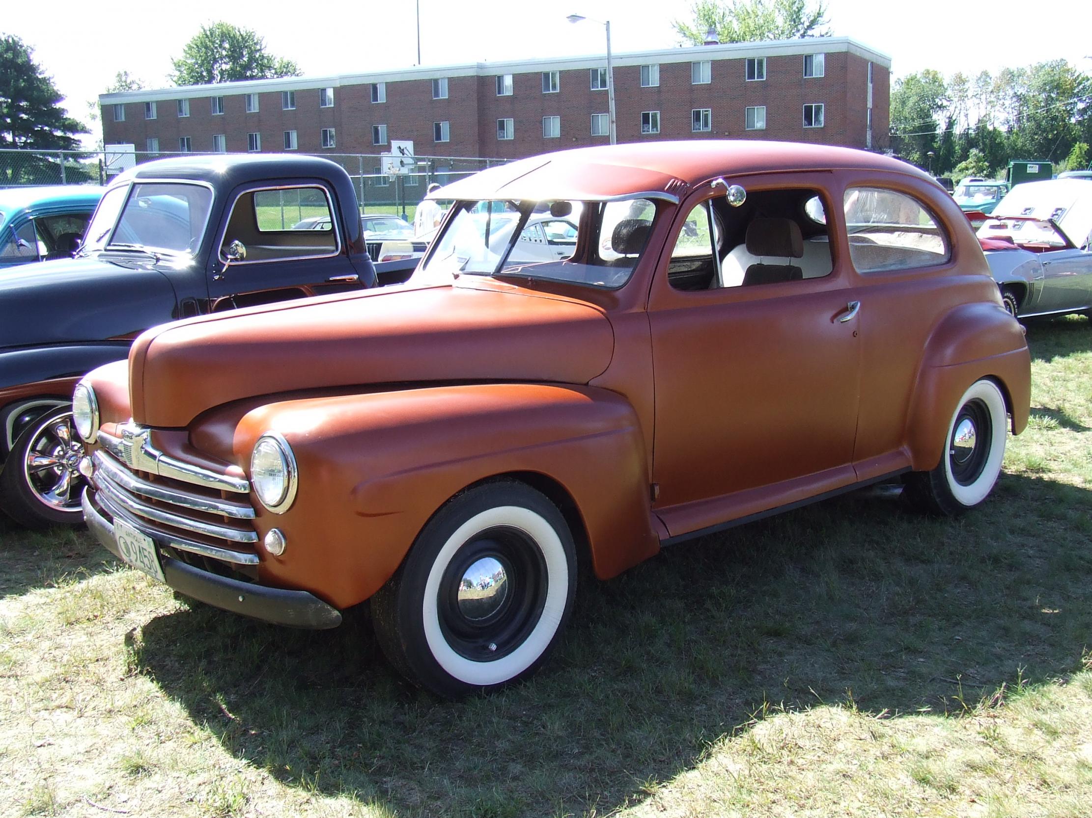

    Old thread, BUT has anyone sprayed or seen a ride with HRF rust color, or some type of flat brown?? PICTURES PLEASE

    LAROKE
    You mean like the color of a disturbed dog turd.
