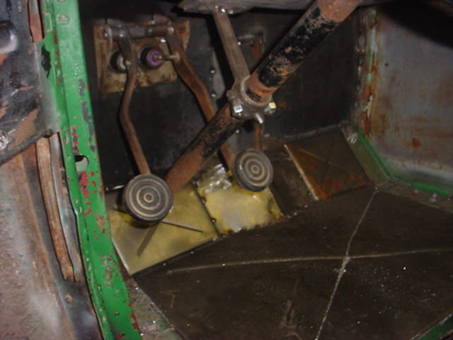

    This was in the T that I owned for a short time. Built by metalshapes. I really loved the floor in this coupe.

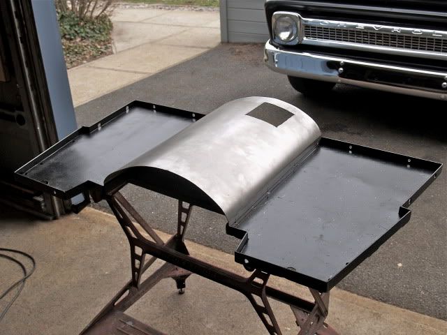

    the start of mine

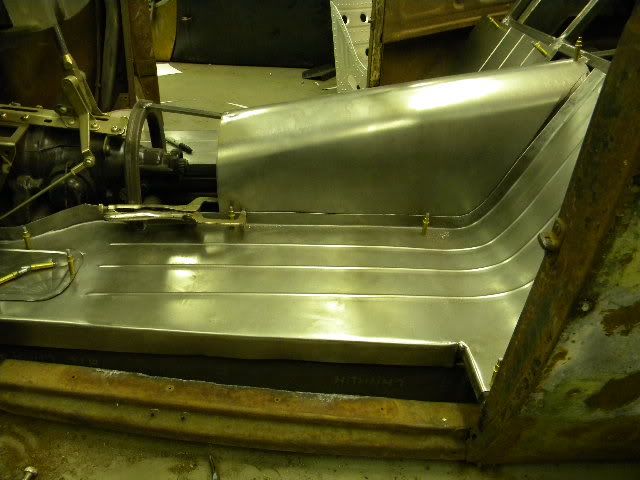

    Model A tudor floor.
    I stamped the washer into the floor with my pullmax and attached the floor and tunnel with stainless oval screws(you can do this with a rivit gun and a homemade die).
    The beads were pre stretched with the e wheel and beaded in the pullmax.
