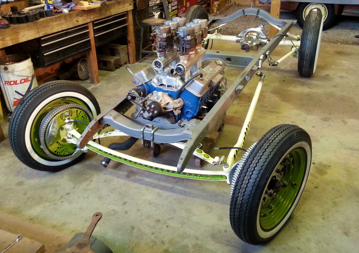

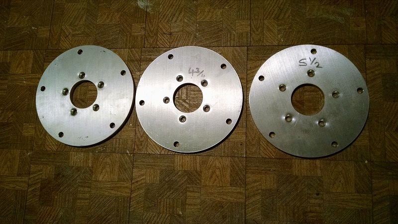

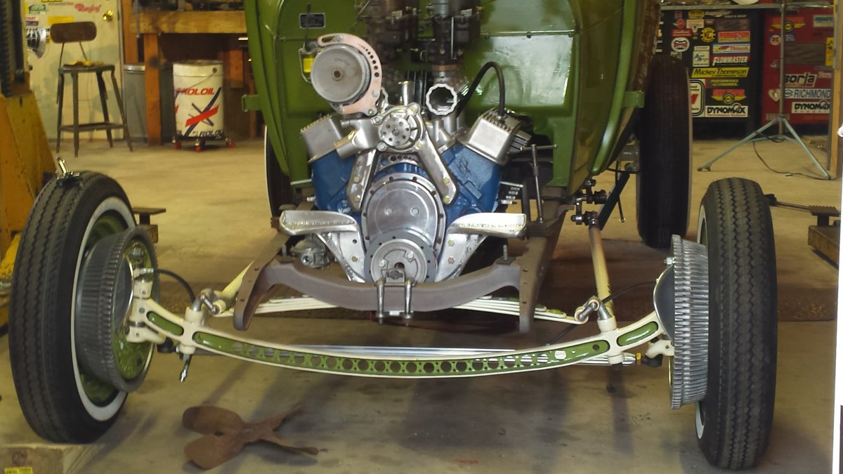

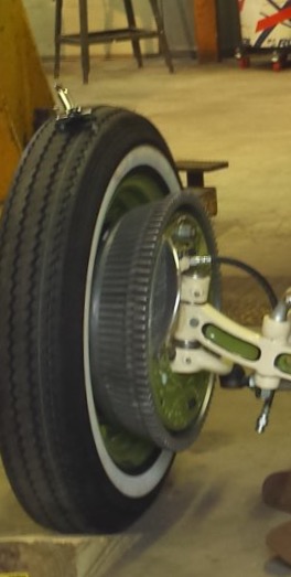

  8. '52 F-3
    Joined: Sep 30, 2007
    Posts: 961
    '52 F-3
    from Central PA

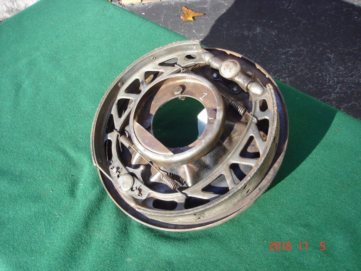

    id like a wide 5 adaptor that adds some backspacing somehow.
    when flat adaptor is used on normal hubs it pushes tire out too far. and cause the kingpin pivot axis to not be in the tire contact patch, causes harder turning tire scrub when sitting still/slow driving etc....
  9. There's no way to make up all the change on an adapter.
    First you have a flat backing plate.
    The wide 5 wheels worked with a very deep recess backing plate.
    You can see the shoes are far behind the spindle mounting surface.
    Net change is about 3 inches per side
    Then the brake drum it self was less than half the thickness of that Buick drum.
    Net change is almost 2" per side.
    That's 5" per side or close to 10 " increased track width total.
    To get an idea - Get an old wide five wheel and knock the center out.
    Place the wheel where you get the contact patch and scrub radius where you want it. Bolt the center on and calculate what's needed to join them back up. It will look like an offset that resembles a front wheel in a dually pick up

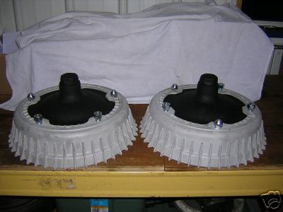

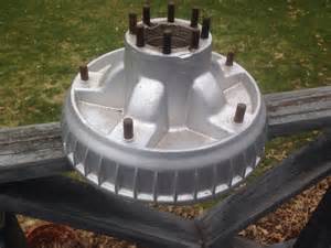

  10. 55willys
    Joined: Dec 7, 2012
    Posts: 1,715
    55willys
    The wide five front hubs should be used and the center of the Buick drums will be cut out after it is centered and the 10-1/4" bolt pattern is drilled in them. Also you will probably need to get the Lincoln style backing plates to get the brake in the right position. There is no other right way to get there from here with the setup you have.
    I am also working on a wide five disc brake conversion that uses a stock hub and eventually want to cast my own wide five front hubs that will take rotors directly. I would like to see someone cast Buick drums that have the liner centered.

    Interesting shoes, who made them?
  13. '52 F-3
    Posts: 961
    '52 F-3
    from Central PA
    a backing plate like that could help with a correct hub/drum setup for sure. maybe something like this, but using a front hub?
    upload_2017-1-1_15-6-42.png taken from this thread http://www.jalopyjournal.com/forum/threads/finned-buick-drums-wide-five-hubs.148359/
    or this
    I know nothing is going to make it all up, but an inch here or there would help..
    i'm using petty narrow I beam and some unique "posie" springs to keep my overall width under control. it's still and inch or 2 wider than the rear.
  14. 55willys
    Joined: Dec 7, 2012
    Posts: 1,715
    55willys
    That first picture is a front hub and for racing they would mount a rear 3/4 ton spindle to the front and use the rear hub and drum on the front.
