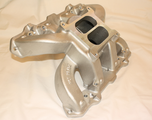

    The Dodge Power Giant 354 engines could also use that intake, they use the 331 style heads and they all had a 2bbl. Using the original to make a casting mold should shave a lot of design time off of it, vs designing something from scratch.

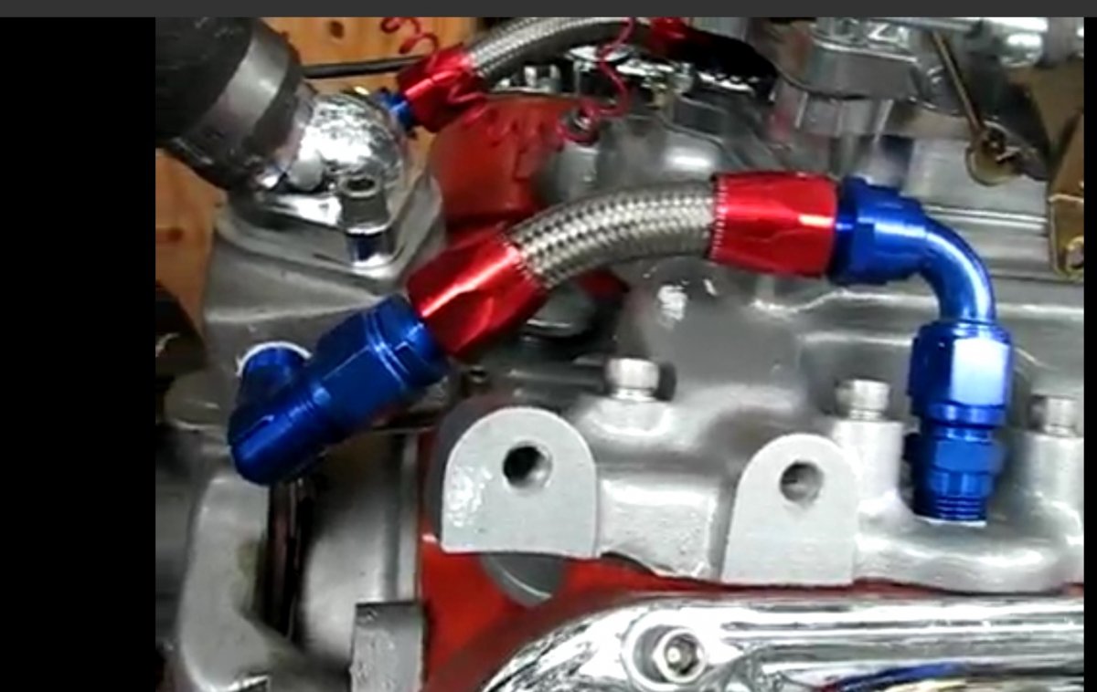

    Hey there 31Vicky with a hemi, I see you are in Cleveland Ohio. There is a lot more manufacturing industry there than where I am. Do you have any connections to get some of these things done?
  6. I've been out of it so long - it's still possible I guess.
    There's a lot of stuff and shops closed up and gone too so it ain't like it was 10 years ago

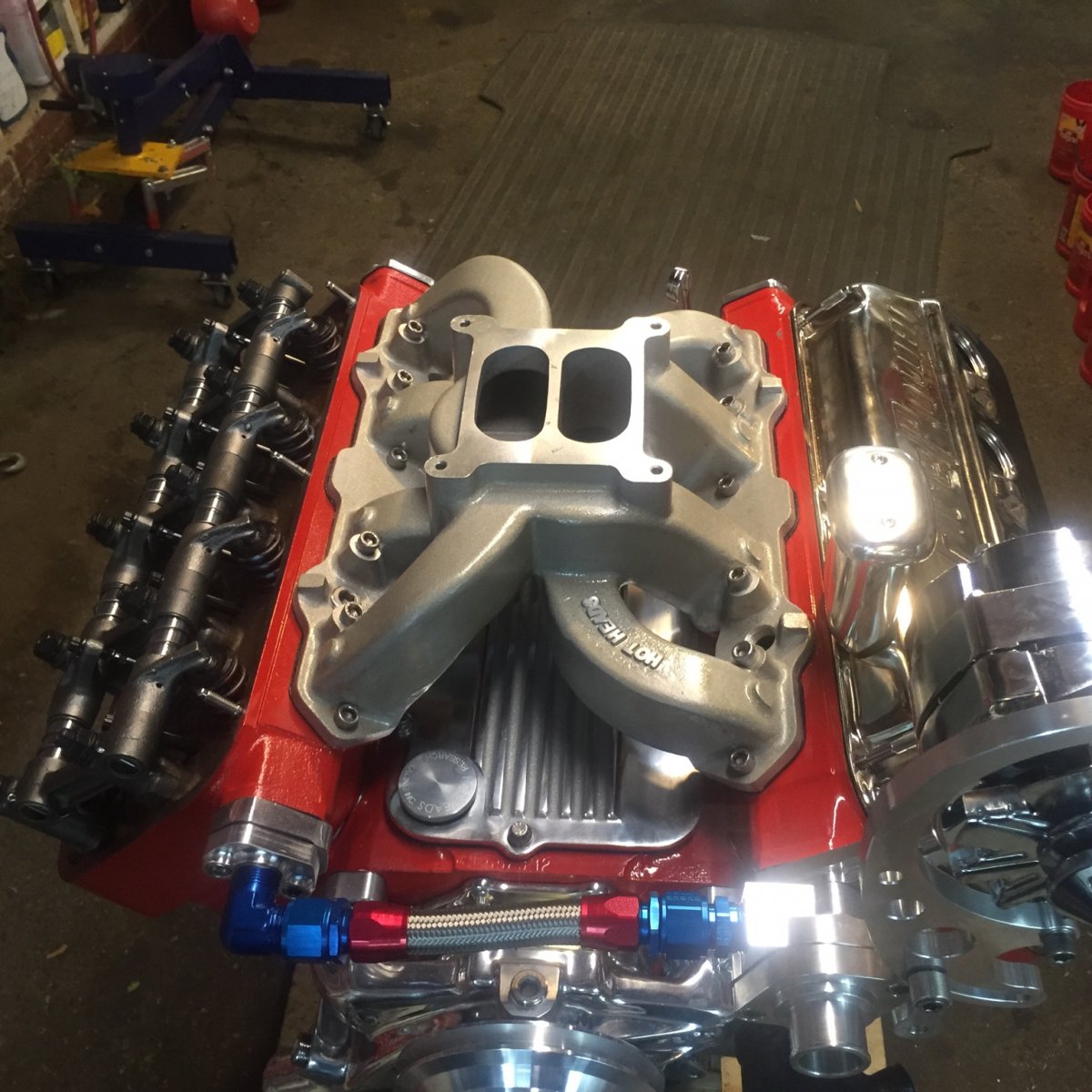

  7. Here's the available work around for the problem.
    Personally I find it very unattractive.
    Then from a functionality view, I suppose it works well enough but the flow restrictions feel wrong to my senses. There are some that 331 heads that have been drilled ant tapped the front of the heads too. TRWaters had (at one time maybe still does) plates that bolted to the front of the heads to take a pipe fitting after some simple milling.
    The question is,,, will a guy buck up for a new manifold or settle for this nonsense.
    Perhaps the nonsense approach wins at the present time because there's nothing else available besides finding the one year only 1954 manifold or jumping up a year to 1955 heads.
    The secondary reasoning is that if a newly available manifold were in the options, a lot more heads would be just as viable and instantly become "usable" to the average guy.
    If I had a bunch of money and didn't mind putting some money at risk I'd try producing a manifold, there's no competition. If I had a little money and had one chance, I'd probably do something smaller and cheaper first.

    Doesn't the hot heads intake work for this? IIRC it has the plugs in the intake flange to work on the 51-54 heads. Sure its the ugly hoses but it works..

  10. I need one of these. Right now we have that ugly tubular thing from HH, the more I look at it the more I hate it.

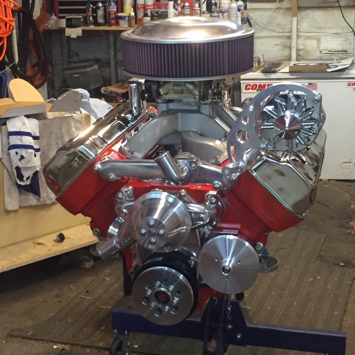

  13. Tatar, why did you switch out the HH unit?
    That's going to be real important on why the other PAW style is needed.

    Red and blue AN fittings are hideous and don't belong on a traditional hot rod or anything else for that matter. Cast aluminum is traditional and seems to be an art that we should be continuing. When the war was over there was a huge surge in speed equipment that was cast. It seems that hot rodders were trying all kinds of new ideas and casting a lot of aluminum.
    With the cost of machine shop time and tools it made sense. Now you can design a part in CAD and send it directly to an automatic CNC machine center and it will spit out perfect part's. That being said there is something to the organic look of cast parts. Pattern making is a dying art that we should be preserving and learning to do. So what if your first few are failures you can learn like our predecessors did. That is what I have done, learned the the old ways and preserved it by teaching younger guys how to do it.
  15. It's not just the color, those fittings could be painted anything, silver black, block color or stripped and polished. Yes that color is the first thing that slaps you but it's much more than that. Tatarsamich switched from the available HH cast unit, to the hideous horseshit hoses for a reason. He's interested in the PAW style unit with different placement for a reason. And the reason is not because of a supercharger even though that paw unit is.

    It seems that this would be good to cast. I need the critical measurements to make a pattern. Why other than a blower is it needed? Is there different lengths due to deck height of the block and other factors? I am ready and willing to make it if you guys can give me measurements.

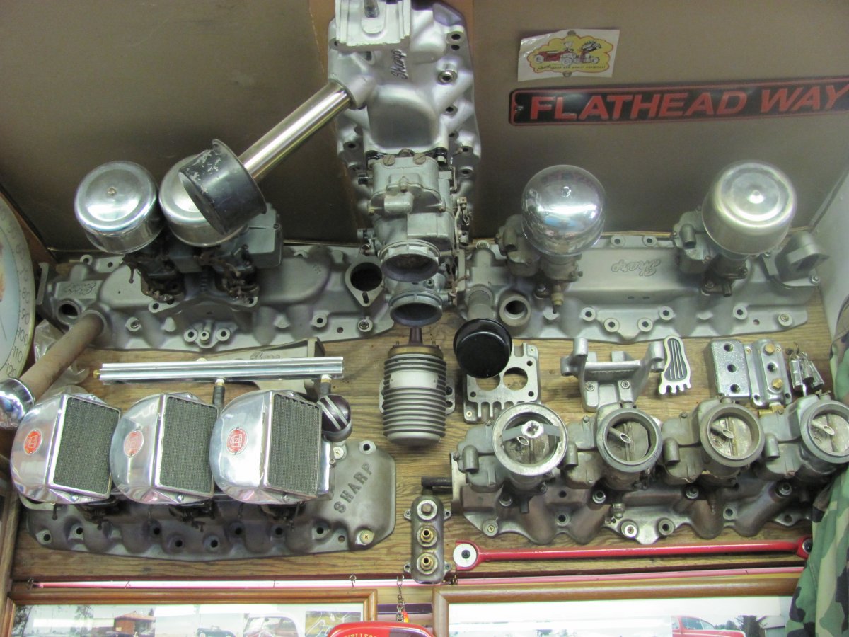

    I would like to see someone make carb flame arrestors that are of the quality of the ones that Nicson produced...... Last Flathead Intakes 2016 008.JPG

    Those are nice, are they sand cast or die cast?

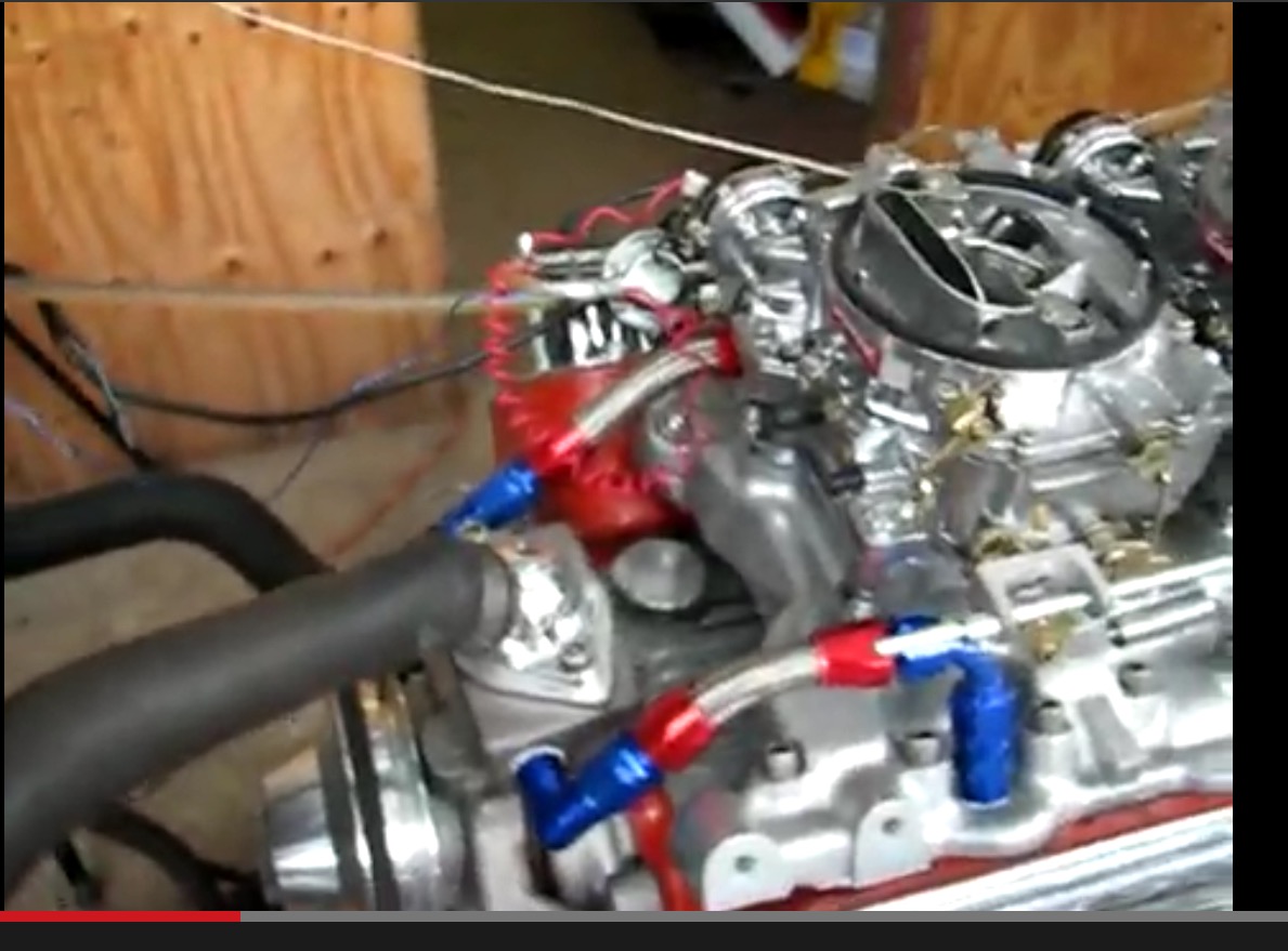

    I did something like this on the Weiand dual quad manifold on the '54 New Yorker in my dirt car. I used regular copper tubing and brass fittings. It looks a little "agricultural", but it probably is "traditional" as the parts were available back in the day. When I built mine, I used "T"'s over the front intake water ports and extended the water lines to the back intake water ports. I have had both the dual quad and 4 duece version of this intake, and they both had 4 intake water ports. I agree that the red AN fittings look out of place, and wonder why someone would go to this effort and not plumb the rear intake water ports.

  22. Since we've also had to use that alternator mount (hoping we may be able to switch to the lower one) the belt hit the water neck and we couldn't use it. I think if we had a crossover that had the neck on top instead of on the front, then it would work.
    31Vicky with a hemi likes this.
  23. Bingo*^^ another reason
    Categorized under doesn't fit or Doesn't work or not compatible but it's deeper than the color of the fittings

    The PAW one will fit for sure in all instances? I can see that the 90 degree elbow sticks out quite far and would cause issues.

    They appear to be die cast....

  27. all instances? Meaning all right?
    I'd say nothing will fit in "all" situations except that hotmess hose crap. The PAW unit works in almost "all" instances, but it was special design for supercharger.
    What's excluded from fitting would be tall deck heads on low deck blocks, low deck heads on tall deck blocks and HH aftermarket aluminum heads. And then the owners free will of wanting an accessory right where the hose outlet is.

    So if it is made identical to the PAW unit it would work in most cases including blower applications? What specific engines are we talking about here? I want to make it and have access to some Hemi's that I can take measurements and test fit on. Like I said before I don't know what fits what with Hemi's so I am relying on the HAMB here.
  30. Yes
    Chrysler hemi 1955 and up 331 354, 392
