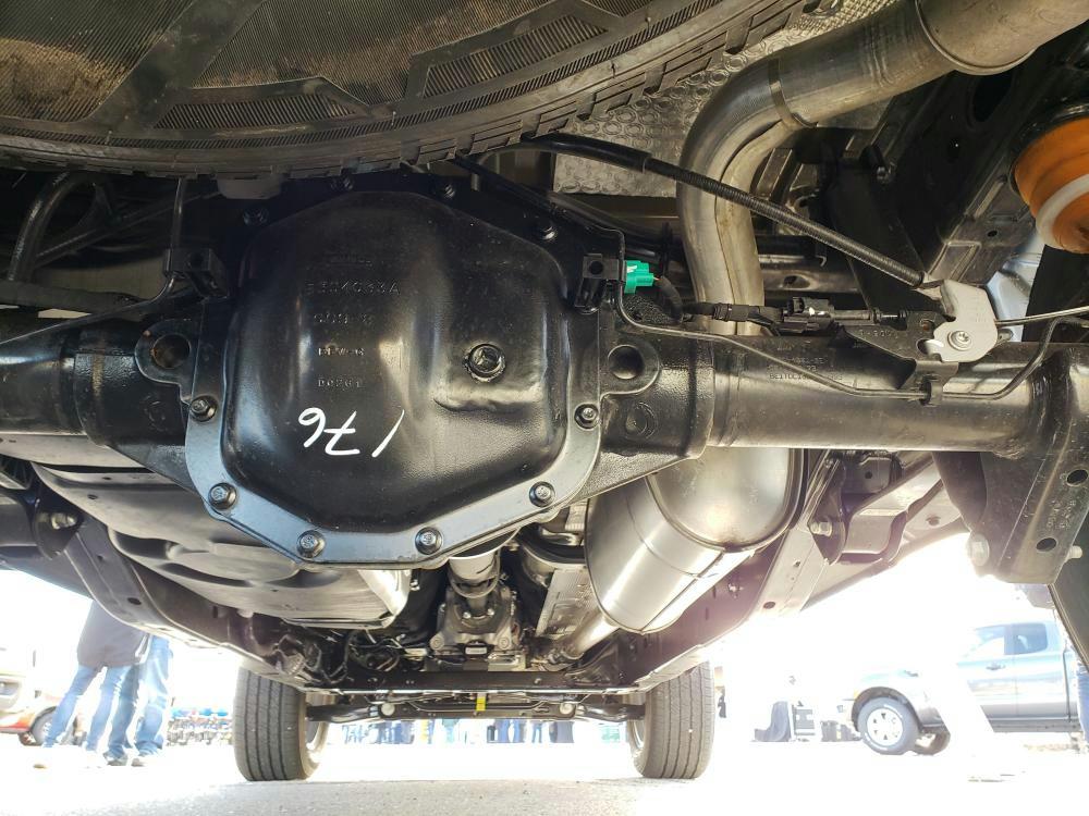

    The Ranger disappeared in the US for a bit (2012).
    When it came back, it was the international version (2019), updated to US requirements.
    What it has now is the Dana AdvanTEK M220.

    New Rangers aren't even solid rear axles. And a completely different truck; not even the same size. A Ranger in name only.

    Yup....I think the M220 in the Ranger is also used a solid axle in some later model Jeeps and Chevy Colorado trucks....a sort of Dana 44....
