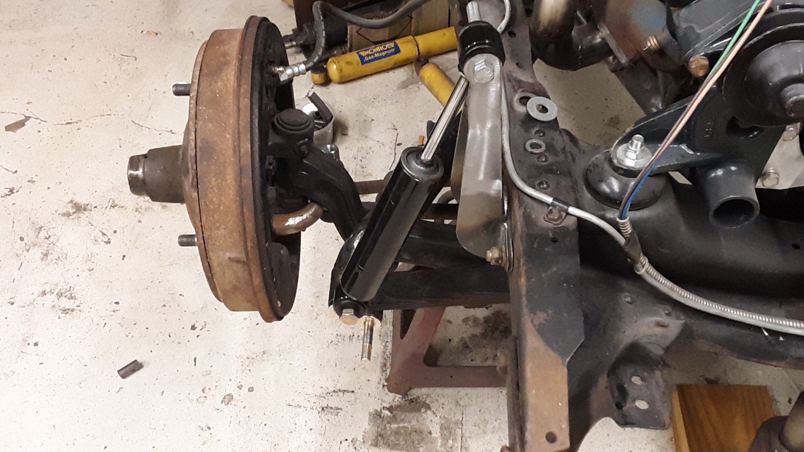

    Maybe I'm jibber-jabbered in the head, I had to cut the hoods off my fronts to get them where they needed to go without undue clearances on the P&J shock mounts.
