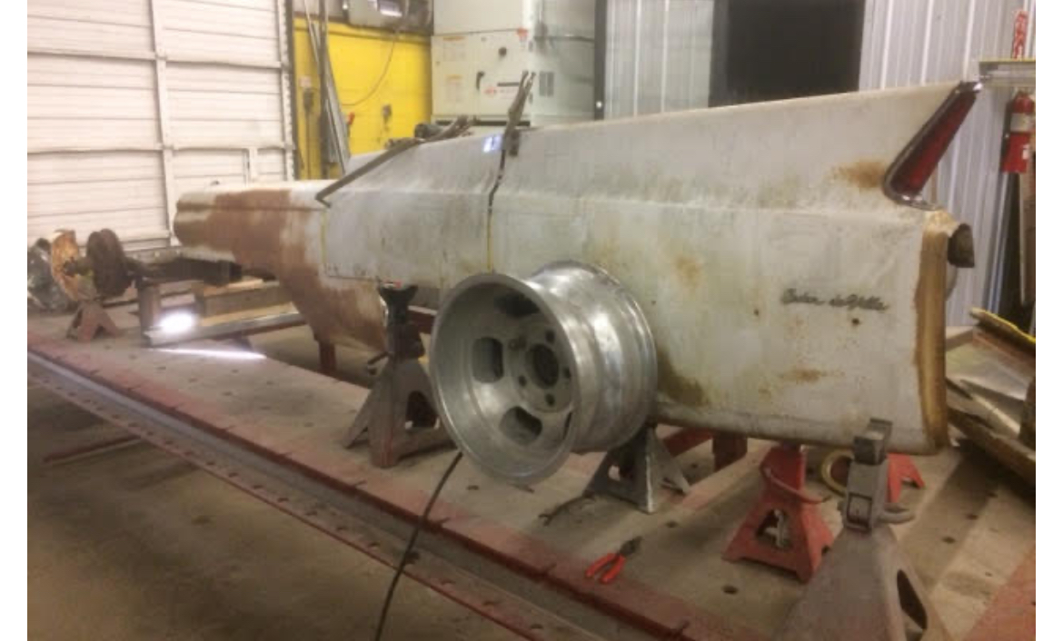

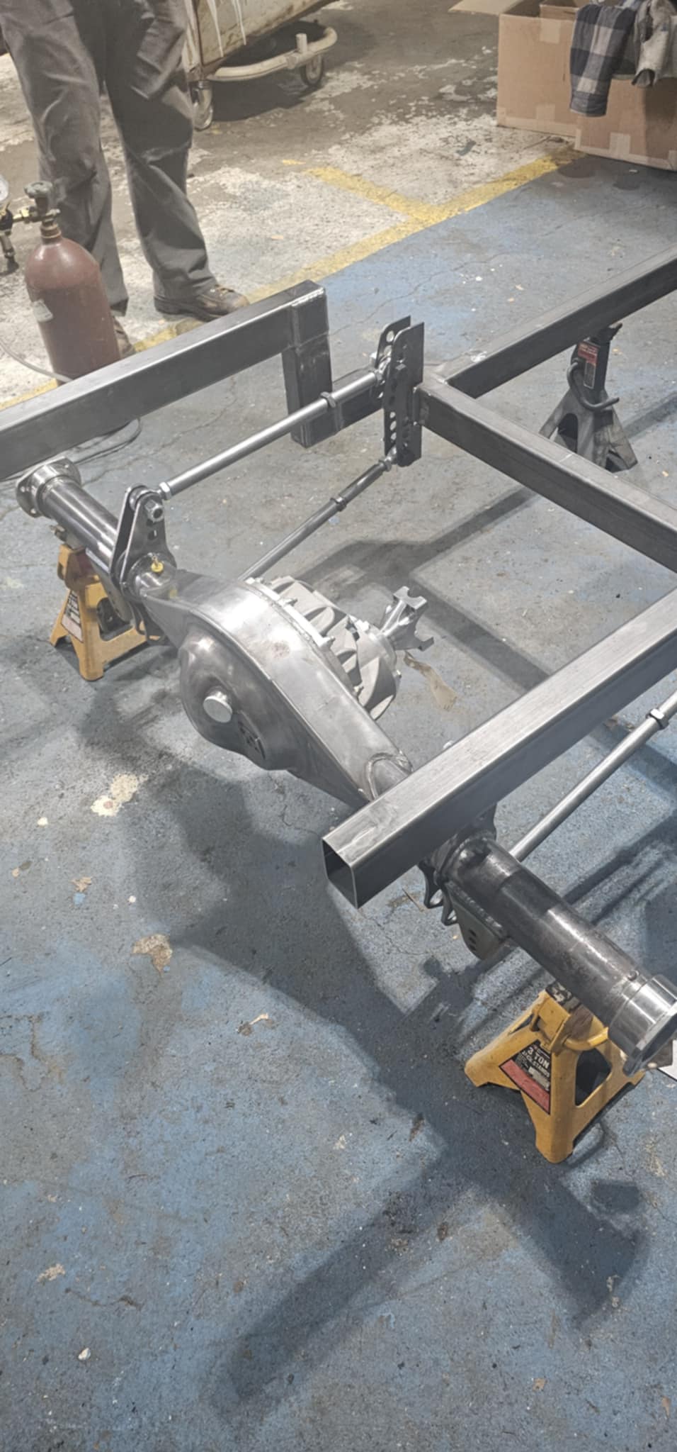

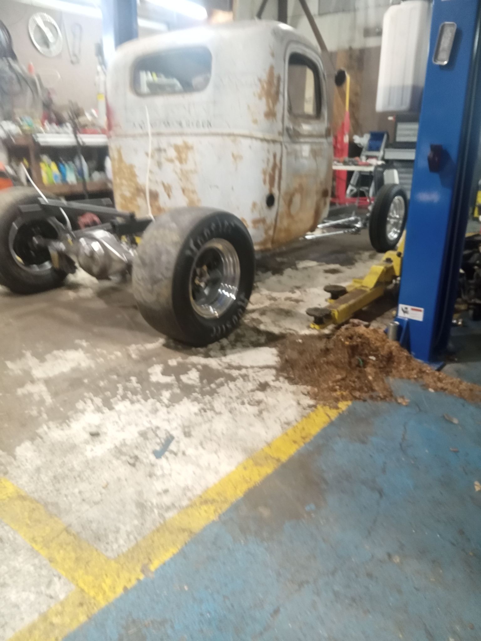

  5. You just put pieces where you think they look good
    Then start measuring and building
    I gotta get back on this one day

  7. Tools needed:
    Kinda level floor
    A level
    Squares
    A plumb bob cones in handy
    Jack stands
    Various blocks of wood
    Chalk, pencils, markers
    Angle finder is nice to have
    A welder
    A way to cut steel. Chop saw is nice
    Tape measure
    Straight edge rulers are cool to have
    Clamps
    Goofy imagination

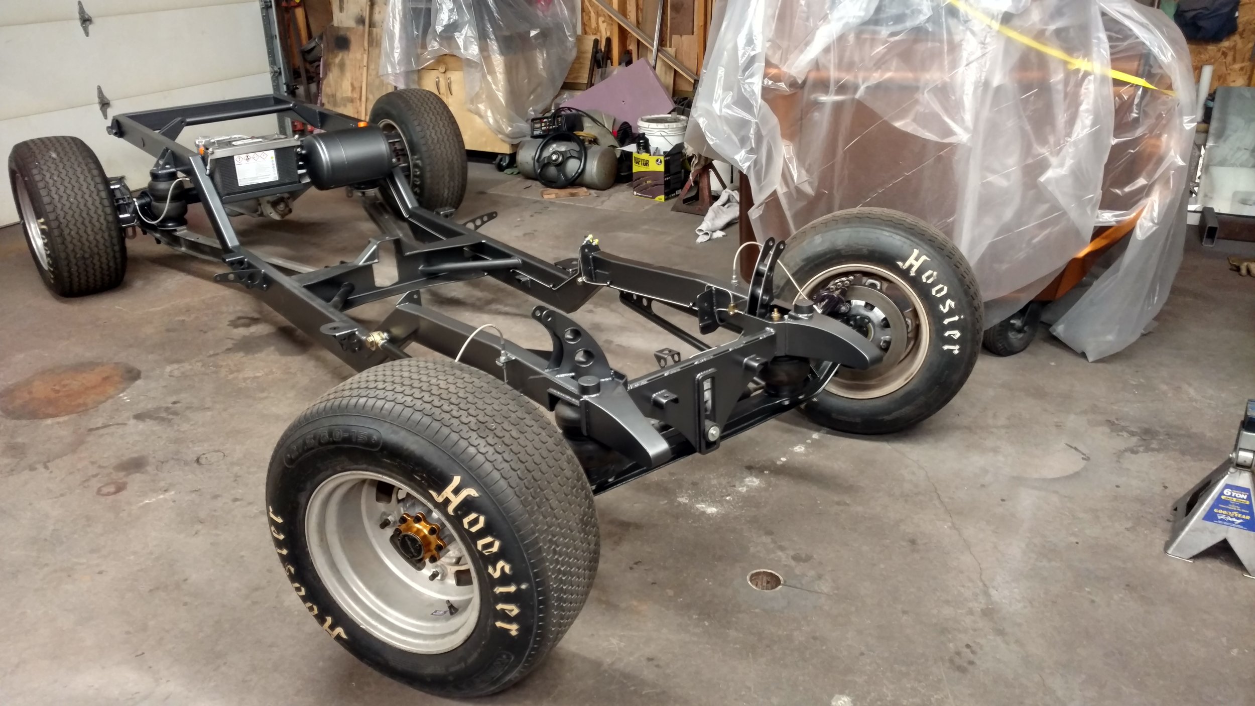

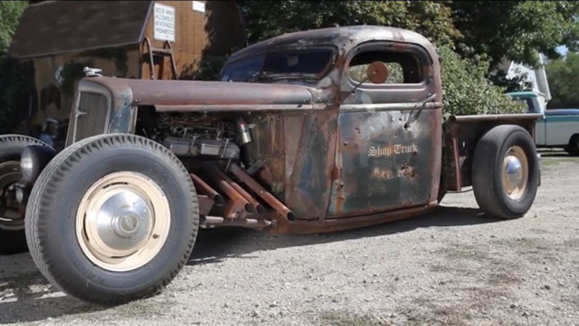

  9. fastcar1953
    Joined: Oct 23, 2009
    Posts: 4,273
    fastcar1953

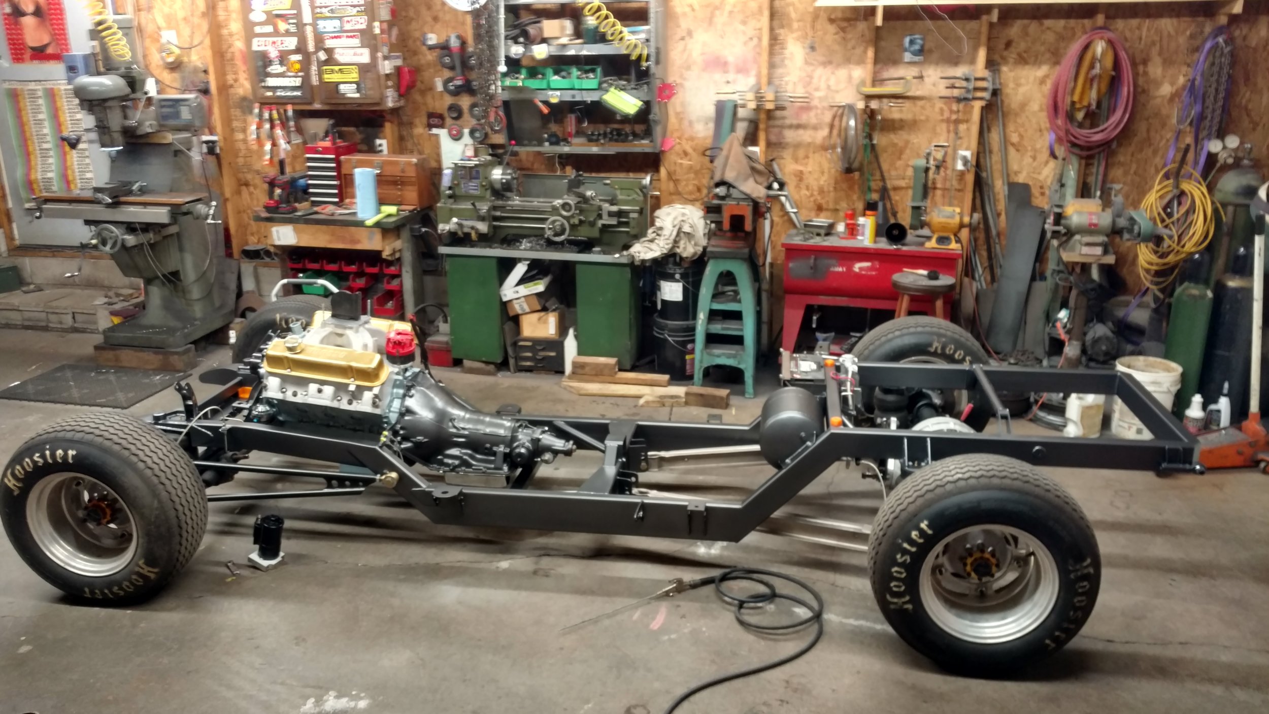

    Something like this. 465814353_9079718318719040_7671453574240345461_n.jpg 466359509_9079717948719077_5130445868032124393_n.jpg 468251552_9182337651790439_9155308214855976613_n.jpg 466968762_9109581919066013_4750567017835964924_n.jpg 466994107_9109580959066109_1810864923720854315_n (1).jpg 467439967_9140276349329903_9130265152697682180_n.jpg 468295972_9187969434560594_5508663570755125366_n.jpg 468304890_9187969047893966_8128394349726999078_n.jpg 473253901_9450359608321574_8119271695677792207_n.jpg 473327787_9450359114988290_9000406087235326527_n.jpg 473416118_9450360084988193_7061207841893908136_n.jpg 473831055_9482732278417640_5954636530524856755_n.jpg 471349372_9350047015019501_6202015666681763524_n.jpg 471598009_9350047355019467_3857360593182127897_n.jpg 471688109_9371424116215124_6525548568132754000_n.jpg 471744276_9371665486190987_3400591377366429343_n.jpg 471751928_9371665479524321_391505667846488965_n.jpg

    You keep getting asked because you keep asking questions that someone with experience building hot rods wouldn't ask. Plans don't exist for building frames for bobber trucks. Guys just build them.

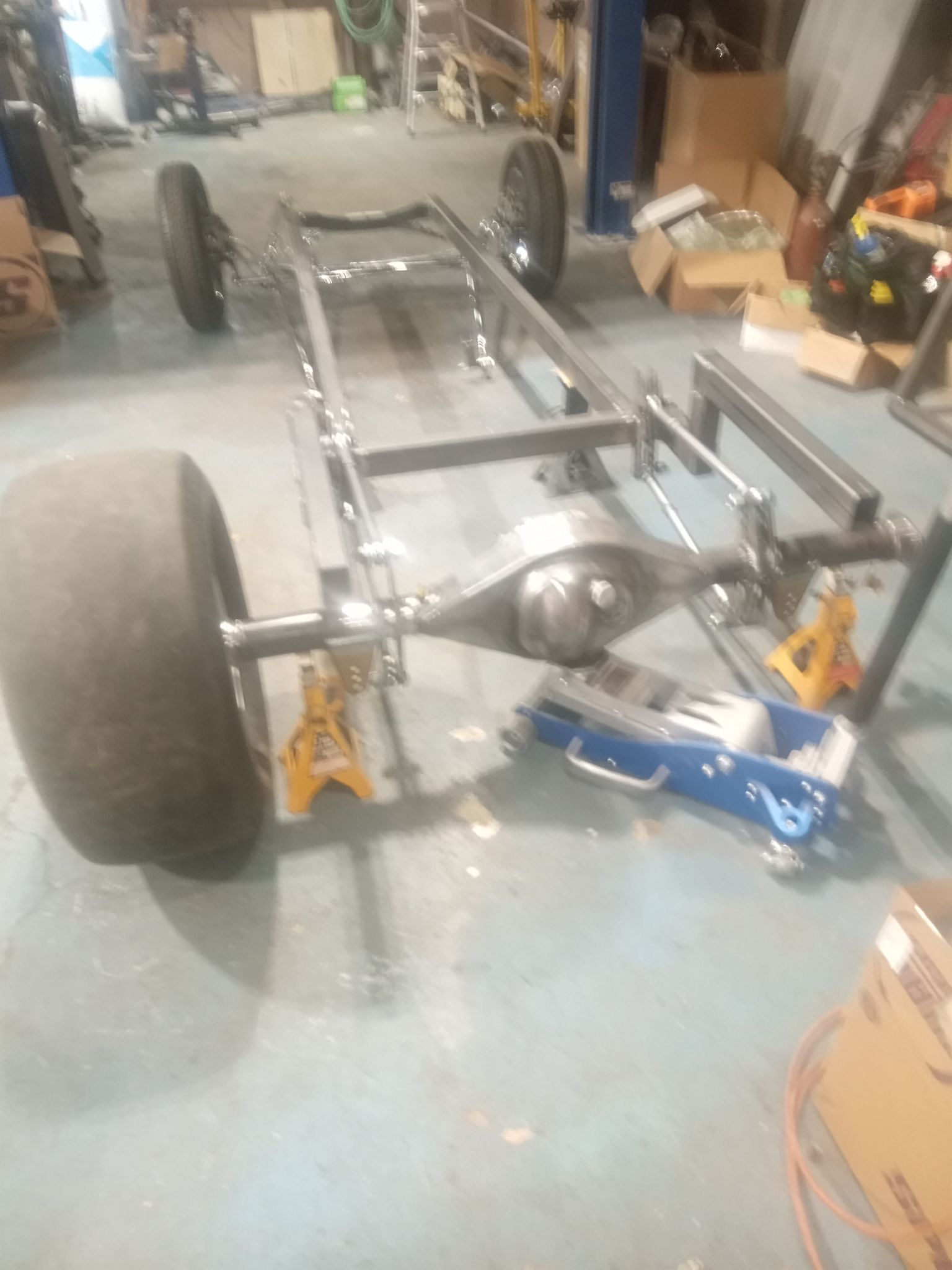

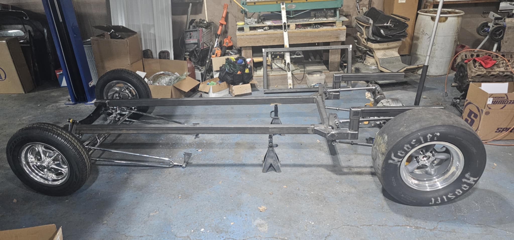

  12. Paulz
    Joined: Dec 30, 2018
    Posts: 199
    Paulz

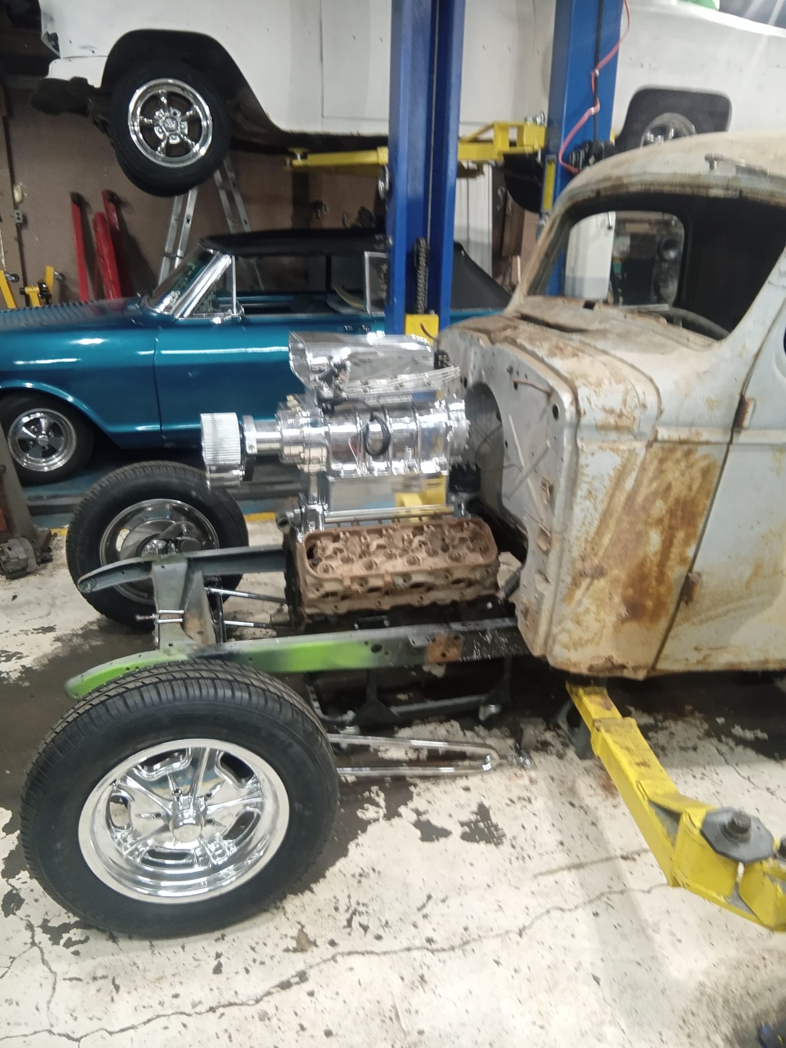

    IMG_20200917_185306220_HDR.jpg This is what's under mine. No plans other than an idea of how I wanted it to look, and then doing exactly what Anthony posted above.

    And there you have it! 3 guys that have shown you their plan! We expect to see a full build report with the plan all set up for the next guy.
    If you want all the measurements, angles, and a step by step process, you will be frustrated forever. They just don't exist. You do the same thing everyone else does, a plan by trial and error, until you have done a four or five of the same thing. Then, after 4 or 5 builds, you don't hand out a step by step pictorial because you probably didn't do***ent the process.
    There isn't one of these guys that didn't have an "OH! ****! How do I do THIS!" moment.
    If you want a frame the body will bolts onto, buy one from somebody the jig builds the frames, or man up and do the plan by trial and error your self.

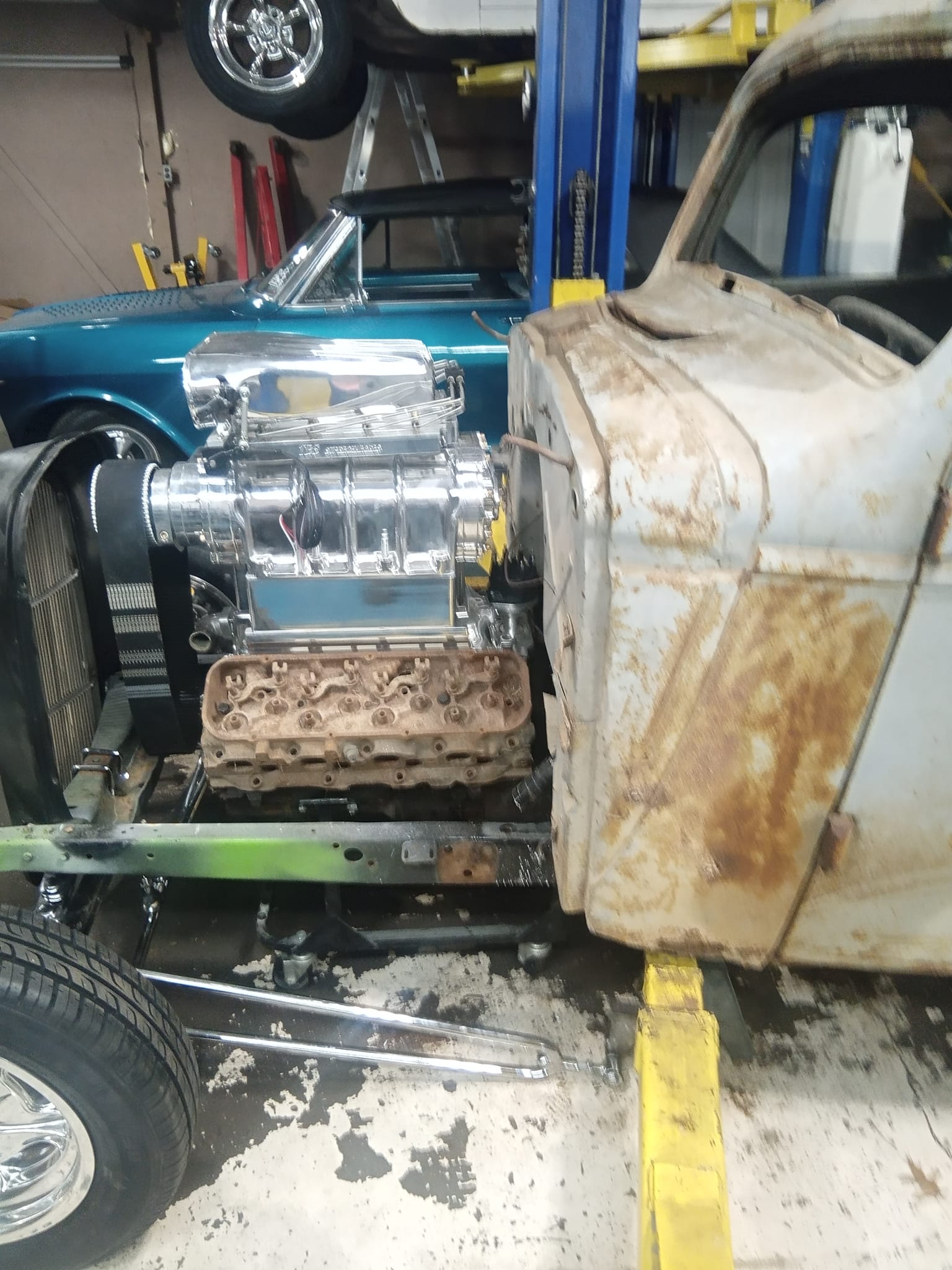

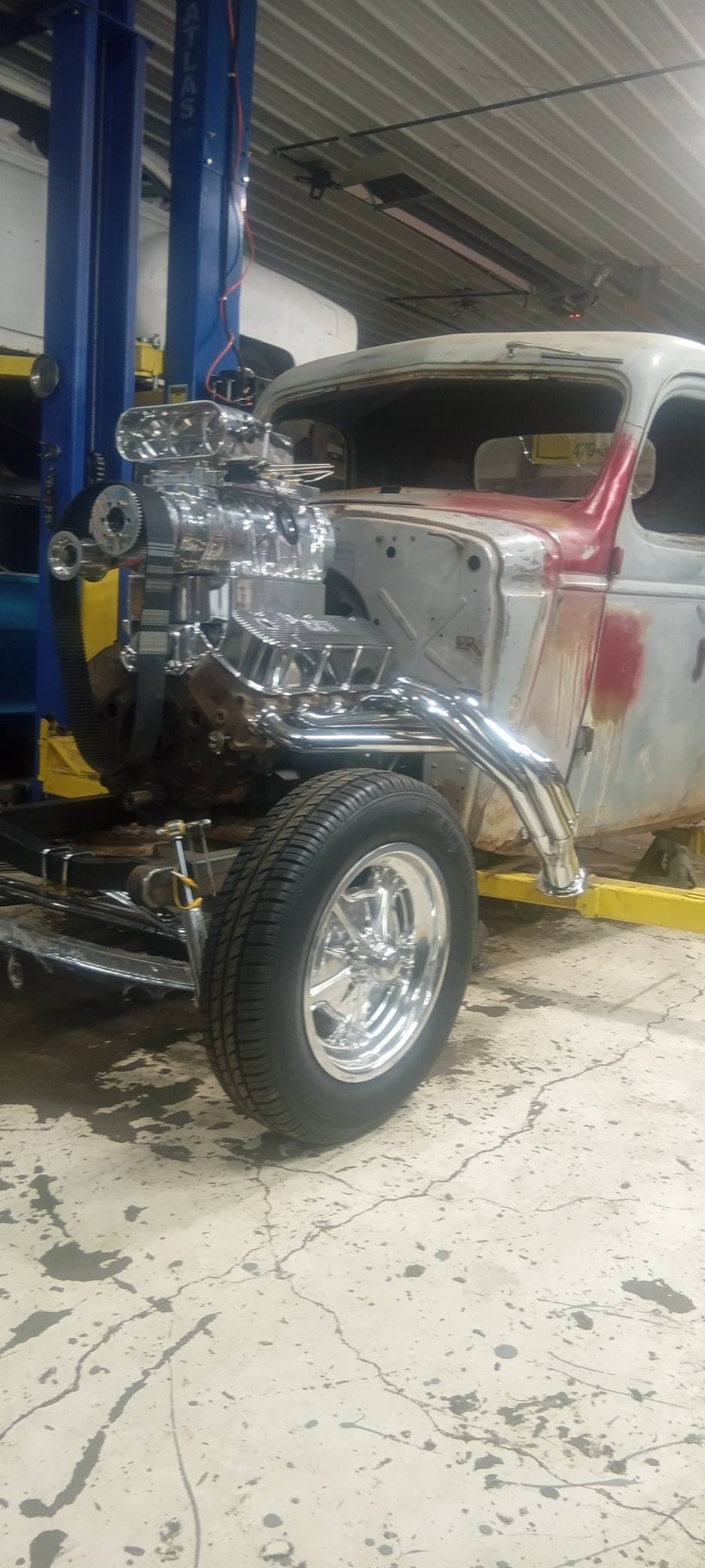

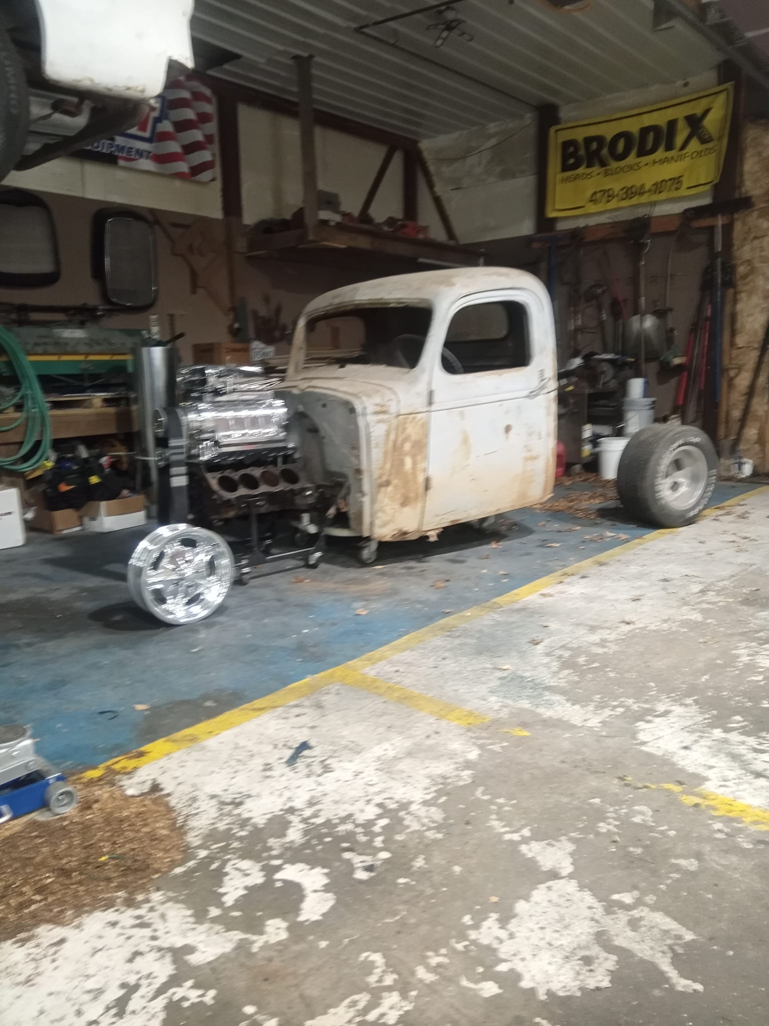

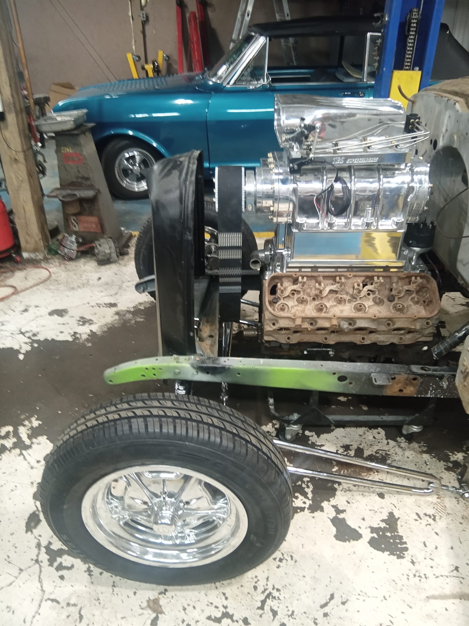

  22. fastcar1953
    Posts: 4,273
    fastcar1953

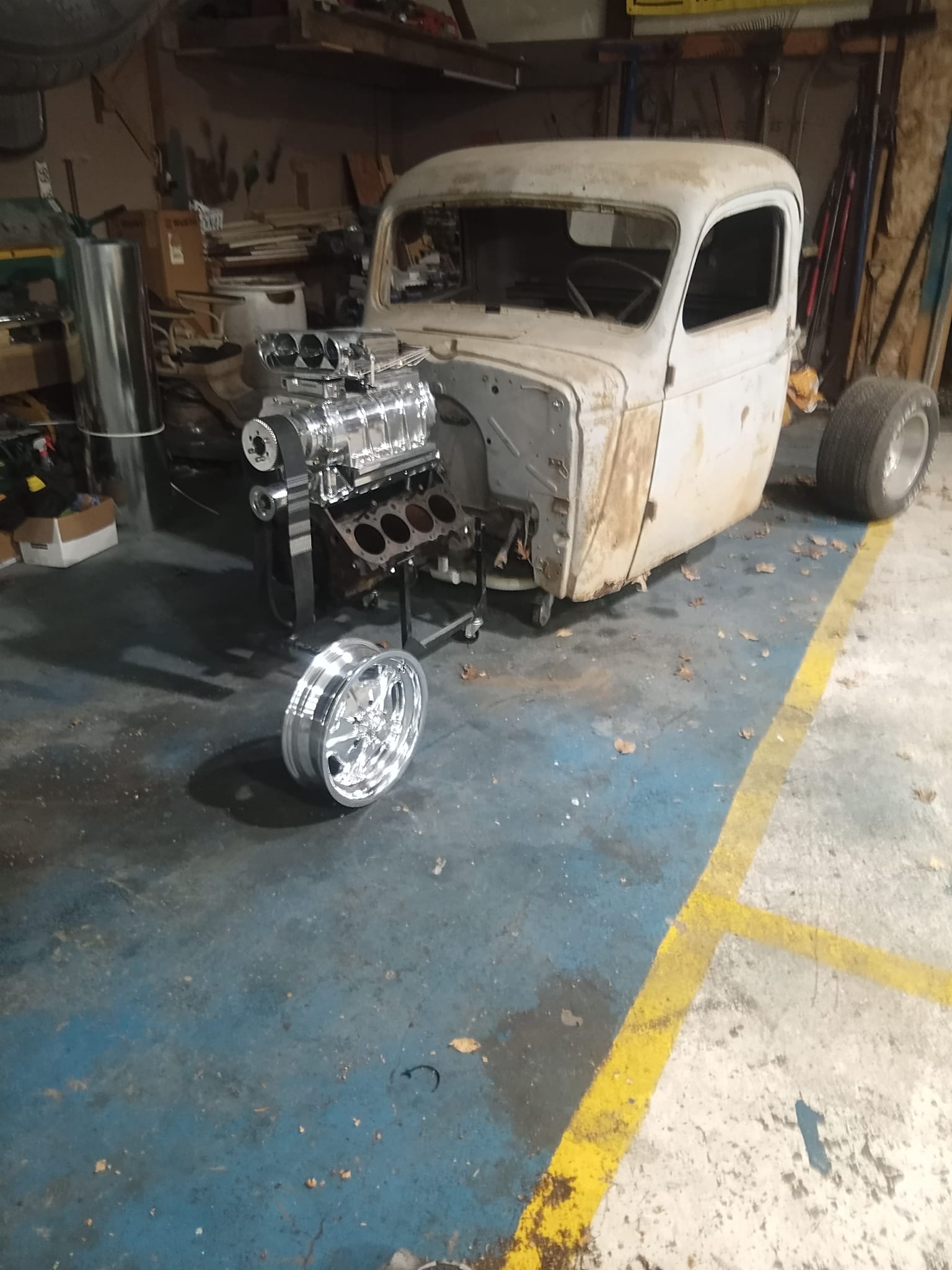

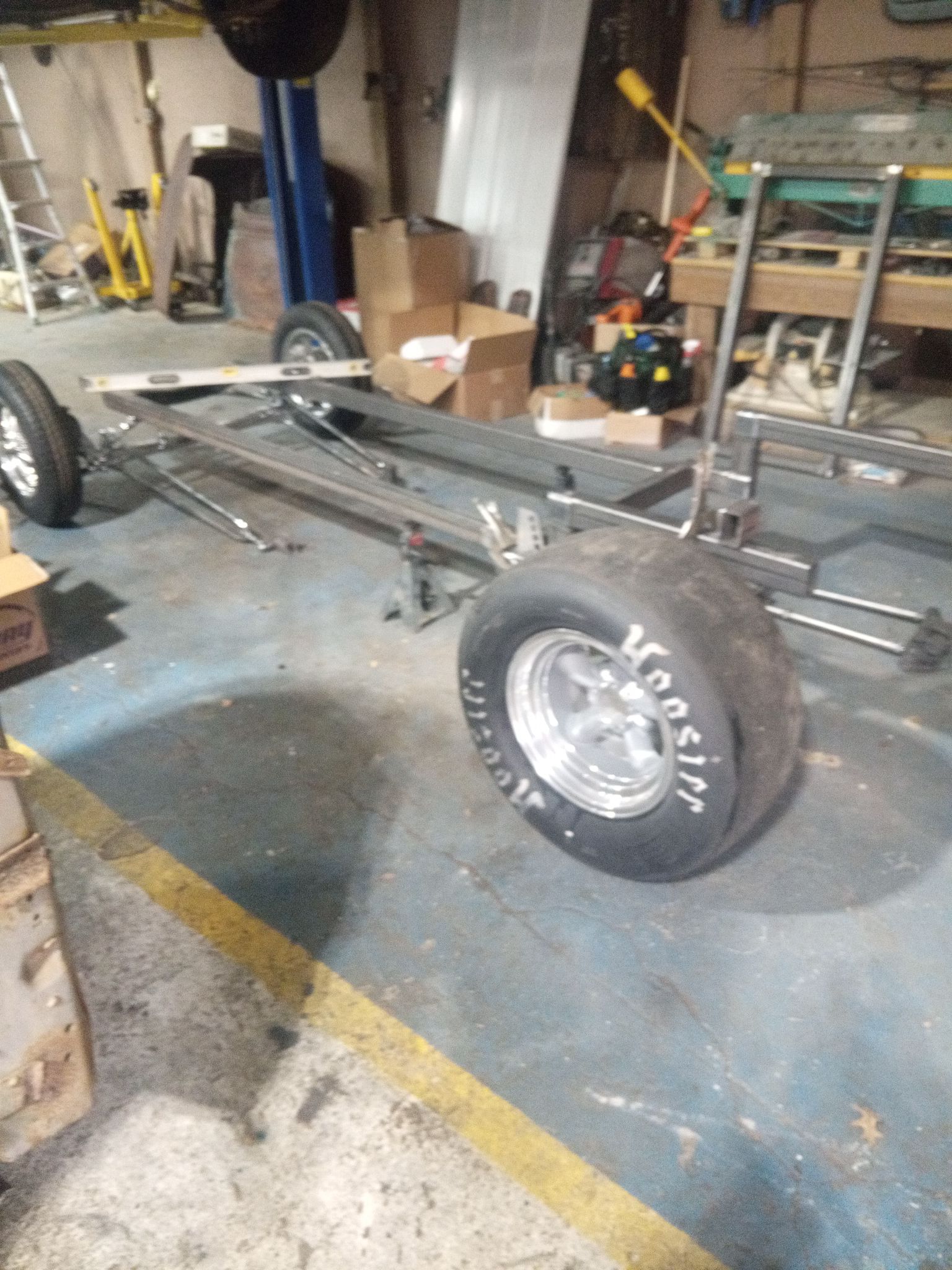

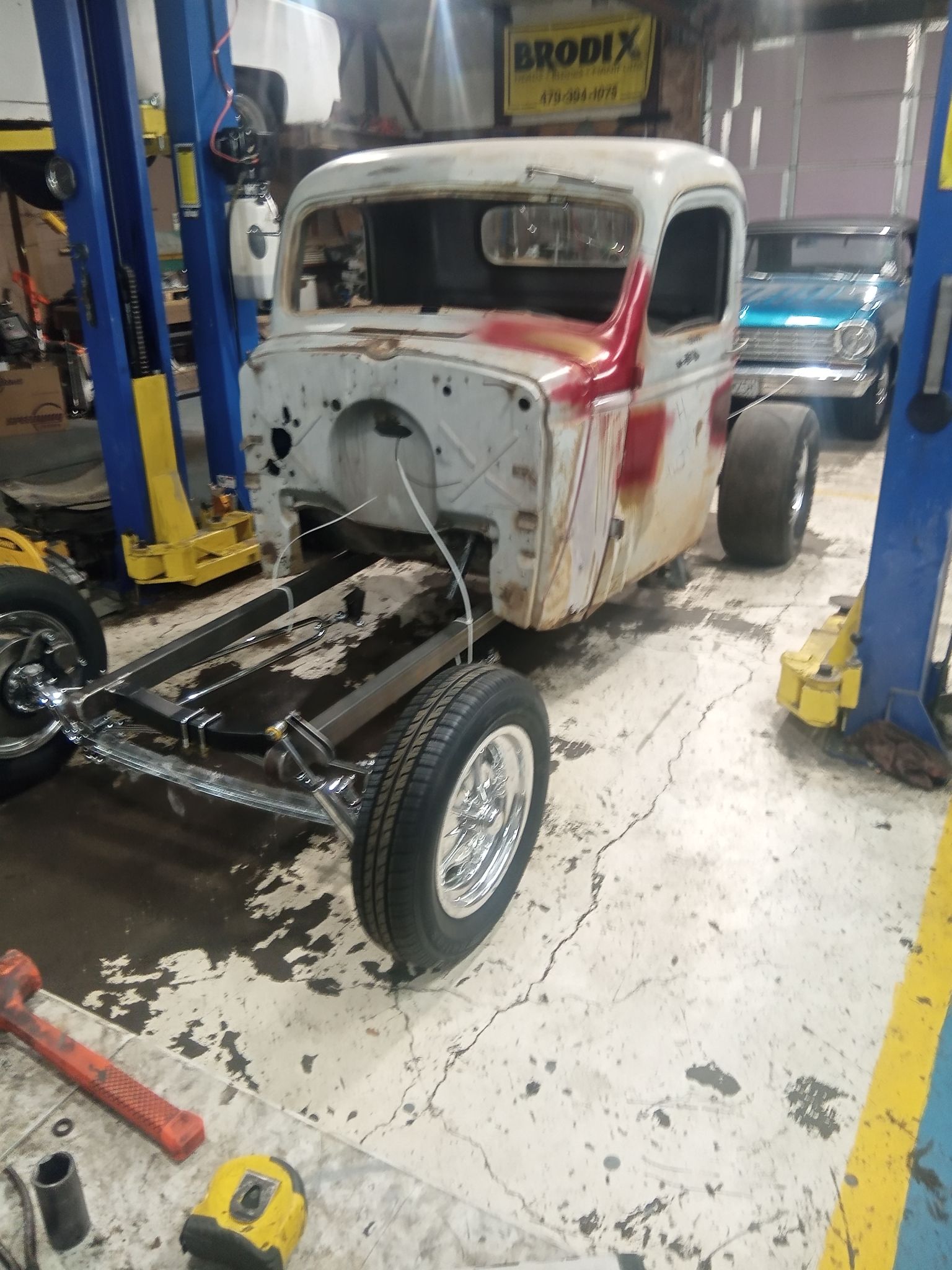

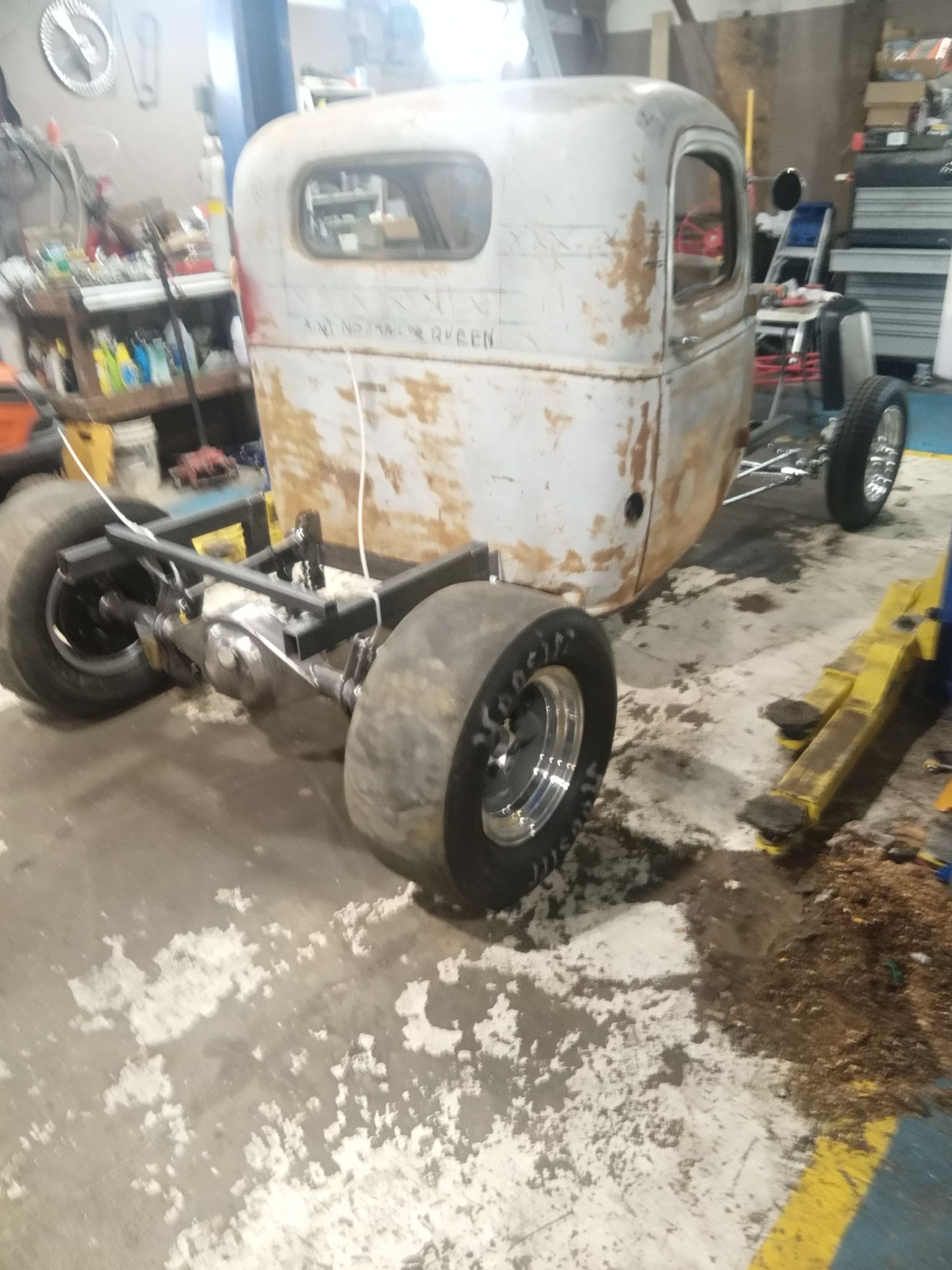

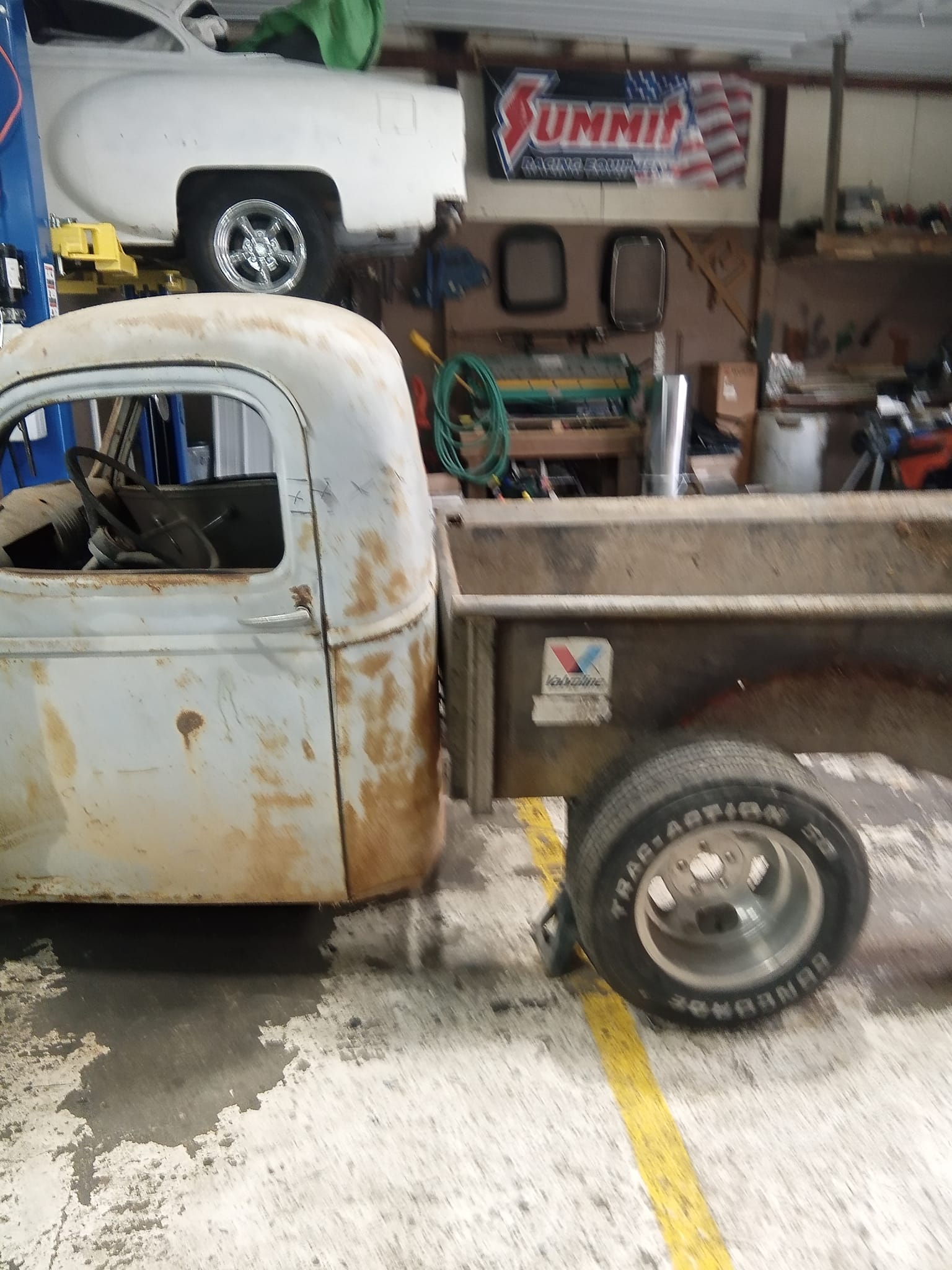

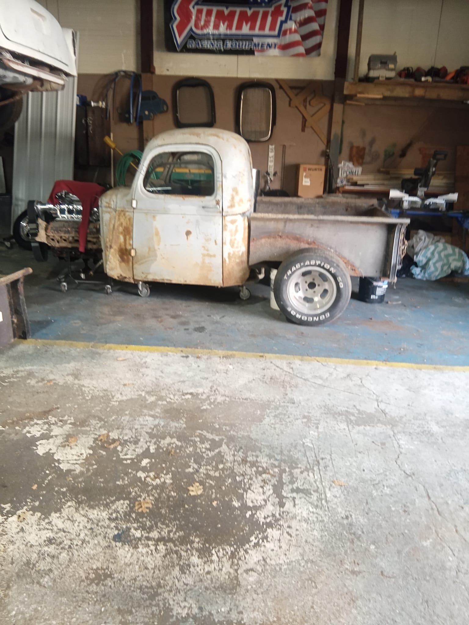

    I started with a model a frame back to firewall. Copy that in 2x3 square tubing ,left it long. Built the back to fit the bed. I also mocked up bed length and fuel cell. Ended up with 116 inch wheelbase. That is what the stock wheelbase was.
    First thing is get body and wheels close to what you want. Figure out what suspension you want .
    Ride height engine placement. I didn't channel my cab. My floor is still flat.
    Yes I did have to make changes a long the way. Move shock mounts , front crossmember, etc.
    If you have the cab and body plus a engine and transmission if will come together pretty quick.
    Mockup is the fun part.
    Okie Pete, X-cpe and lostone like this.

  24. fastcar1953
    Posts: 4,273
    fastcar1953

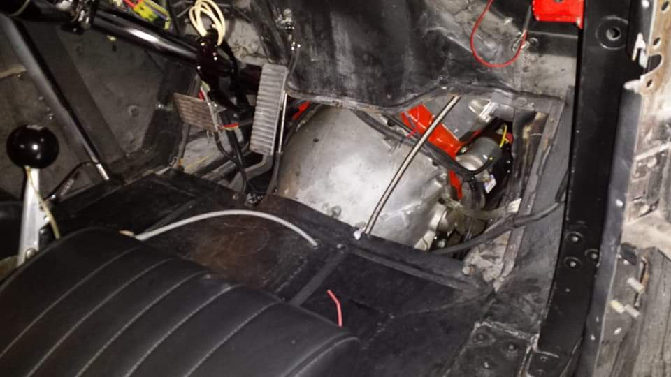

    th400 with gear vendor. Floor is flush up to toe board. I cut out floor just for mockup. It will all come out and get new floor put back. 474013286_9489028577788010_3458395365278883544_n.jpg 474210553_9489028904454644_712885756321661977_n.jpg 474274474_9489029081121293_5211812670103525668_n.jpg
