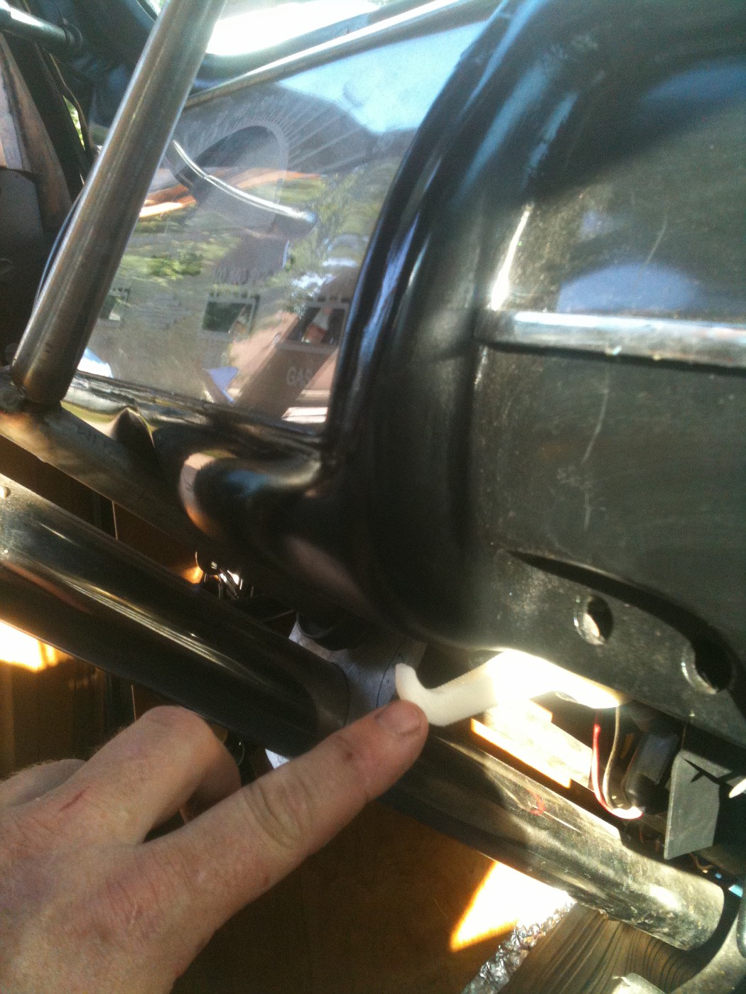

    I have a 3d printed part on the recycled 40 ford woodie..
    its plastic... simple.. for the most part hidden.. and solves a very big problem..
    I used shapeways..

    That looks like a holder for your CB mic.

    This is the handle for the wiper switch.. which makes "turning" the wipers on and off.. easy.. most people never see it..
