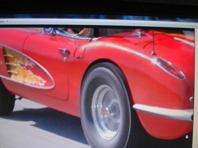

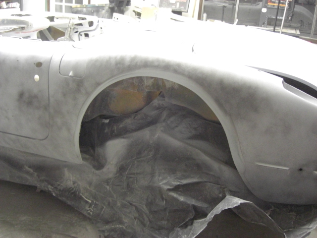

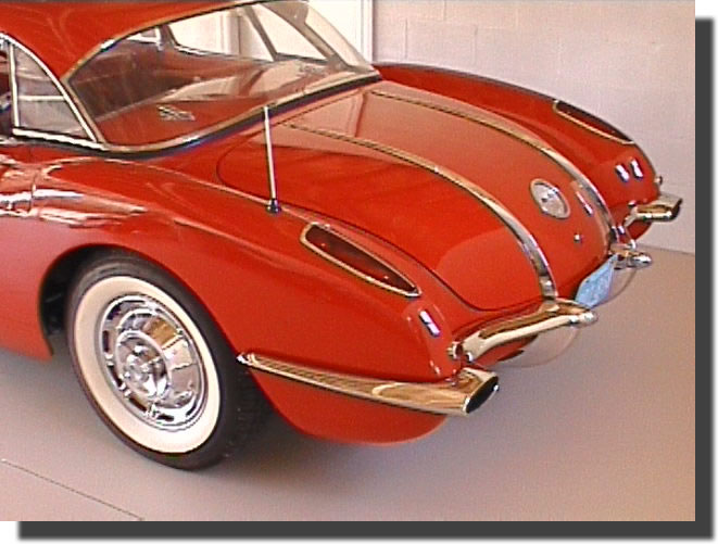

    The car has set a few weeks in the sun to cure the body work and now comes the hard part mentally for me . Up till now the body work has been pretty much by the book, as in, it could be put back to stock at this stage. Now comes the turning point . First , the rear fenders need to be radiused . As you can see in the comparison pics . The movie car wheelwells looked to be trimmed about 3 inches higher than stock. I thought long and hard about whether I should cut them or not , for about 5 seconds and then I butched em out! No turning back now. 1958corvette.jpg CIMG8095.JPG CIMG8101.JPG
