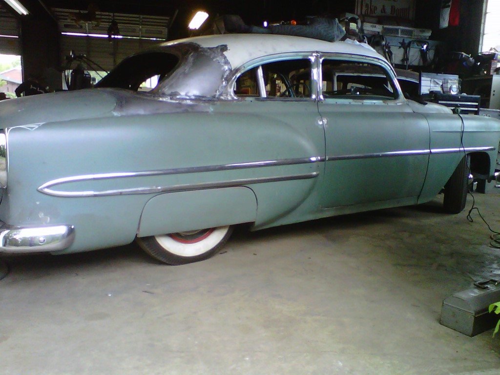

    so jeroma and myself broke out the 4.5" angle grinder with a diamond cutoff wheel and a spray bottle of water and we made some **** happen:) got the stainless cut too:)
    unfortunately it got late and we didnt have a rope so we couldnt install the window but that will be done directly after work tomorrow!
    I cant believe how nice it turned out... it looks so damn good!
    thanks for all of the encouragement guys!

    Man, that statement means alot...that was the whole point to chop a car back when they first started doing it, to improve the lines and flow of a car's body (as Winfield said at a show when he was chopping a top) As if it could have looked that way from the factory. Mail slot windows and hammered tops look good on some cars, but a chop like yours really goes back to the roots of kustom cars. Looks great.

    I guess you could cut the gl*** first but that seems rather ***bersome to me... and it may not be chopped a ton but there is almost 3" difference in hieght in the front and probably 4" or 5" in the back...
    as for keeping the stock window, I am just not a big fan of wrap around rear windows, I like big ***y sail panels:) I have seen wrap around rear windows that looked great but its just not my first choice.
    and my suspension, it has a Fatmans MII ultra low front end under it, my stock front end/steering was shot and it was actually about the same price in my case as everything needed to be replaced. oh and 1 coil cut off the front with 2" dropped spindles, the rear has a set of 3" dropped springs from posies with a set of 3" lowering blocks, 8" c-notch in the back and the tunnel has been raised 5".
    and yea as im sure my 235 is not going anywhere unless someone offers me a chunk o change for it:D

    found a couple more pics from when I finished up the p***enger side on sunday:)
