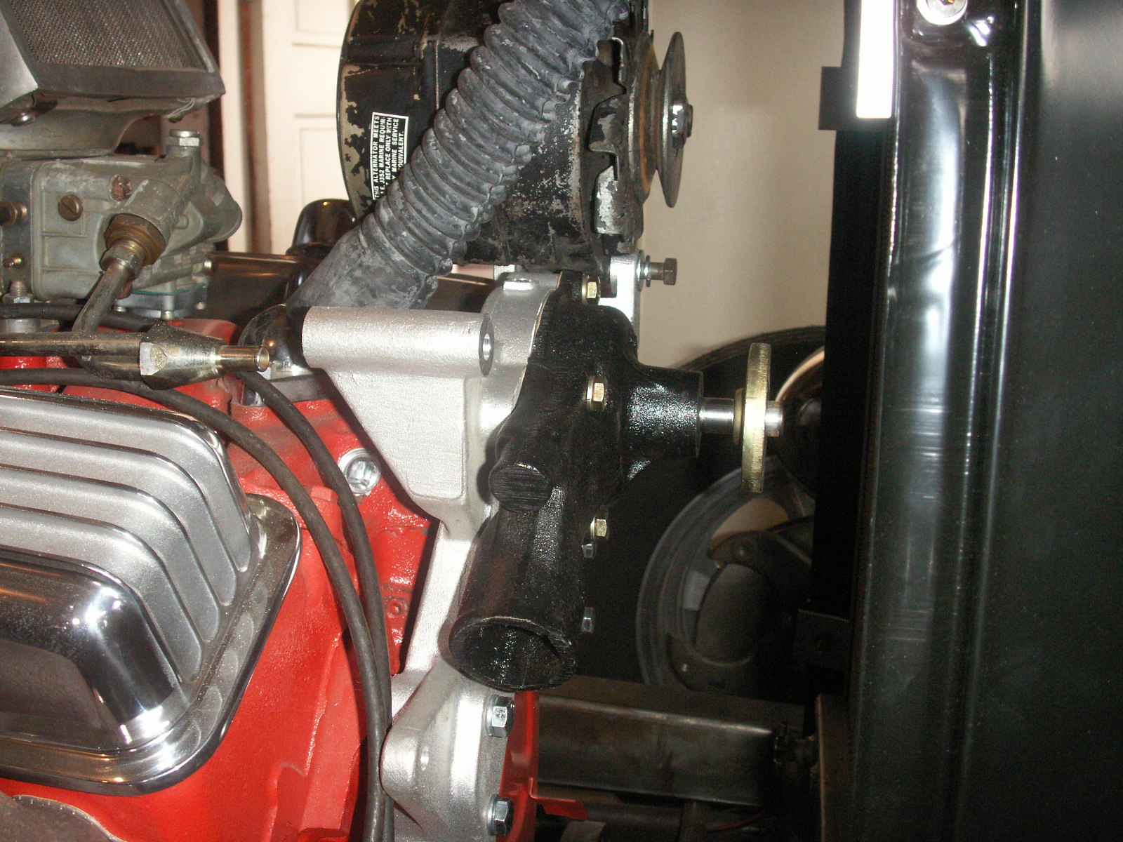

    We decided that the fan we would have to use would be so small it would likley not be able to adequately cool the car in the hot Texas weather, and we were not willing to use an electric fan. So I painfully paid out the $300 bucks to get the Zipps waterpump riser from Southern Rods.
    <CITE>www.southernrods.com</CITE>
    It was the first time I had delt with them and they were cool on the phone, and the delivery was quick. What else can I say.
    On a different note, I initially ordered the part from Socal Speed Shop. After 6 weeks of waiting I called them and the gal said she would have to have some one call me bach, which they did in a few minutes and the dude tells me that they were out of stock and when they called the company (ZIPPS) he was told that they were not making the part anymore. Whether this is true or not I don't know, but those of you that will run this setup might consider calling Southern Rods and picking one of these neat peices up before they are gone!!!

    The riser uses a straight six chevy waterpump, available at any Autozone. I comes with the alt mount and A/C mount built in. I guess I will use the Alt instead of Gen like I had mocked up. I will likely just cut and remove the A/C mount on the P*** side.

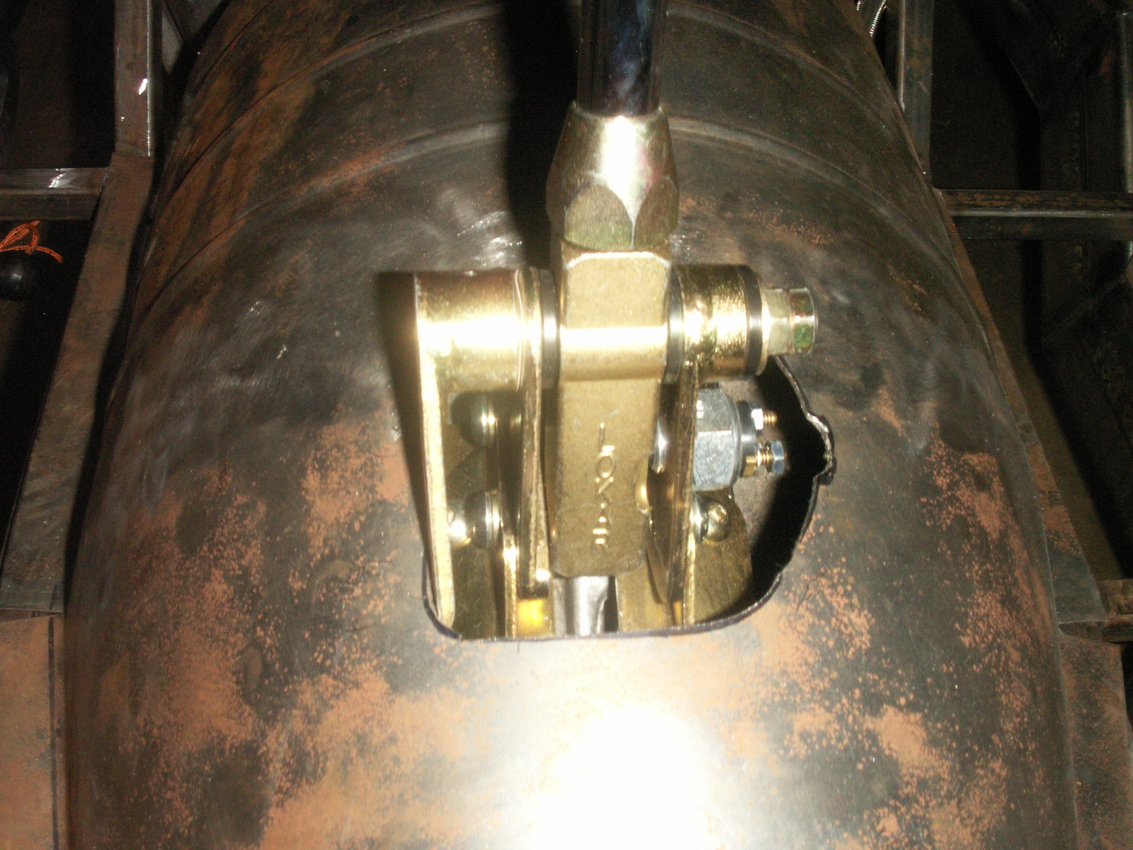

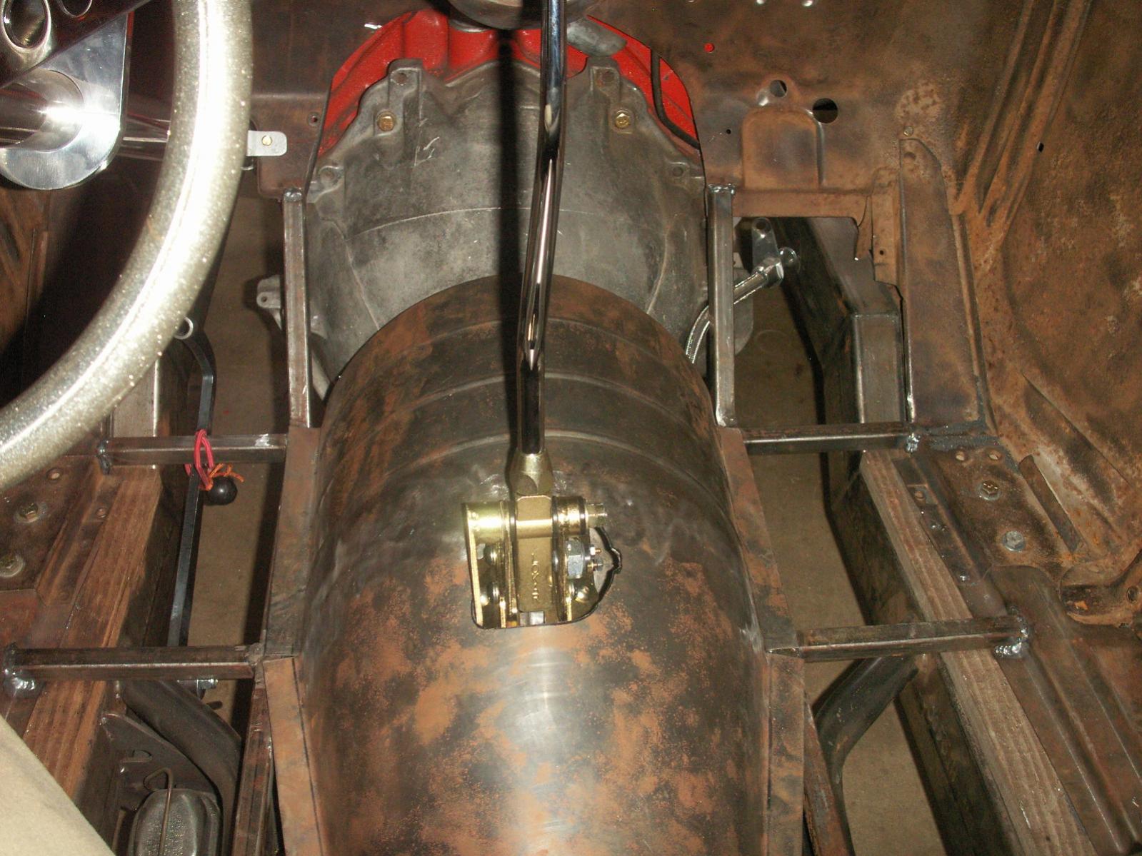

    Perhaps the coolest advance was in the floor. I finishe the transition between the driveshaft tunnel and transmission hump. I think it looks killer. THere is NO room for your feet but it was as much as I could manage with the channel like it is. I should be fine.
    I also installed the new Lokar shifter www.lokar.com I went with the 16" Nostalgia shifter. I think it ended up being right around $200 with shipping. I got the Black mushroom shift handle.
    I am really impressed with the Lokar. The quality is outstanding. I have seen the Gennie shifter as well, I think that is what Jay runs, and I dont like it as much. I prefer the shift detent in the top rather than having to pull the handle to the side to disengage.
    The gennie quality was also really nice I just prefer the way the Lokar operates.

    Oh...and I got a seat in. I bought it from Dan who is a pal over in Keller. 63Dan63 on here I think. He says its a caravan middle seat. I think I gave him like $80 or something. I fits perfect. THe headrests are funky but they are not staying. I will have it recovered at some point in an obscene metalflake vinyl.
    Took a couple trys to get it mounted right, and in the end it is a touch higher than desired, but the tunnel would not allow it to go any lower.
    BIG learning point here. You want to make as much room as possible along the way. There are several areas where I erred on the side of caution to give clearance to the suspension and driveline ect... only to later struggle with not enough room inside the car because of it.
    So I guess I am saying make sure you really think stuff all the way through and do the extra work to get nice tight clearances.
    A perfect example is the tunnel for the drive shaft. The bender I purchased would only give me a certain amount of radius. It was wider that I needed but I went with it because it was the easiest way to get it done. Well it looks good, but I sacrificed a lot of clearance inside the car.....anyway there ya go. THink it through first. THere are places where I did all the math thought it through and still came up short because there is only some much **** you can stuff into a gymsock, but there are otherplaces that I could have avoided problems had I considered it longer.
    so here is the seat.

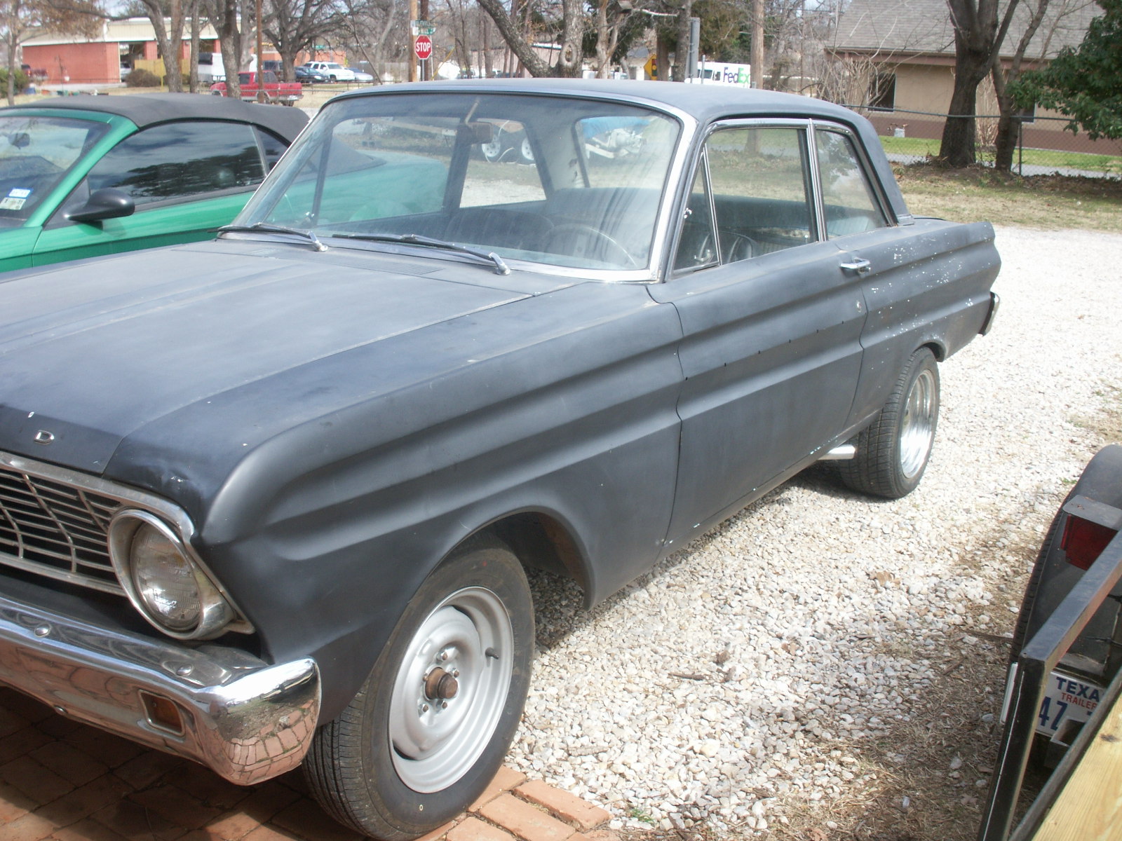

    So the coupe will probably not make the roundup, but I will bring the Falcon. Its a beater but damn it it quick and fun to drive. Its been back on the road for a month or so after over a year or motor rebuild and component upgrades.
    1964 Falcon
    1957 Ford 9" rearend
    late 70's 302/C4 combo
    550 lift Crane cam
    World Products Heads
    Big stall, 3200 I think
    econoline seats
    early Mustang susp/steering
    I am worried about the 5hr drive down I35 because the car is really not setup for the highway, but we will see.

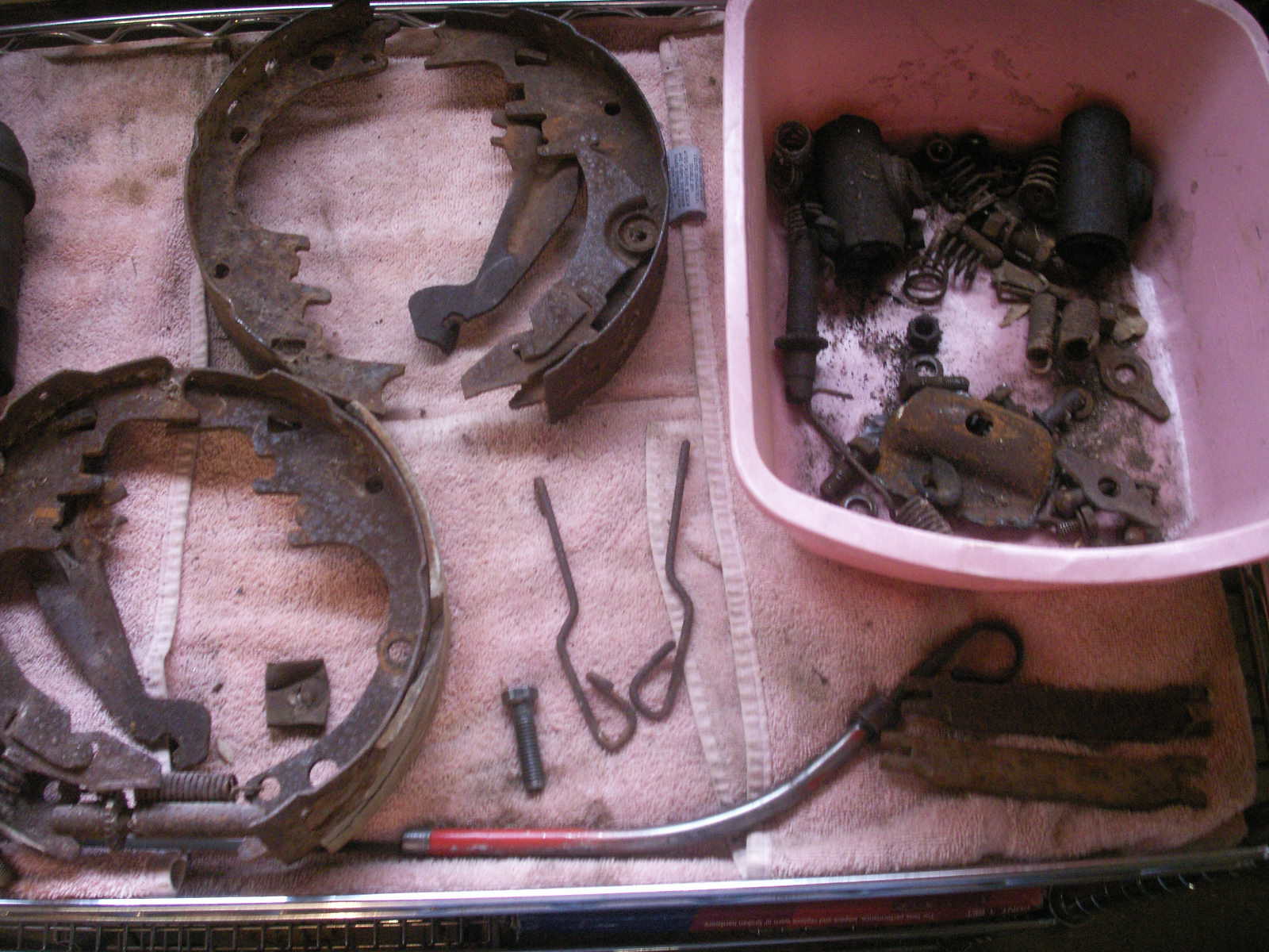

    I jumped back on the coupe and got some work done. I pulled the mocked up rearend. As you may recall it gave me quite a bit of trouble getting it set up, but it is right now. I cleaned it up, finished the welds and put some paint on it yesterday.
    I also painted the ladder bars and the other ***ociated components and installed it back under the car this morning.
    I put the backing plates back on pulled out the brake hardware. Most of it is trash so I ran to the parts store and got some new stuff.
    I will have to start fresh in the morning with the ***embly because I have to be at work at 4pm. I am however "back on the wagon" and I will hopefully be posting alot of progress in the next few weeks-months.
