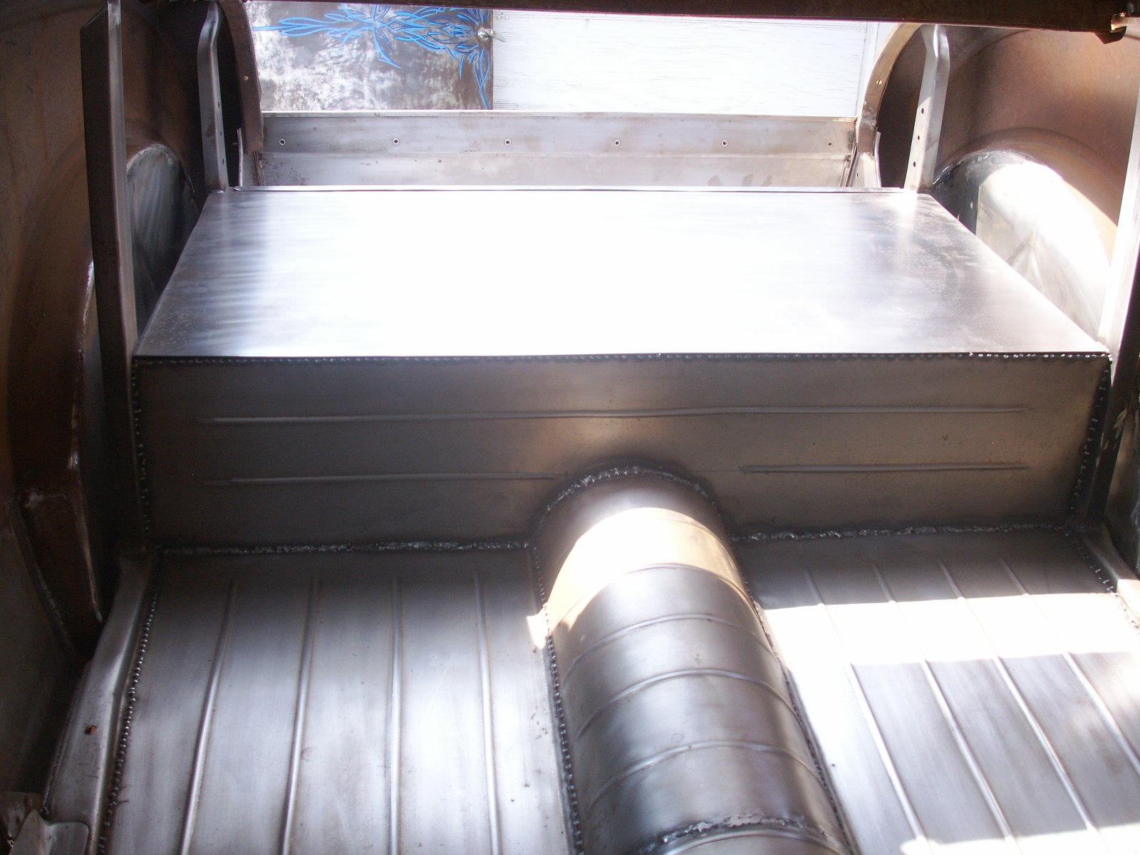

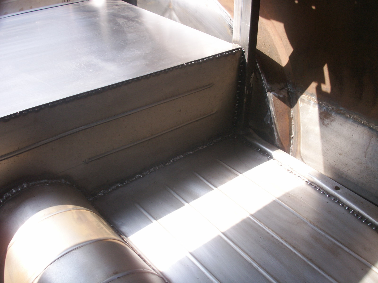

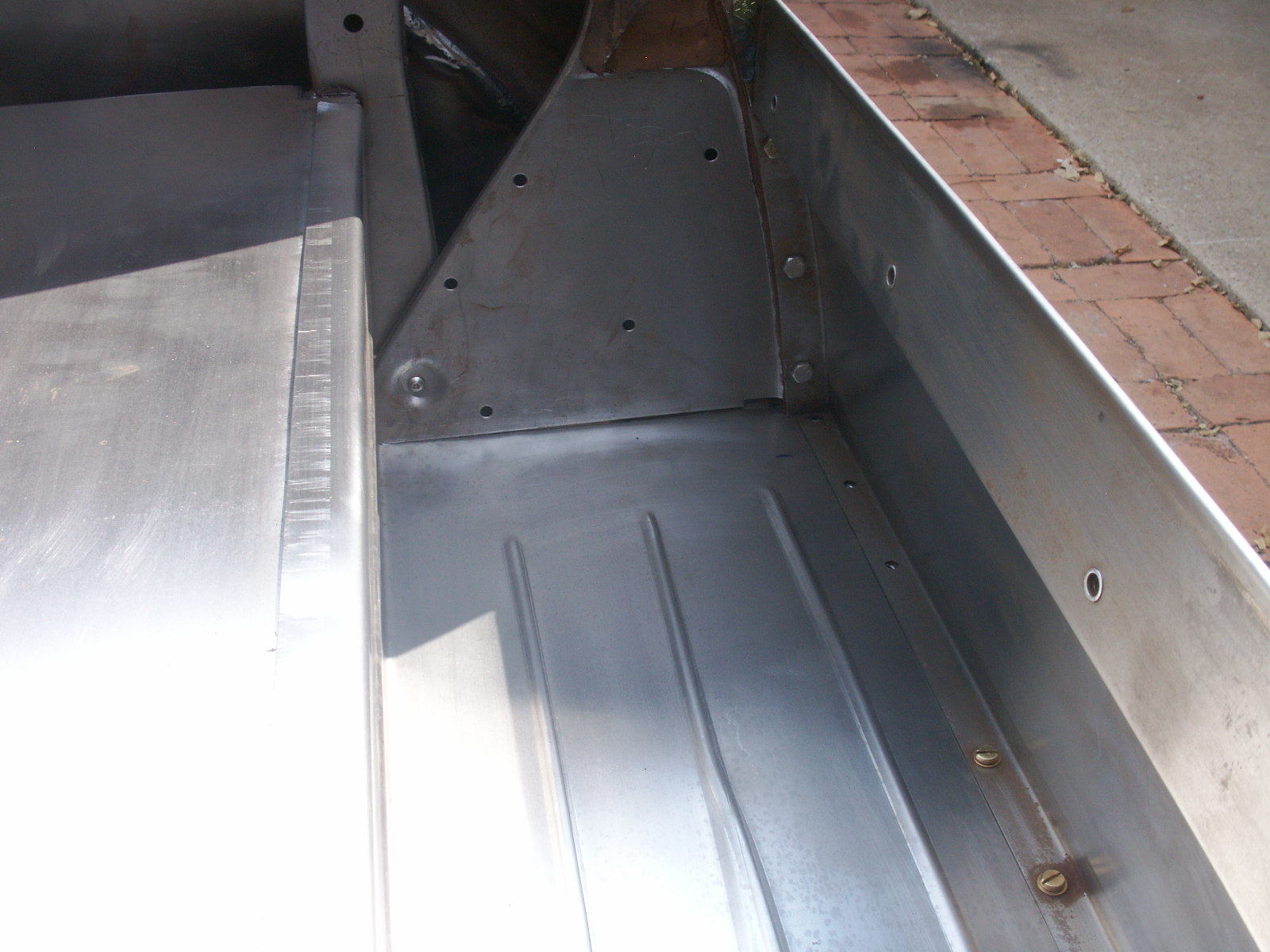

    Matt, Rocky and Jay came over and we broke out the sheetmetal brake and the bead roller and got the rest of the trunk laid in.
    You can see some of the beads are not quite as nicely done as one would like. I could have remade the panel, but the truth is after the seats, fuel tank, battery box ect. are installed these flaws will be obscured for the most part.

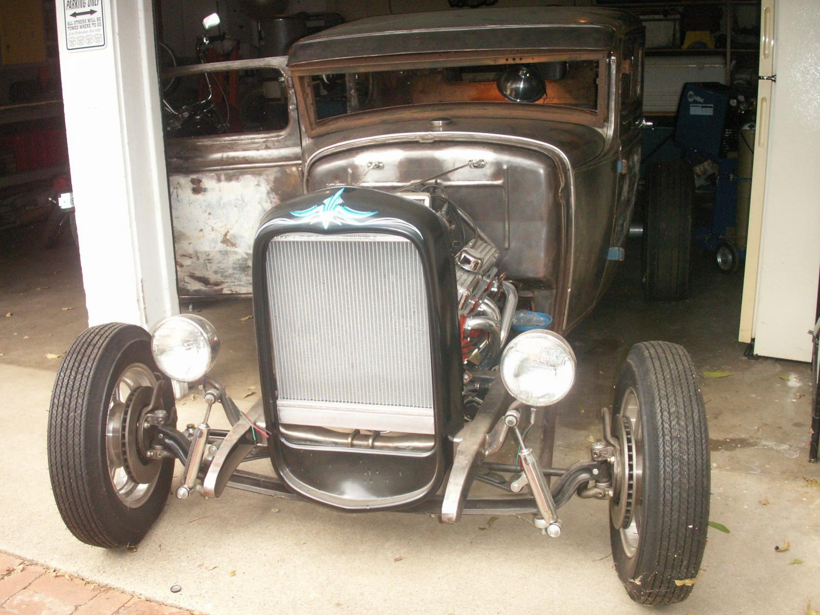

    I also traded in the stock exhaust manifolds for a great set of long tube headers. They barely clear stearing, but.....they do. Also got the brake pedal set up, as well as the accelerator pedal, and final fitment of the steering column.

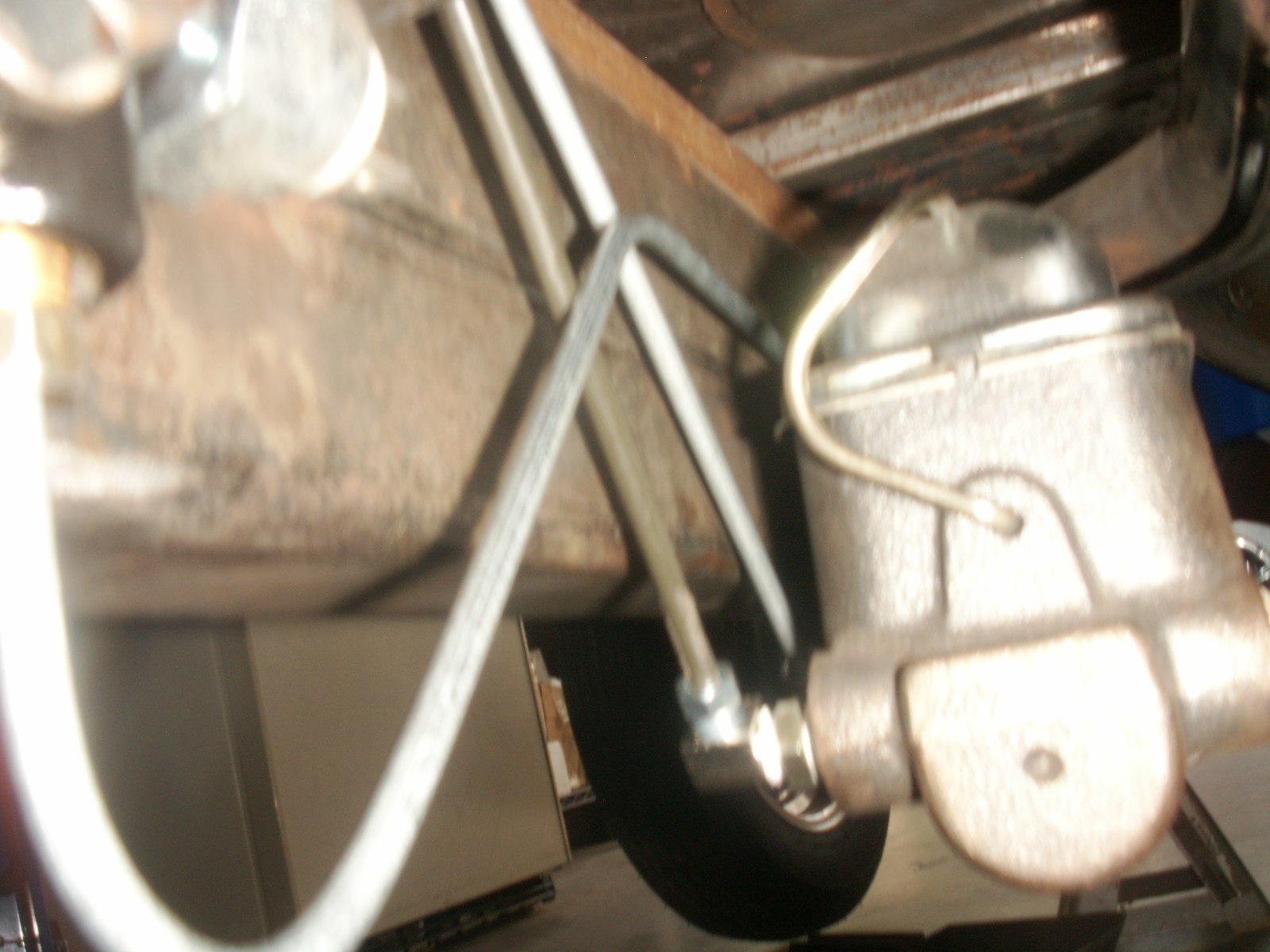

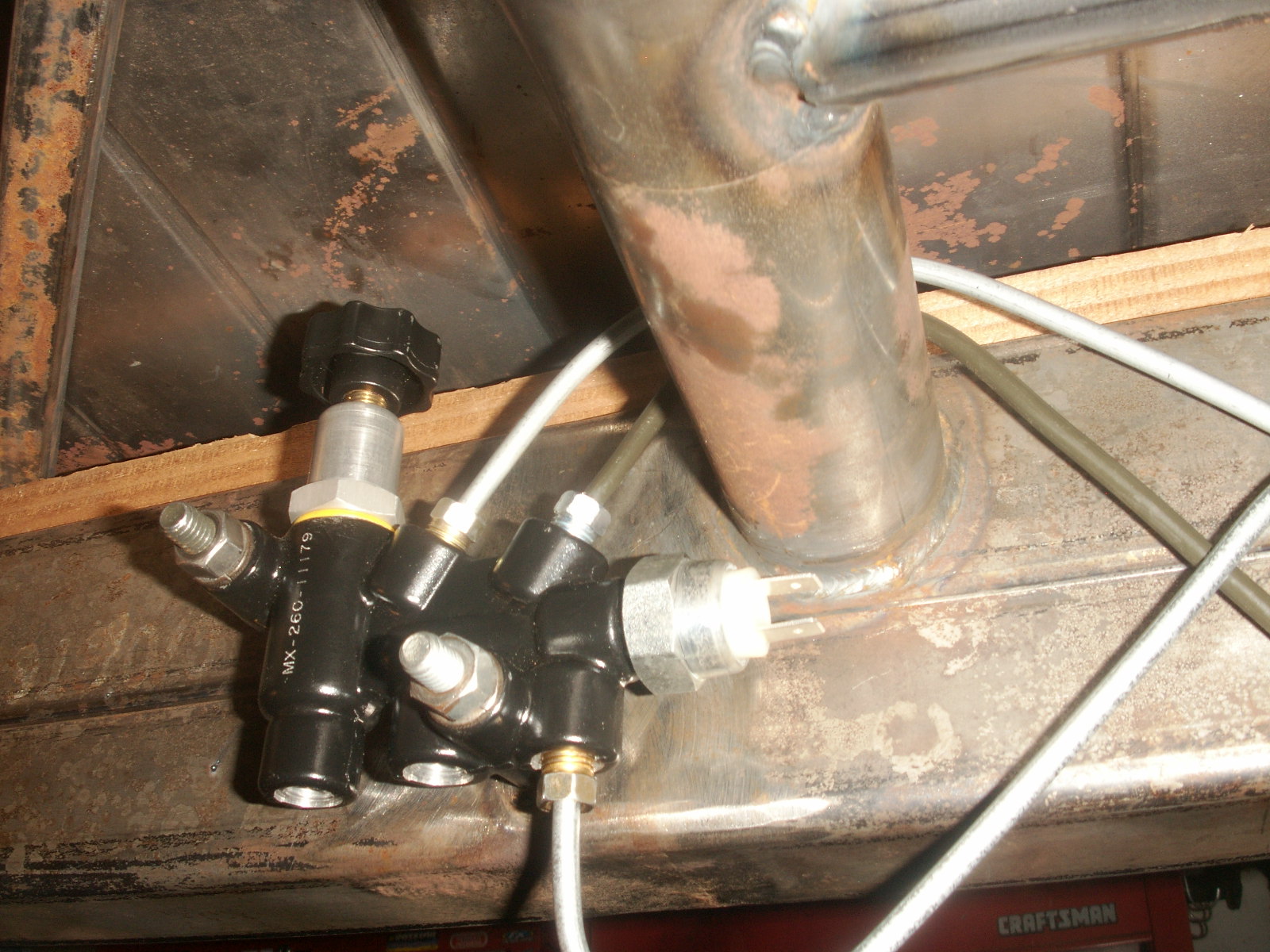

    Got a little more worked out today. I am using this trick little wilwood piece. It is an adjustable proprtioning valve with a built in brake light pressure switch. I mounted it inside the frame rails and started routing the brake lines. Looks complicated but is actually realatively straight forward and should work fine.
