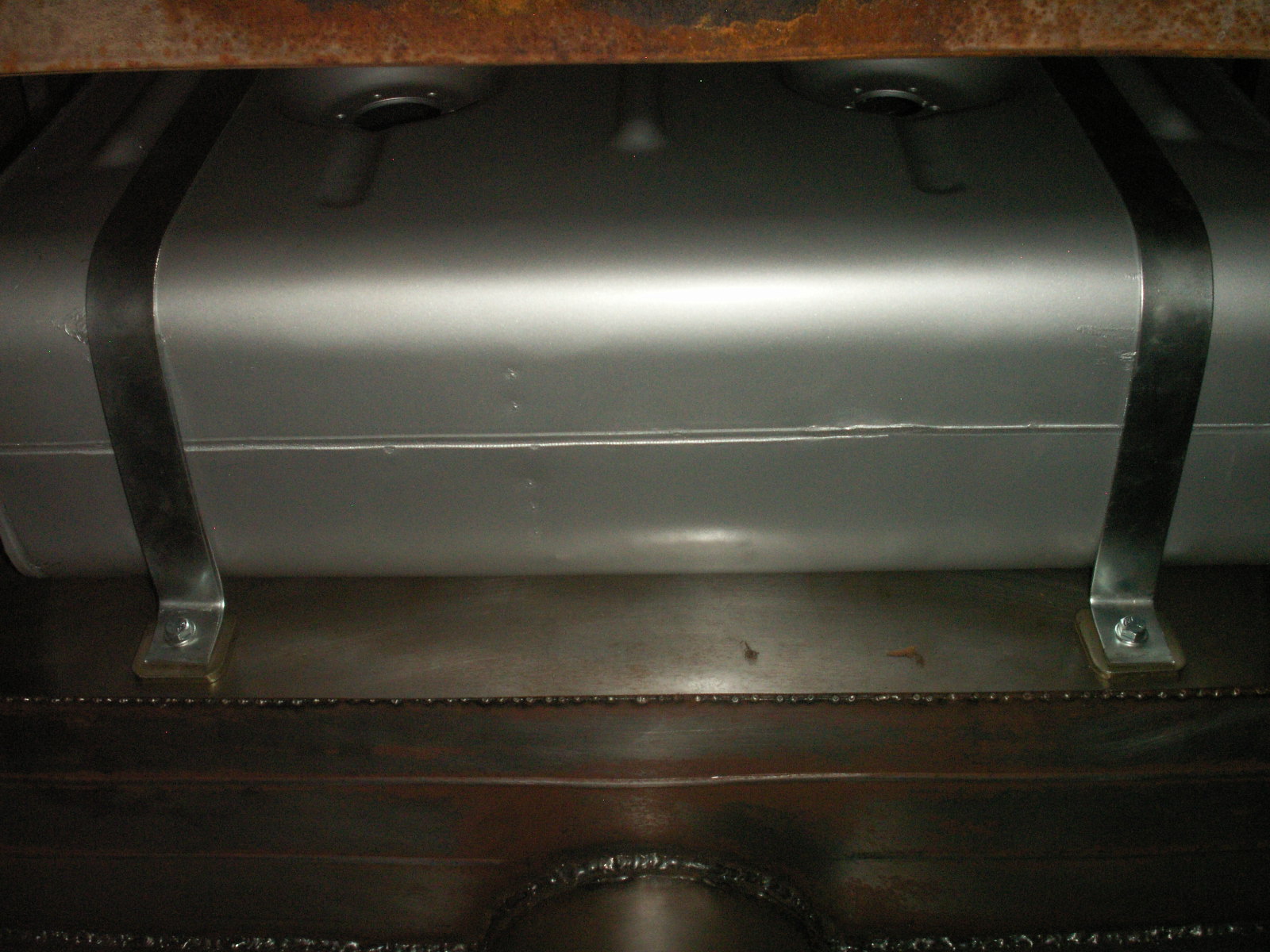

    Been a while since I have posted on the Coupe. Partly because I have been away, and partly because I have been on other stuff. But.......I am back on it with a vengance.
    I ordered a tank from www.tanksinc.com. I got the 16gal. universal tank. It ate up most of my trunk. I could have went smaller and made a little room in the trunk, but I think I will be happier this way.
    So I used some tabs under the floor in the trunk to mount to. Then located the cooresponding holes in the floor. Bent the hold down straps and cinched her down. Looks pretty good.
    I am going to run aluminum fuel line with some cheesey anodized AN fittings. I hope they don't look to out of place. I guess I can paint them if they do.

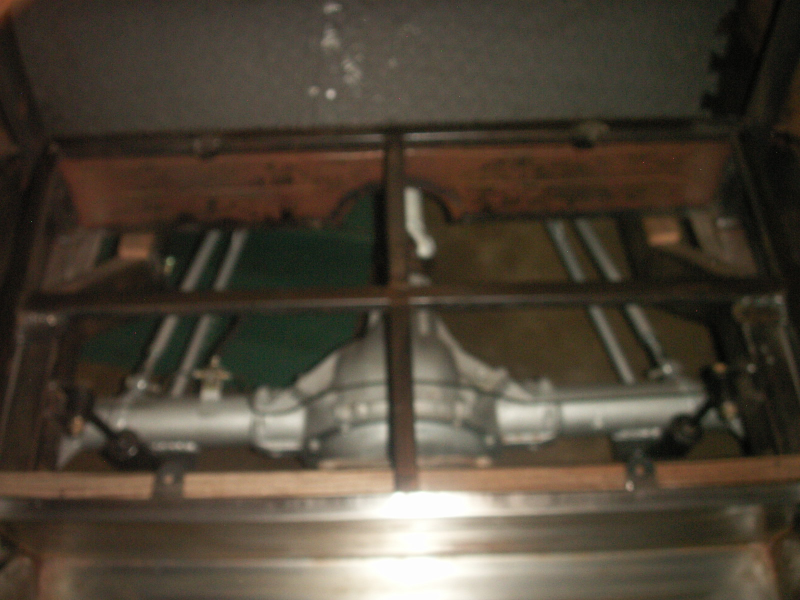

    I am not all that happy with the ladder bars thus far, as there is no room for anything else underthere. Exhaust is going to be a real pain. But I understand they work well for a good hard launch. We will see. If I have any issues I will first go to coil overs. Then move the ladder bars to parallel, and add a watts link.
