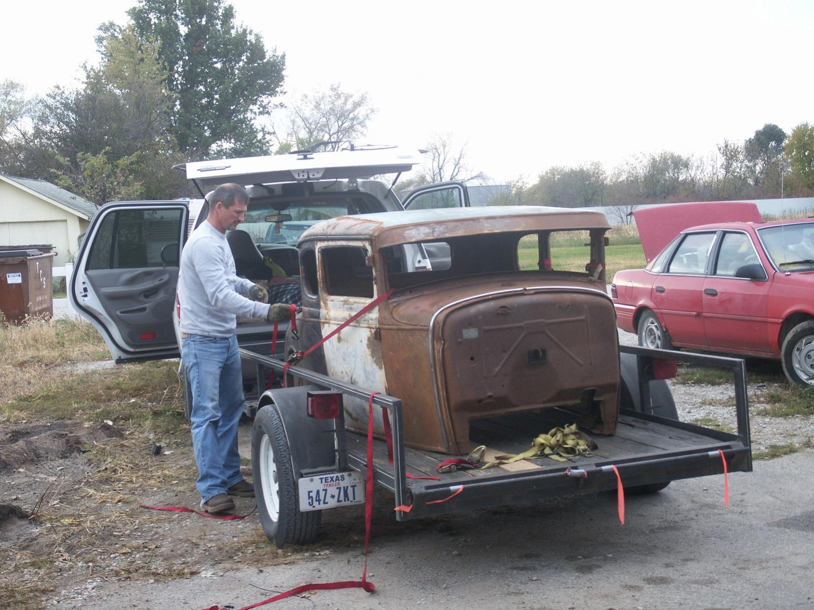

    Had a great weekend. Drove from DFW to a small township near Red Oak Iowa.
    Cal the guy I bought the Coupe from has a little shop there out in the middle of no freaking where! (see the first two pics)
    The last few miles were down a dirt road though a corn field.
    Picked up the coupe, it was rougher than I had hoped but are'nt they always, and headed south to Kansas City.
    Stopped at the Westin downtown KC where the valet let me leave the rig up front in the drive between the Limos. It was a hoot to see that heap parked with all the bling.
    They hooked us up with a killer corner suite because I am Military. We went out on the down and had a great nite.
    The next day we headed home to Texas. (third pic)
    Today I started building a body cart so I can get it off the trailer. Still not sure how to mount it but I think I can manage something. (last few pics)
