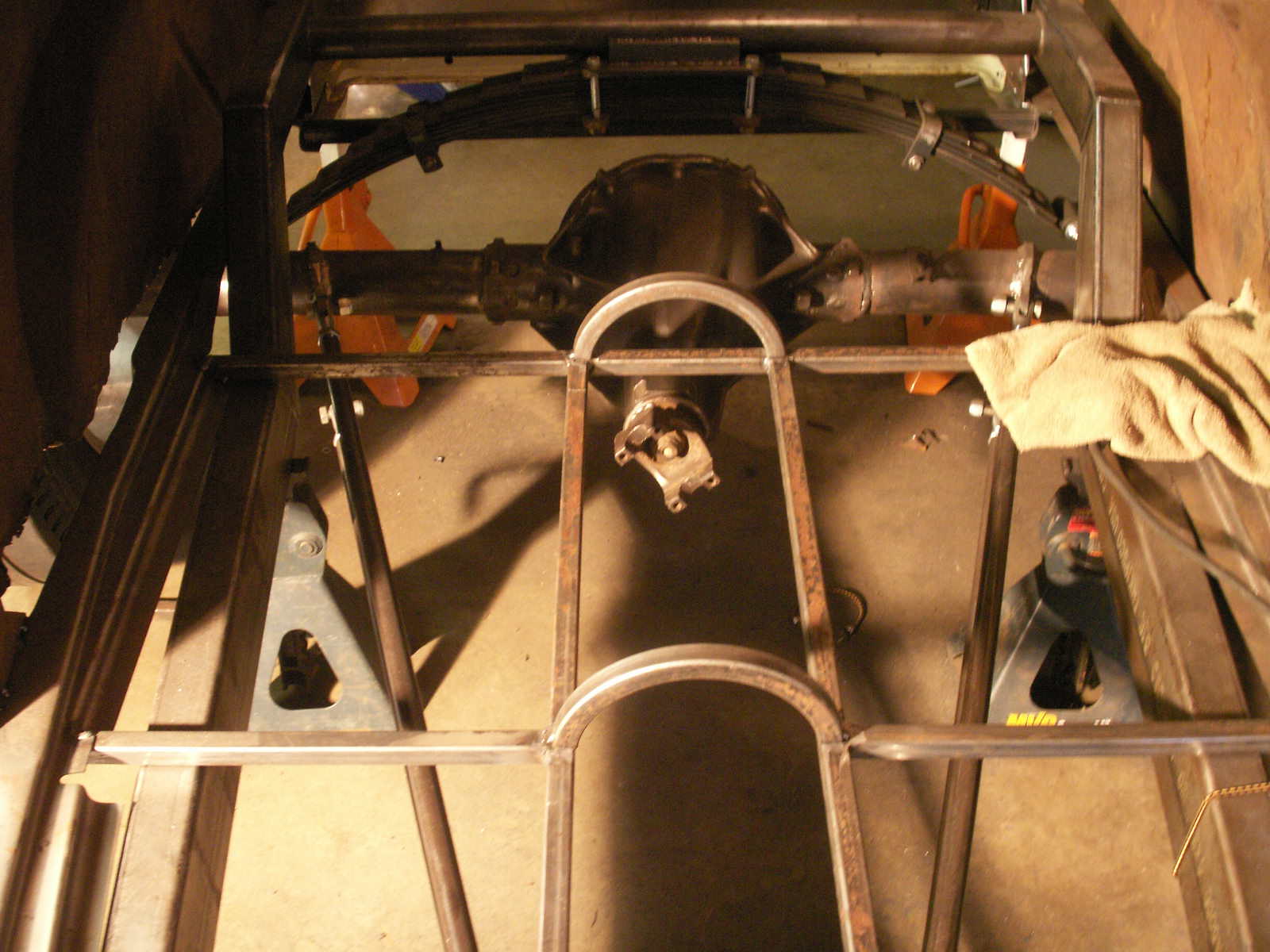

    Rob,watch for clearance at the bottom of the rear Z area floor/ladder bar.
    I little pocket (notch)for clearance will be needed.
    Looking good.
    (I bet you could lower the whole tunnel a couple inches..)
    Ring me anytime.eriC

    Rob! Lookin' good man!
    You mentioned that the U-bends would double as drive shaft protection. If that's your intentions I would beef them up quite a bit. Those will get driven right up through your floor before that will happen unless you're going to make the floor out of 10-gage steel. You could also start them smaller towards the front as well. The rear of the drive shaft is where the most movement will be seen when the suspension articulates/travels.

    You guys make some salient points regarding the construction of the tunnel.
    While I allowed for enough room for some narrow seats, I now realize that a little redo now will allow me more seat and interior choices down the road. The width of the loops is out of my control as that is as narrow as I can get with my bender. But I can lower them. I originally decided to use the same height tunnel all the way back to make it easier to form the floor. I have decided to step it down though. I can bring the front down some as well. THe front came down 2" and the middle and rear came down 3".
    While this will not give me any more width, it will lower it such that the seat riser will bring the botom of the seat to a level above the tunnel allowing an overlap and thus a wider seat.
    I have cut it very close at the front, but there should be no movement at the trans yoke so as long as it clears with a 1/2 inch or so I guess I will be ok.
    Check out the improved tunnel.
    The first pic is what I cut off the loops, followed by shots of the new tunnel installed, and finally what the seat height looks like with the bottom of the seat being just above the top of the tunnel. (I am 6' for reference)
    This also does not account for any lean back that I may put into the seats. I should have 6-8" of headroom.

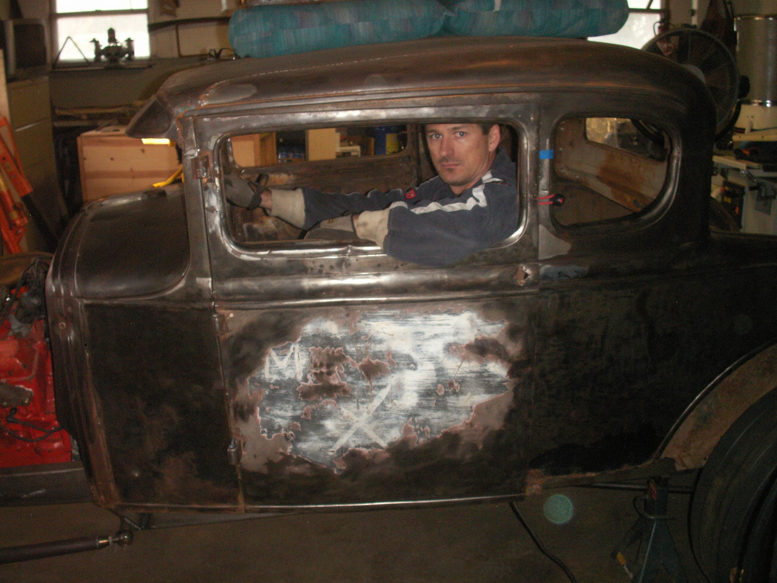

    P.S. Got a question for you guys. I was told the car was an old race car. I really did not give that much concideration until I began taking off the paint and some symbols on the door caught my interest (see post #161). Anyone know what the significance is? THe seller thought it was a stock car.

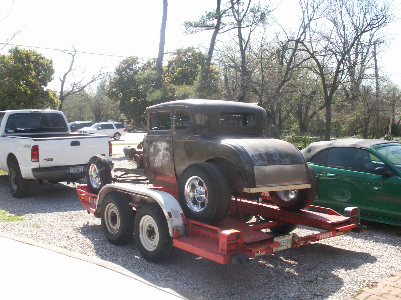

    before I could settle in and install them, I got a PM from Tim Young. He has been following the build and offered his metal working services. By offer I mean for a fee naturally.
    So I lamented for a bit over whether I really wanted to put down the cash to have an expert metal man do some work on the coupe. The body is rough and Tim and I agree that it would be extremely expensive to make this body perfect. However i need to have some rehab to get it useable, and I wanted to give tim a shot so for the first time since I bought the body it was rolled out into the light of day.
    Check out the pics of the roll out, then the arrival at www.irrationalmetalworks.com , and finally the empty hole in the garage.
    The coupe's absence will give me an opportunity to get some real work done on the racecar.
