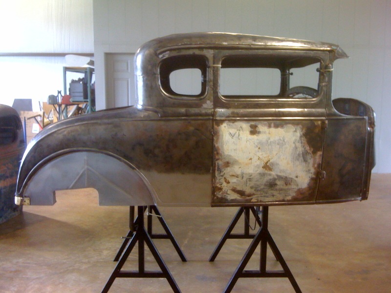

    I just got a few pics of the coupe's progress from Tim at irrational metalworks. As you all know I took it to his shop for a little bit of metal work that was beyond my present skill set.
    It does not look radically different than it did before, but I ***ure you alot of work has been done that makes alot of difference in the end.
    Here he has completed the rear quarter patches and the wheelwells.
    Next is the subrail notches to clear the rear axle and spring.

    Oh and you can also see where the firewall was patched. It was pulled out and torn where the grill shell rods attach, as they typically are.

    THanks Mark. I am really happy with how the car sits. Not too high, and not too low. THe angle in the last few pics is weird but the wheelwell in the body follows the contour of the rear tire really nicely.

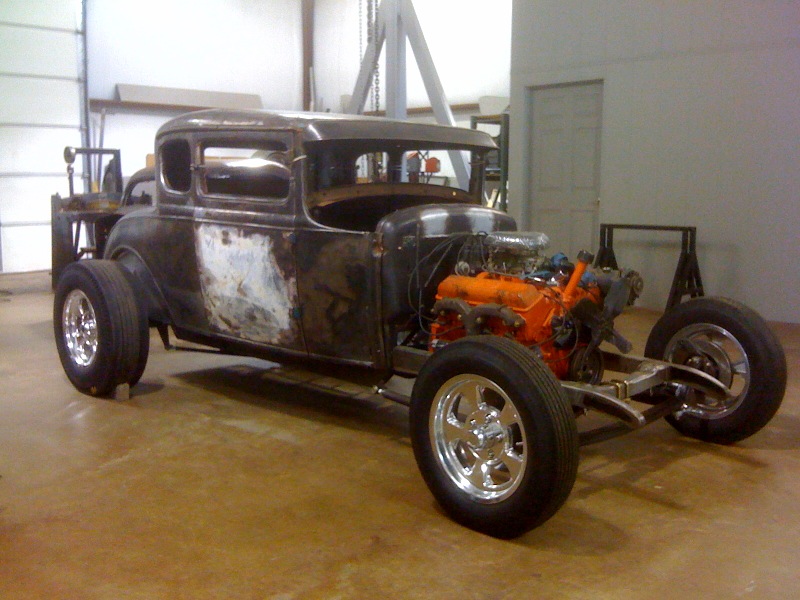

    Both wheelwells are notched and the body is back on the frame. The rear tire is now perfectly aligned in the wheelwell.
    Thanks Tim!

    I brought the coupe back home today. It is nice to have it back in the garage. Tim really helped with some of the more complex metalwork and now I can get back to the build.
    Here is a side by side of when I picked it up last year and as it sits today.
