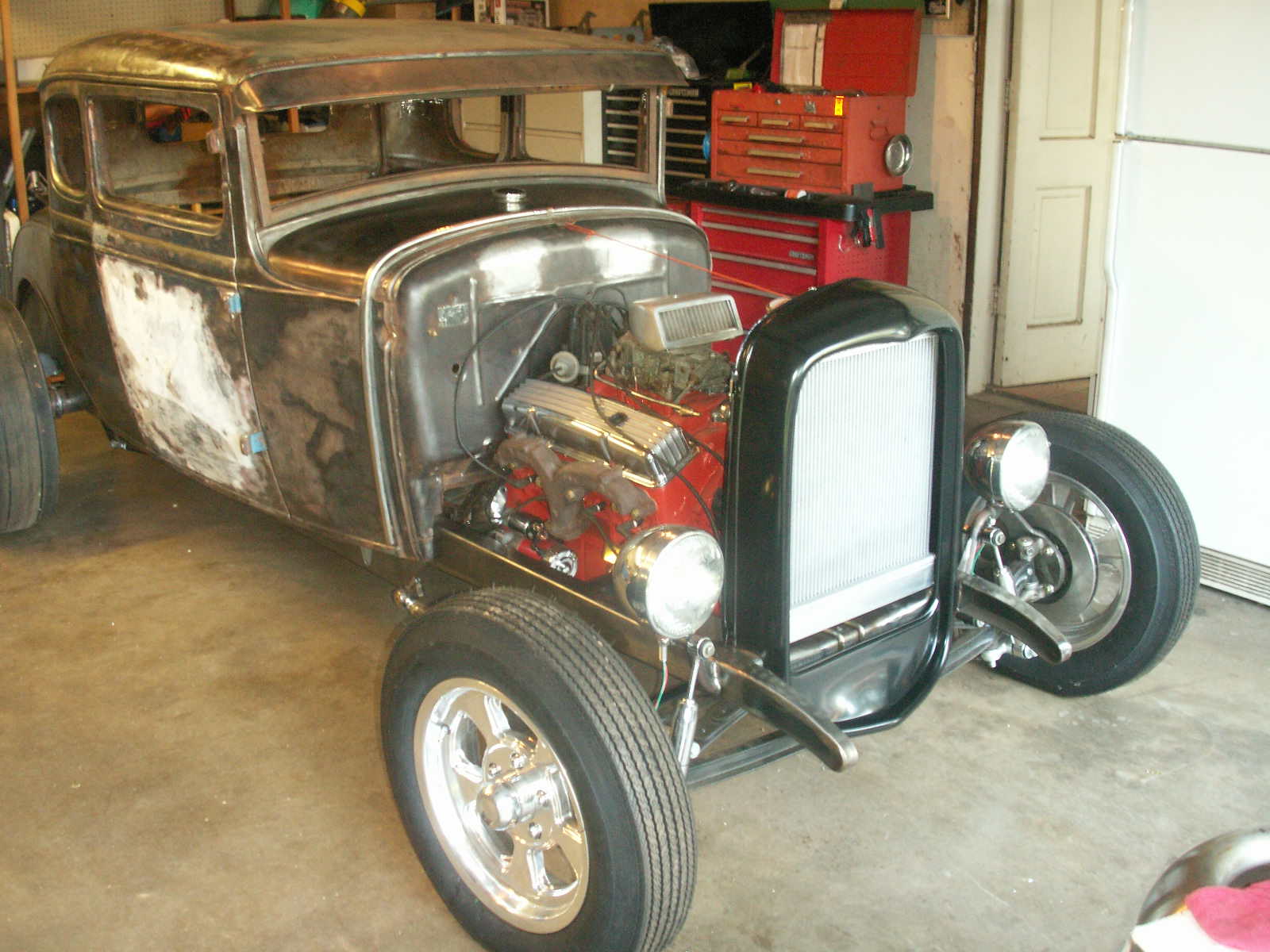

    Quick update. I put the bones back on and the caster is right at 7.5-8 degrees. They really look cool swept up like that too. Next item will be too install the headlight/shock mounts and get some front shocks on there. Then the same on the rear.

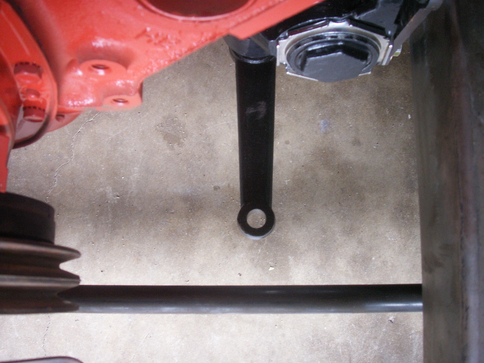

    Great thread. I've been working through alot of the same issues. your coupe is looking great. I don't know if you've already done it but I would gusset the vega box mount where it hangs down below the frame. a little triangle made of 1/4" will add alot of strength and possibly keep the box from breaking away from the frame. Keep up the good work.

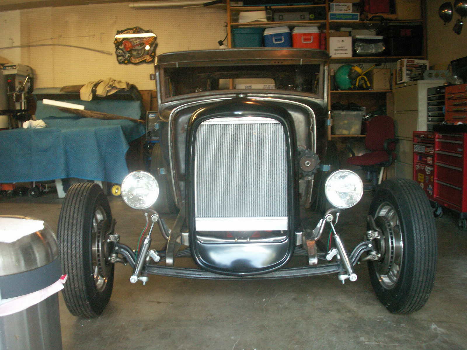

    Hey Rob, those shock mounts look great, Did you weld them in place or are they bolted on? can't see it in the picture. I'm using the same ones, mine are bolted on.

    These are weld ons from pete & jakes. No provision for bolting. I could have welded on a plate to then bolt them on but that seemed redundant.
    As for the gusset under the frame at the steering box, no I did not have plans to put one there, but I am going to now!!

    After getting the radiator set, I broke into the Vintique grill shell www.vintiqueinc.com. This piece was a different story. It was one of the more expensive shells out there but I have been told they are they best. I have to say I am impressed. The fit and finish is perfect.
    I had to decide whether to channel a full size grill, or chop it down to fit the hood line right. I mocked it up and decided to channel it. THe bottom of the shell ended up being just above the top of the axle. it looks perfect!!
    I am super stoked. I sat and stared at it for 45 minutes. Seriously I just sat there and stared at it.

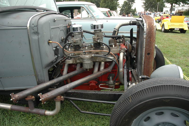

    So what I need from you guys this time is a couple of reference pics, and some measurements of the grill shell mounting rod plates on the firewall. Mine were torn out and the patches obscured the original mounting location.
    I could wing it but I would like to get as close to original as possible.

    I am also curious how you guys are getting away with running your radiators without support rods. Seems to me like the tabs would break right off with the first big pothole.
  22. pitman
    Joined: May 14, 2006
    Posts: 5,148
    pitman
    Let's see if Rebecca's image will help you here. N1gzd is her handle, a fantastic photographer BTW! Search her Ty-rod's series, there are many detailed engine shots as you go thru the later pages.
  23. Why didn't you just cut a wedge out of the top?
  24. Do you have an original radiator to mount the rods on and check the spread at the rear? Not trying to crack wise, that is how I placed them on my truck. Just a thought...

    Hope this pic helps Rob.

    Thanks for the reference pics and comments. I think I can get pretty close.
    THe radiator has the tab for the rods, but no holes or slots drilled. Gonna have to wing it.
    Also, by engine bay is longer than stock so i am using 32 support rods. THey are a few inches longer.
    I also thought about coming straight back from the firewall and then bending the rods in front of the engine to meet at the radiator. Reason being that I think I am gonna run two fours and it will gimme some space.

    Rob, I too think those headlight stands are *****in'. 56 NoBrakes is using them on the A bone we are building. As for the shell, I would recommend channeling the shell over the frame which is what we did. We channeled it 3" and then filled the gap between the lower edge and the bottom of the radiator. See for yourself. BTW, please don't anyone flame the mockup tires.
