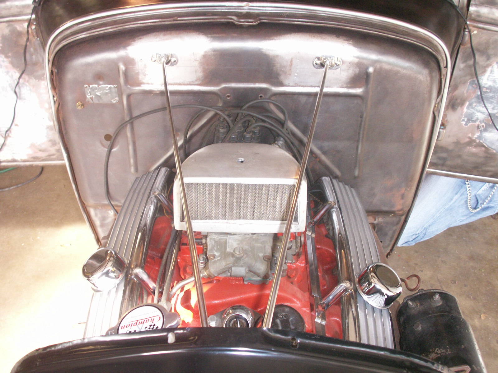

    I was able to get the radiator supports installed. I thik they look pretty good. It really tied the front end together pretty good.

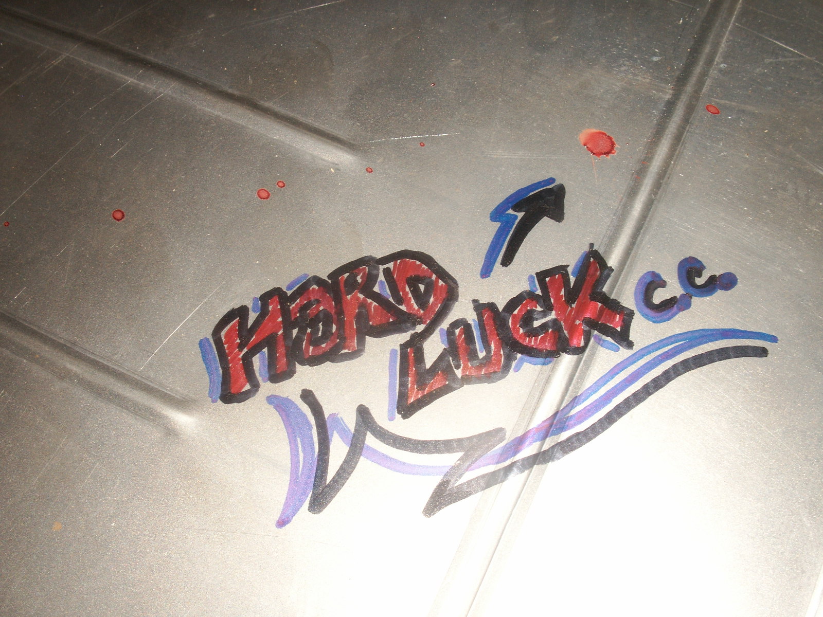

    I borrowed a sheetmetal break, and a bead roller from my buddy Jay (Jay28), and Brian (Bass) hooked me up with the sheetmetal connection. Got in the garage with Matt and Rocky and we go after the floors in the coupe. I cut and shaped the tunnel first using 18ga steel. Rolled in a bunch of beads 3" apart, and stitched them in.
    Then I cut the floors and rolled in transverse beads in the front and longitudinal beads in the back. I welded in or should I say tacked in the passenger side while Matt worked on the tunnel welds on the drivers side. I reached over and put the grinder to the welds so we could tack in the drivers side floor when I slipped.........

    Oh yea here is Matts work.
    viva la Hardluck

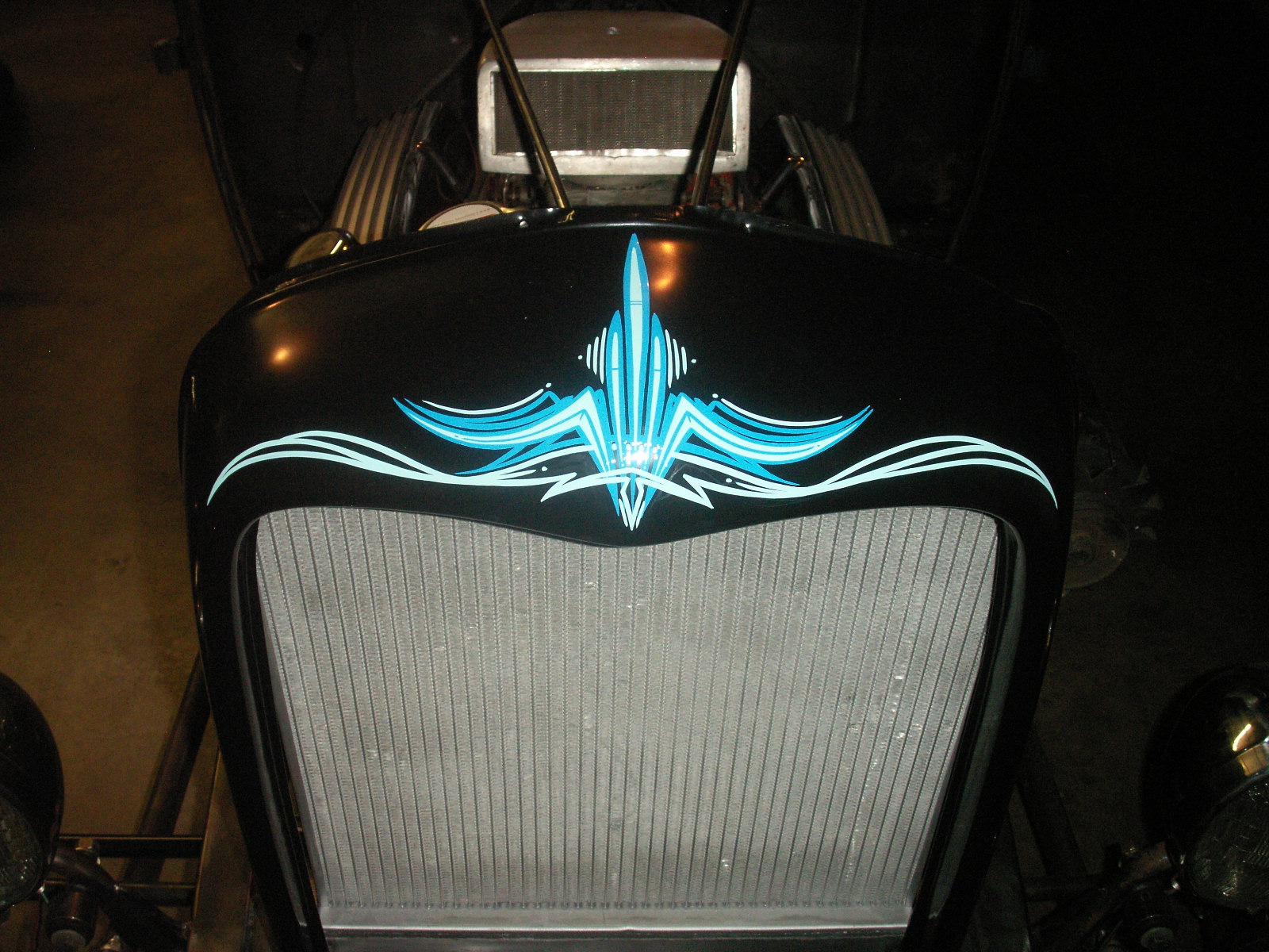

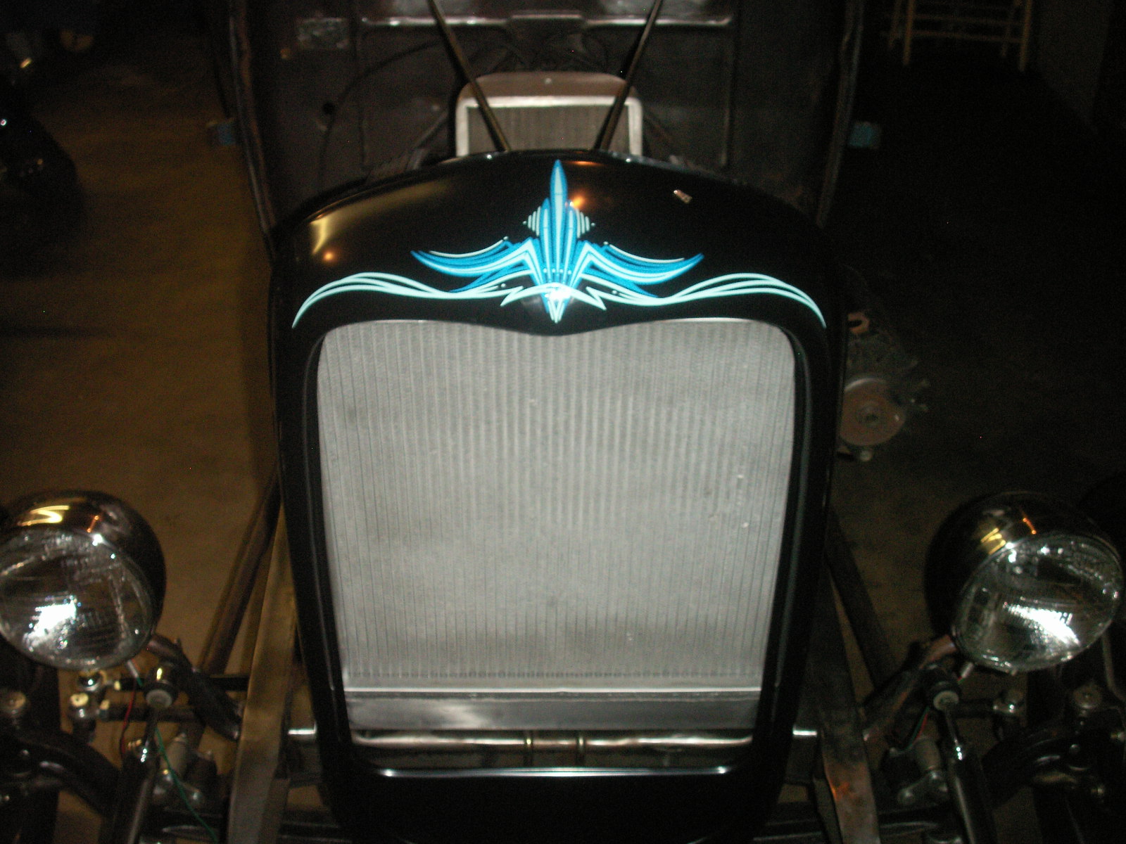

  30. Hotrob
    Joined: Mar 23, 2005
    Posts: 589
    Hotrob
    from DFW, TX
    Some cool pics of the coupe Hazmat took on his phone. He has an app for that.
