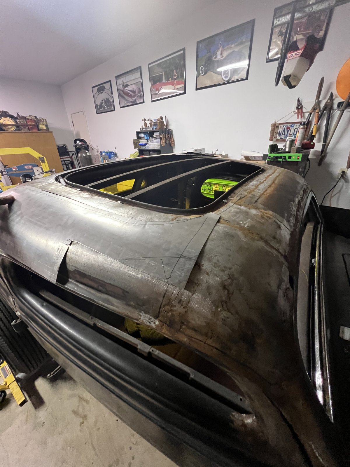

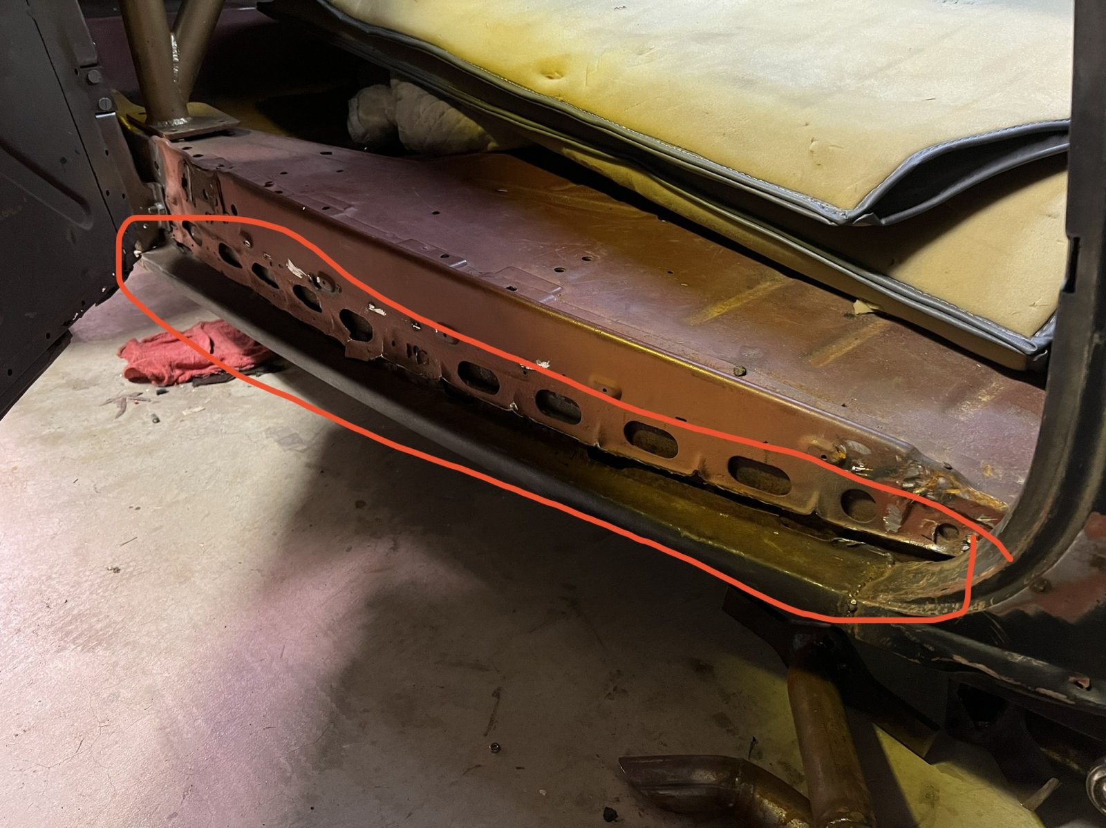

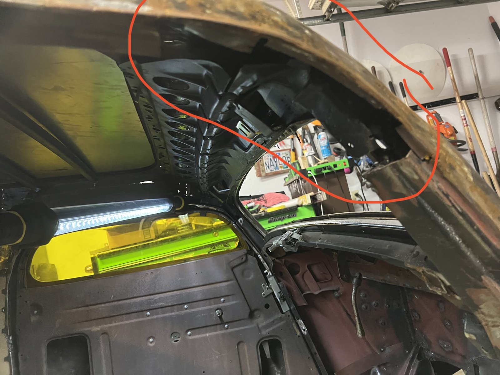

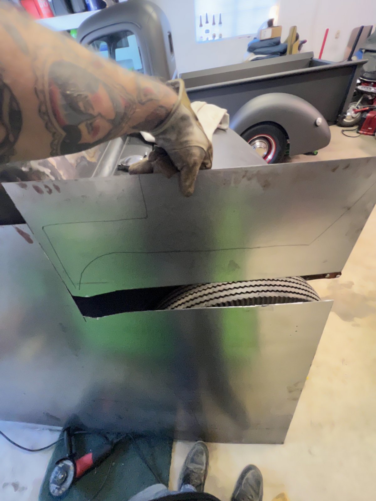

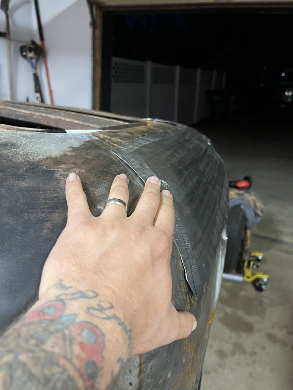

    Progress has been slow, but slow is better than none! Tonight I started marking out a few of the repairs and cut the first one out. You can see as to why I’m cutting it out to make new panels…
    09865632-FFD5-4C9C-A87D-D5473F8542B1.jpeg BD0891C1-739B-4576-99DB-F24945A13C0B.jpeg 3191D204-E00F-438D-B143-02E21A7018CA.jpeg 3B959A52-004F-4AEF-BA8B-8582A6525713.jpeg
    I’ve got to knock the dust off of the hand tools and get to making some panels now!

    I'd keep that chunk you cut out of the roof as a wall-hanger, or sell it as "modern art" (the second picture).

    Ick, nothing worse than a patch slapped over the top of a big hole like that. Shame too, some of that original sheetmetal likely could have been saved before that was done. Definitely the right choice to cut it out at this point, though.

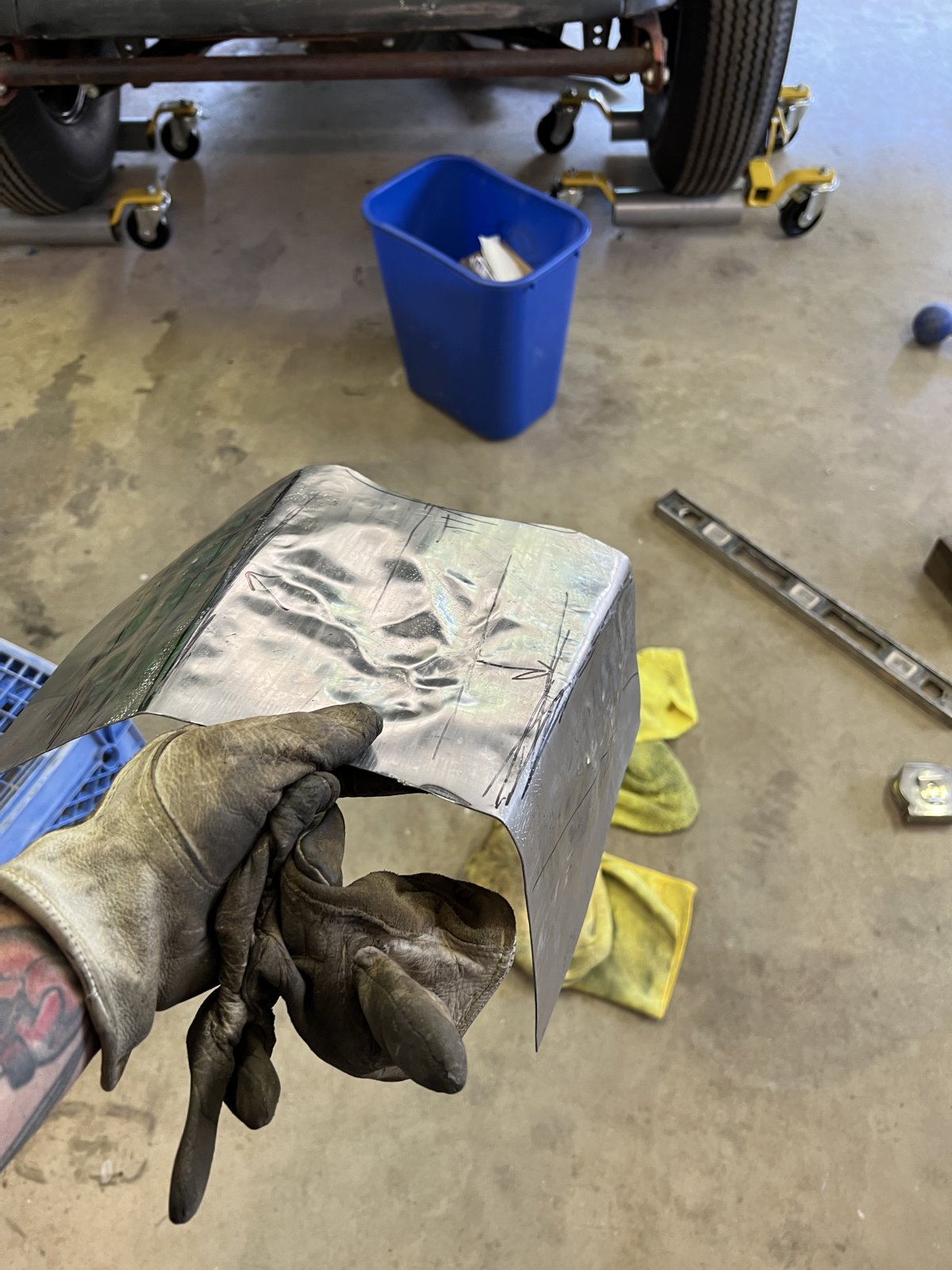

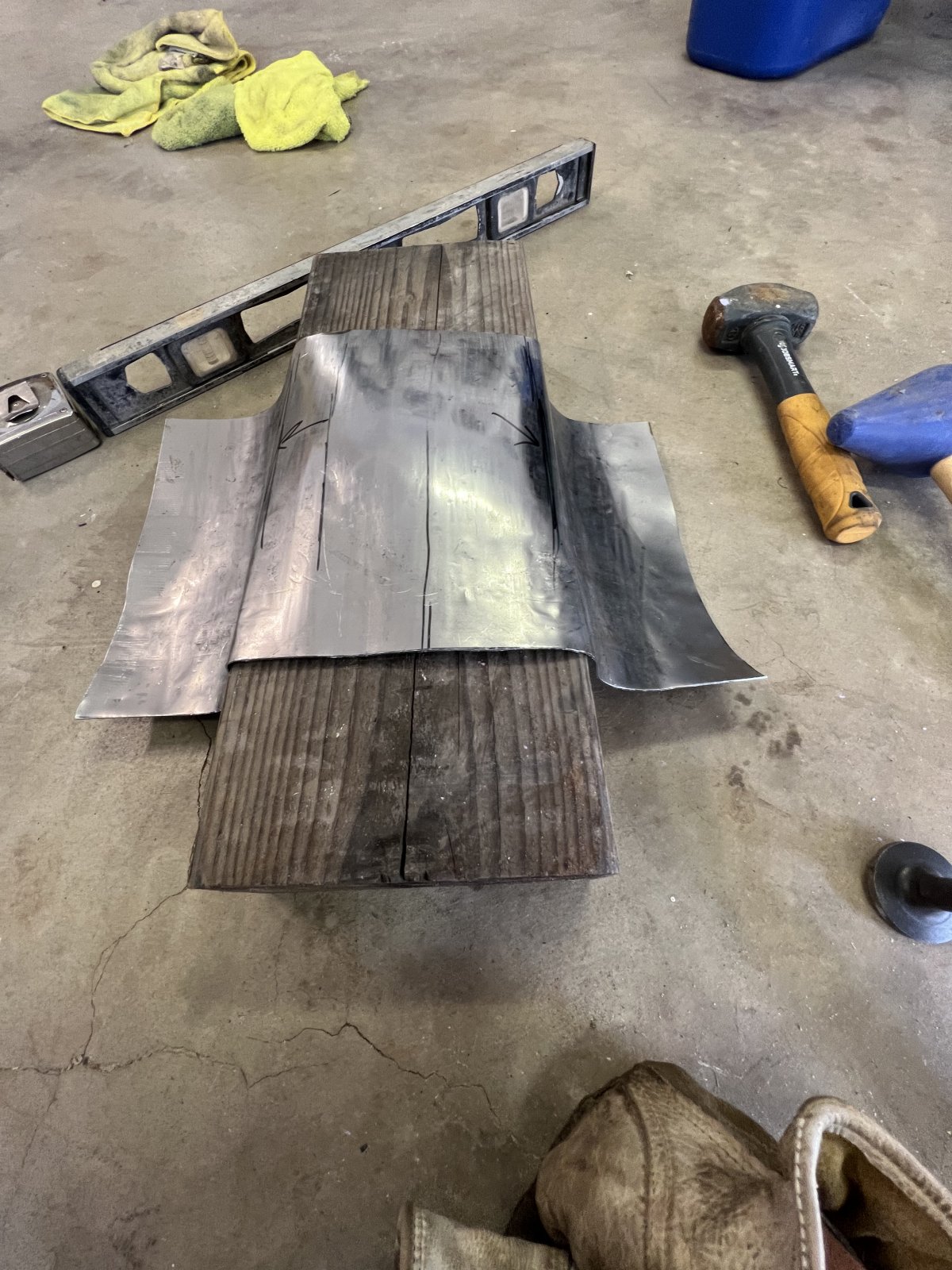

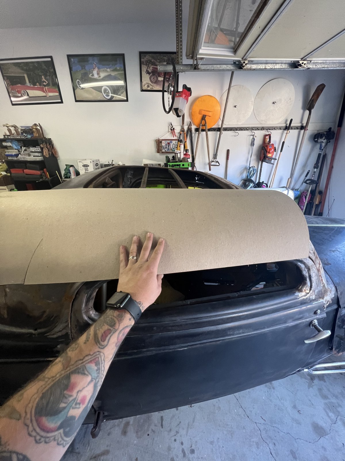

    E4C80305-1B0F-4A27-8DDB-6725376F00C7.jpeg 153401C1-1CC7-49E7-B1C5-EE8E084A74E9.jpeg 66D5CAF4-8E91-4B5B-9E88-DA55FA501C12.jpeg 427BEA6C-C217-48B6-8F30-495A336CE6F9.jpeg AEB0F3BF-AB8C-4465-9384-E9AE40A3C410.jpeg Little bit of progress tonight. I started in the replacement panel. Got a new piece of 19g cut out and started shaping it. Baby steps! D7464AF8-9818-4DFE-89C2-D21217FFCC92.jpeg

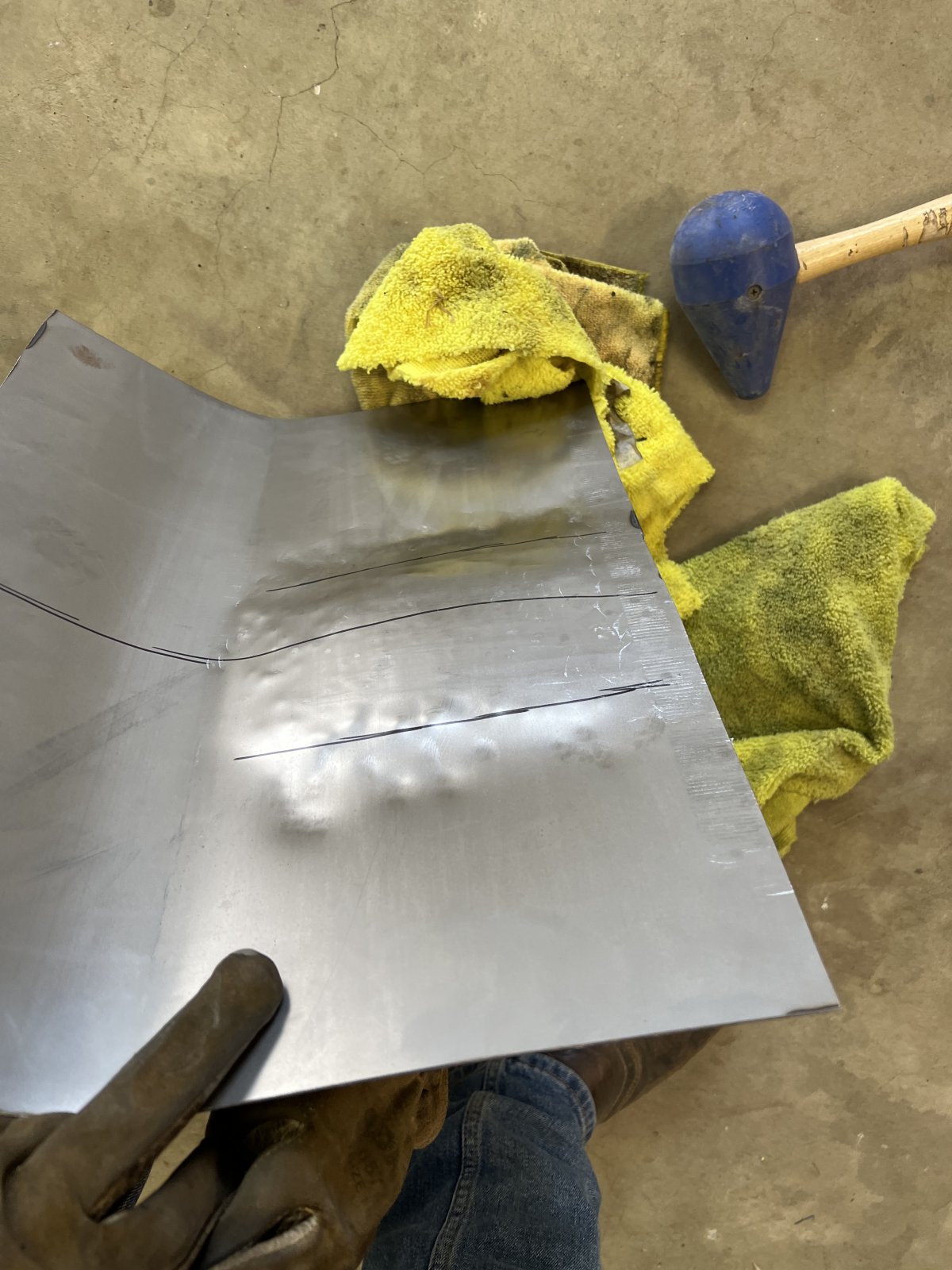

    A little more time shaping the first panel tonight. My goal is to do at least a little bit every night even if it’s 5 minutes.
    36394AB4-BADE-4D19-ADBF-FA606D97604A.jpeg 99A18AA9-3070-4655-862A-95F5CB87583E.jpeg

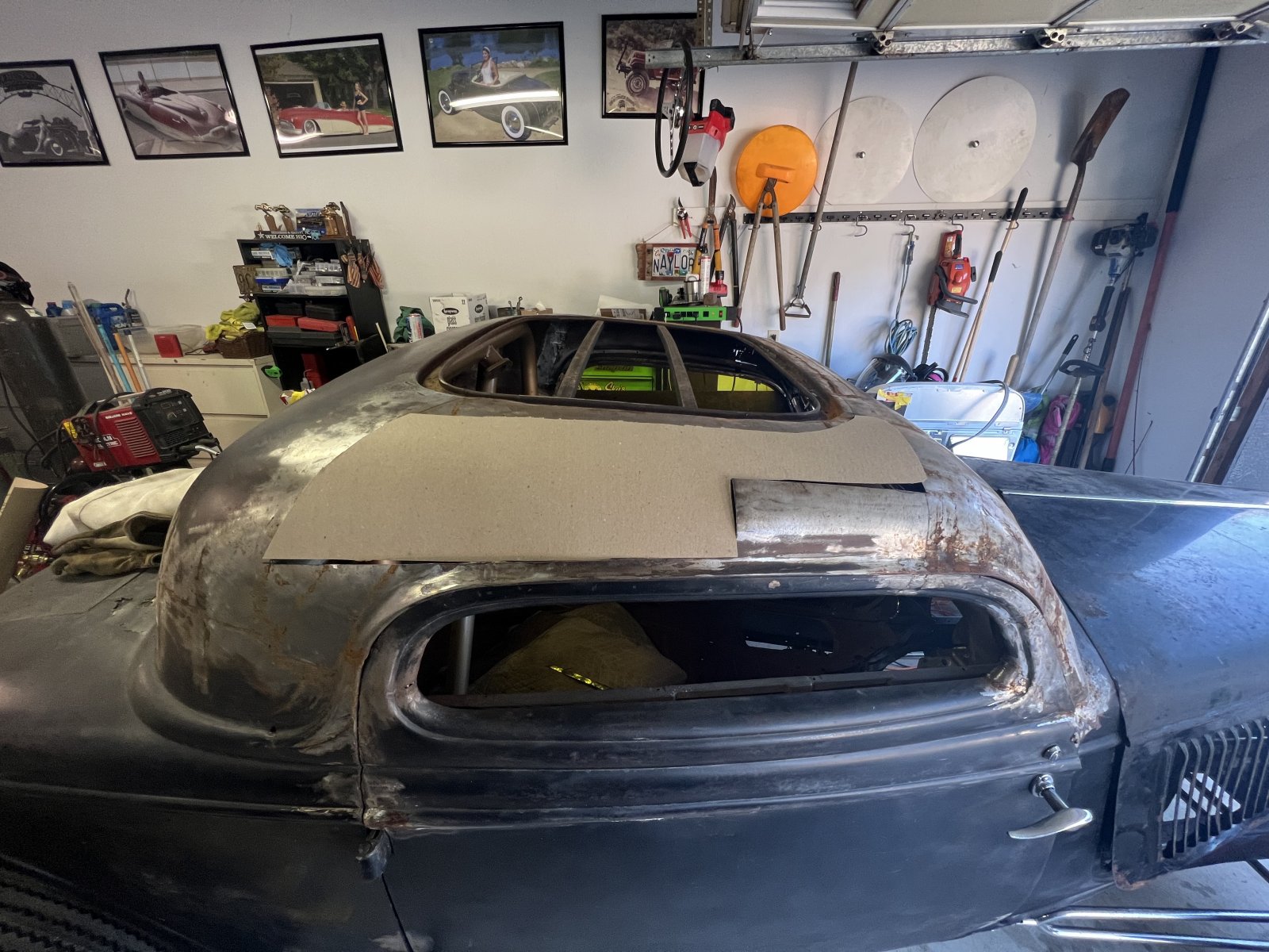

  25. angelbaby65
    Joined: Dec 26, 2011
    Posts: 105
    angelbaby65

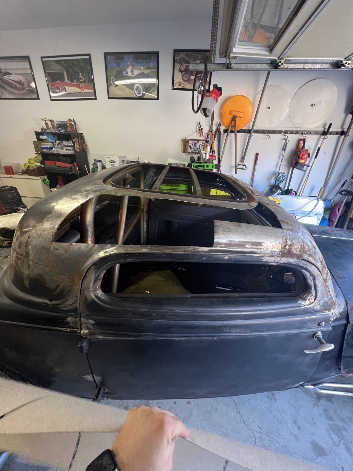

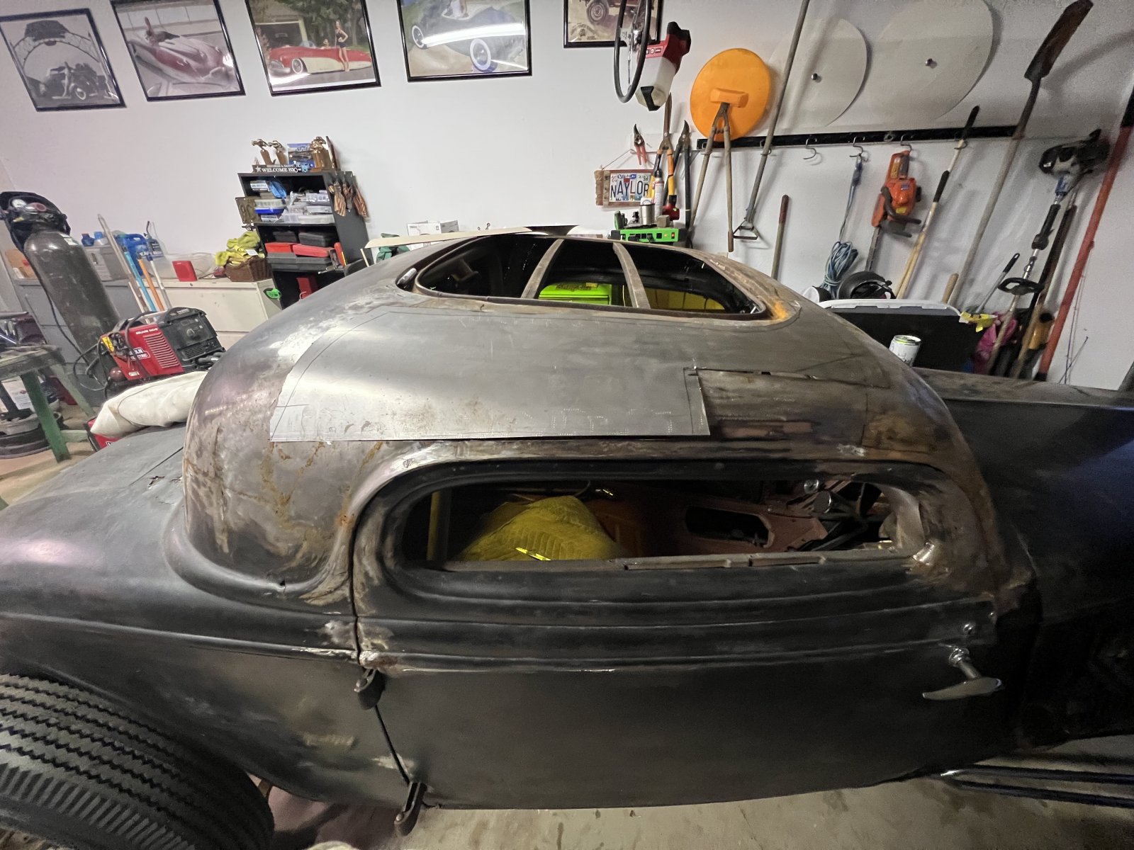

    5E835870-B9E8-4DE2-B635-A9A2C7A53439.jpeg File—-> shape—-> fit repeat… almost ready to weld in. 631010AE-2BF0-4397-B73C-495A65EDC16A.jpeg

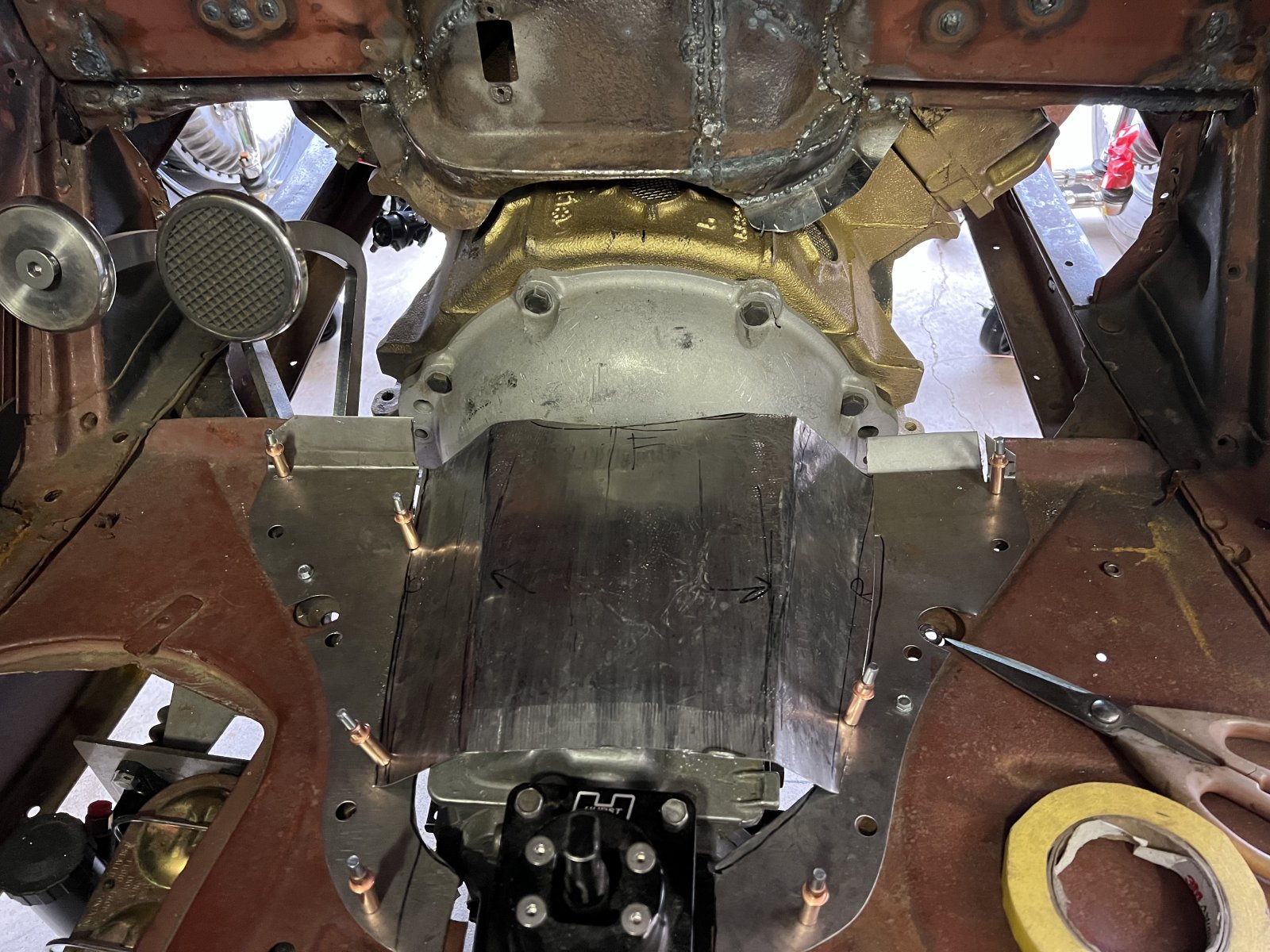

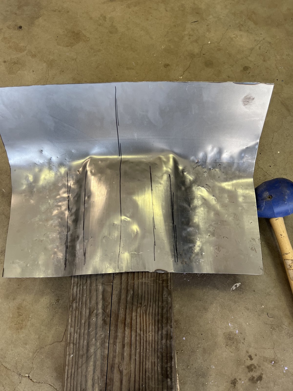

  26. angelbaby65
    Posts: 105
    angelbaby65

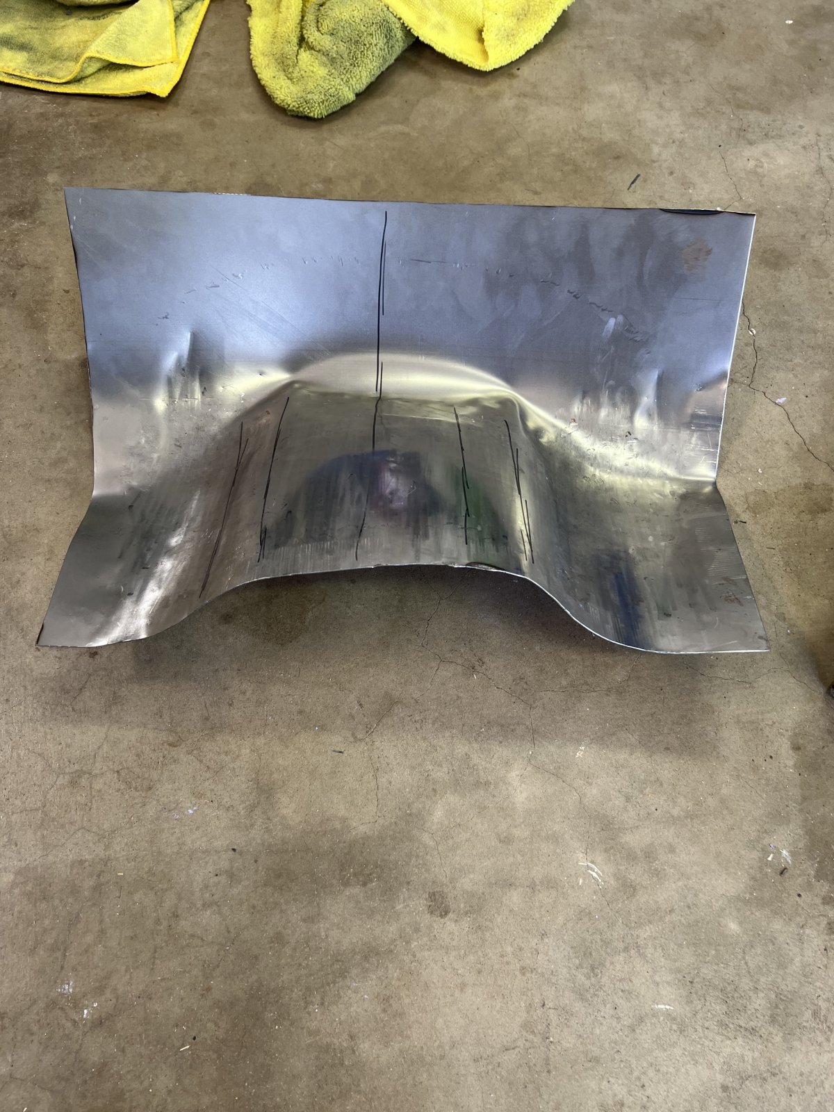

    CC24EFB9-8D45-4CD2-B7BB-0D461AD92728.jpeg Started to weld the roof patch in! Also a little side shot for motivation! I started working on the trans tunnel too, I tried to make what I had envisioned in one shot and was quickly humbled by the metal… so it cut it shorter and will make it in a few pieces.. can’t win them all. 1548D1D6-4217-4DB0-BC4F-6E6D1B5DC562.jpeg

    6699D767-994E-40C3-8D33-1C8CB6EDAD7D.jpeg BF294B1F-BE52-414A-9162-AF8B3F97D848.jpeg 21A5DEFF-6ED3-4A3A-8530-3D8171DA75BA.jpeg D9EA4ABB-EE9A-445F-872F-135ACEF9237C.jpeg Welded in. Onto the next.
