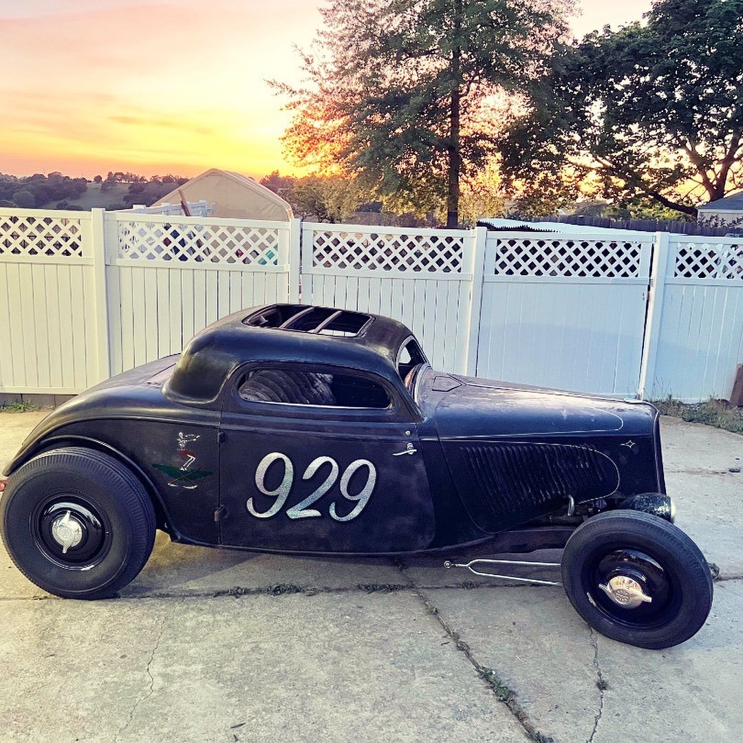

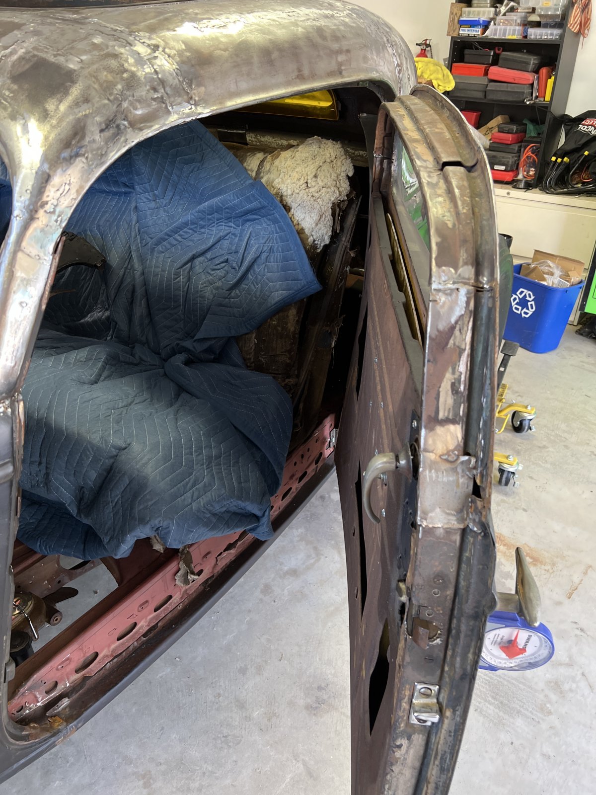

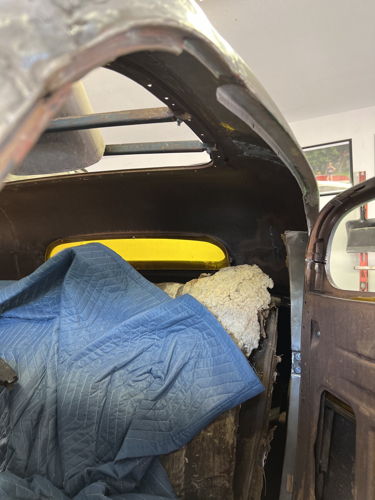

    Little more progress last night.. got the piece I made welded in.. image.jpg
    What’s your guys thoughts on metal vs wood for the door surrounds? I thought about building mine from metal instead of wood, I know that’s not traditional.. any pics of this being done out of metal?
  2. The way you can work metal, I would say, why not? Could you maybe throw a couple more wheel nuts at this project to help me sleep at night?

    Can somebody post a picture of what the door weather stripping looks like factory on a 33/34? Particular at these angles. Or even a picture of a factory car with or without rubber at these angles. Thanks!

    Weather seals were fabric and nailed onto the wood on the body. So, if you replace the wood with steel you are going to have to come up with something else

    Stock 34's had a simple lip seal that fit under the jamb strip above the door. Also a bit taller strip that fit under the door upholstery card on the bottom of the door. And as Curbspeed said, the upholstery covered windlace all around the front, top, and back of the door opening.
    A vendor like Dennis Carpenter or Drake should have pics in their catalogs.

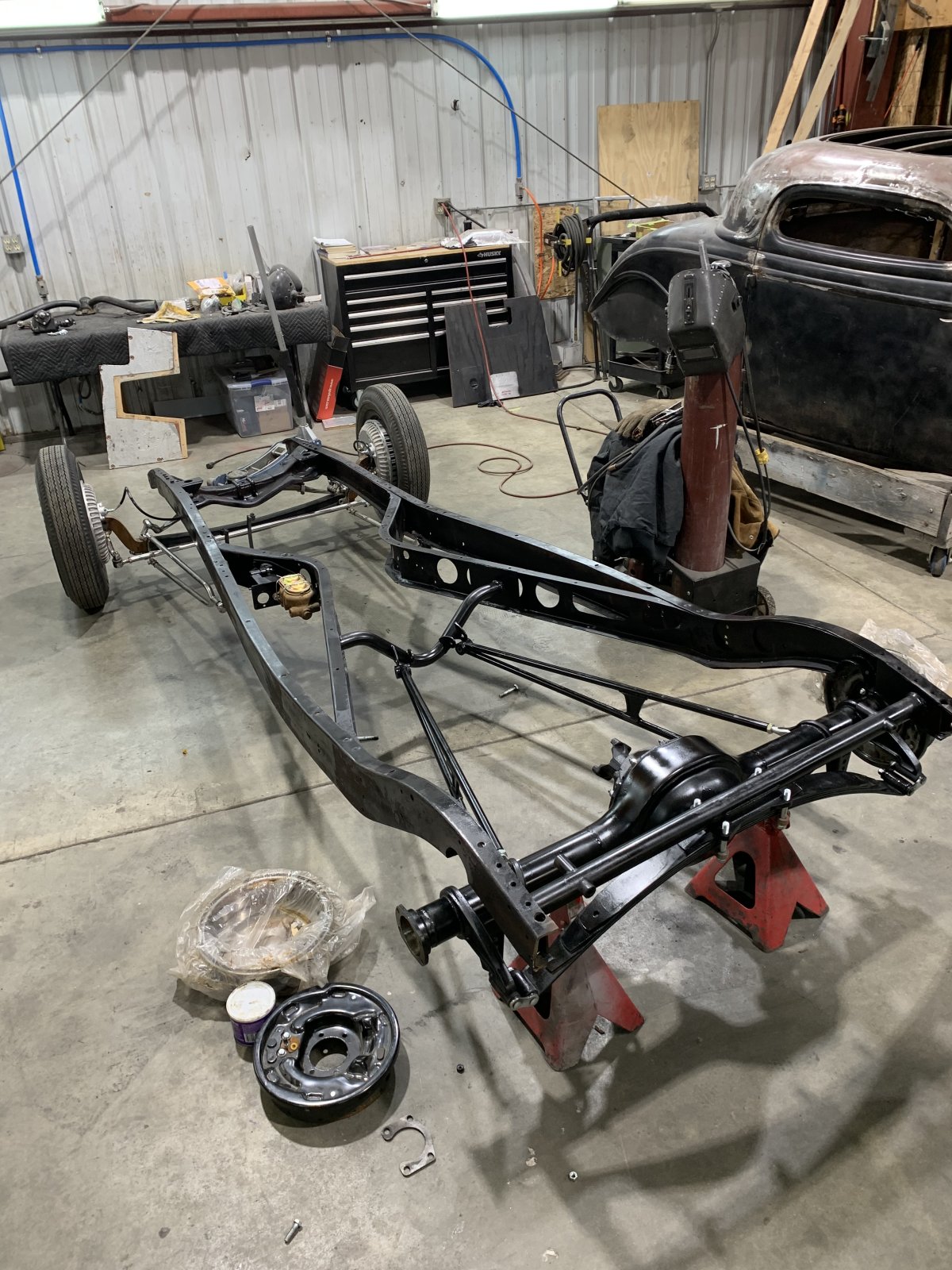

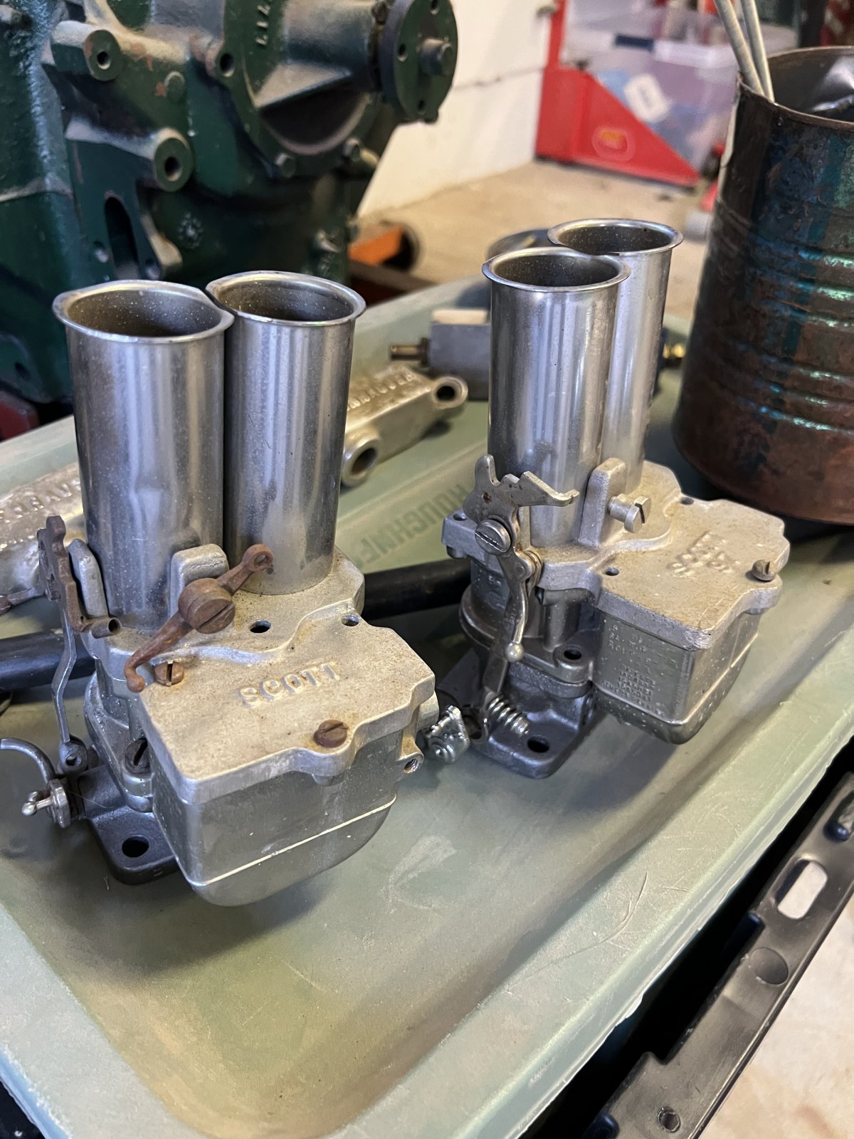

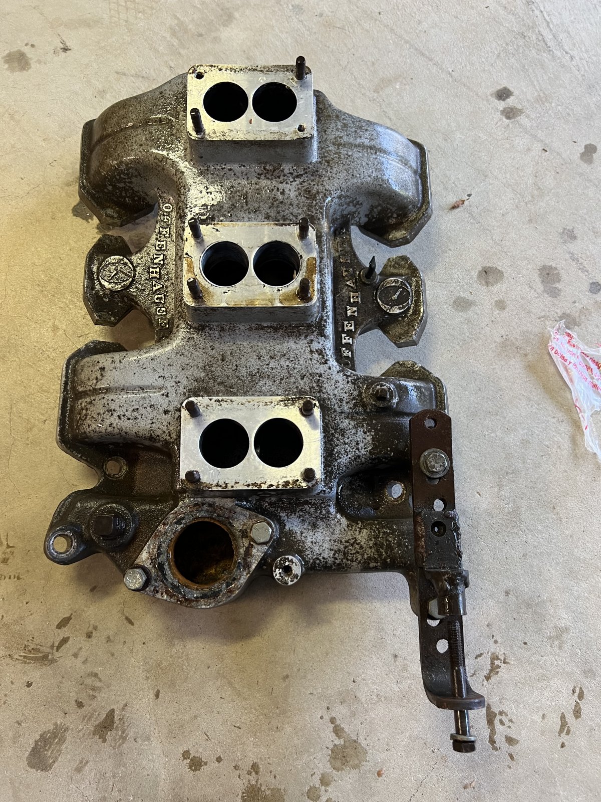

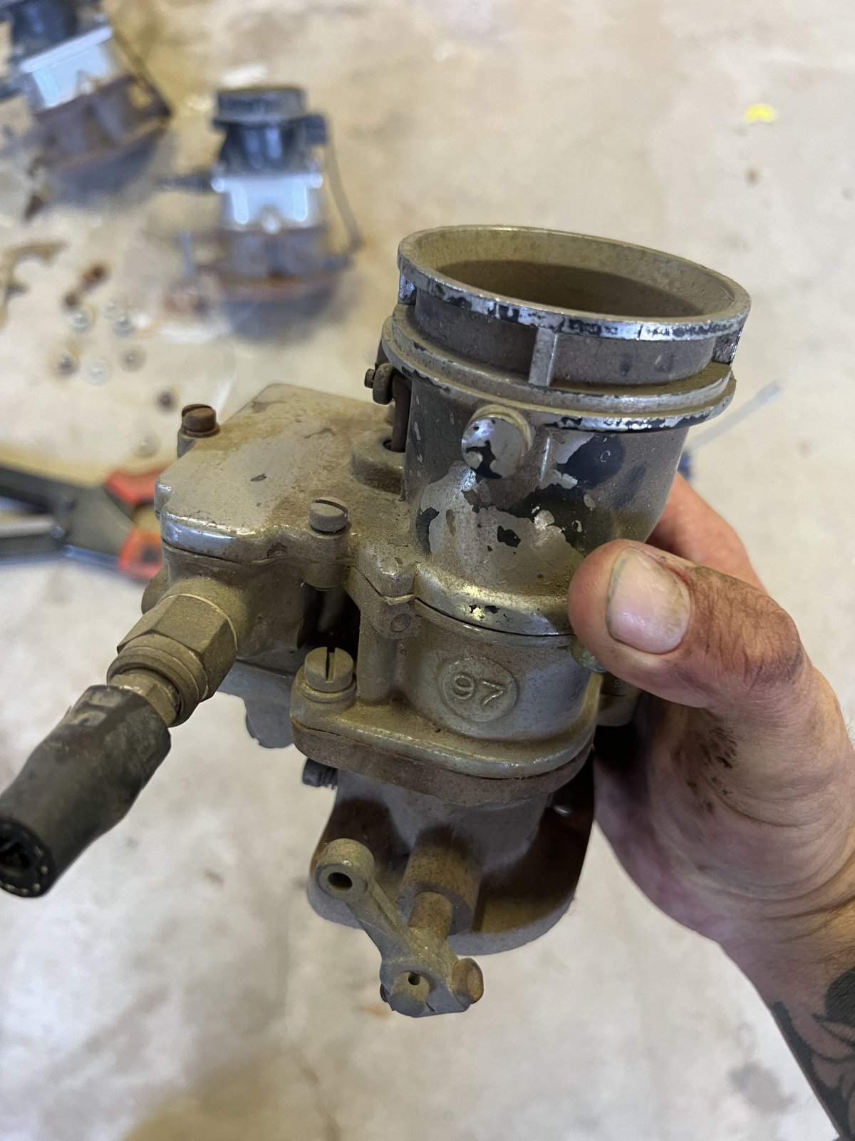

  11. angelbaby65
    Joined: Dec 26, 2011
    Posts: 105
    angelbaby65

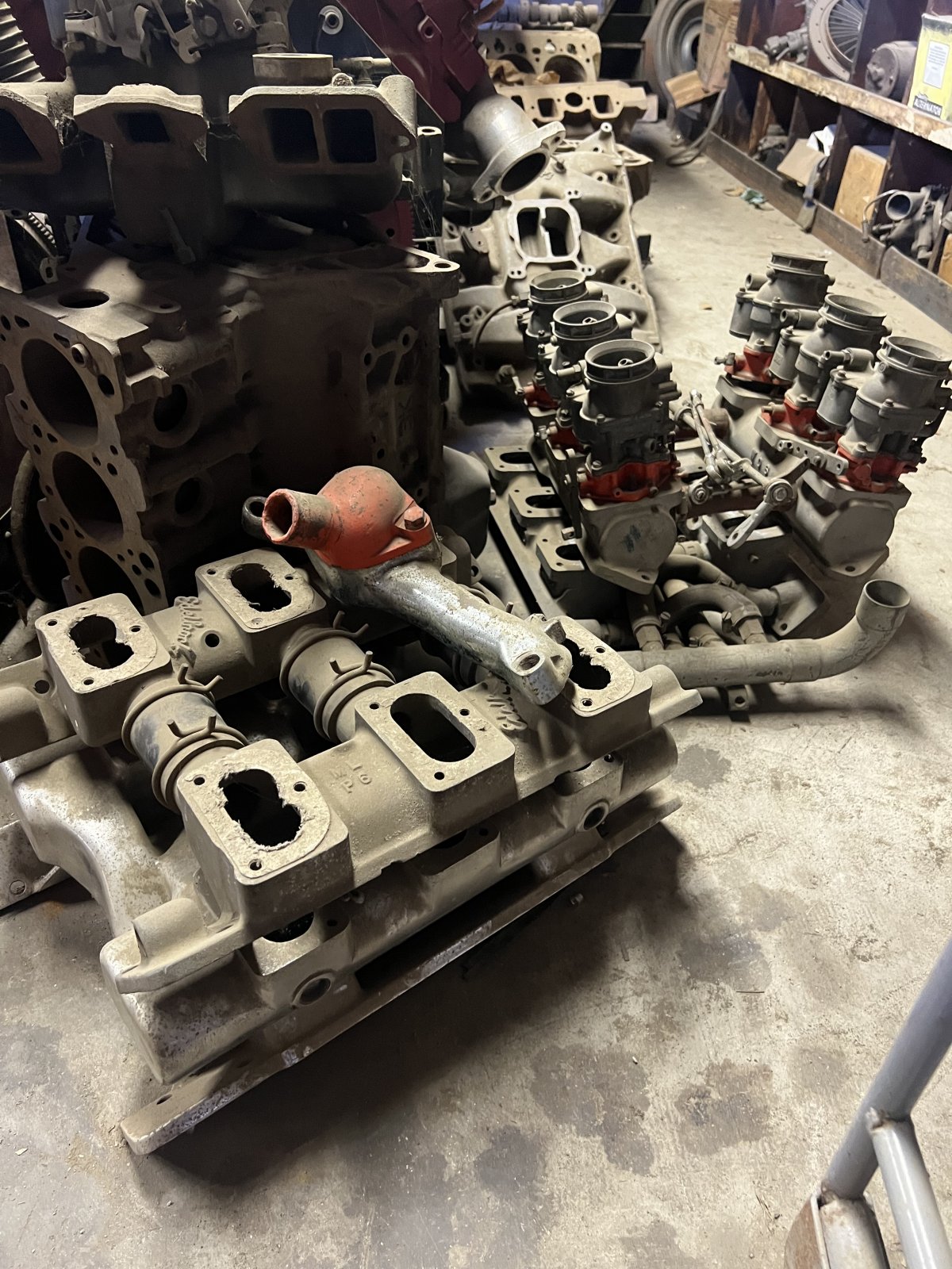

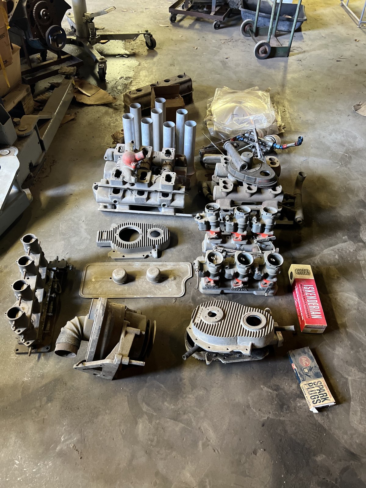

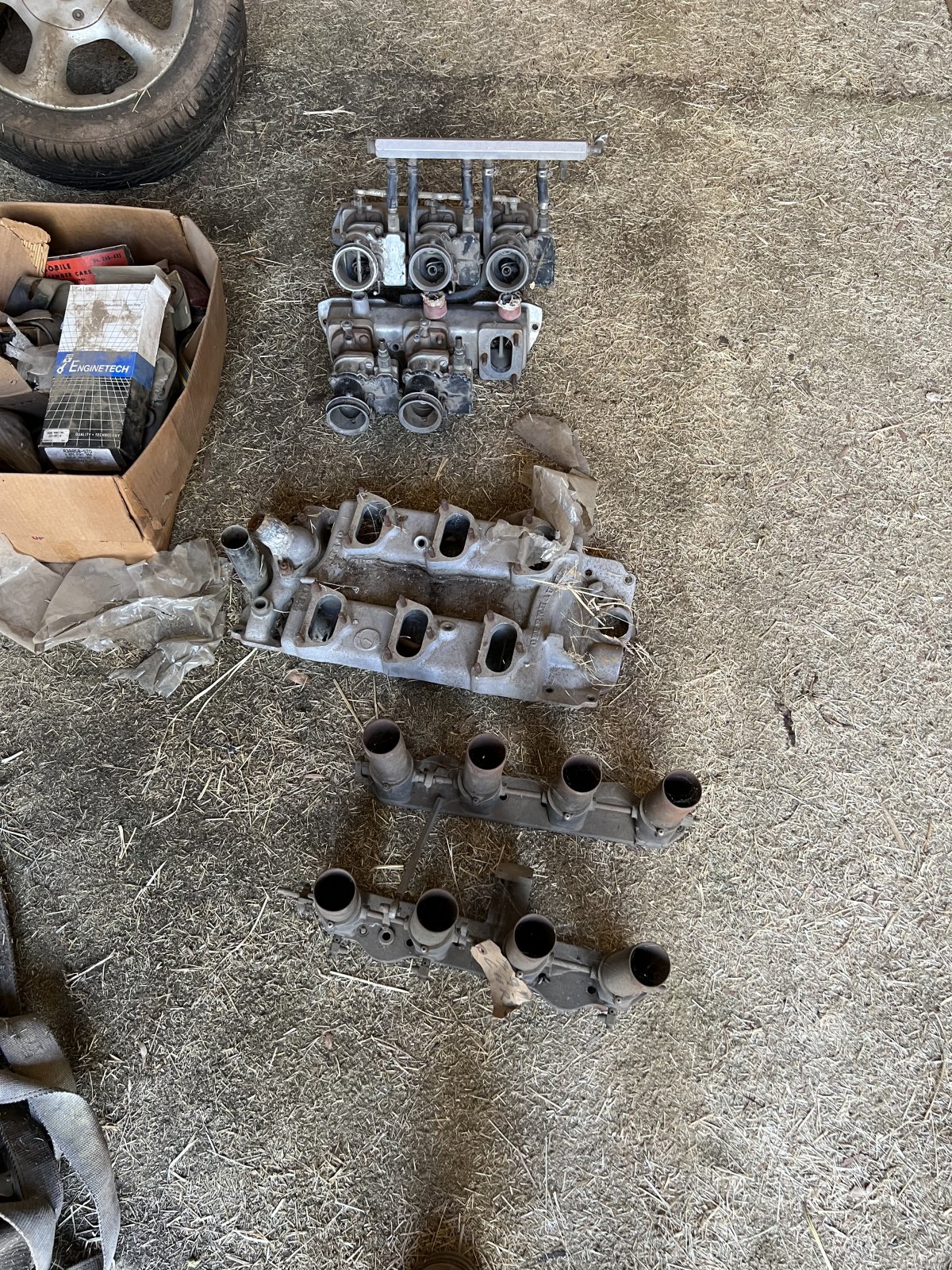

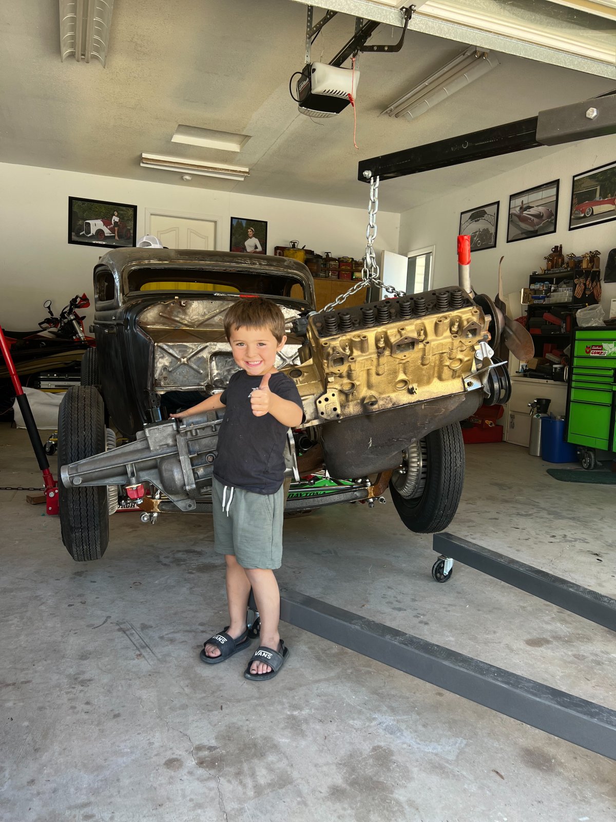

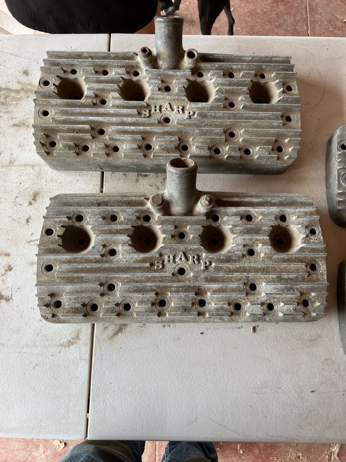

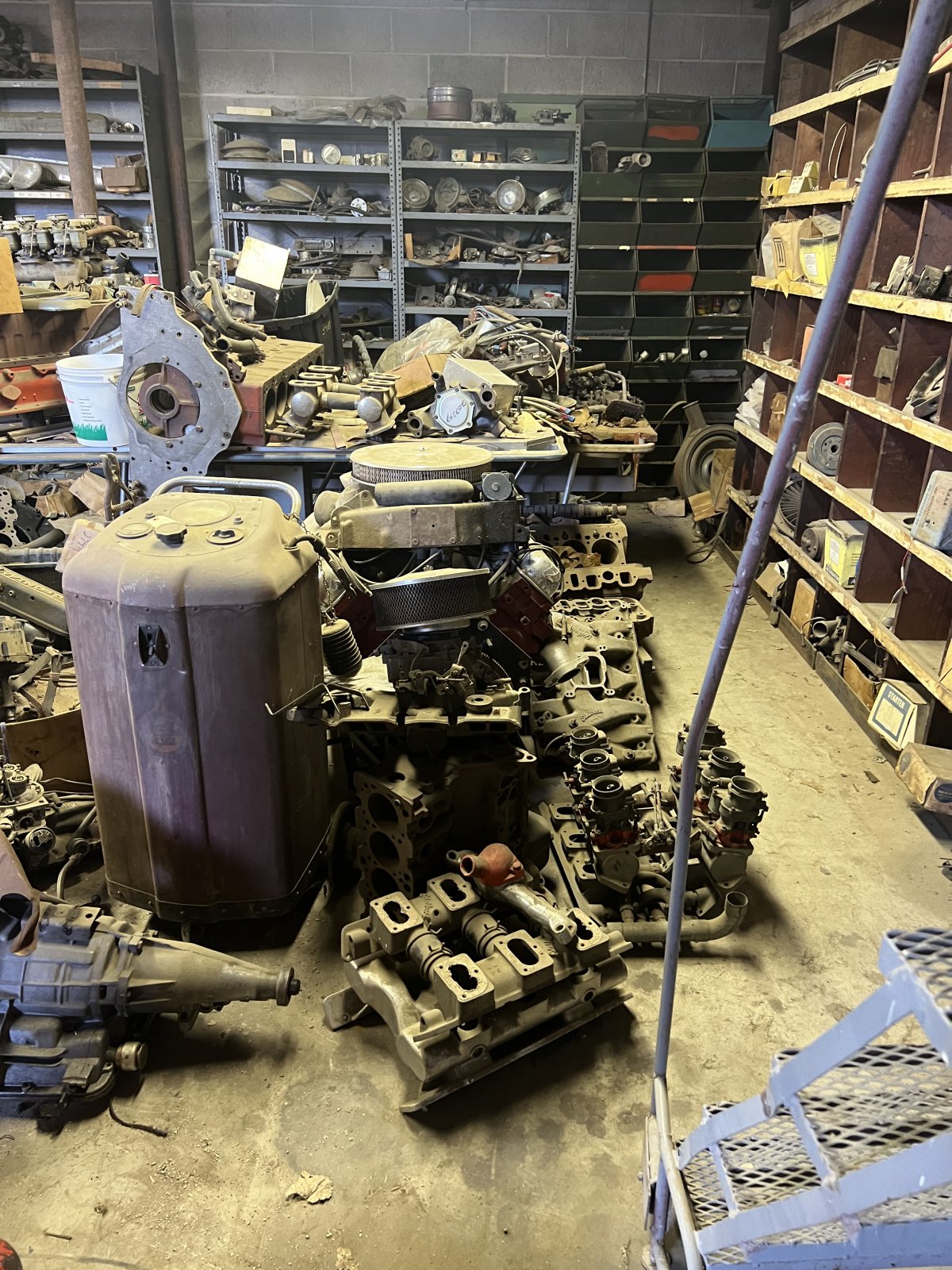

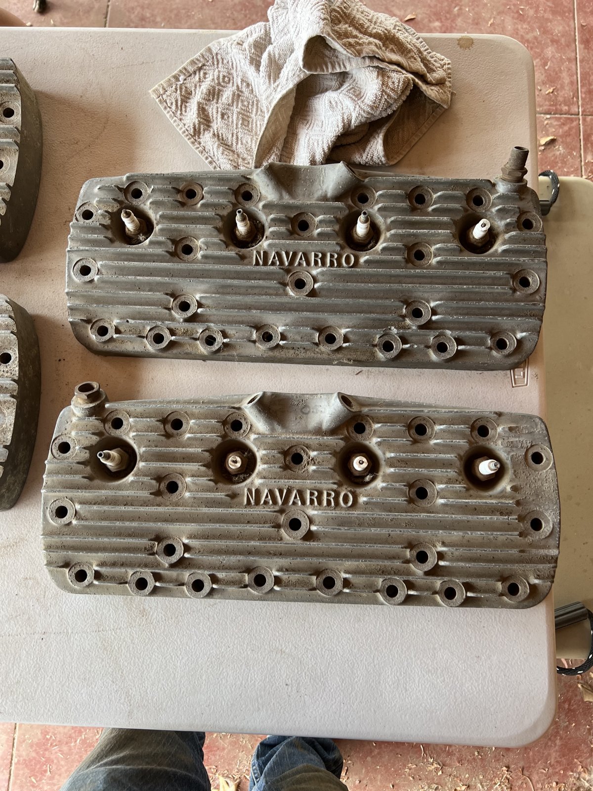

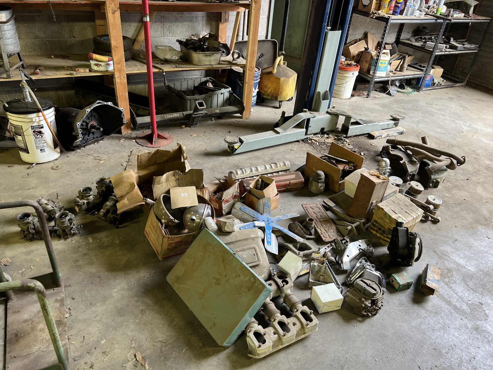

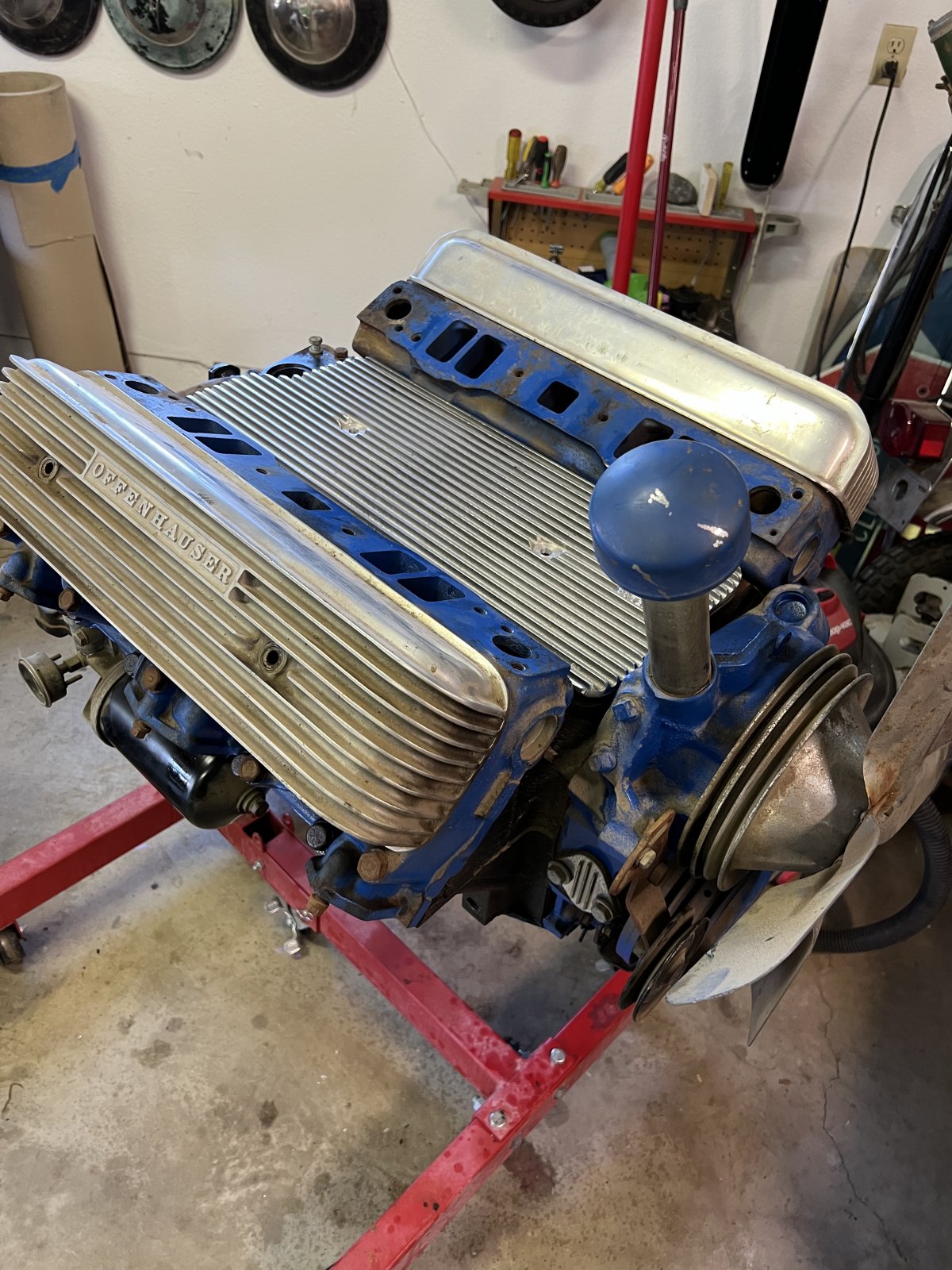

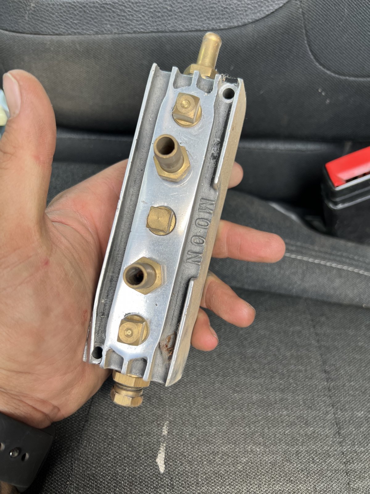

    I’m back! Been busy with work and have a little daughter coming into the world any day! Little update! I knew life would get busy so I chatted with Clay from Clayton’s hot rods about finishing up the car. I got it as far as I could with the time I had and then dropped it off to him a few weeks ago. I’m eager to see the progress once he starts! Prior to dropping the car off my 4 year old son pulled the motor out, the only help I gave was bolting a chain to the motor!
    I will just kind of do a photo dump here, but after we got the motor out and pulled apart I found out it was in much worse shape then I was told. Can’t win em all.. so I got the car dropped off to Clay and started hunting for a motor. I got a lead on a rebuilt engine 3 hours south of me, old posting with ****ty photos and the guy says I’m just helping a friend sell it, call her and set up the deal. So I call her and she mentions that she is selling a bunch of old parts and maybe some cars so I grabbed a chunk of cash and my trailer and hit the road. To keep it simple I went to get 1 motor and ended up making 2 trips filling my truck and my 20’ car trailer both times! 5 olds engines, 1 hemi and tons and tons of parts. (@cruisinthepines or @saia_vintage on instagram if u wanna see the video and pics of the haul) injection, 6 packs, heads, 94s, 97s u name it! So I got everything home and started figuring out what all I had and started to figure out which engine I wanted to run. Out of the olds I had 1 394 3-303’s with ported 371 heads and 1 455. I’ve planning to run the blue engine it’s a 303 with 371 heads adjustable rockers and a crazy custom built roller cam setup. For now I’m going to run the offy valve covers with the eelco valley cover and off 3x2 manifold with these old chrome 97’s. (Need to clean up the paint off them still) long term I think I will run the scott97’s but they need to be ***embled and adjusted. I’m working on a run stand so I can run the motors and make sure I’m making the best choice. They’re all 0 miles engine. Anyways there is my update! 19439F0C-3070-4B2D-94C8-71385568F3AD.jpeg 2BF1ACAF-48AC-4D19-B4DB-1D65C67463AD.jpeg
