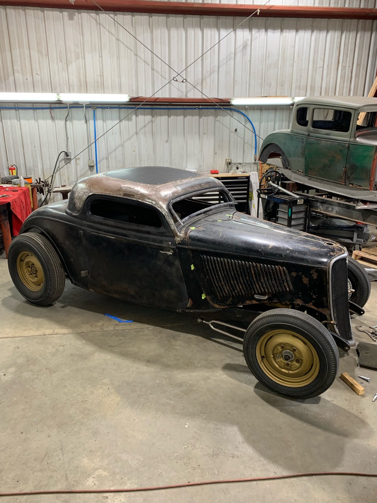

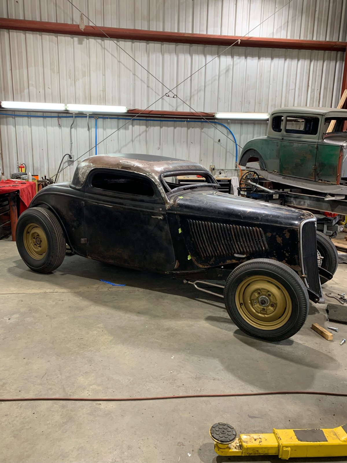

    Starting to get the front sheet metal fitted, headlight stanchions and roof filler panel in. It’s looking like a car now, I think the stance and proportions are dialed!

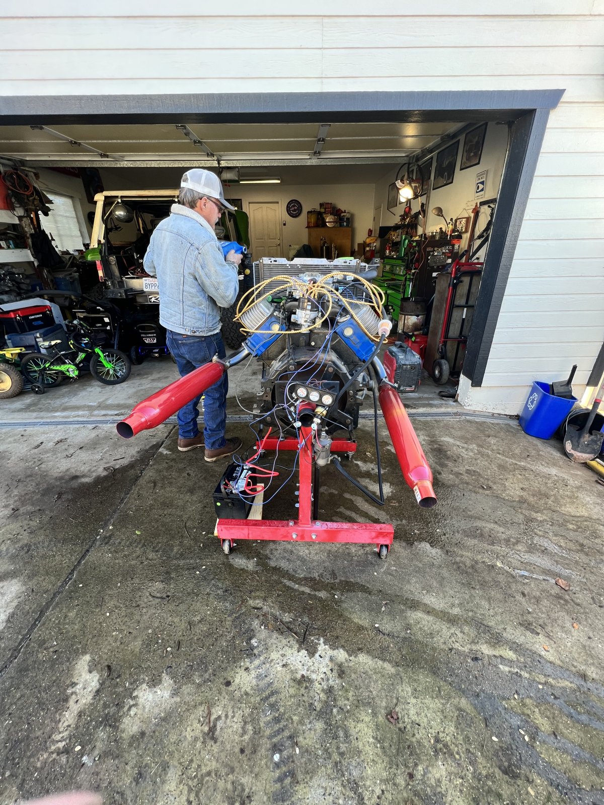

    Exciting update! Got the first engine fired up last night!! This solid roller 303 sounds down right pissed off! None of these engine I have were ever fired after being built in the 70s, so I wanted to make sure I didn’t run anything dry. I pulled the plugs on the 2 engines I’m planning on firing and soaked with a mixture of atf and marvels, also pulled the valley pan and squirted the same concoction down the hole, I let that soak for about 4 weeks then last week I drained and installed a new filter and 5w30. Last night I duct taped a 12mm socket to an extension and primed the oil pump, spun the motor 45° and repeated a handful of time, after that I pulled the valve covers and piled everything up, the cam, springs, rockers etc still had ***embly grease on them. After that I finished up oakie wiring my test stand dropped the distributor in and let her rip! Fired right up and ran BEAUTIFUL. No leaks except the water pump has a small drip out of the shaft, which I expected! I had Phil at mason ignitions rebuild 2 distributors for me, 1 with a br*** gear and fixed 20° of timing for the roller motor and another Mallory dual point for the other motor. Planning on firing up the second motor tomorrow! If you wanna hear the roller you can listen to it here on my instagram. https://www.instagram.com/p/CnqiYYIO7hI/?igshid=ZmMyNmFmZTc=

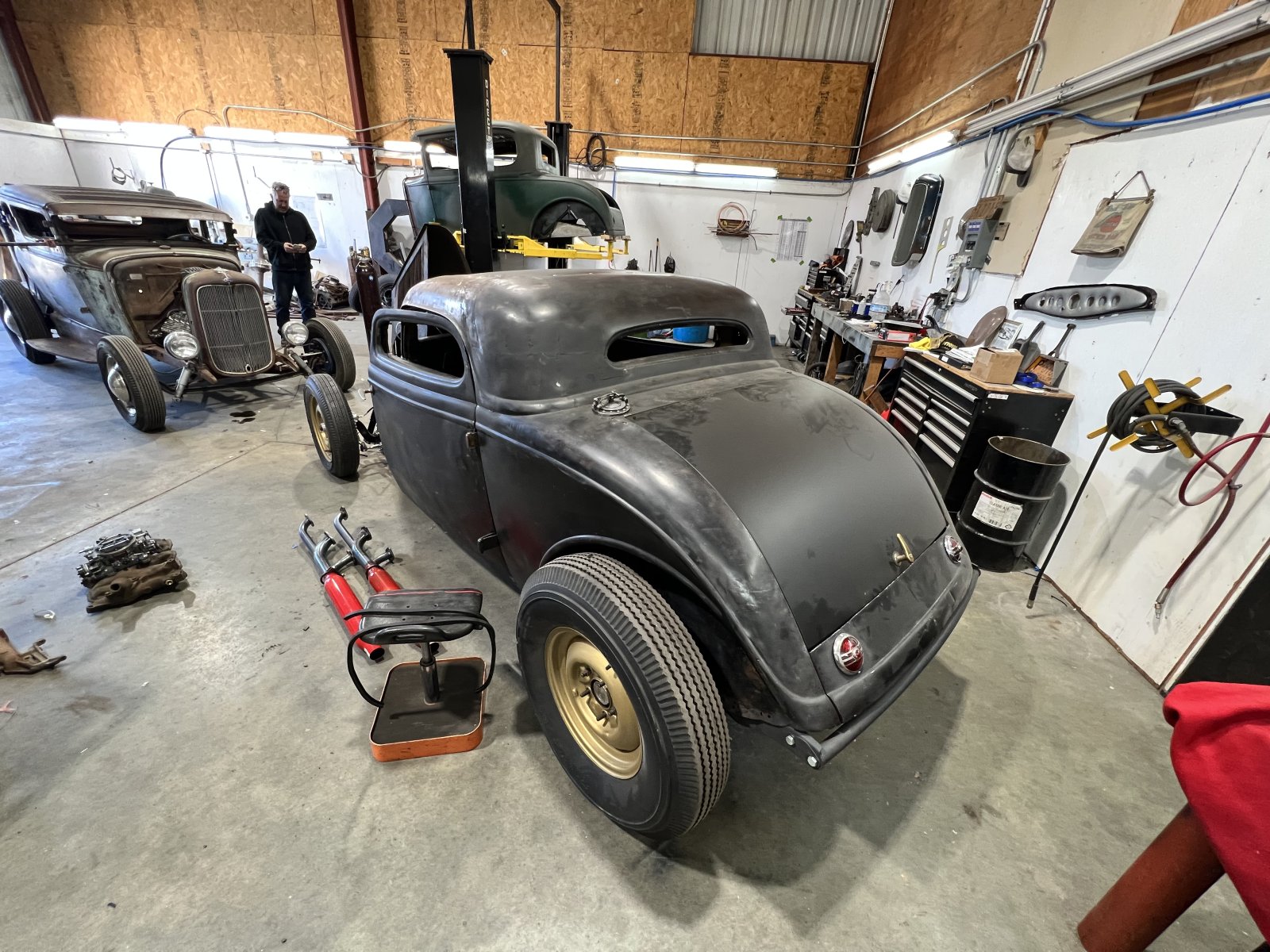

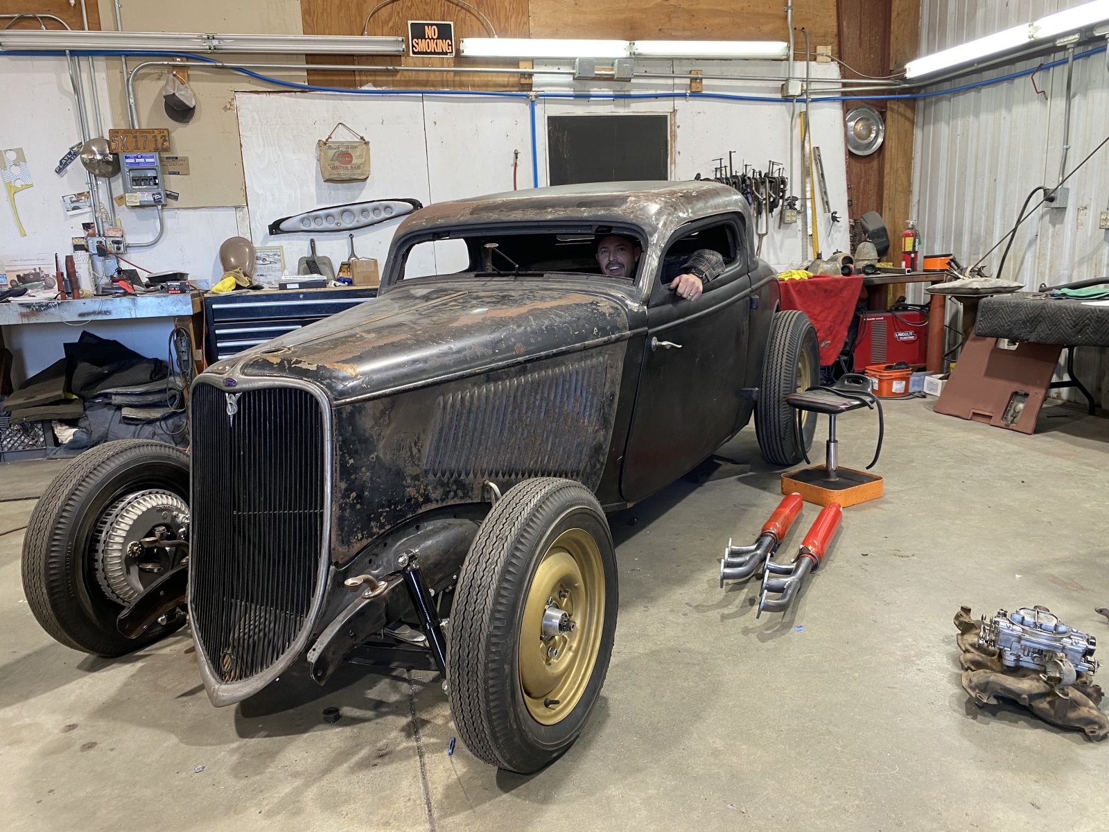

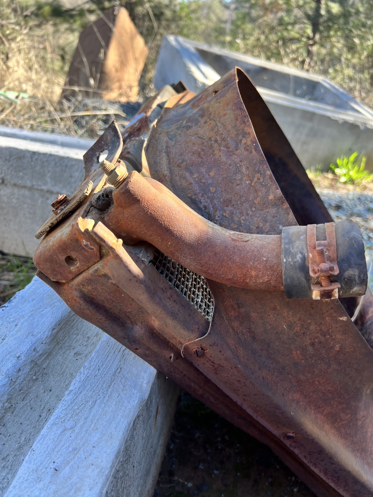

    I went down Thursday to drop the roller motor off so clay can set it into its final resting home! I brought down a few differnt options of headers and manifolds to see what’s going to work, it’s. Extremely tight squeeze on the front port against the hood. Another battle we are fighting is the lower radiator outlet, since the car is channeled to much my radiator sits very low, I wanted to stick with a big radiator to help keep this 303 cool. I picked up an old 9n ford tractor radiator in hopes to use the lower spout but it didn’t work out as well as I hoped. Clay contacted br*** works and they’re going to build us a custom piece to weld on.
    Sat in the car to mock up seat location, in these pictures im sitting on the floor board and we’re guessing my seat will sit around 6” total height from the floor. I’ve been waiting on a glide seat, they’re only a month behind on delivery so far .

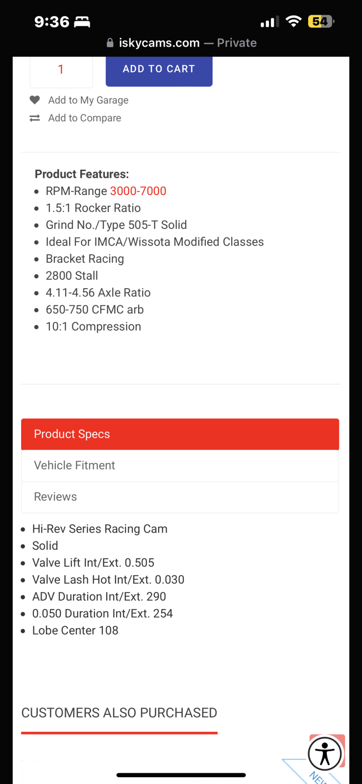

    Also I pulled the cam plug and got the cam spec’s finally!

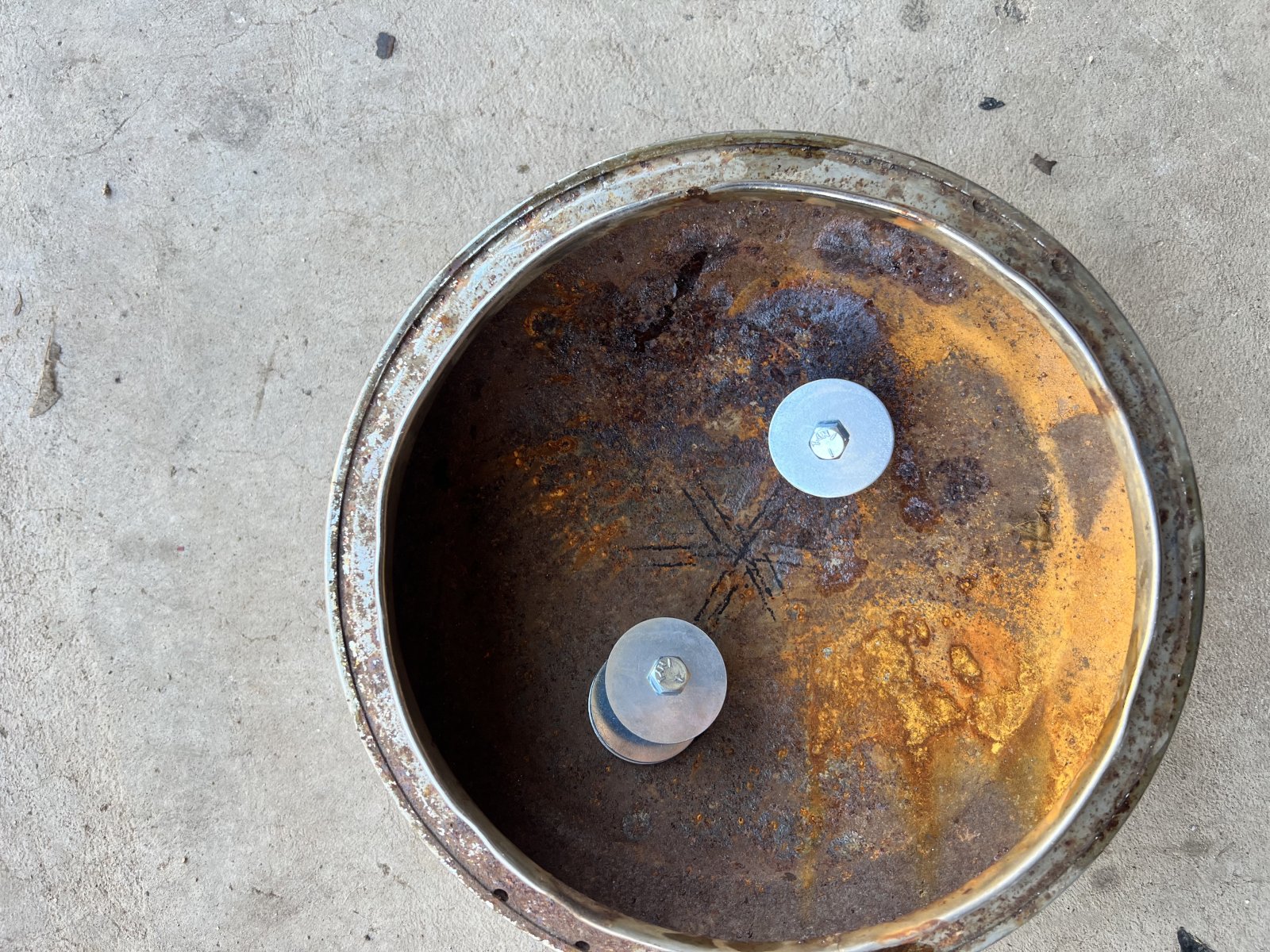

    so I got my hands on a set of Veda spec caps and I wanted to do something a little differnt with them since I’m running a set of 40 wheels instead of spokes. This is what I came up with, drilled out a set of 46 caps and bolted the vedas on. I think I will safety wire them to the wheels for some security. I measured about 78 times to make sure they are centered as close as I can get them, but I wanna make sure they are perfect because the aluminum is NOT light lol. I also thought about getting the wheels and tires balanced with them installed to help smooth it out, but we will see. Any ideas on how to perfectly center them? Hardware is obviously incorrect it’s just what I had laying around.
