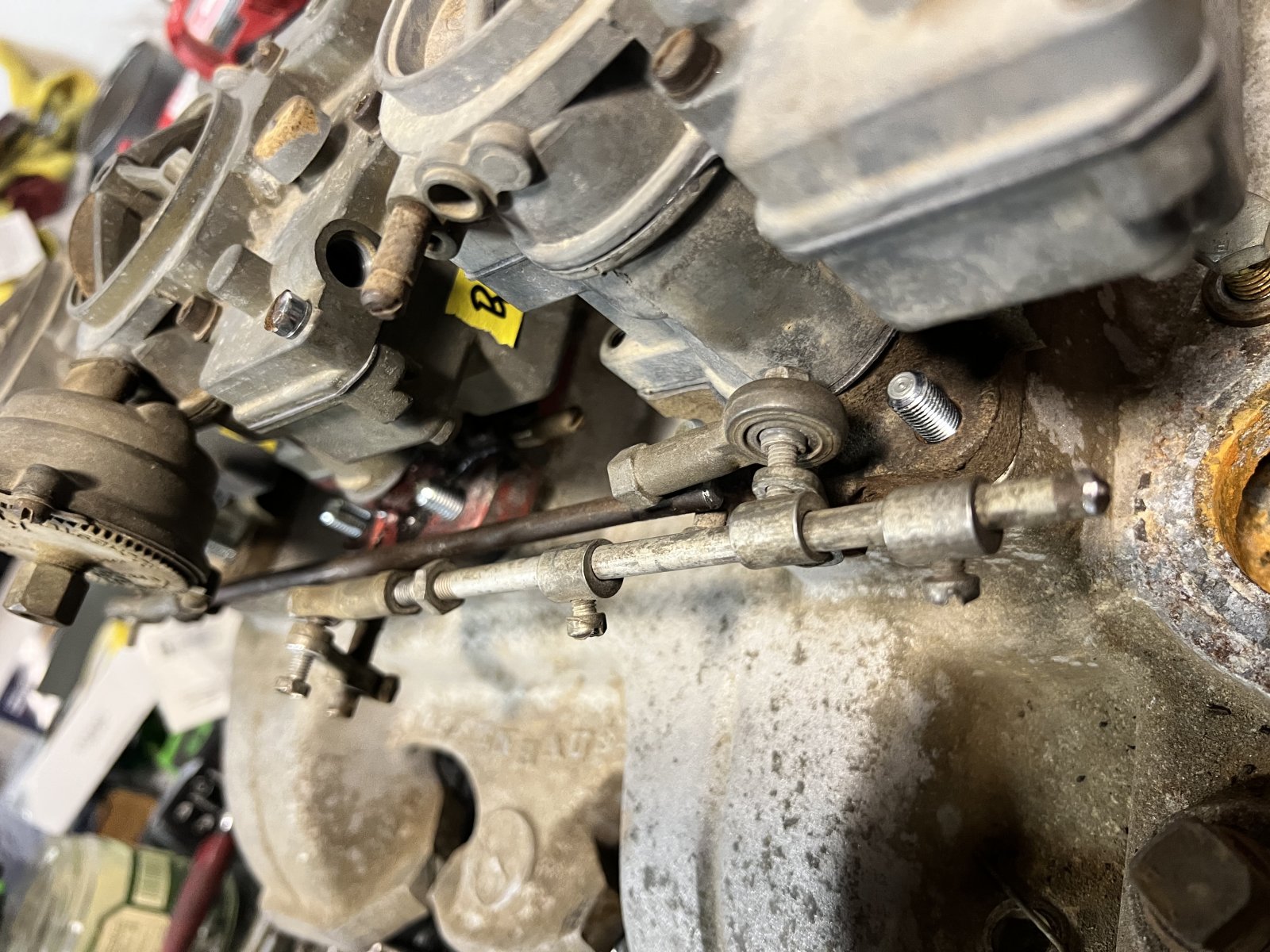

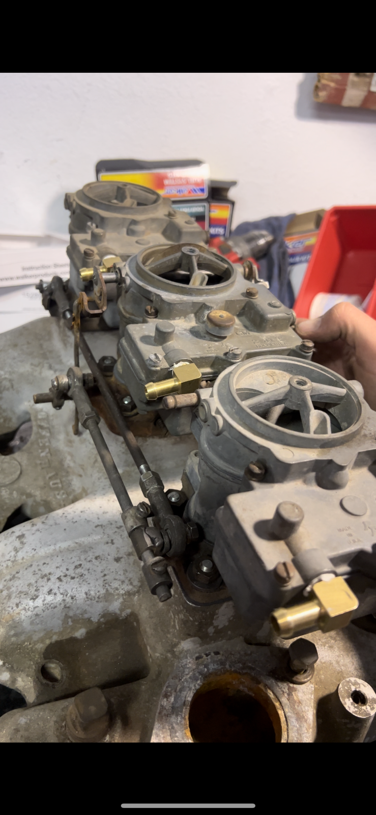

  6. angelbaby65
    Joined: Dec 26, 2011
    Posts: 105
    angelbaby65
    Alright guys I decided to use these Rochester 2jets from a j2 setup with a offenhauser intake drilled for them.. I think I’ve got the progressive linkage figured out as well, thankfully I had a pile of old linkage to choose from and make up what I need. Not sure what I’ll run for air filters yet, maybe some scoops and screens.

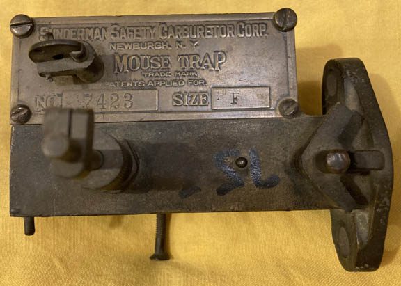

  7. Outback
    Joined: Mar 4, 2005
    Posts: 3,447
    Outback
    from NE Vic, Oz
    My boss is getting a repro Mouse-trap made & are eagerly awaiting it's arrival! This yours? What's it going on?
  8. Budget36
    Joined: Nov 29, 2014
    Posts: 15,370
    Budget36
    So what the heck is that used for, and why is it called “Mouse Trap”?
  9. angelbaby65
    Posts: 105
    angelbaby65
    After taking apart 2 other carburetors and modifying some parts, I’ve got them dialed in and ditched the vacuum operated choke and made a manual setup. Also got the progressive linkage setup and adjusted it works well on the bench. Outer carbs come on about 1/4-1/2 throttle and all go WOP at the same time. We will see how I did once it’s running. Heading down to Clays tomorrow to check in on my car and drop off my new glide seat along with the carbs, manifold, and fuel block.

  10. vtwhead
    Joined: Oct 20, 2008
    Posts: 5,307
    vtwhead
    Do the light test on those secondaries and see if you can see any light p***ing by the closed blades. If you can then you will have a vacuum leak and it will idle ****ty. I would get it running on the center first with block off plates on the outers then add each outer to see how it goes. Back in the day GM used a paint on material around the edges of the blades. Paint them, close them and let it dry then break them loose to provide a tight seal. ****ster used to offer it years ago. I have used it on one 348 tri power and it worked flawlessly and still is running great 10 years later.........

  11. angelbaby65
    Posts: 105
    angelbaby65
    great info, i checked them but I didn’t use a light, ill see how they’re looking! Thanks!
