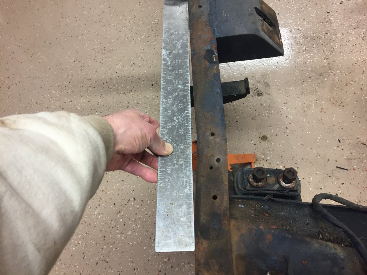

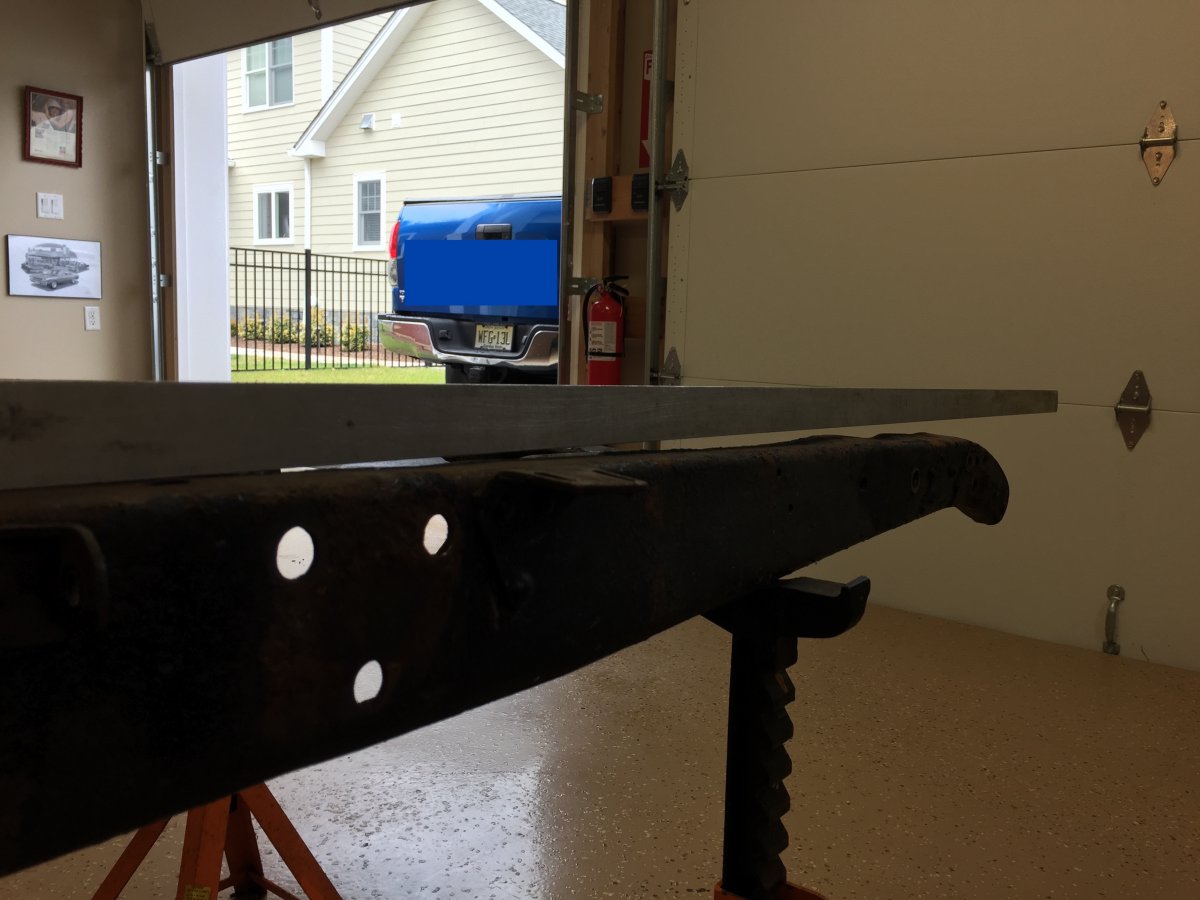

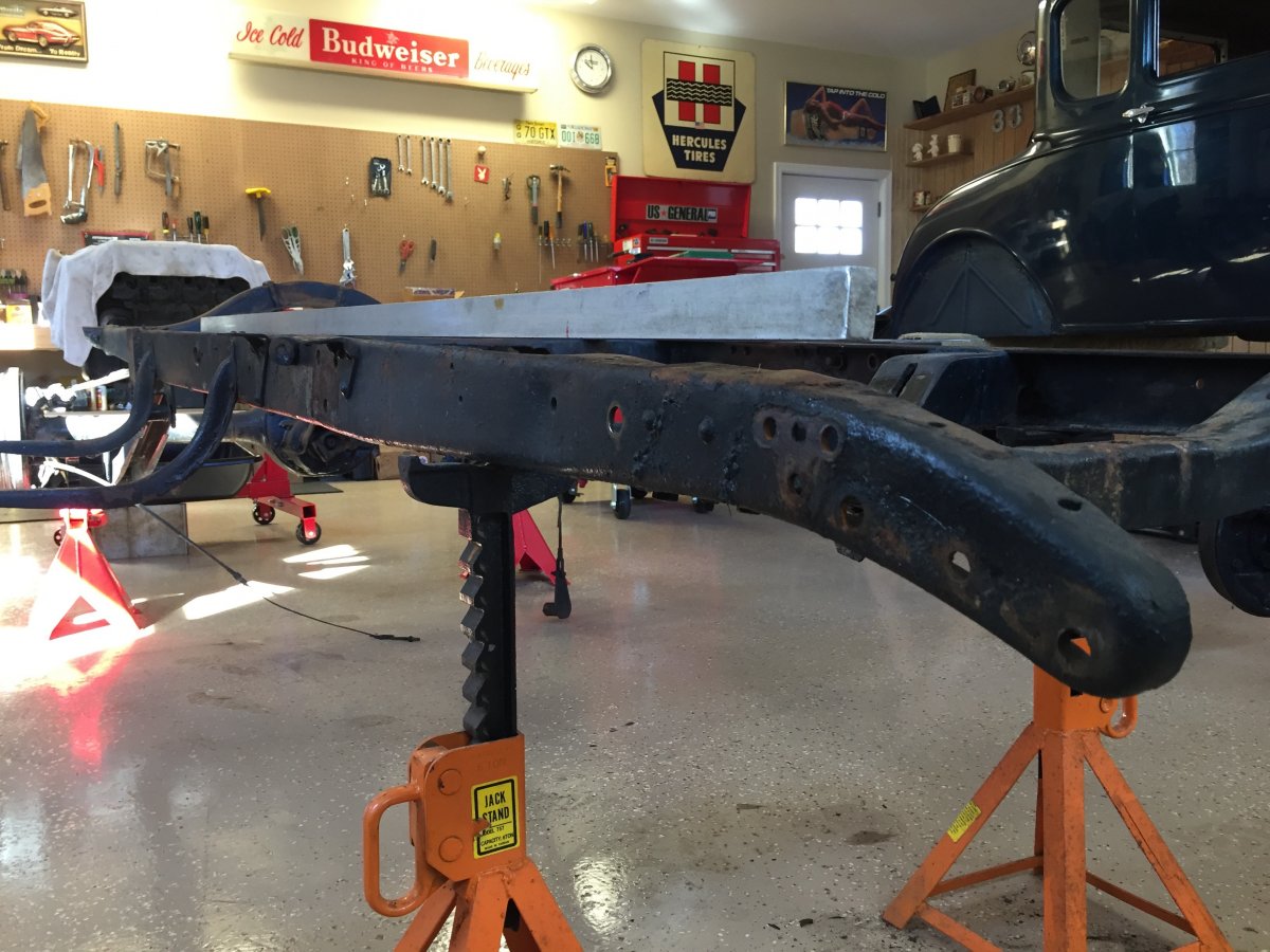

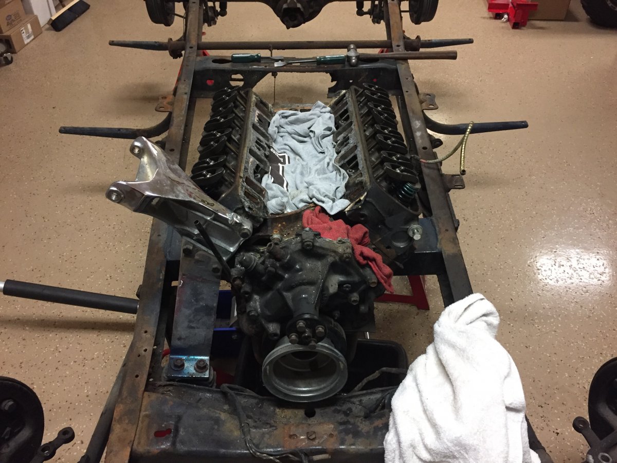

    A heavy bracket is bolted to the engine and is bolted to a rubber trans mount that is welded to the front cross member. Was this to keep the engine from twisting? The frame has lots of problems , it's twisted
    I don't like the motor mounts. It's been cut and welded in many places.
    Too much work was needed so i picked up a nice model A frame to work with. IMG_1579.jpg IMG_1580.jpg IMG_1574.jpg IMG_1550.jpg

    Welded in some plates to boxed the frame . IMG_1762.jpg IMG_1761.jpg IMG_1852.jpg IMG_1837.jpg

    I'm not trying to rain on your parade about the hipo motor...I'm trying to confirm that what you have is indeed a very valuable k-code hipo 271 hp engine. From what I see of the exhaust manifolds on the car, they do not appear to be correct for the hipo (though it's difficult to see a good view of the driver's side...and they could have been changed for regular manifolds for the sake of clearance). Below are photos of k-code hipo exhaust manifolds.
    If you take a picture showing the width of the vibration dampener, that will certainly help to confirm...as will a close up of the valve springs in the heads to confirm whether the heads have the hipo only cast in pockets to stabilize the valve springs at high rpm.
    Once you remove the oil pan, you can look for the football shaped 3/8" connecting rod bolts, the balancing hatchet on the snout of the crankshaft, and of course the larger main bearing caps (same as the "Mexican" 302 blocks).

    i make my own SBF motor mounts, they bolt to the heads [2 bolts right, 3 bolts left]
    i use flat head mounts and biscuits... don't care for any of ford's SBF mounts...

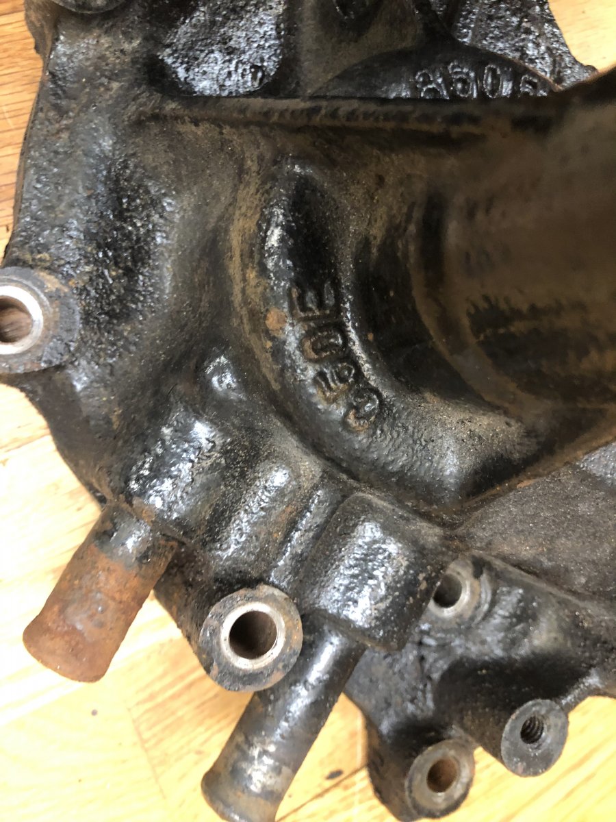

    No worries this won't rain on my parade. This engine is turning out to be a mystery.
    Apparently frank ordered this from a local ford dealer and installed it in the car in 1965.
    The exhaust manifolds are slightly different. After some researching the engine the damper is the
    thinner one not the "K code." Looks like the water pump , fuel pump , and distributor have the
    "k code" casting #'s all dating correctly for this engine. Not sure if someone would go to all the trouble in the 1960's to find and install all the correct "k coded" and date coded water pump, fuel pump, distributor for an old hotrod. Mustang yes.
    Wow one search on ebay and they are asking crazy $ for these parts.
    What ever it is it puts a smile on my face ever time i work on this car.
    It's my therapy to go and turn wrenches on this car.
    Here is a picture of the water pump with casting #. IMG_3019.jpeg IMG_3018.jpeg

    Reminds me of that kid on American Hot Rod who wouldn’t box his frame rails. Boyd offered the kid a dream of a lifetime. I boxed a 40 Ford frame in once, heard nothing but **** from the Peanut Gallery! Good call on boxing your new frame!
