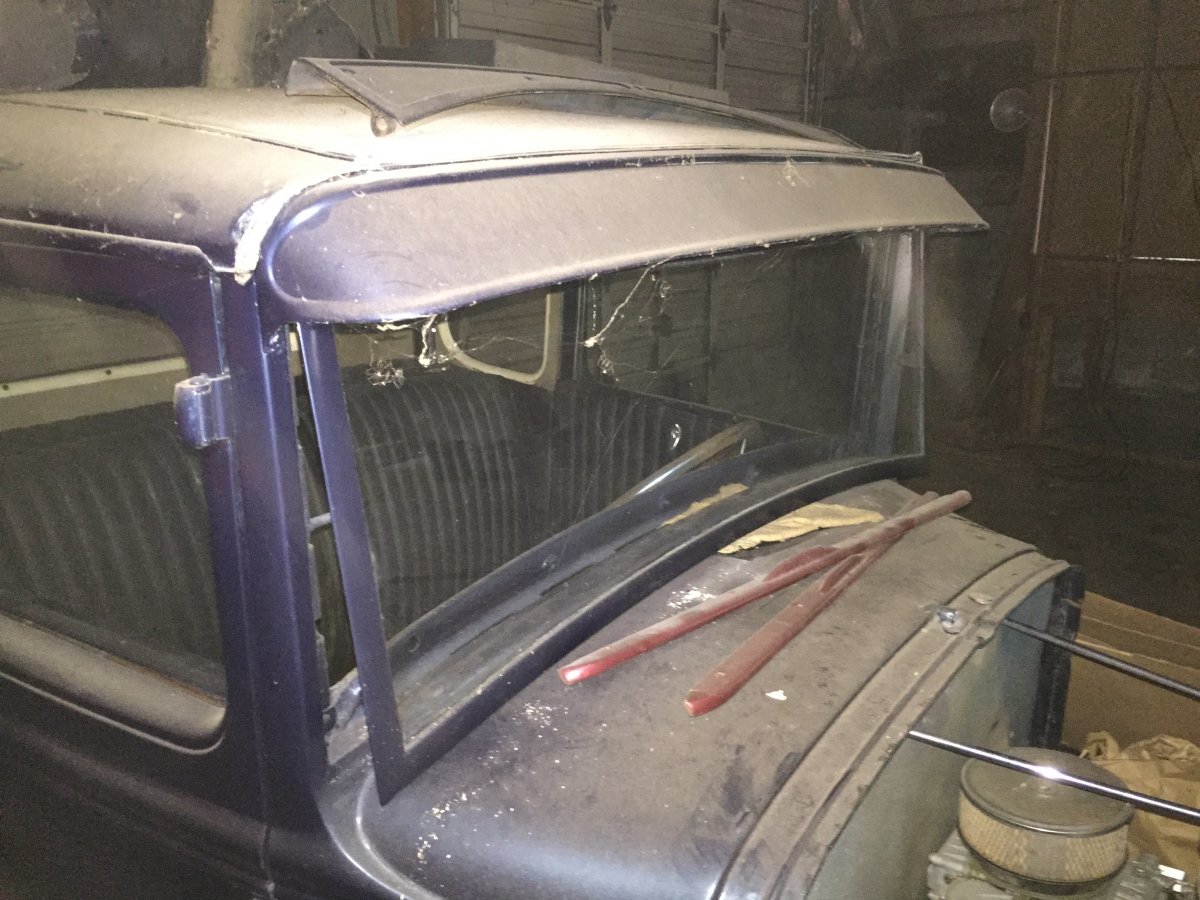

    I replaced part of the rain gutter under the back window and the curved trunk panel. IMG_3080.jpeg Also the two running boards are shot . IMG_1878.jpg IMG_1877.jpg IMG_0697.jpg

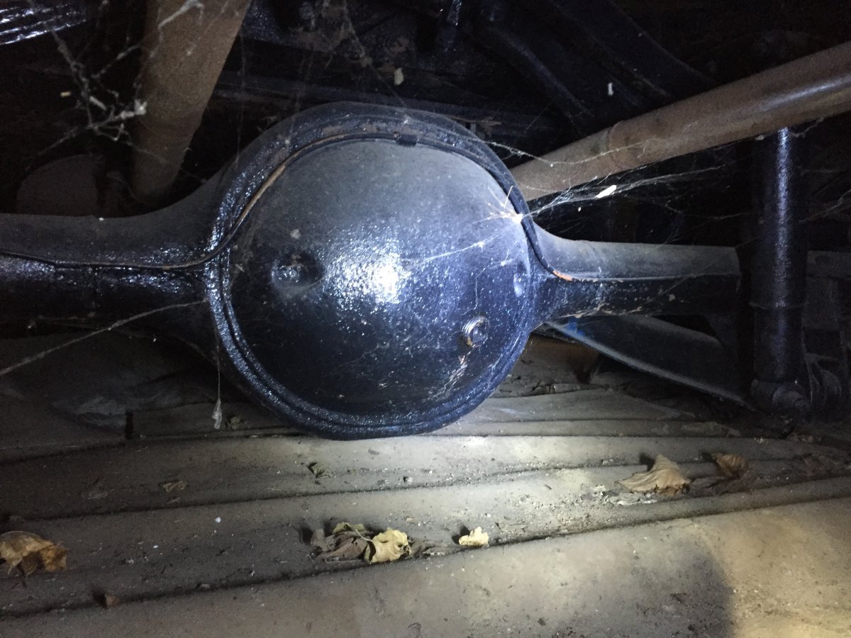

    Yes i wanted a pic with Frank . I am keeping the lower bracket he cut with a torch and welded to the axel. I could have just cut that off and install the typical shock mount . This just adds interest to the car. I installed new shocks the same style he had on the car. IMG_3093.jpeg IMG_3095.jpeg to the car.

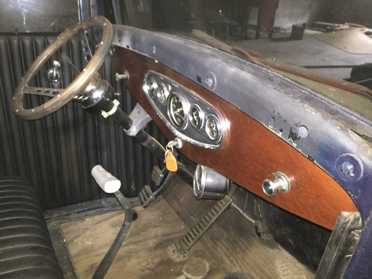

    The old Sun Tach transmitter box was mounted under the dash. I found two corroded batteries inside the box. Not sure why they could not use the 12Volt power from the car to work the Tachometer. IMG_1657.jpg IMG_1661.jpg
    I found a place to install modern electronics in side the box and calibrate the tachometer.
    The Tach is mounted under the dash. I am not sure if i will leave it mounted there or find a better place up closer to the steering column. I need to figure out where i have room as i put this car back together. I think i might be nice to have it more visible in side the cab.

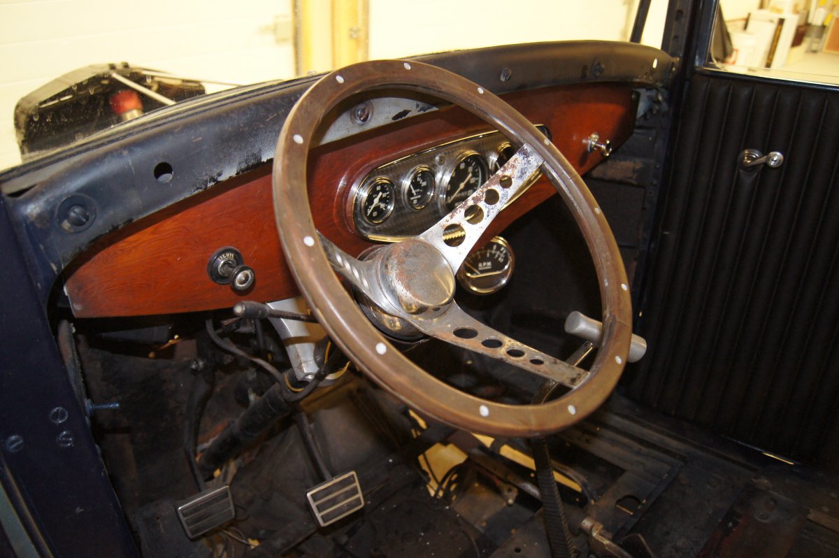

    The steering wheel is a Superior 500. The chrome is in poor shape and i would like to clean it up.
    I am thinking i could give it a light sanding and some " chrome paint" . Any one have ideas on how to make the wheel look better? DSC02465.jpg IMG_0011.jpg

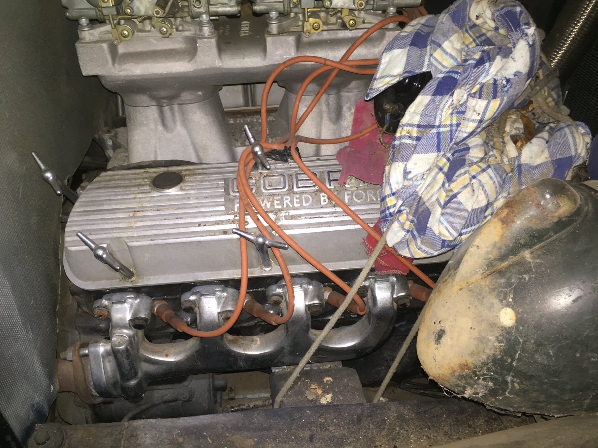

    The old wiring will need to go. This is all inside the old gas tank. IMG_0546.jpeg IMG_0545.jpeg IMG_0548.jpeg

    If it's was my car I'd cut out a lot of that inner gas tank baffle and underside to give me more room for the wiring. None of it shows, so you won't be hurting the looks.

    :rolleyes:...love that torchwork on the inner tank...even some Smoke effects...mine was cut entirely out underneath including baffles with the gas axe and maybe a hatchet here and there...period correct indeed...:D

    Thanks. I will cut some of the bottom tank to make more room to install the wiring.

    I'd not use the chrome paint on the wheel. Just never looks that good. Instead I'd carefully sand and polish just the rusty areas and then buff all the metal to a high finish, and then spray it with clear. That will save the patina, and improve the looks of the rusty areas, without making it look bad. I've polished out steel before and cleared it, and it looks a lot better than paint.

    Thanks. I will practice that on some other old chrome part i don't need first.
