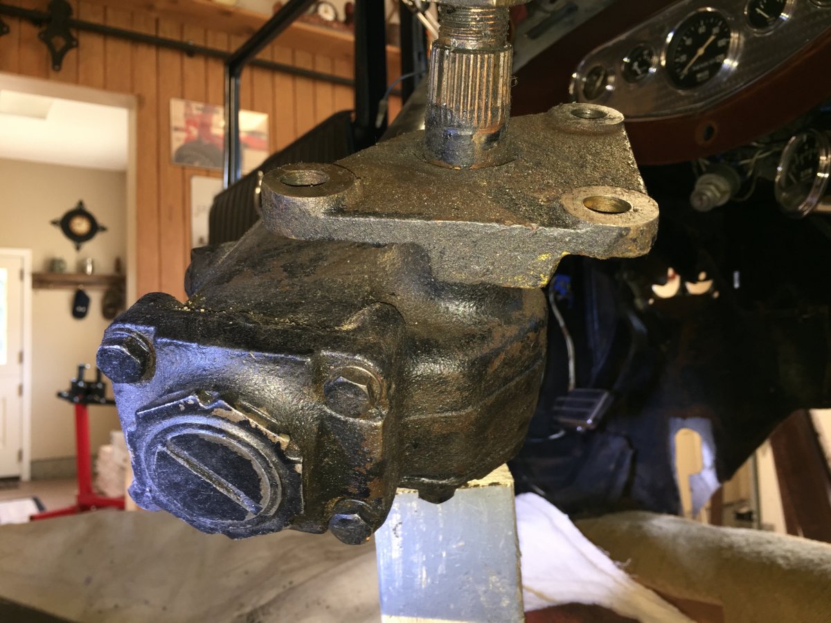

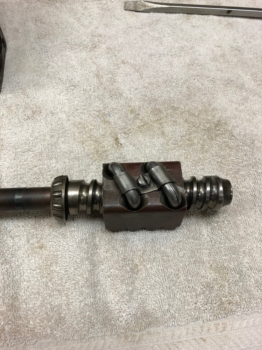

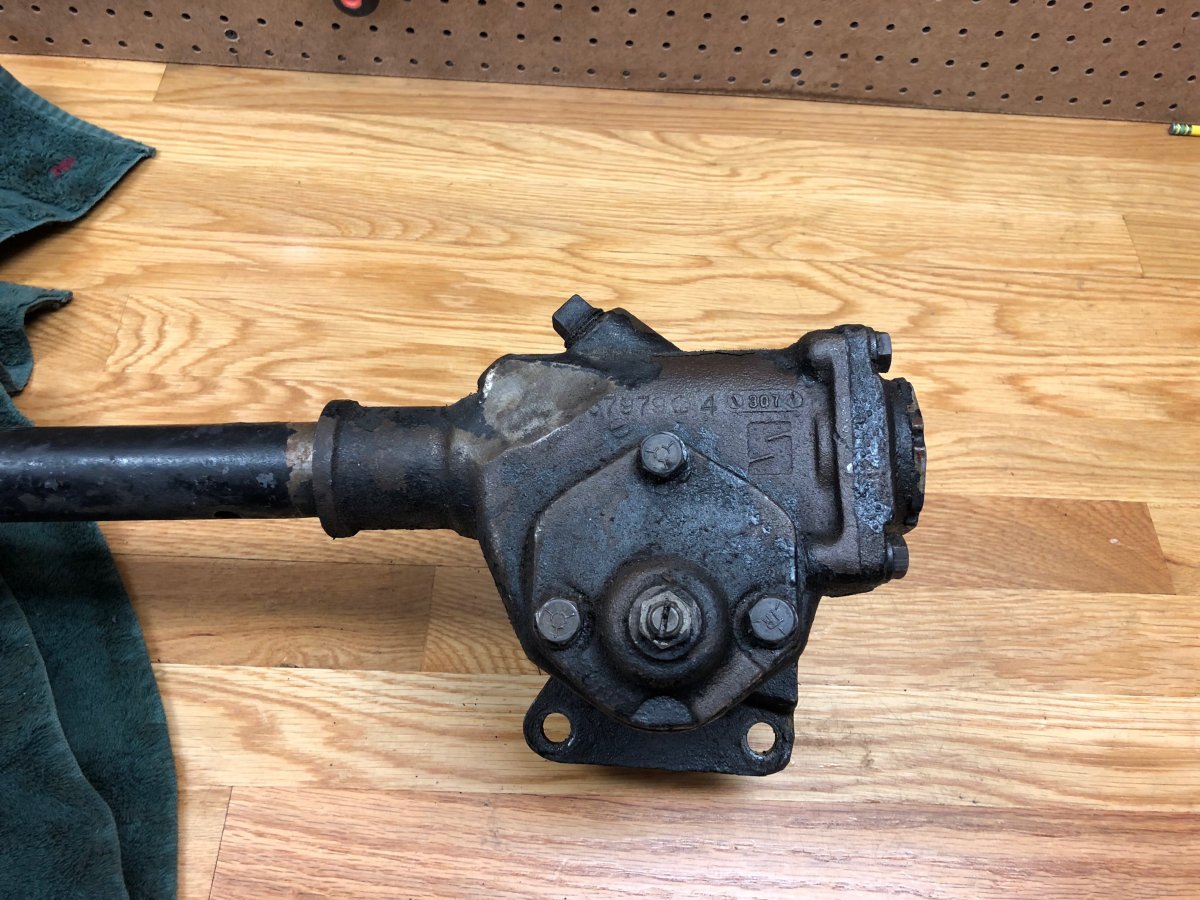

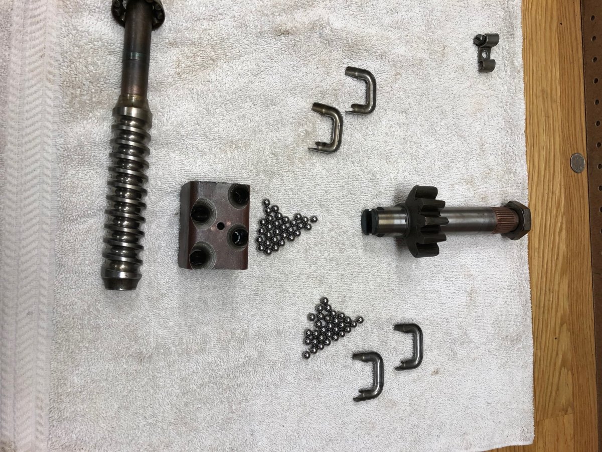

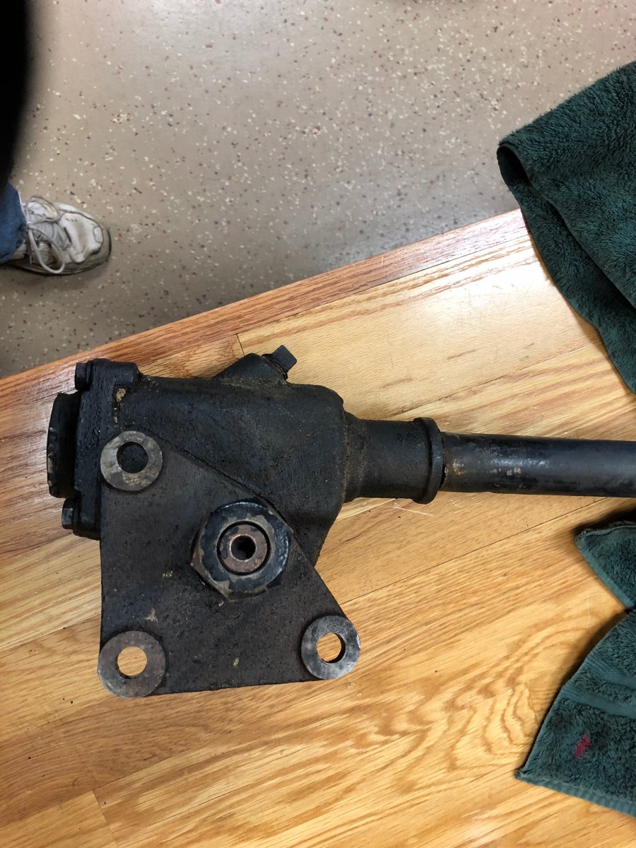

    I rebuilt the steering box. I think it's from a late 1950's f100 ? He had to grind Some of the box so it would clear the exhaust , hope this will not get too hot? IMG_0551.jpg IMG_0553.jpg IMG_2038.jpg IMG_0582.jpg IMG_0583.jpg

    Fill the box with good grease, when it gets warm the grease will melt and work as a nice thin lube.

    I highly recommend John Deere corn head grease in old steering boxes.

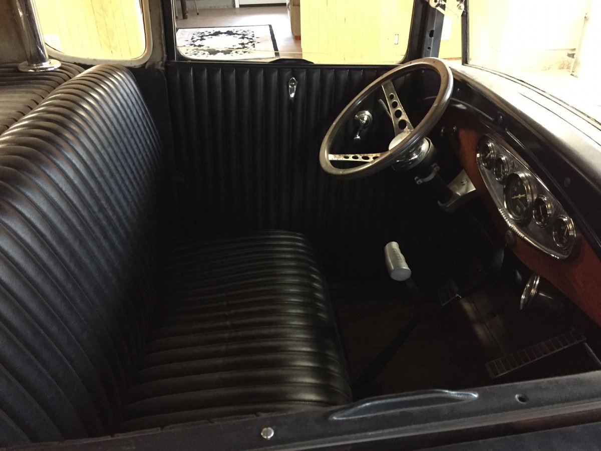

  10. Dana aren't these staggered peddles cool. I have not seen one like this since I was a very very young man.
  11. dana barlow
    Joined: May 30, 2006
    Posts: 5,582
    dana barlow
    from Miami Fla.
    Porkn****** ,,,:cool::)I would guess,a few did it for foot room,were others may of just not set them up even. I knew more then one rod with the need for extra brake pedal travel>do to wrong size brake piston match up as well,,didn't stop many from driving hell out of them !! Def. cool too !
    Still looks a little better when the ped's are even.

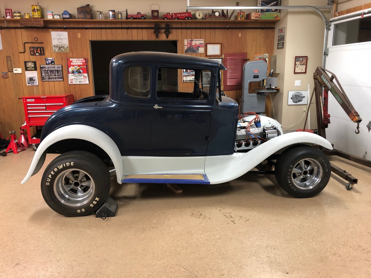

    IMG_1905.jpg I stripped and primed the fenders with epoxy primer. I put the body back on just to check how everything is fitting. The rear seems to high so i removed the stock rear spring and installed a reverse
    eye spring that brought the body in the rear down. Now i now why they z the frame in the back.

    My project got much bigger. I was planing on just painting the fenders and clean up the paint on the body. After i painted the fenders the paint on the body started looking like ****. So now i decided to paint the whole car. I guess that is how it goes. IMG_1939 (1).jpg IMG_1874.jpg IMG_1909.jpg IMG_1933 (1).jpg

    That does indeed look like a Ford f100 steering box but it is not from the 50's. The recirculating ball type box was introduced in 62 for the early 63 models. Prior to that they had two gears working against each other, I think they called it worm and sector. That box you have may not like the John Deere grease but I don't know what that is because I have never used it. Most recirculating ball steering boxes I am familiar with use 90-140w gear oil. That box is far smoother than the older style and easier to steer, much less friction.

    Thanks for the info
