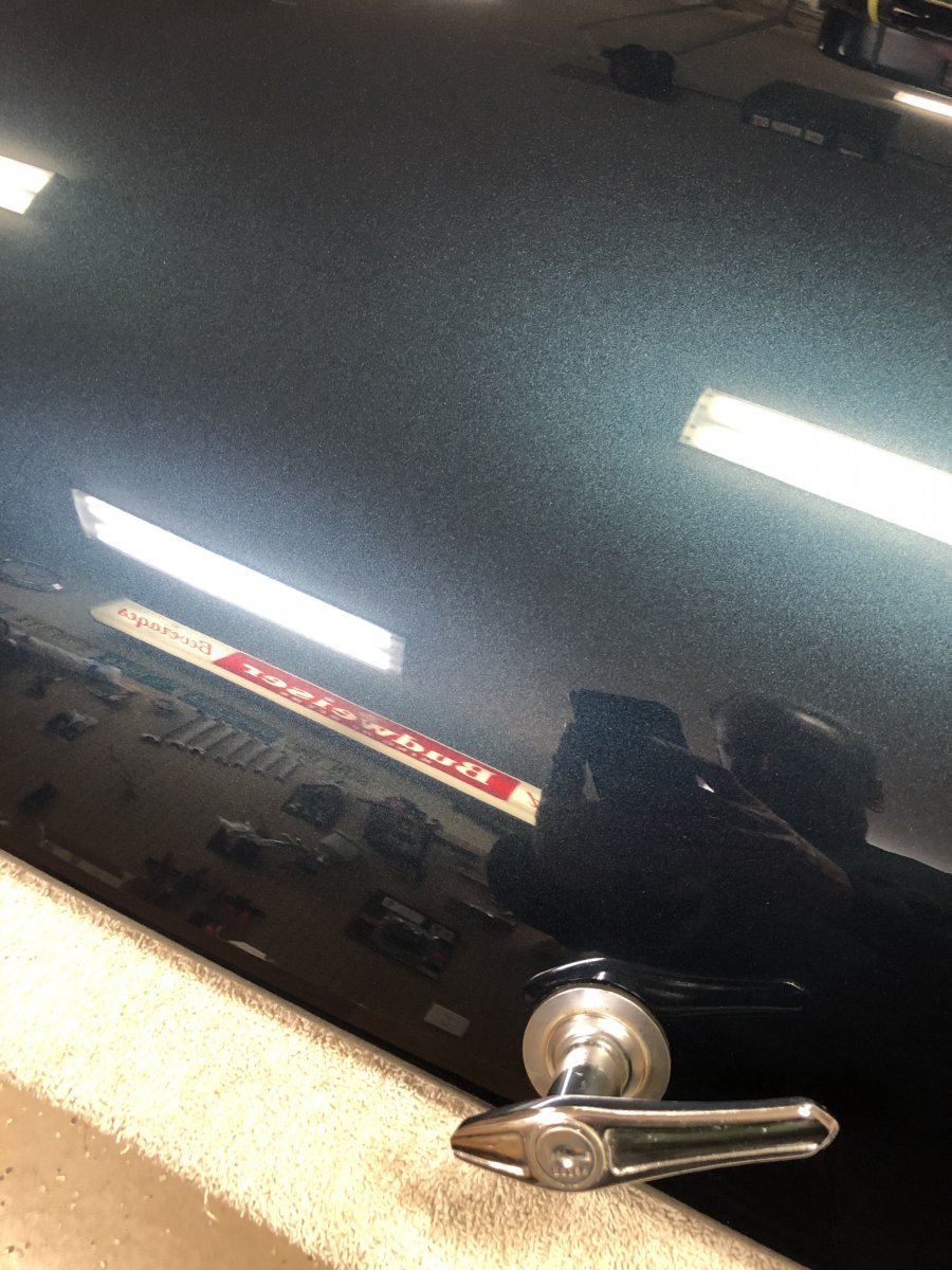

    The weather is now warmer so i can finish applying the clear coats. I am using a process called flow coating. It is a way to get a flatter finish . Flow coating is basically applying coats of clear and letting it dry a few weeks . Then wet sand and apply more coats. I upgraded to a better Matrix clear finish.
    IMG_3574.jpeg IMG_3575.jpeg IMG_3577.jpeg IMG_4832.jpeg IMG_3585.jpeg Last fall i applied two coats of clear but i could not finish because of the cold weather.
    I removed the body so i can wet sand the clear coats. I will apply two more coats and then i can start the final ***embly of the car. I finished the doors and grill.
