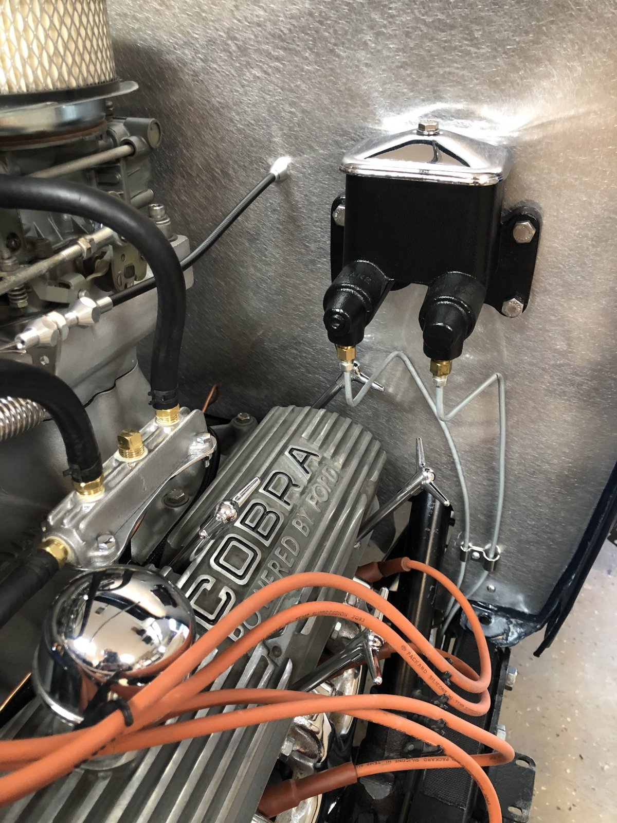

  15. The mismatched size Kugel Clamp below the MC sticks out
  16. ModelARon
    Joined: Jun 14, 2017
    Posts: 364
    ModelARon
    I have to hide this post from my wife
  17. ModelARon
    Posts: 364
    ModelARon
    I don't like this mismatch size . But i will keep looking for a better one

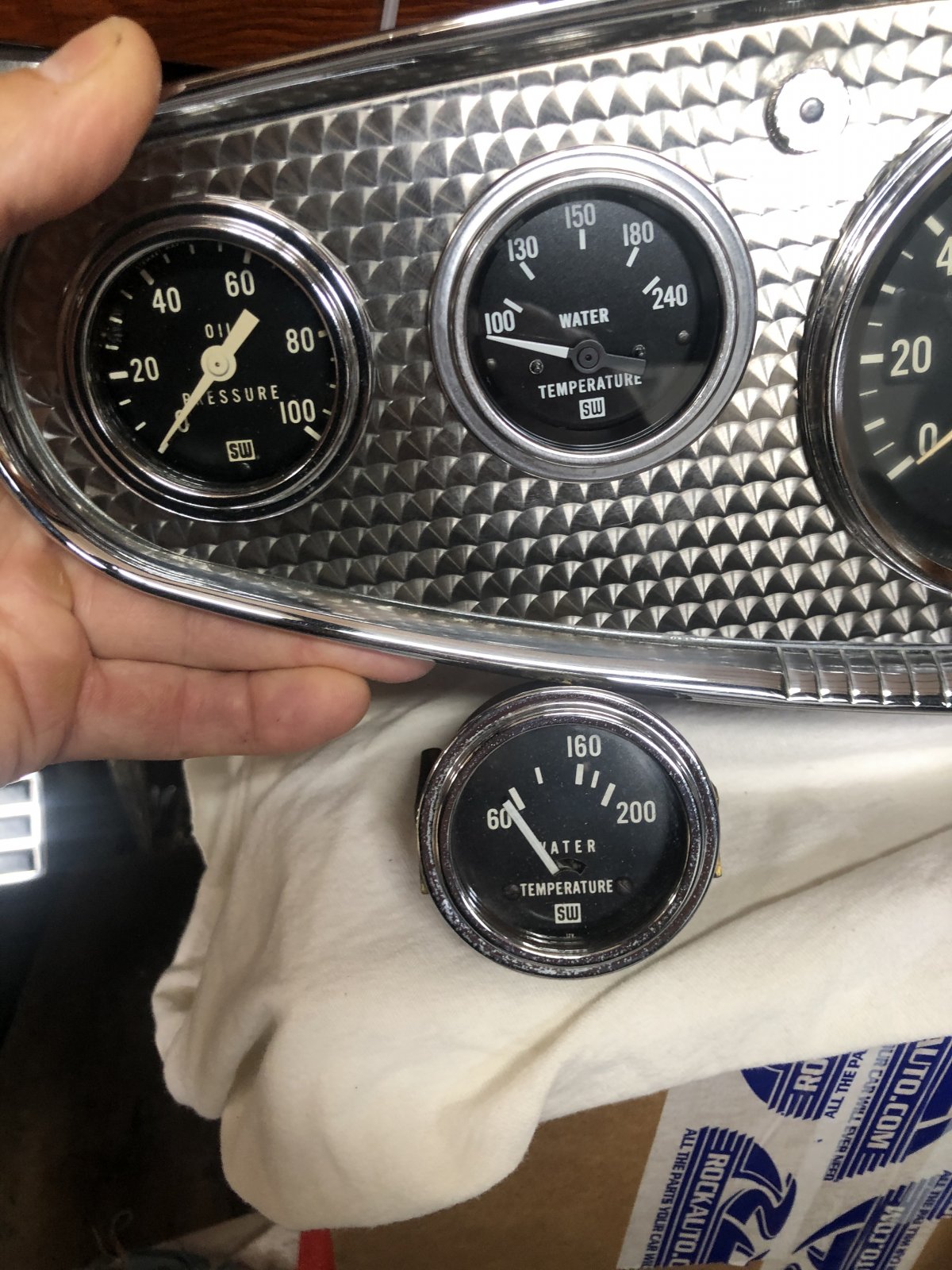

    The water temp gauge is not working. I benched tested the gauge to make it work but no luck.
    So i installed a new one. I like that the new one has a better temperature range up to 240.
    Also installing a new temp sender to be sure the ohms match and i get the correct temp reading.

    Have you considered swapping the old bezel onto the new gauge? The old chrome does look better
    Roger Loupias and loudbang like this.
  22. alchemy
    Joined: Sep 27, 2002
    Posts: 23,467
    alchemy
    The newer bezels are stainless, not chrome. They can be buffed more to increase the shine, but the color might be different from the chrome.

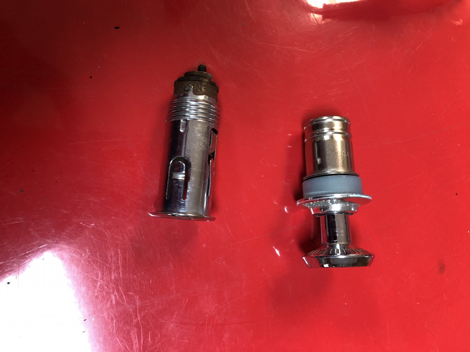

    The cigarette lighter did not work. I guess that was a must back in the day.
    I will put in a new element and socket and keep the old knob.
