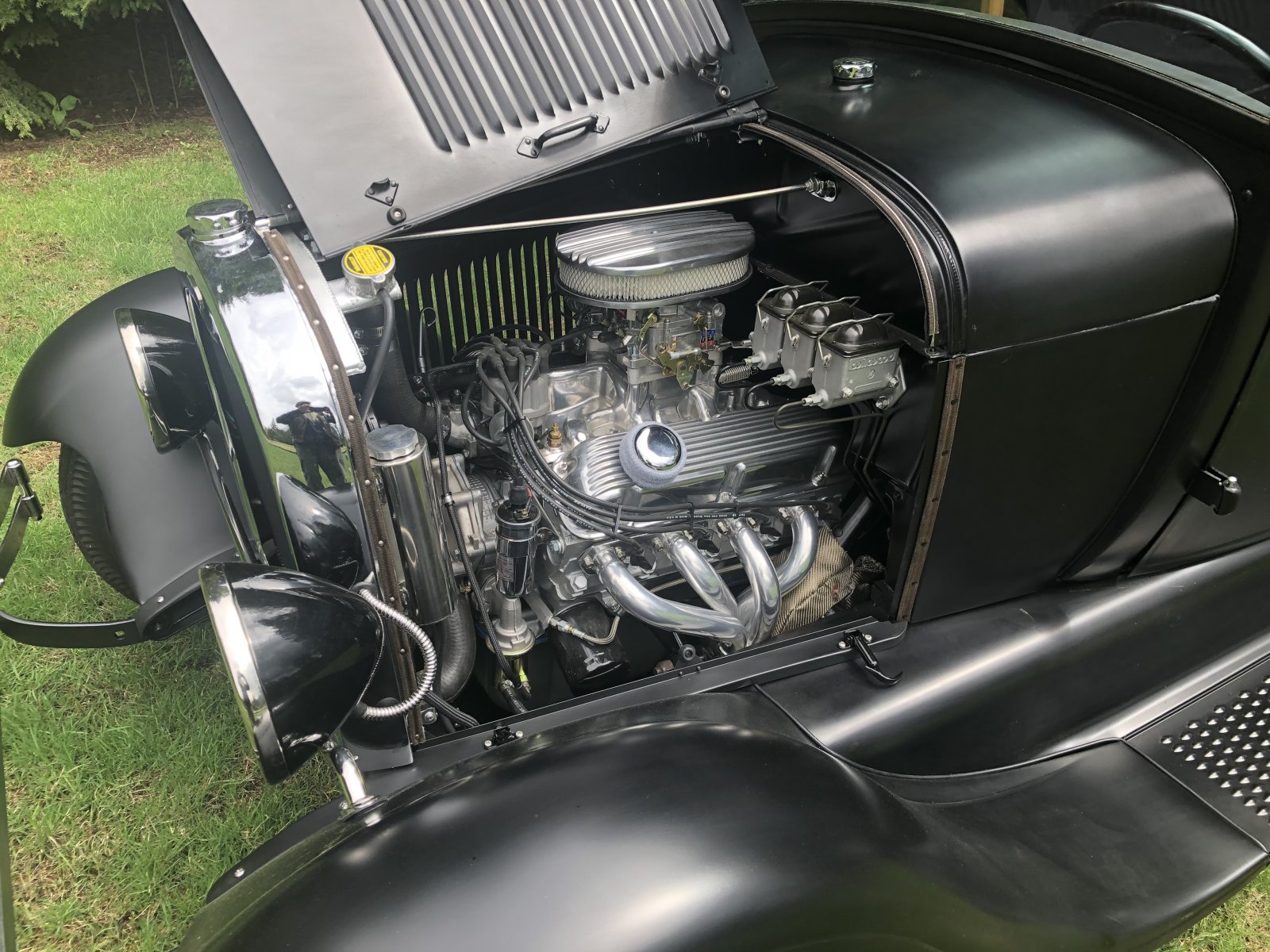

    In response to your questions

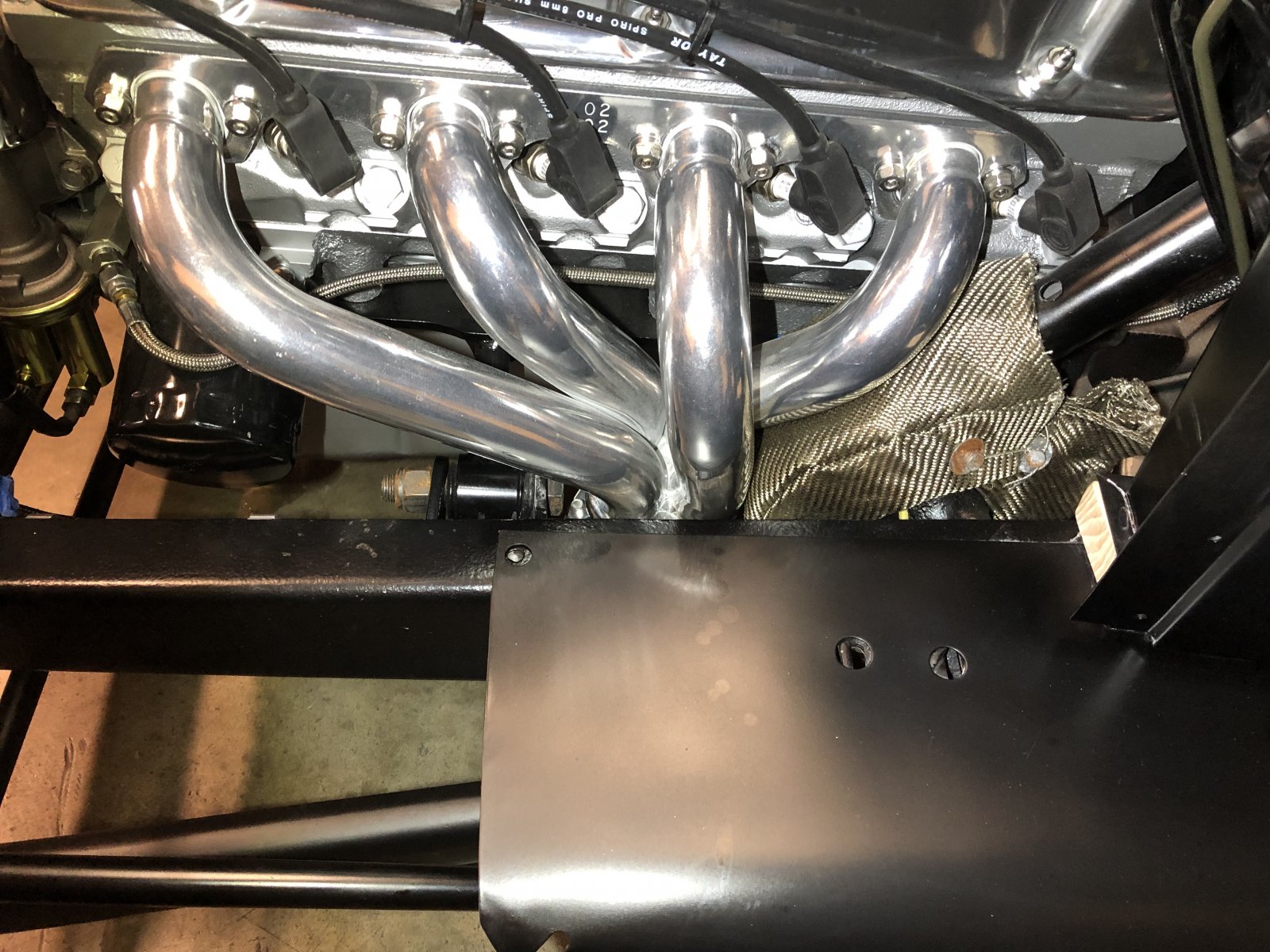

    The reservoir is a 3” dia. X 12” long stainless piece. Due to having so little room in the engine compartment I had to run an electric cooling fan with a thermostat switch that turned it on and off. I prefer the look and function of a conventional fan but I couldn’t make it work. I never had any issues with this truck running hot or overheating.
    The radiator cap is a 15 pounder on a new aluminum radiator
    Concerning the “turbo wrap” around the steering box: I didn’t have space for the engine headers, engine mounts along with the steering box all in the same tight quarters. I shifted the box location back about 2 1/2” inches but that changed the steering column angle and it pushed the steering wheel up into the cab and against your chest. So I rotated the steering box and shortened the column and shaft. Just the same I only had a fingers width of clearance between the header and the box hence the cover. I was concerned about cooking the grease out of the box. I also paid a “Performance Coating” facility to coat the “inside” and the outside of my headers to help bring the temps down. The combination works well with no issues. I want this truck to live for another 92 years

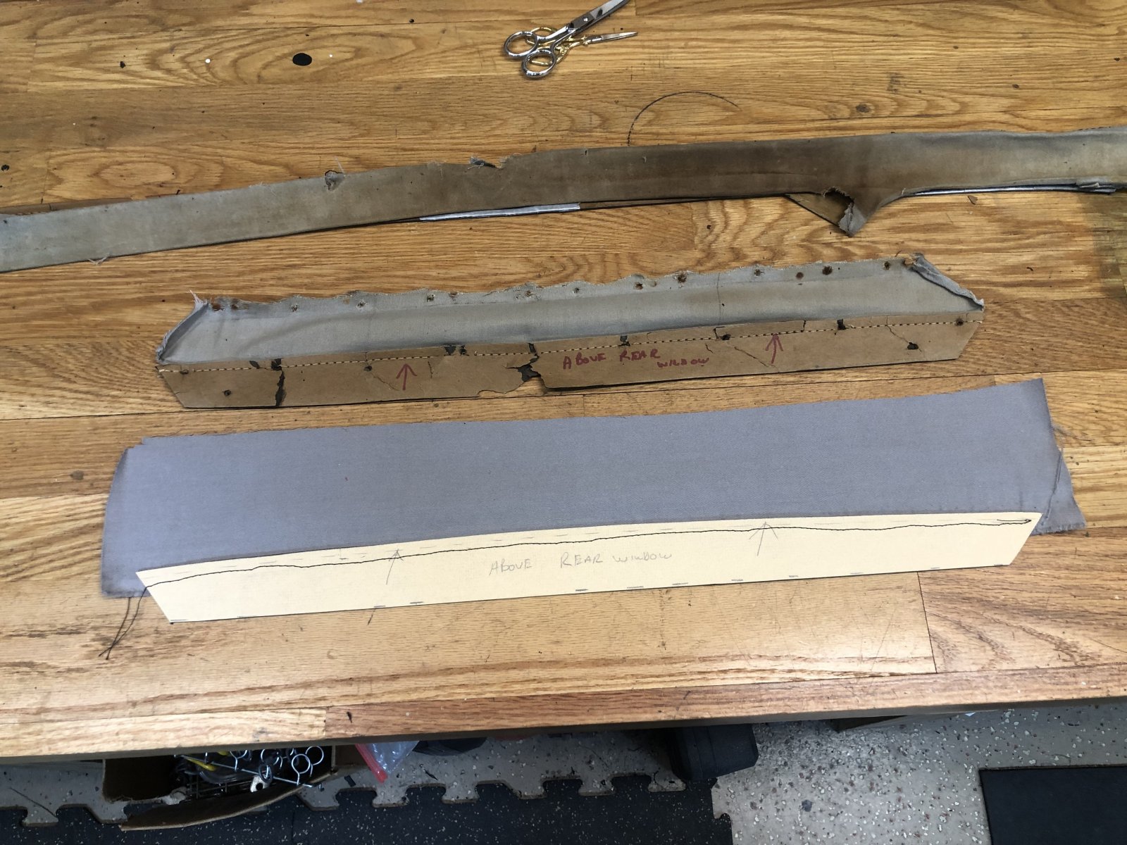

    I am making some progress . I installed the gl*** windows , the old quarter IMG_5116.jpeg IMG_5117.jpeg IMG_5118.jpeg gl*** had lots of scratches so i installed new tempered gl***. The gl*** in the doors have been replaced by someone over the years they are safety gl*** in good shape. Installing the headliner and interior fabric now. A family member is good with a sewing machine so that is a big help. I have saved all the old fabric and cards so i can use them as templets if needed. This is a first for me and it's a pain to get the fabric to look nice.

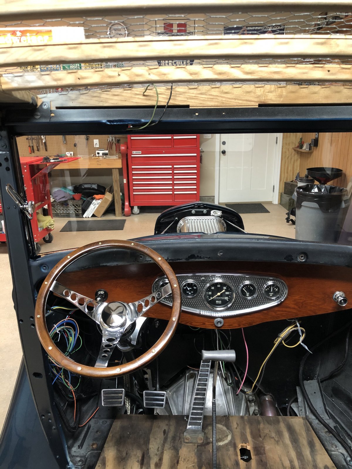

    I am working on replacing the boards that hold the door and kick panel material.
    The panels are warped so i am installing new ones. The first panel i took apart has the Road Runner name written in glue. This was the name of the original builders club he belonged to . IMG_5162.jpeg

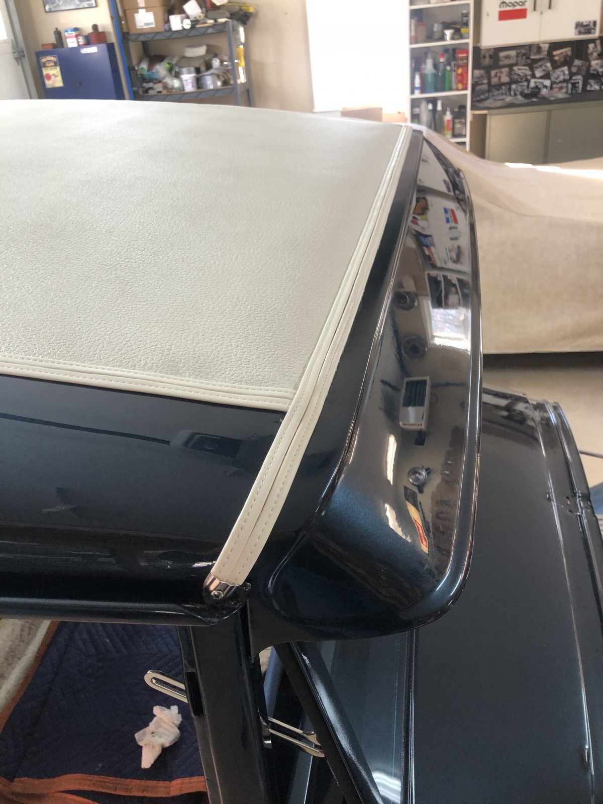

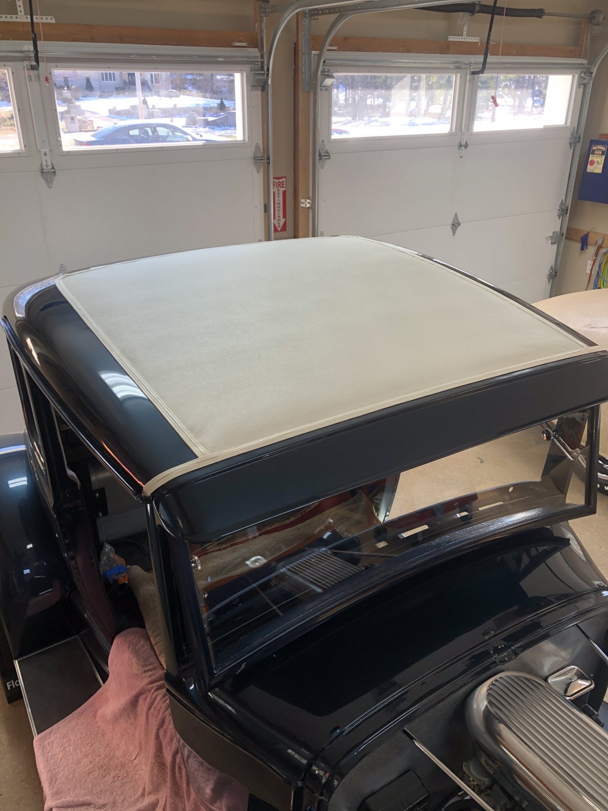

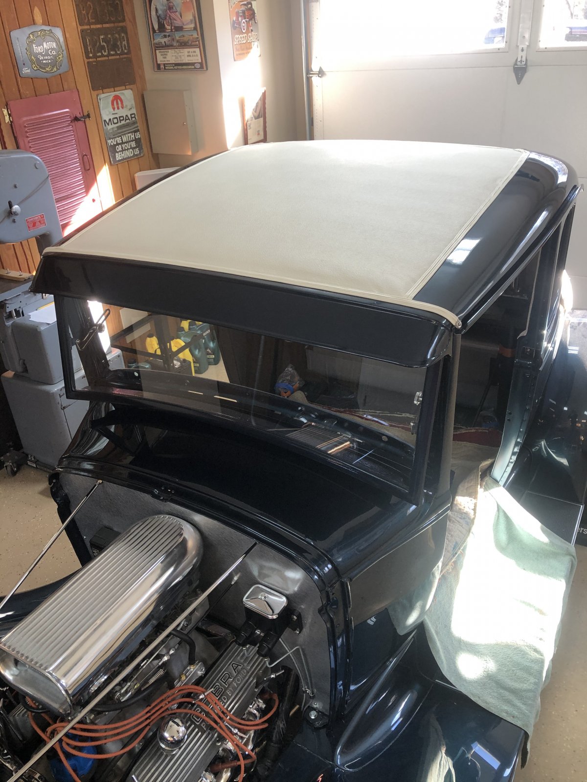

    I finished the top. I used some strip caulk to help seal the top. I marked a plastic spacer to help find the holes punched into the metal roof. I used a nail set to help me to stay away from the paint. The nail set fits over the nail and the punch is inside 66464699966__4C44A9F8-EBAA-4E70-B9EA-2997A55C8977.jpeg IMG_5201.jpeg IMG_5207.jpeg IMG_5206.jpeg IMG_5208.jpeg
