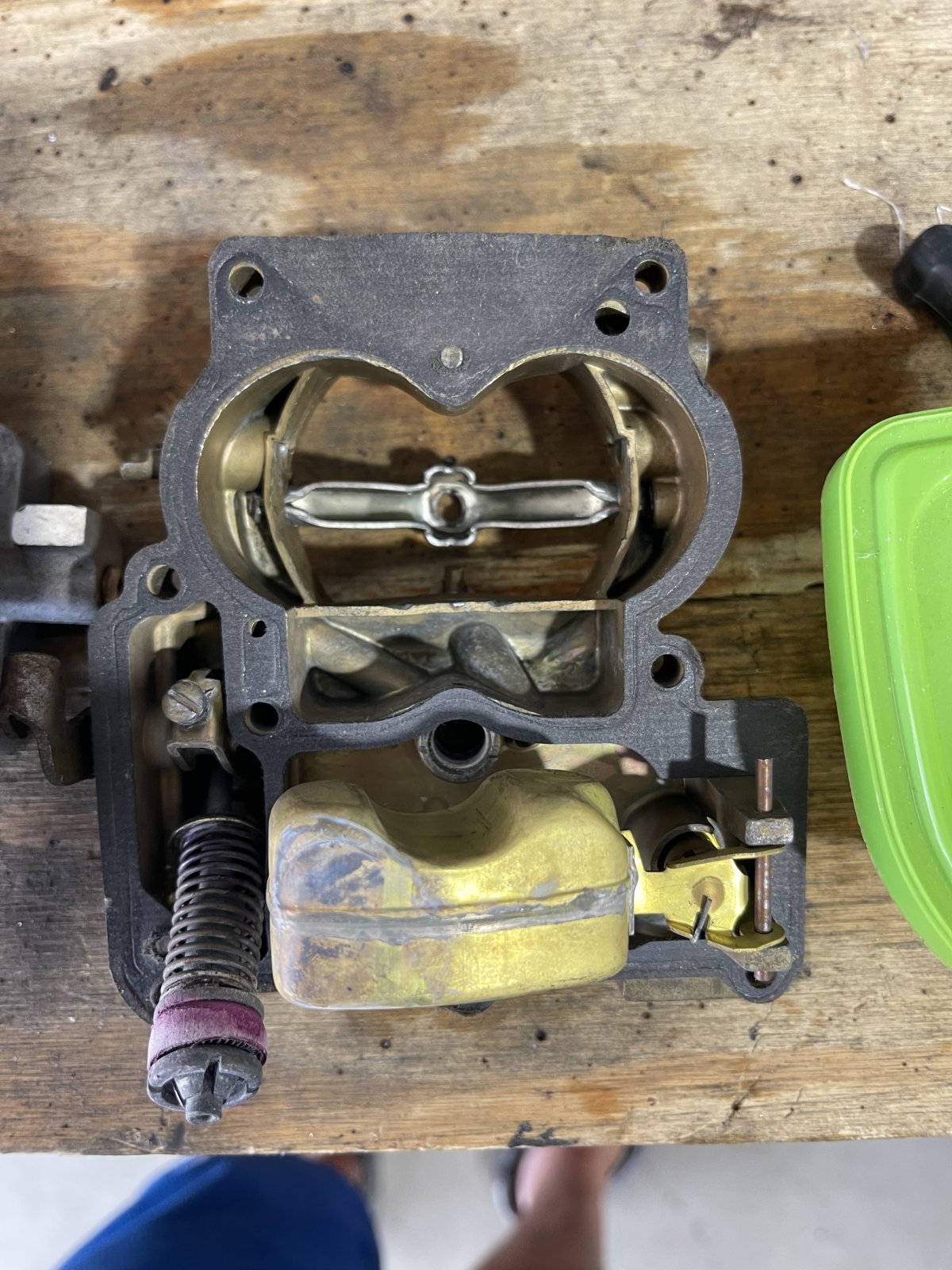

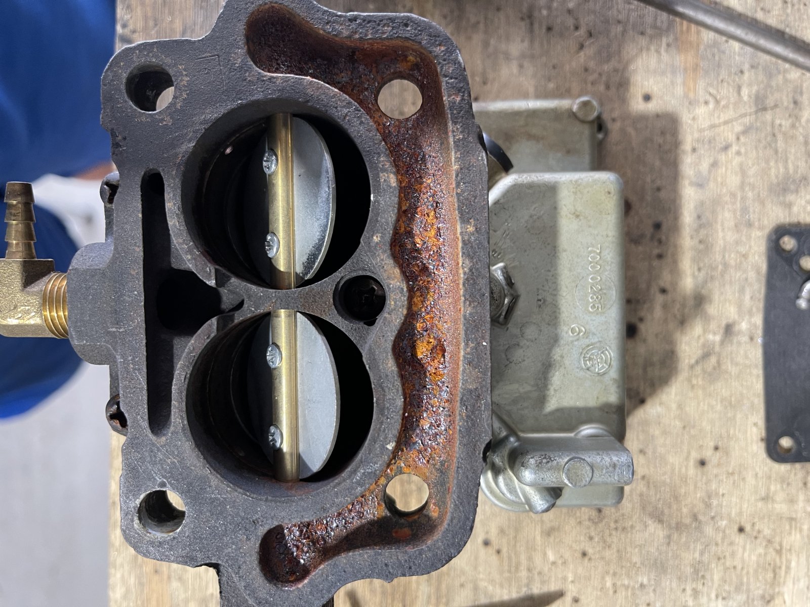

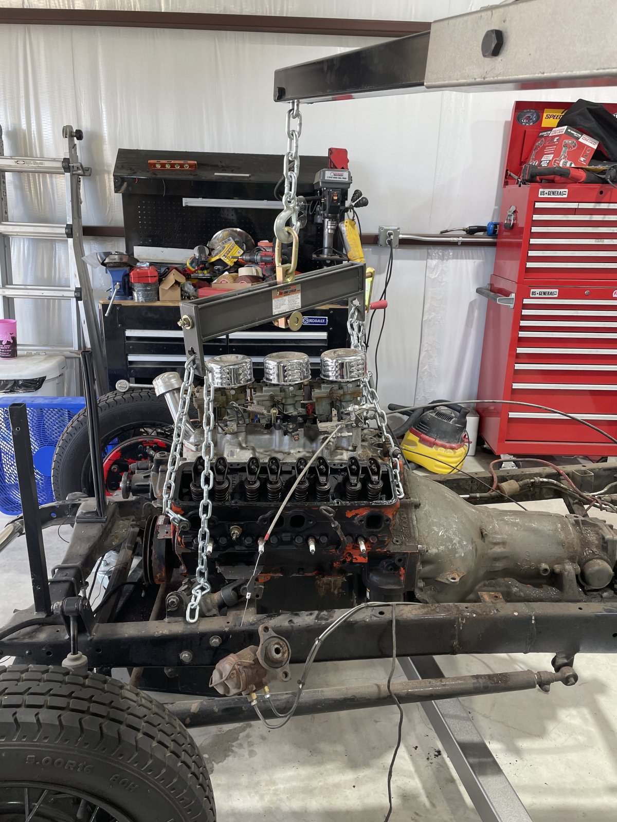

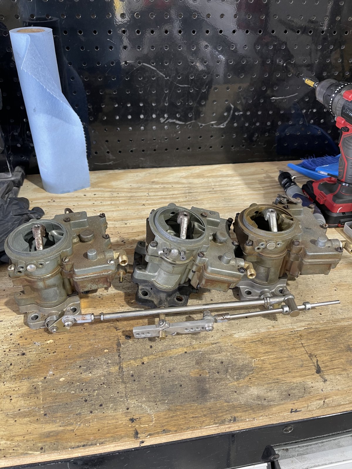

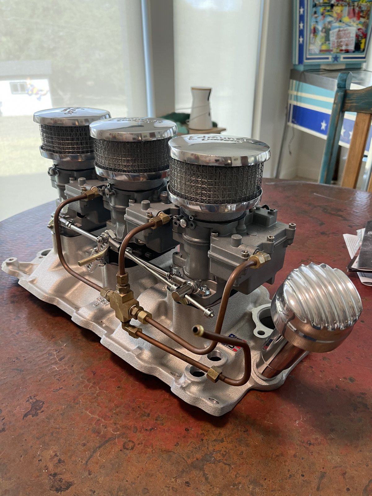

    Wow, real tri-power carbs! They look to be 1958 Chevy based on the front fuel inlet. Any info on that?
    John
  6. Hotrod31A
    Joined: May 20, 2022
    Posts: 119
    Hotrod31A
    Just rebuilt them, no tags and no stamped numbers so they are older than late 60s due to lack of a stamped number so I’m told.

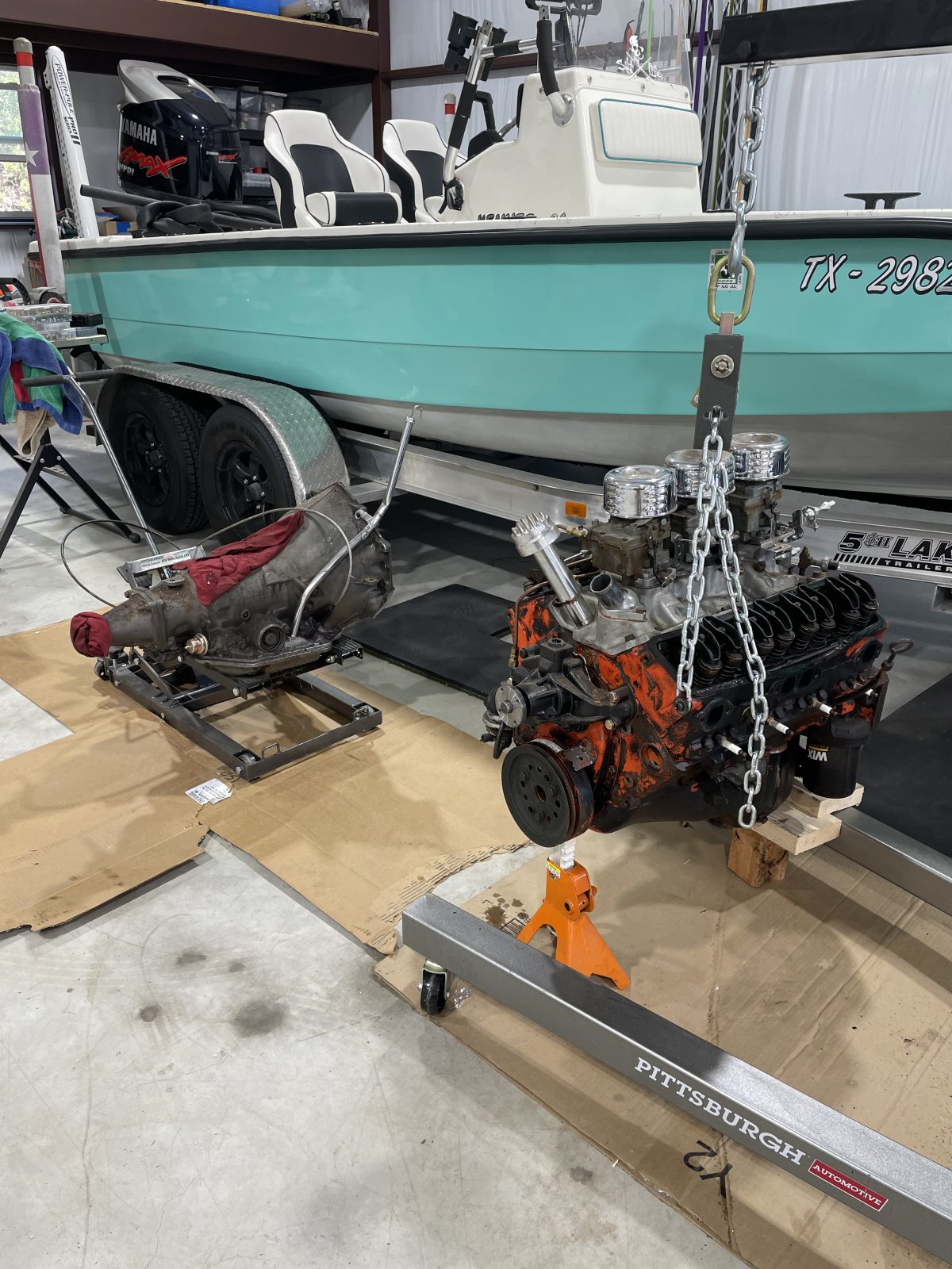

    Have the original 355 Edelbrock intake that came with the car that fits the 265 sbc.Swapped it out for a newer version that matches the intake ports on the heads. 4E4D42A7-846F-4C6A-B885-F5AC9FE89E7E.jpeg

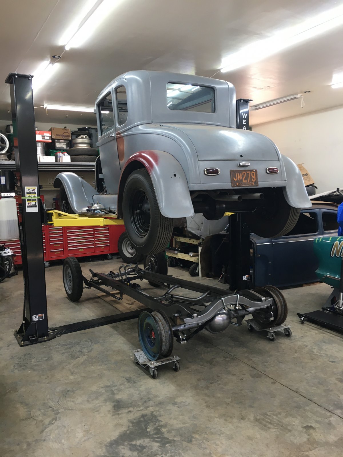

    Love your attachment to lift the body. Will do that with mine.
    31chevymike and Hotrod31A like this.

    Rochester started stamping the carburetor identification numbers in the bowls beginning in 1968 to conform to Federal smog emission requirements. Prior to 1968, Rochester utilized tags to identify the carburetors. Of course, the first time the carb saw a commercial rebuilder, it lost its tag.
    These do not appear to be genuine tripower, but great job on the work you are doing.

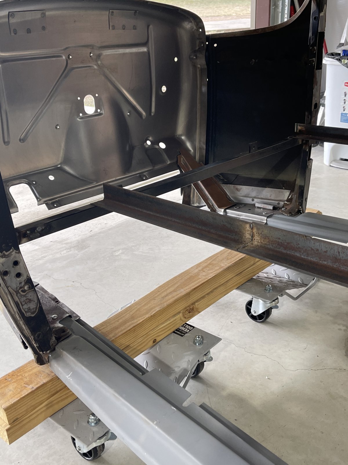

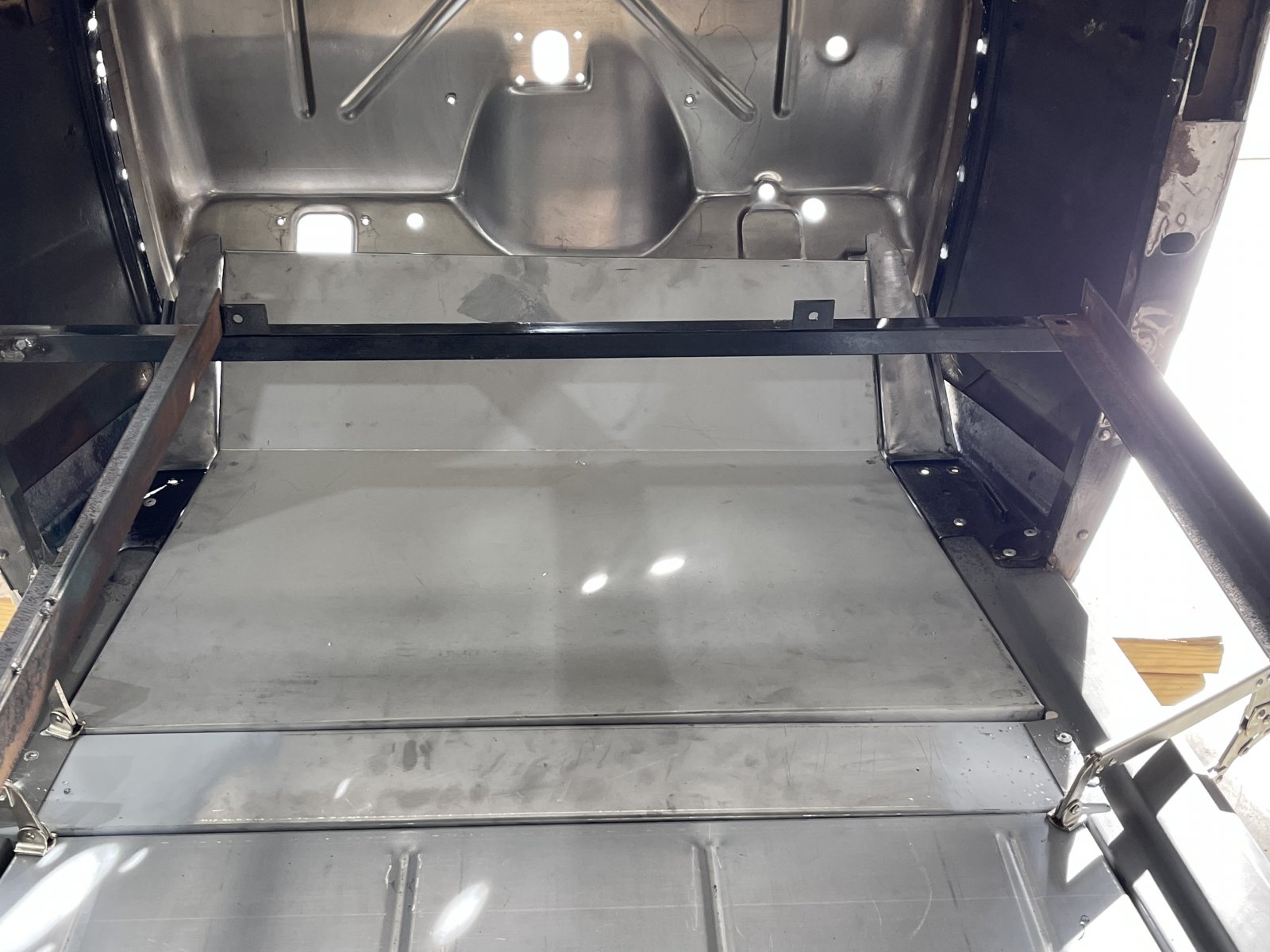

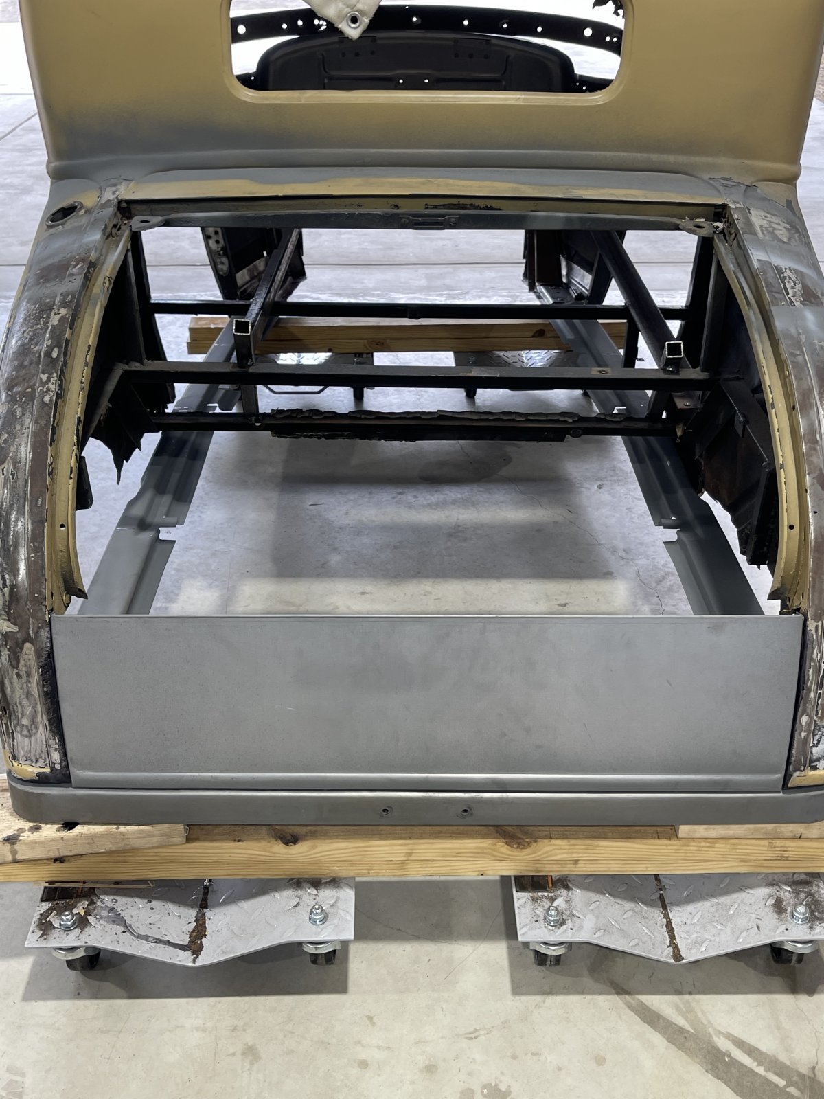

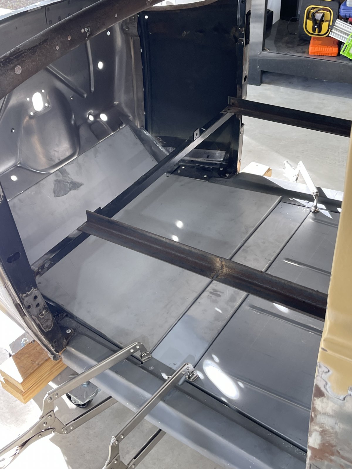

    Now back to more important stuff.. all day banger installing the drivers side subrail and both extensions. Everything is temporary pop rivet fit including firewall and rear panel. Plenty time for gap and final fit after frame arrives and they hopefully matchup. Measurements are at least on target from an old drawing I got off this site.
    Also sprayed the rails and parts with zinc rich primer and descaled and hit the rusty spots with converter anywhere the media blast won’t be able to get to.
    PSA —- WEAR YOUR SAFETY SHIELD when using the wheel of death. Had a cuttoff wheel snag a corner and explode on me. That could have been my face and neck. I knew better than to do what I did, but I got in a hurry and the results speak for themselves.

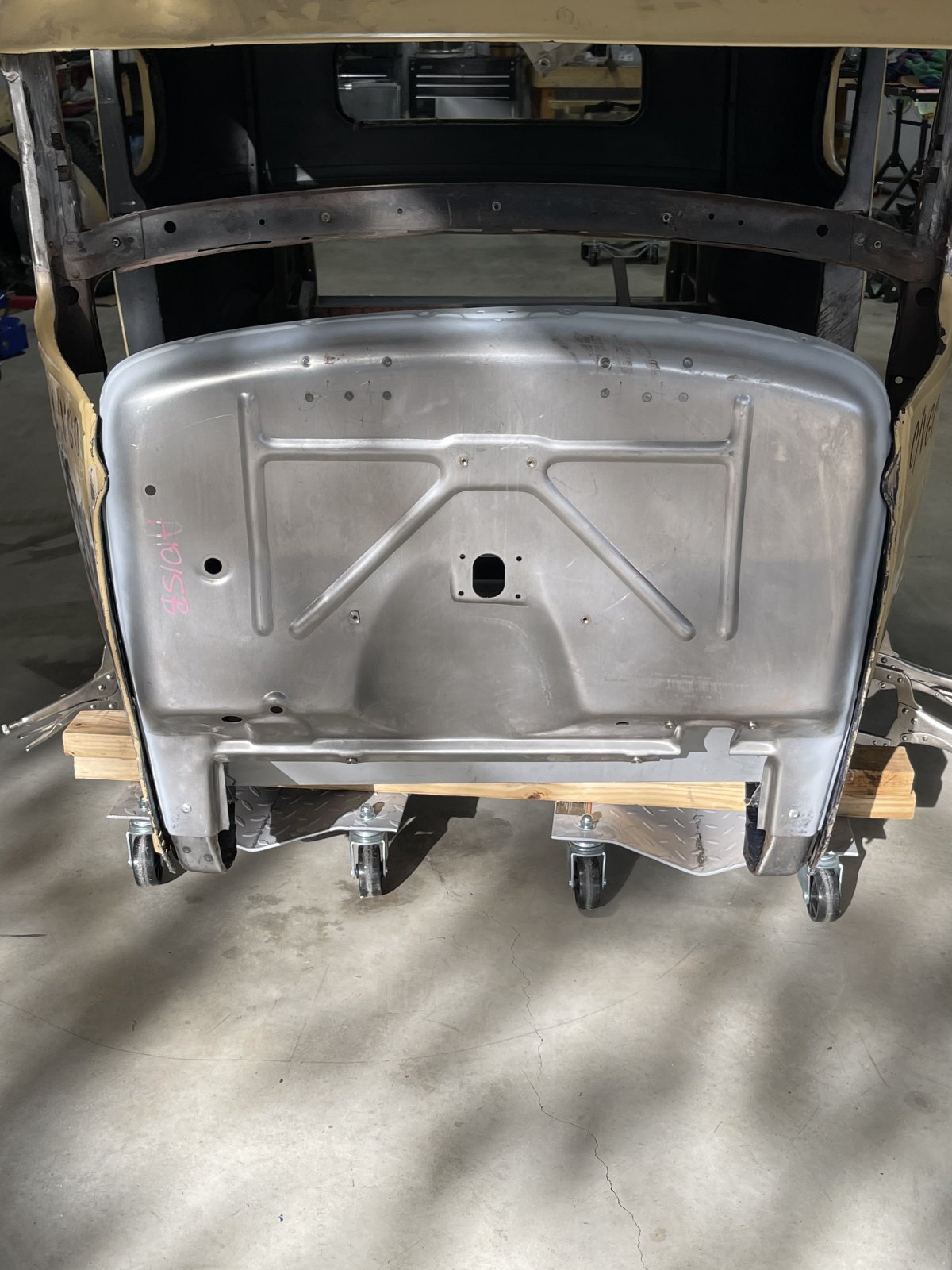

    Refit the extensions and toe boards , added cross sills and floorboards. She’s slowly coming around.
    3D14C166-F682-48B4-9D3B-7A034C291A82.jpeg A9E2761F-1AD5-4B61-A2EE-1E046D474064.jpeg CFA337BE-9645-4817-A2D1-F14D3F2C0CDB.jpeg 5B201147-1144-4F01-B788-26B5D1AFF822.jpeg
