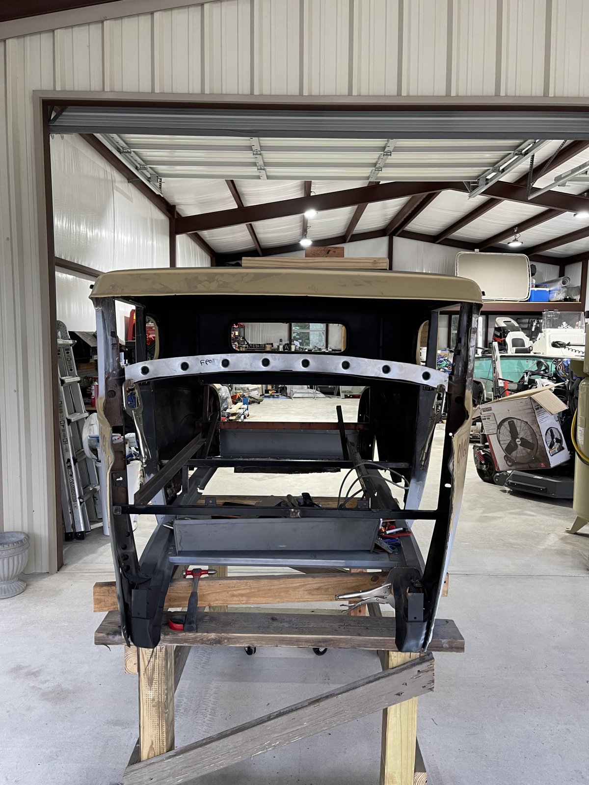

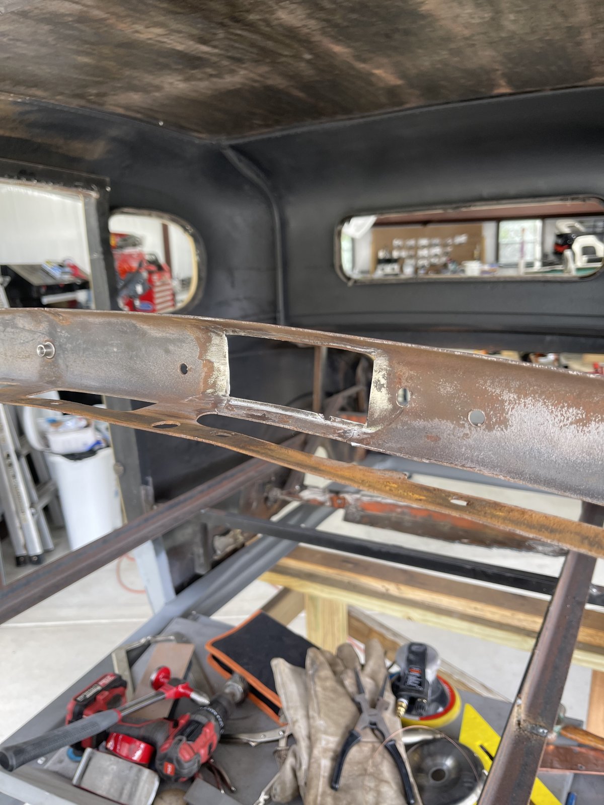

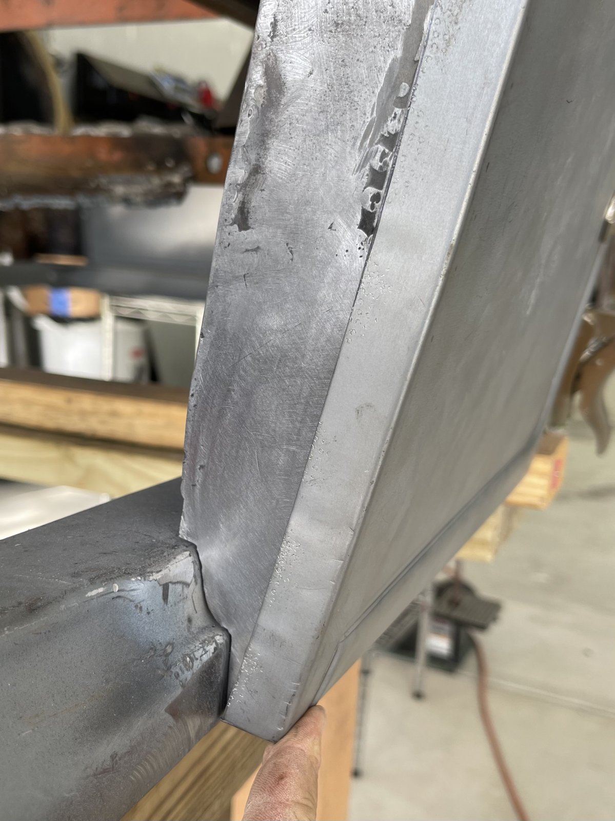

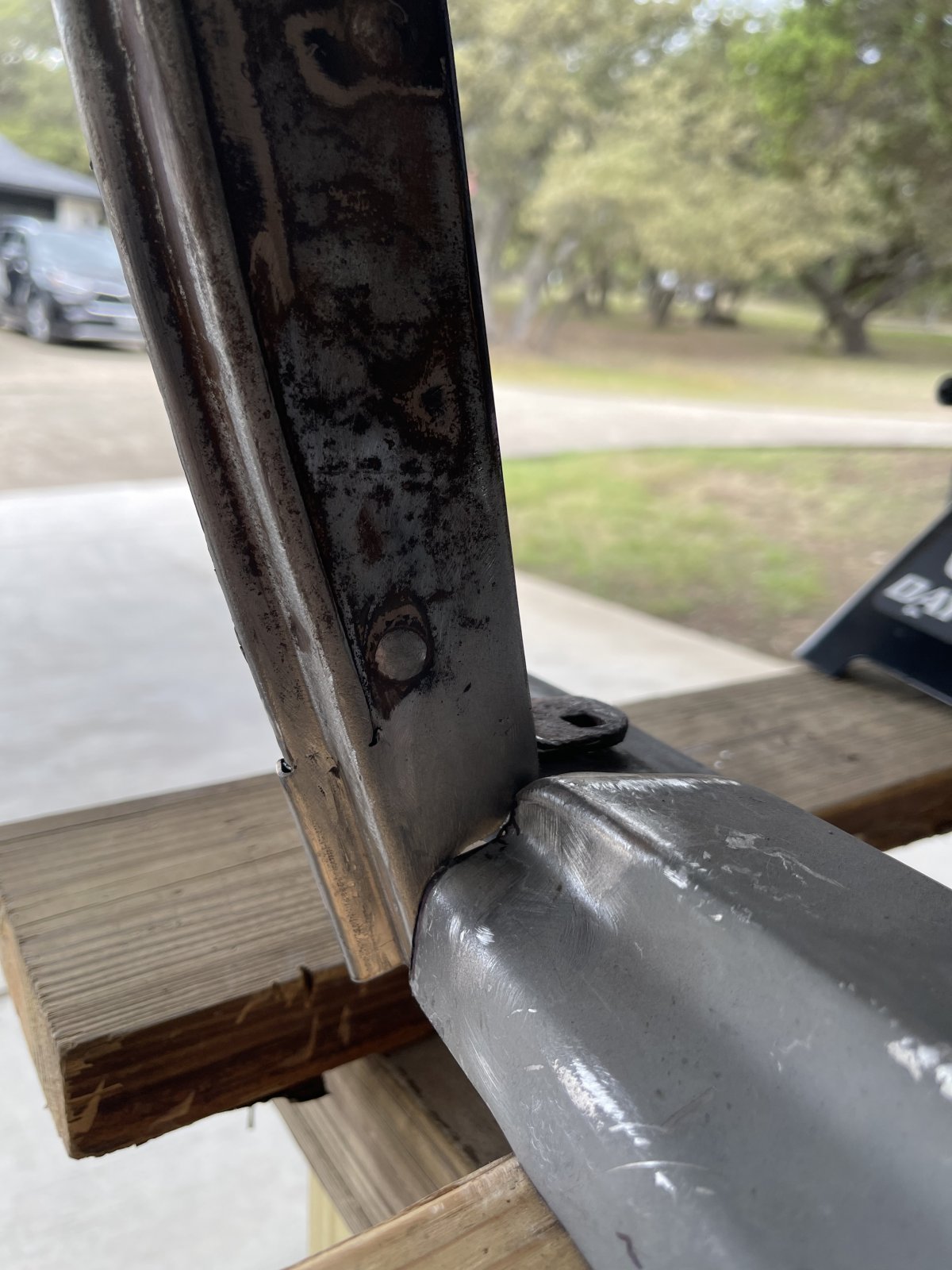

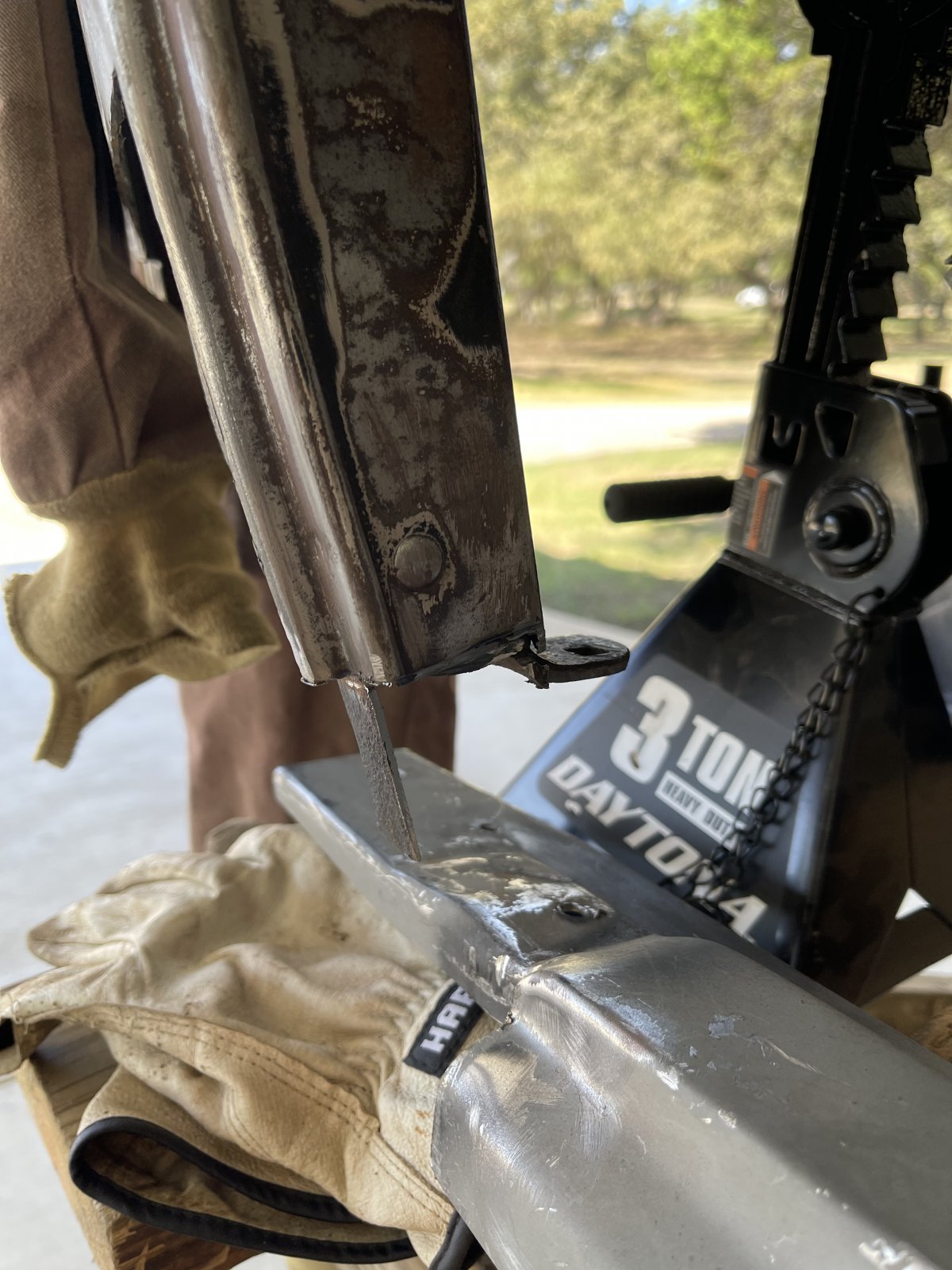

    Back on the job after calling in sick lols.

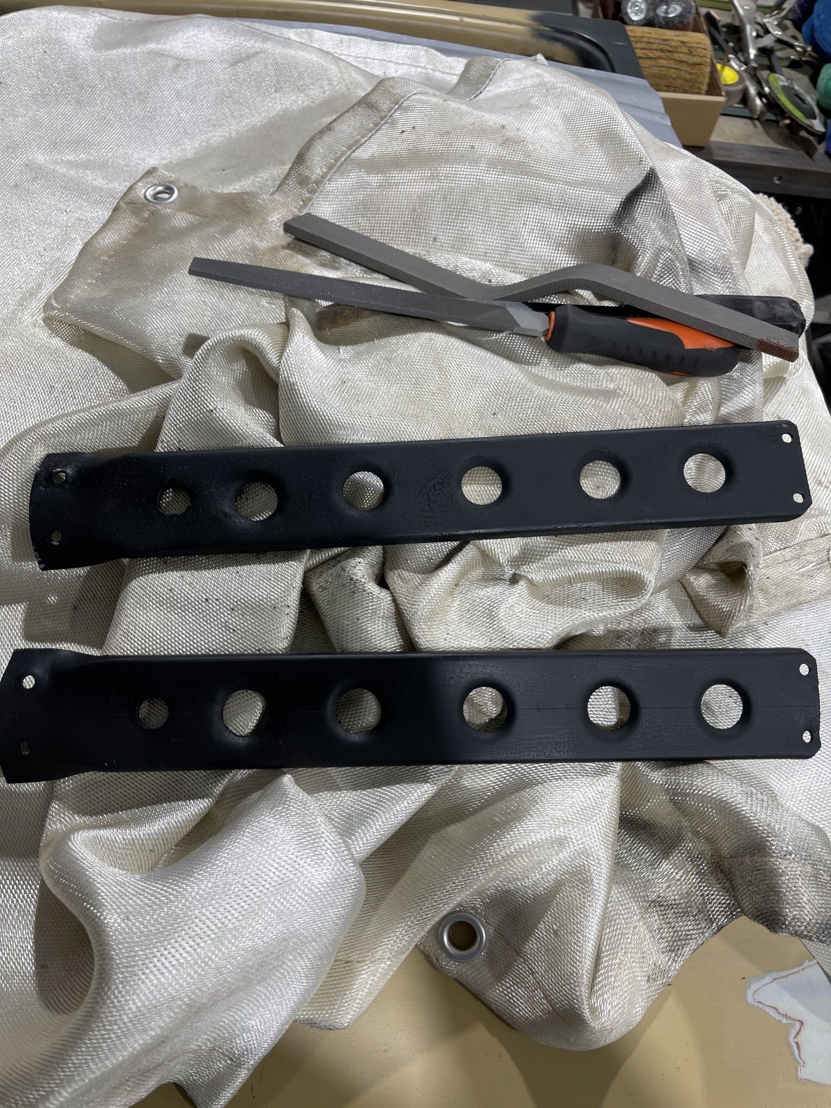

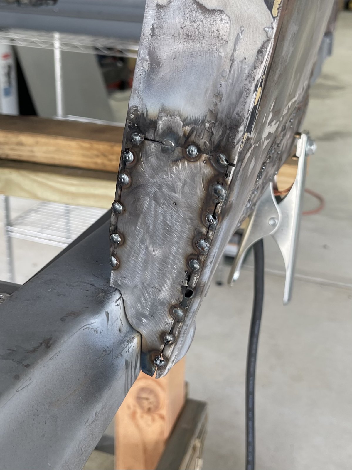

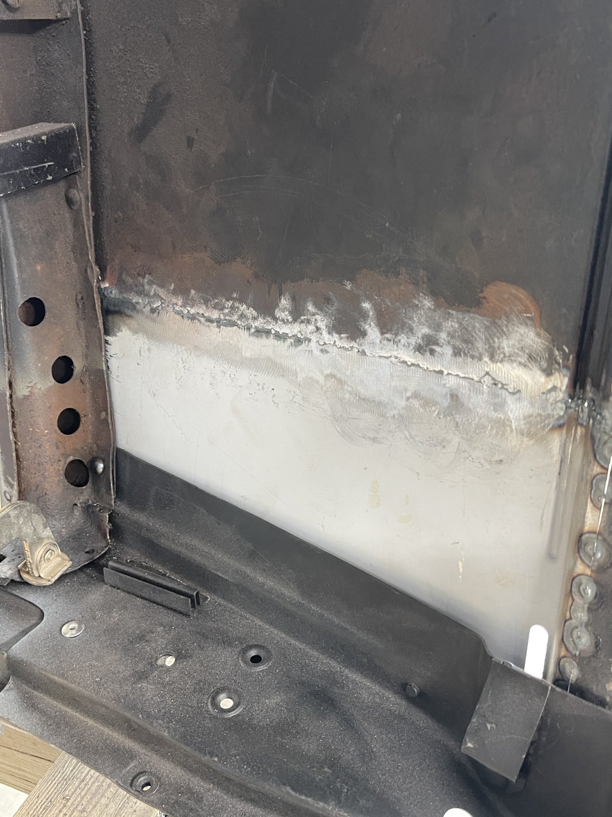

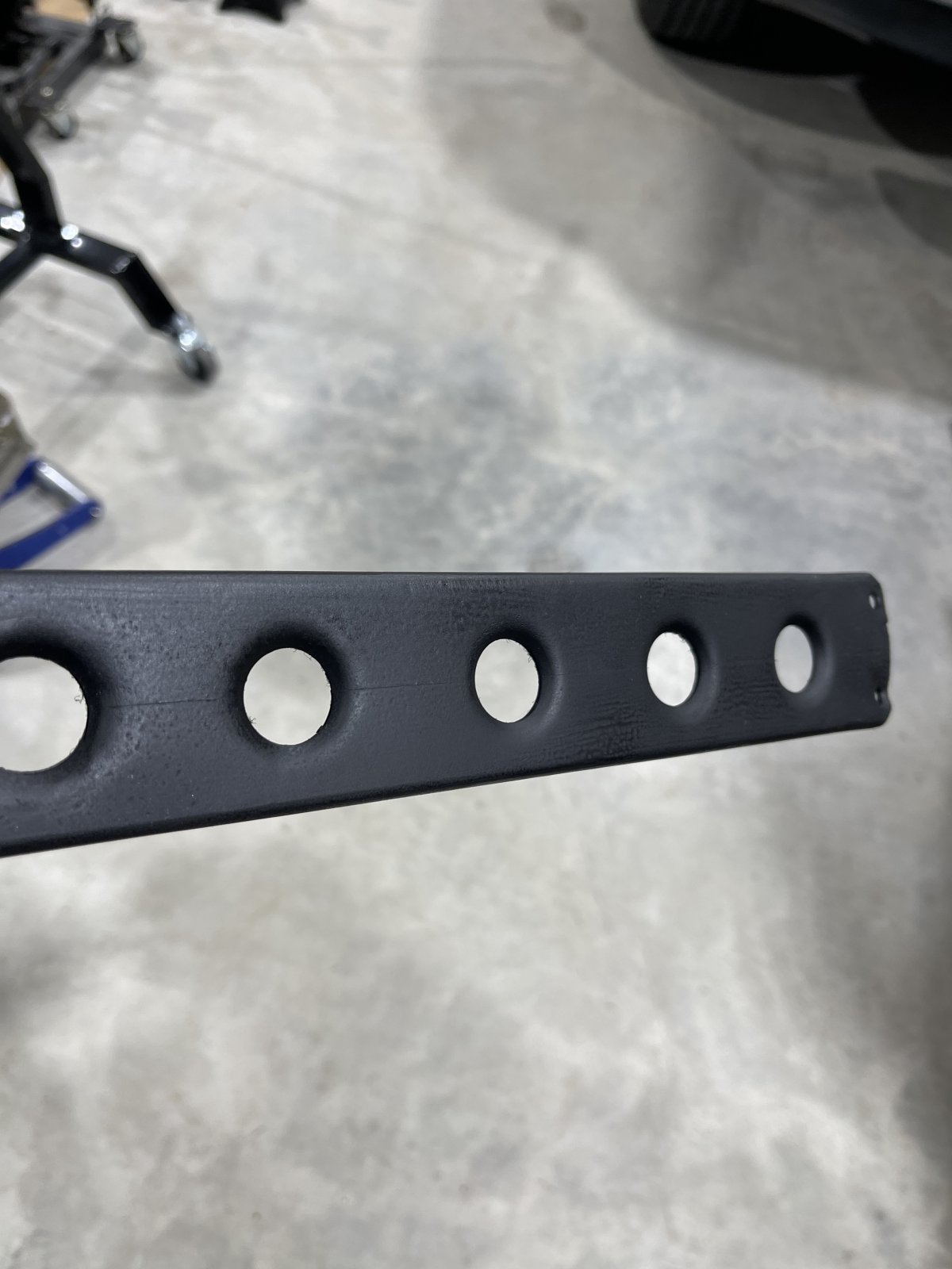

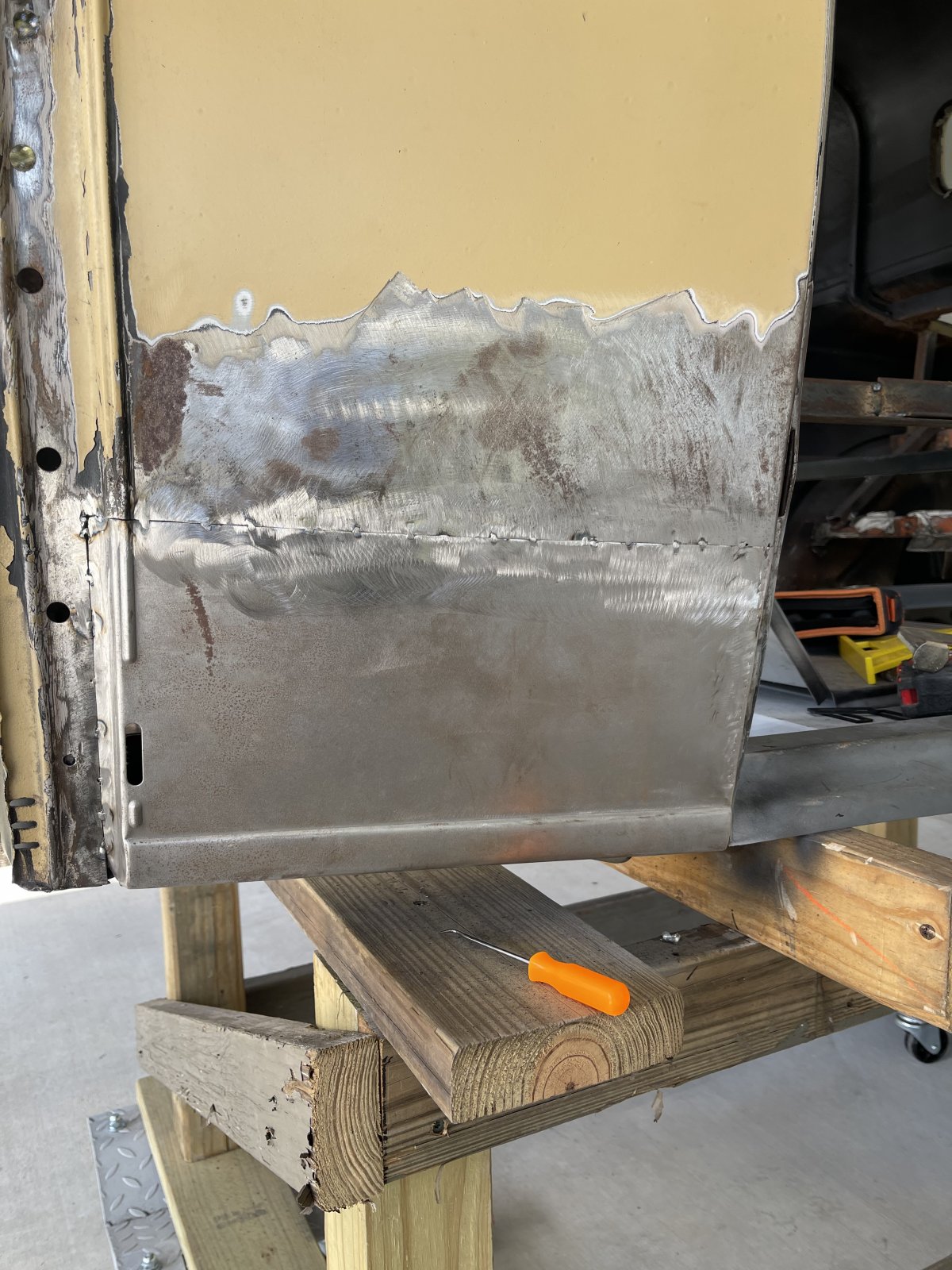

    Some dimple die mods for the firewall braces and my first hand made patch for the door jambs. Not sure my grinding skill can overcome my welding lol.
    Had to bail on the tig welder this time….
    F8AAB46C-4A2B-43F0-A0F3-78884CC5AF86.jpeg B04F9666-F5E5-4DBE-8D37-01A714EA3D87.jpeg 07886109-D351-4F6A-B9C0-21A45B66FCB5.jpeg 03CF73C2-C375-4CE4-986E-16E060D478AD.jpeg 14512AC2-24F7-44CD-9D52-CF9A6E9D5761.jpeg D50325B7-7506-4FF1-91E5-B880D0827943.jpeg

    Holy ****....now I know why you're so eager to keep progress going without the frame!
    Anyways. Progress looks great!

    Yeah this things like a bad onion, the more I peel….worse it gets. Have a **** ton of patch panels to weld in. This ole girl has more plastic than Dolly Parton haha.

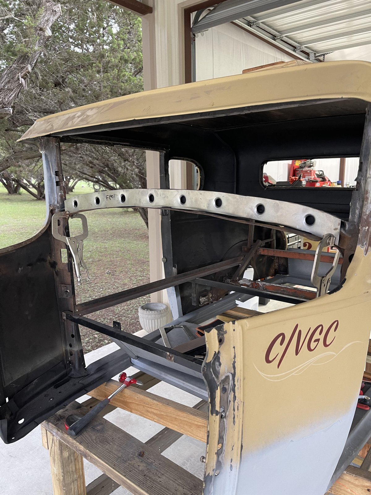

    Small amount of work today. Waiting on a pulse tig to arrive before I dive into body panels. My $200 ebay tig runs too hot even for a tight weld seam. Using mig but it’s eating twice the number of grinding discs.

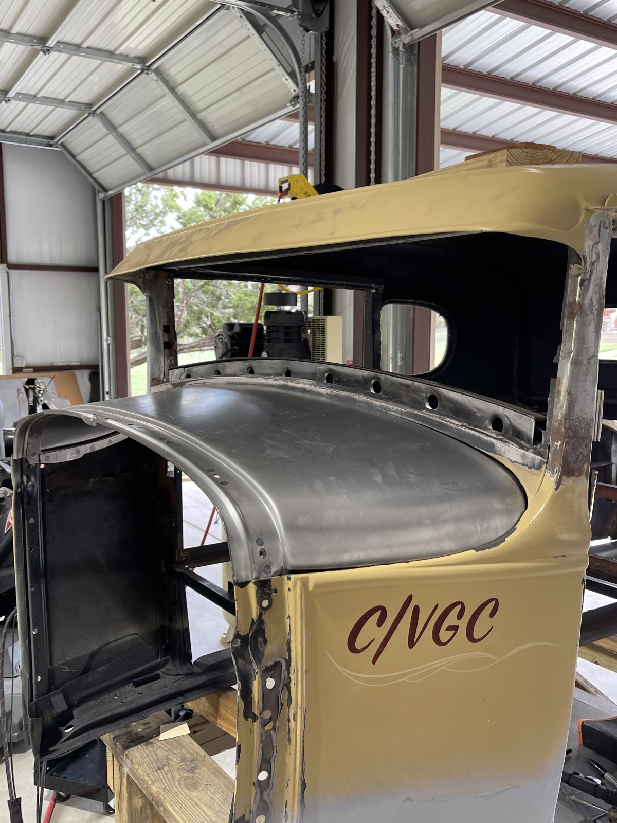

    Made the drivers front A pillar patch, next up is the cowl patches after welder gets here. 716879CF-297C-4AAD-8D50-6754D3BB25C5.jpeg 669EBC26-2E90-4D1A-86BB-52DDC5B6728B.jpeg FA1F552C-515E-465A-AD21-3433B33B1811.jpeg 83FA09C5-FEA0-408B-837D-D5021D011012.jpeg

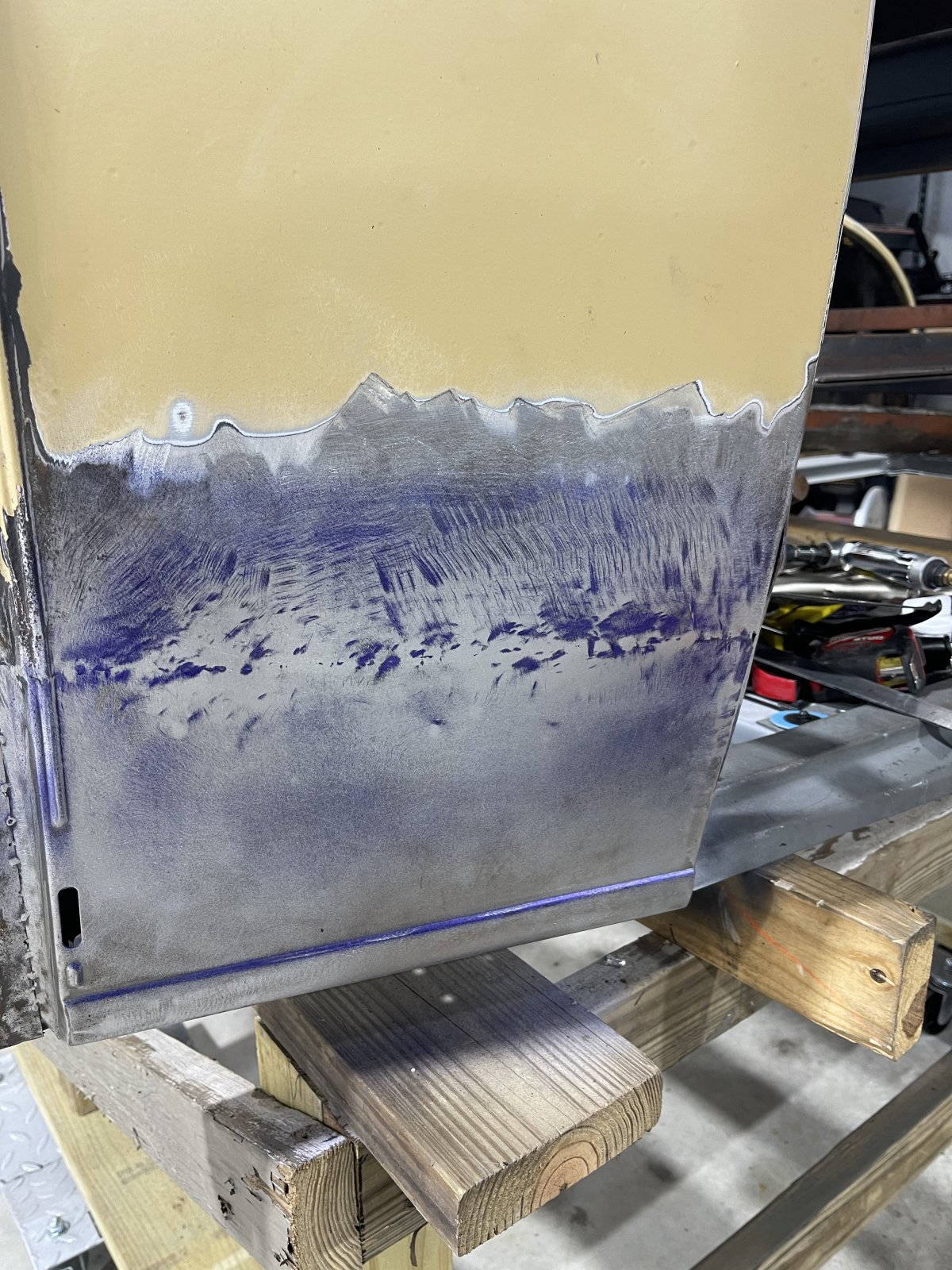

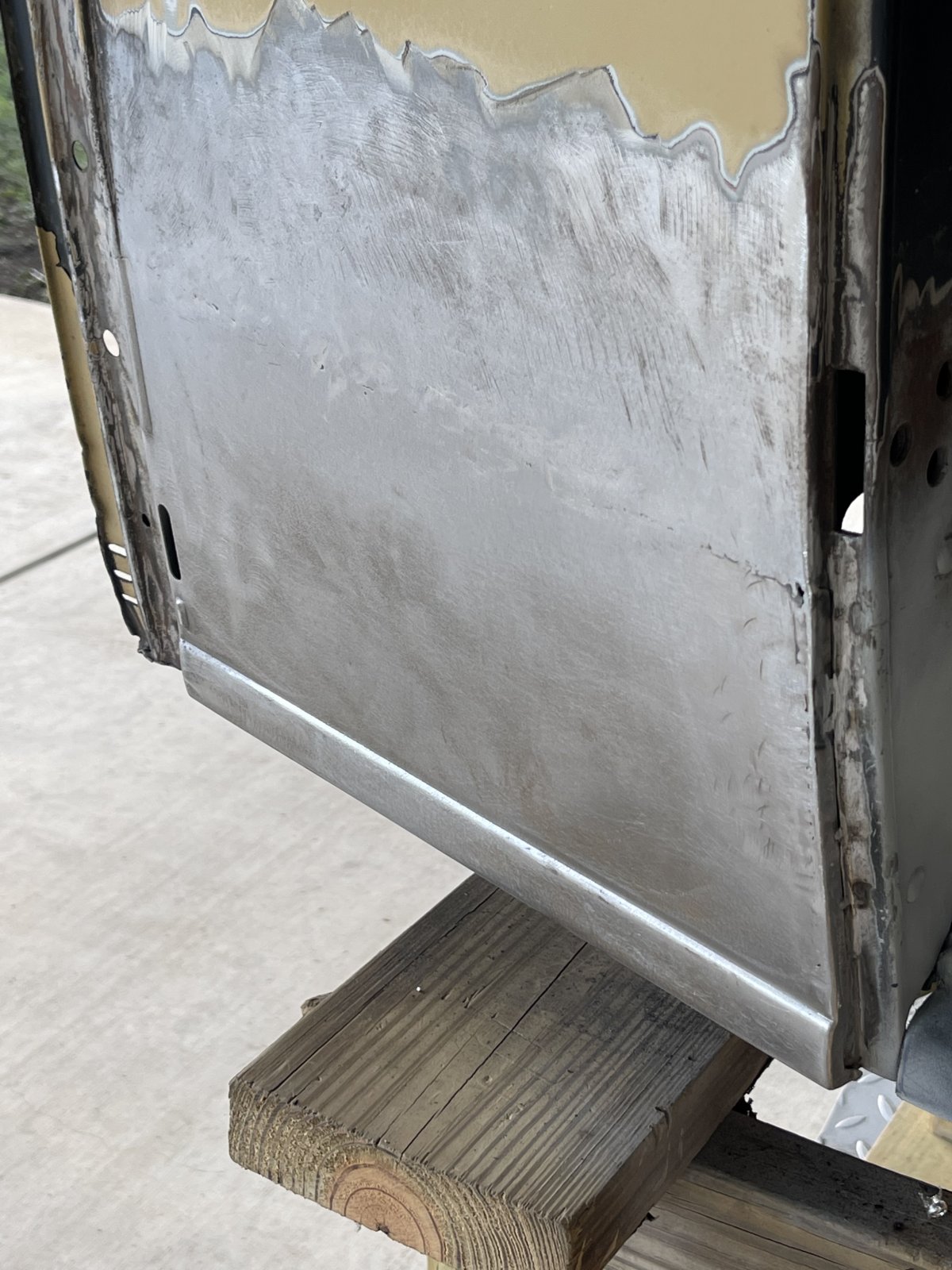

    First patch panel almost done. Needs finish tig on both sides and some cleanup of pinholes. Liking this pedal tig! Panel beating in my future to get it back to Henry.

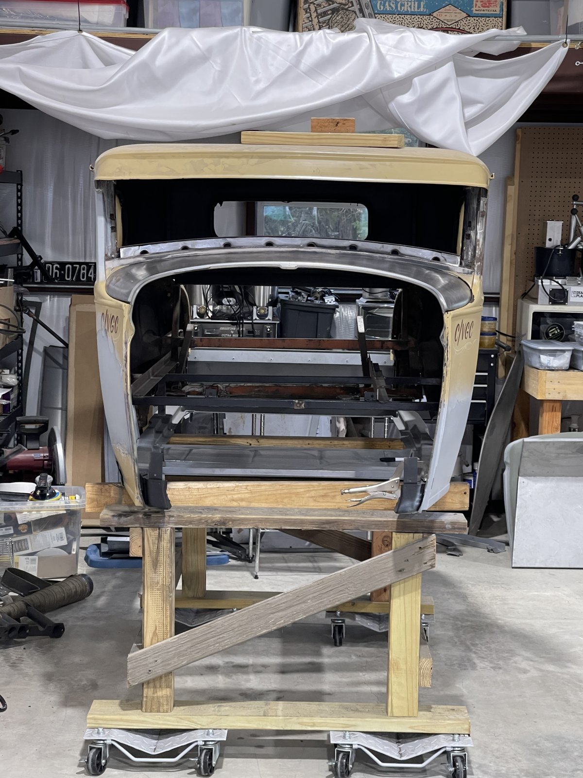

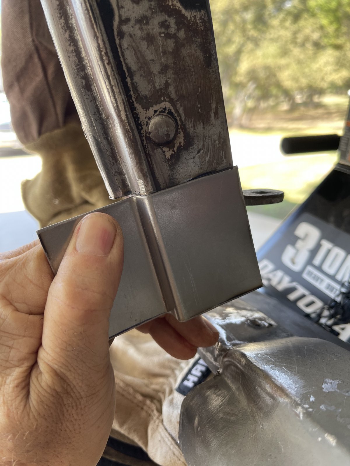

    Another step…. Metal finished the cowl patch and it’s time to move on. Will make a final tune up and finish once all panels are complete and I can focus more on the little tweaks.
    Decided to fab a filler panel while repairing the header panel. Think I may keep it if I can get a clean fit with the dash and cowl filler., BCC593DC-AED1-4251-8320-080CF26711AF.jpeg 04291293-C8DE-4C54-9BE8-0428D5601766.jpeg FD7C5AD5-4444-466D-825E-C563D2261390.jpeg 0D295DFB-B4F7-4231-9299-143322C1B0B5.jpeg

    Finish welding and mockup. Think I’ll keep this modification. 33C1E074-C3D3-4CCB-9688-9644B9B6193A.jpeg 6D55572A-AF5D-4DED-831D-E16807E339D8.jpeg
