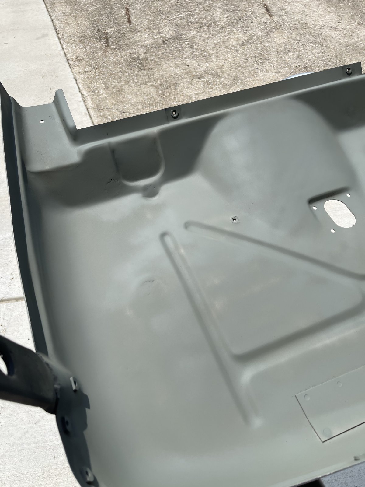

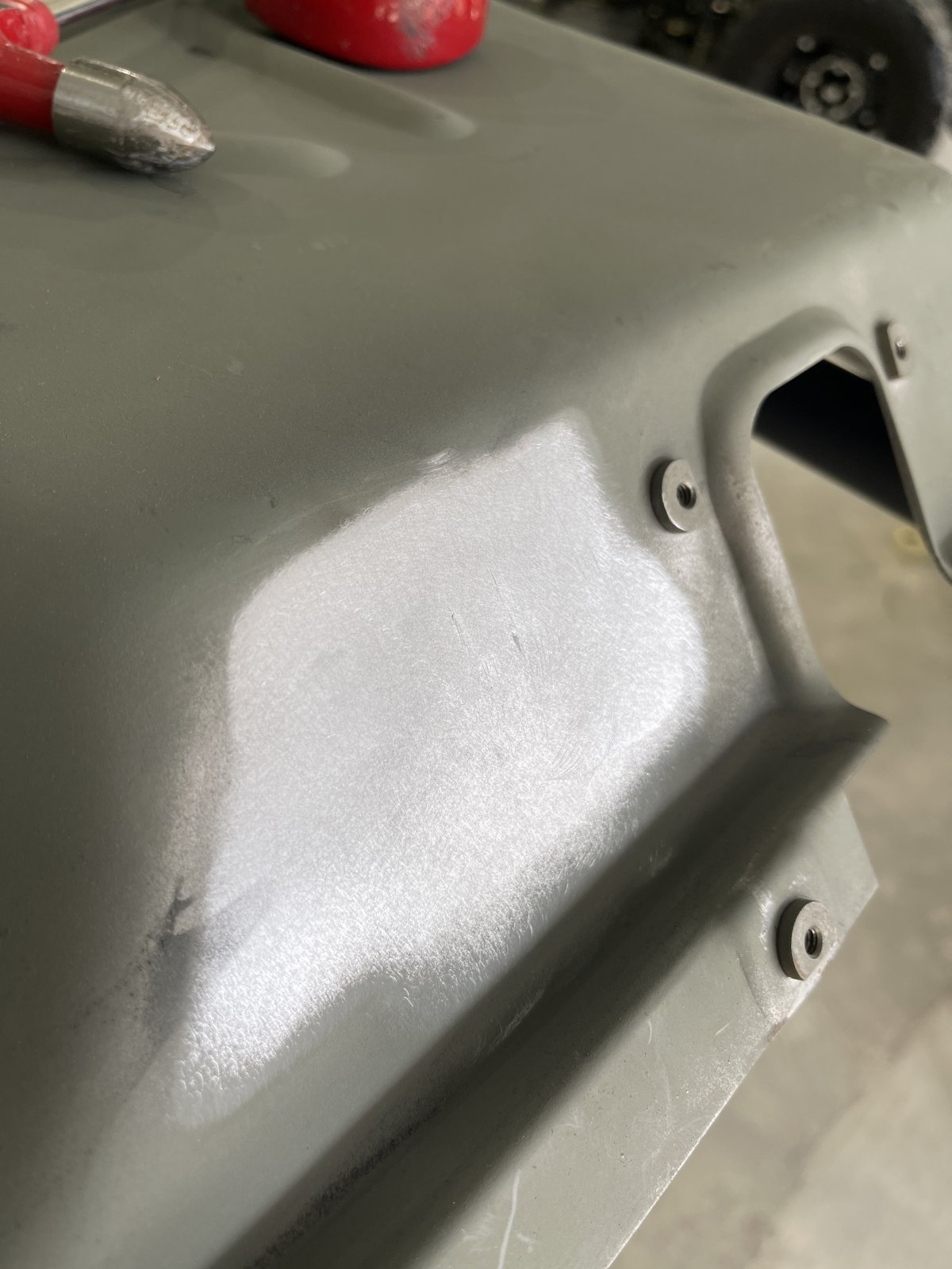

    Hotrod31A
    Small progress today, filling the extra holes on the new firewall, and reattaching the dimpled supports.
    Finally dialed in the pulse function on the tig and switched to the finger trigger. Much less ***bersome. Believe the settings are perfect for the ****welds on 18 gauge, can stay on the seam without fear of blowing it out now. Guess it could be my grinding skills are just getting better too, pics are after a thin layer of epoxy prime to prevent rust, no filler yet.

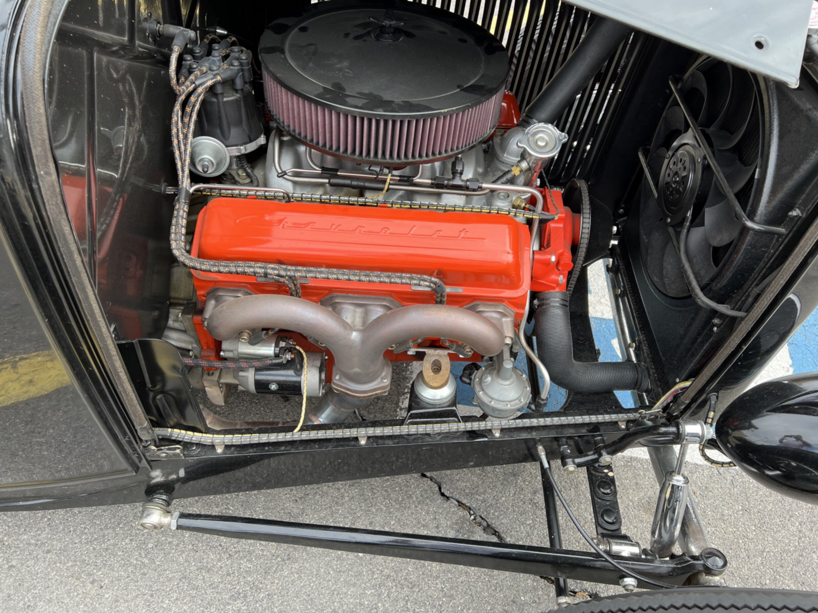

    74A36788-D8B1-4F54-8B45-62EEBE5453A4.png This SBC looks great…KISS (and inexpensive) is good plan!

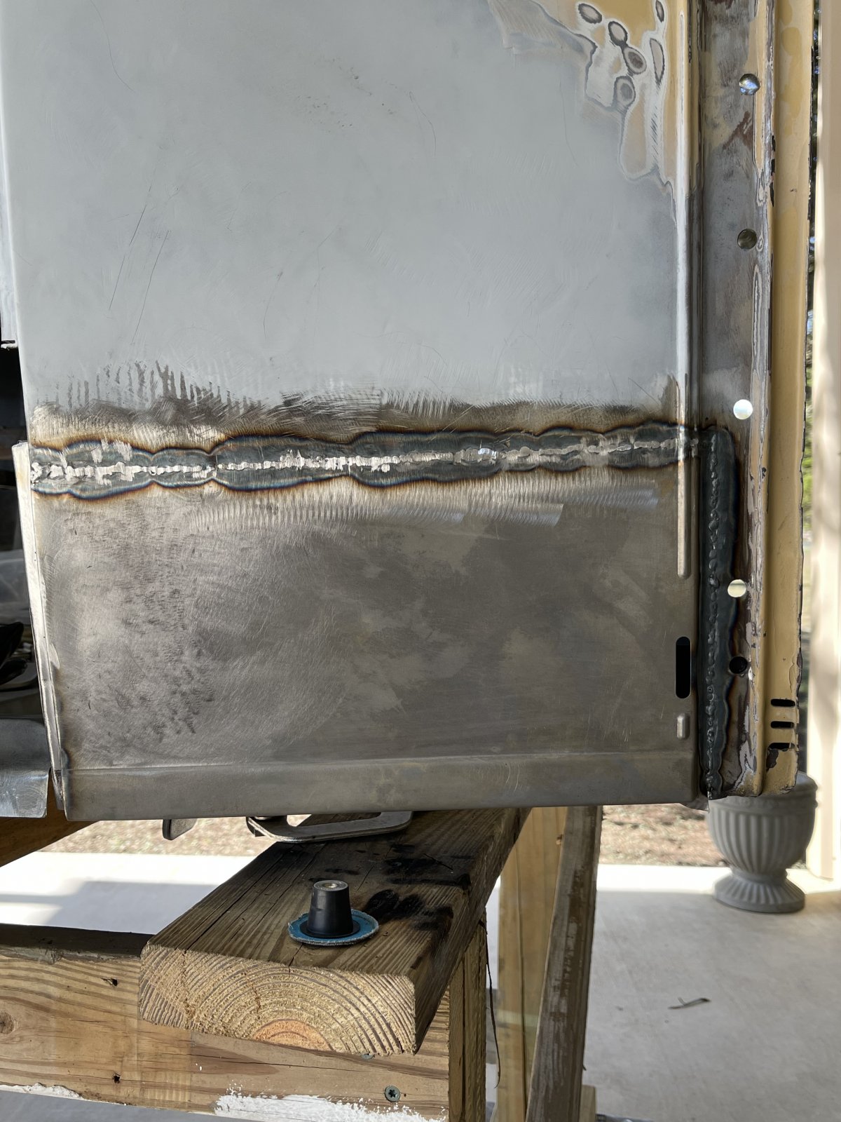

    P***enger cowl patch in and ready to move on to doors and hinges.
    3 days of labor , two burns and one cut , strained patience to get here. 97B14DFF-B906-4C71-AEB0-36B63B2CF250.jpeg 556DC2E5-42FC-417D-8333-1A0B25097B5A.jpeg C48776EF-CA35-4722-8AF7-DB5ABD95FC0B.jpeg 835C0E0E-C2AE-4064-BF57-93D17354F1EA.jpeg 813847C8-0C24-4D7E-B345-AED28775F3A0.jpeg 8C4F6754-C603-4014-99CD-94A551C62055.jpeg

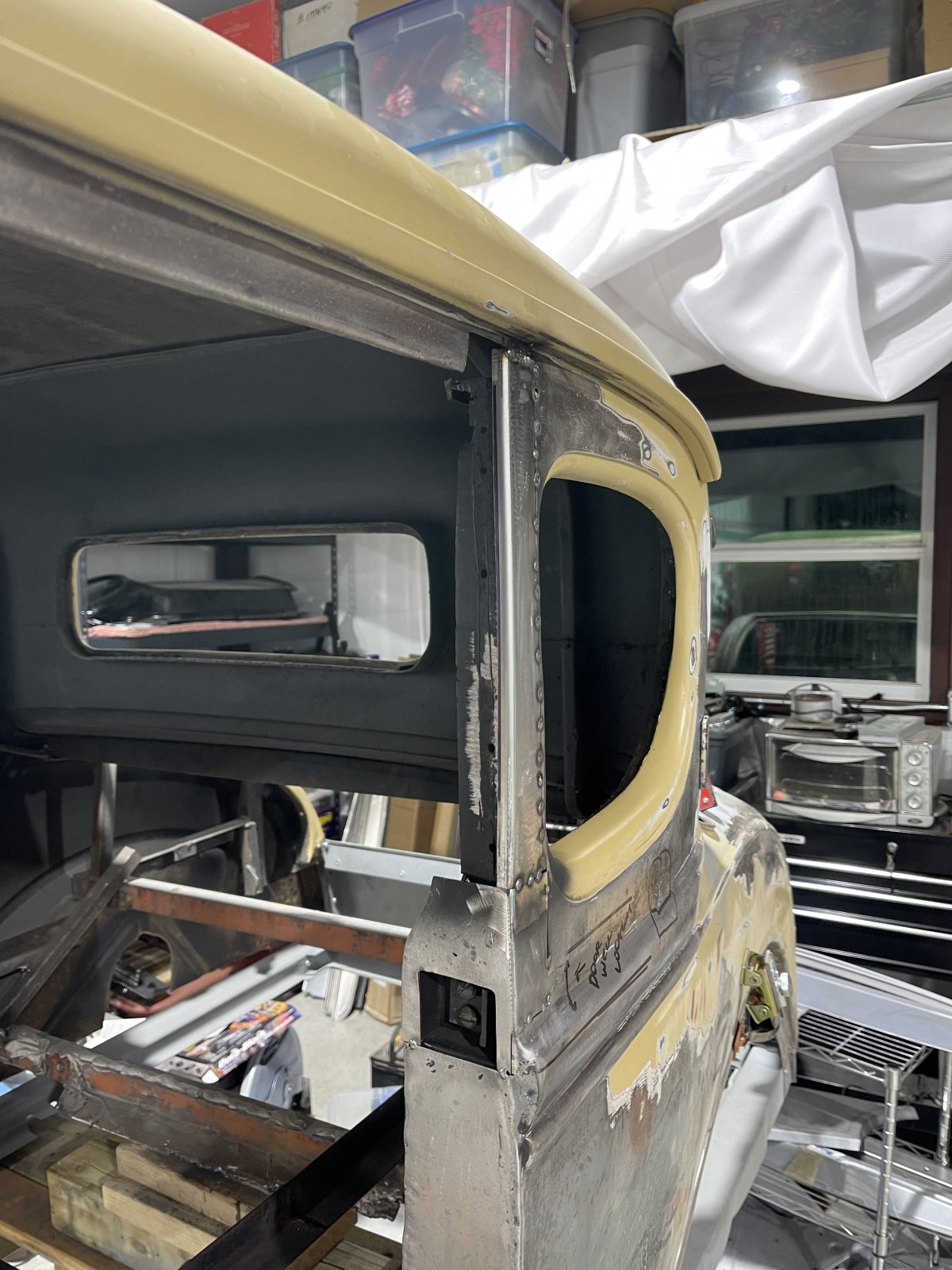

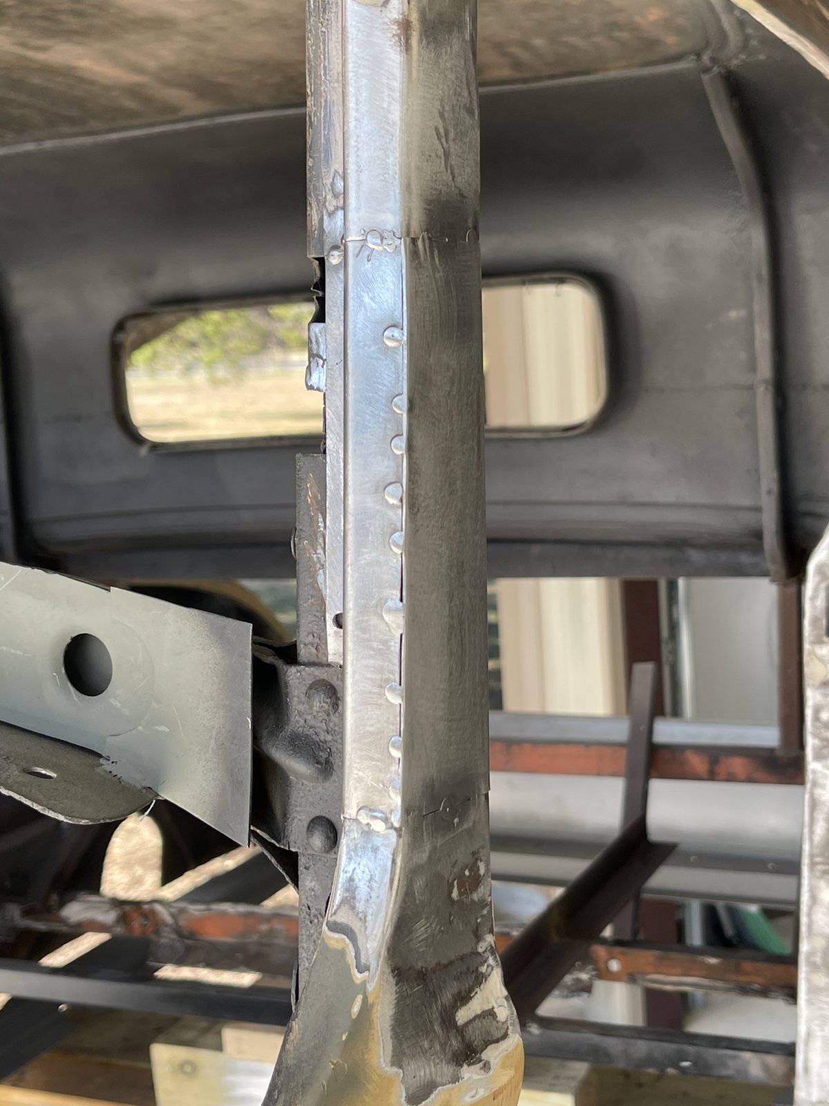

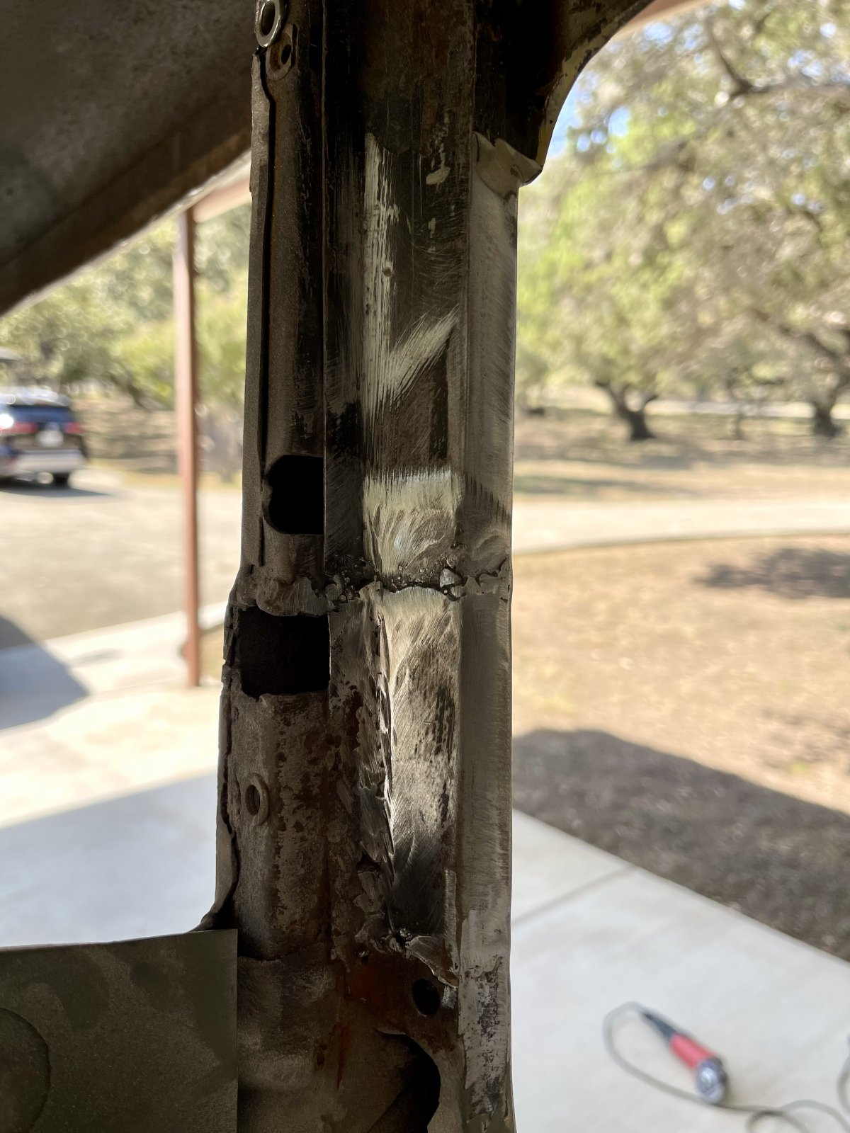

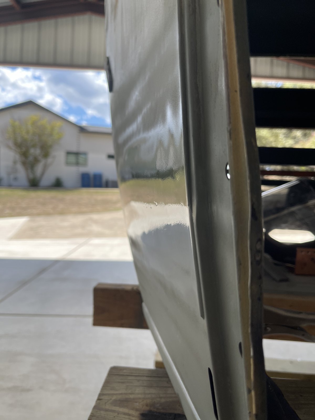

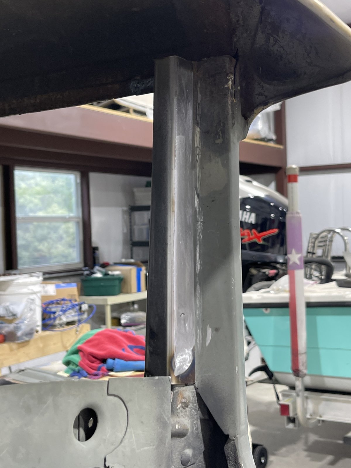

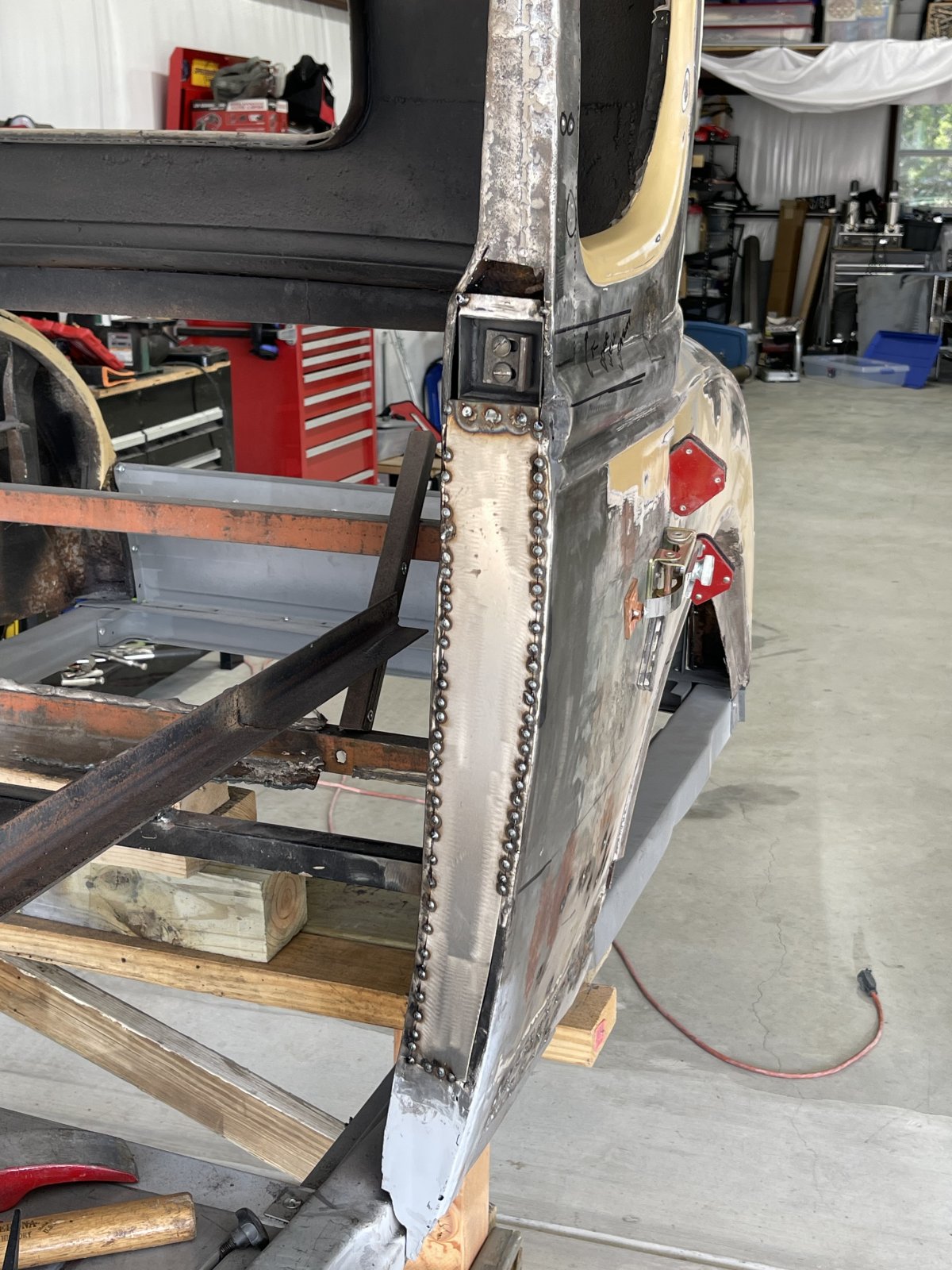

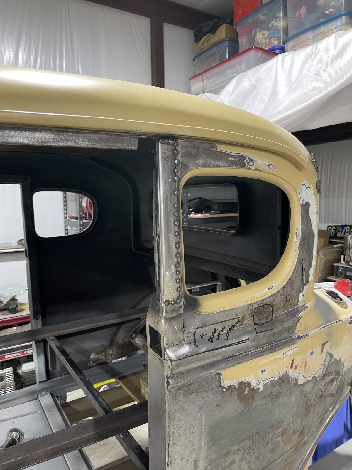

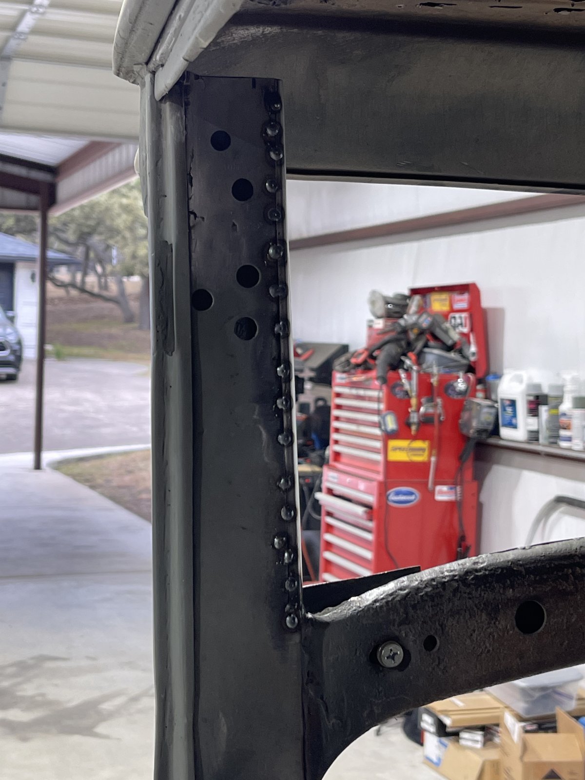

    Today’s update. Starting on the jambs and couldn’t get past the ****py A pillar chop so had an o **** moment and cut it out. English wheel skill had to get there quickly .
    All tacked in and almost ready for final weld and grinding.

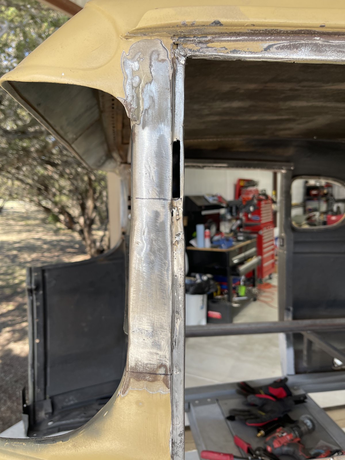

    Inner lip added , welded , metal finished , bondo ready and moving on.. 9D68AA64-3F7C-4BB6-BE81-12A12FF3D295.jpeg 1F03CF74-7E8F-47FE-94E5-EAAF95DACEE2.jpeg EEECF903-A166-4148-AE21-1FB6D6DA6F6D.jpeg 4565FB93-6D1B-4E30-88E5-AFF66A8F2528.jpeg

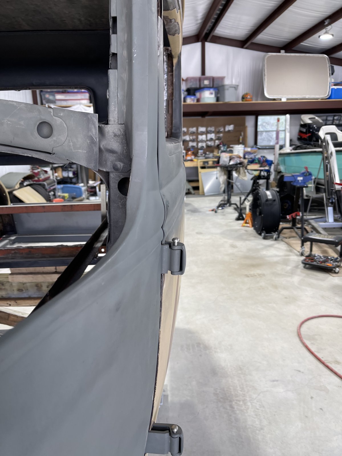

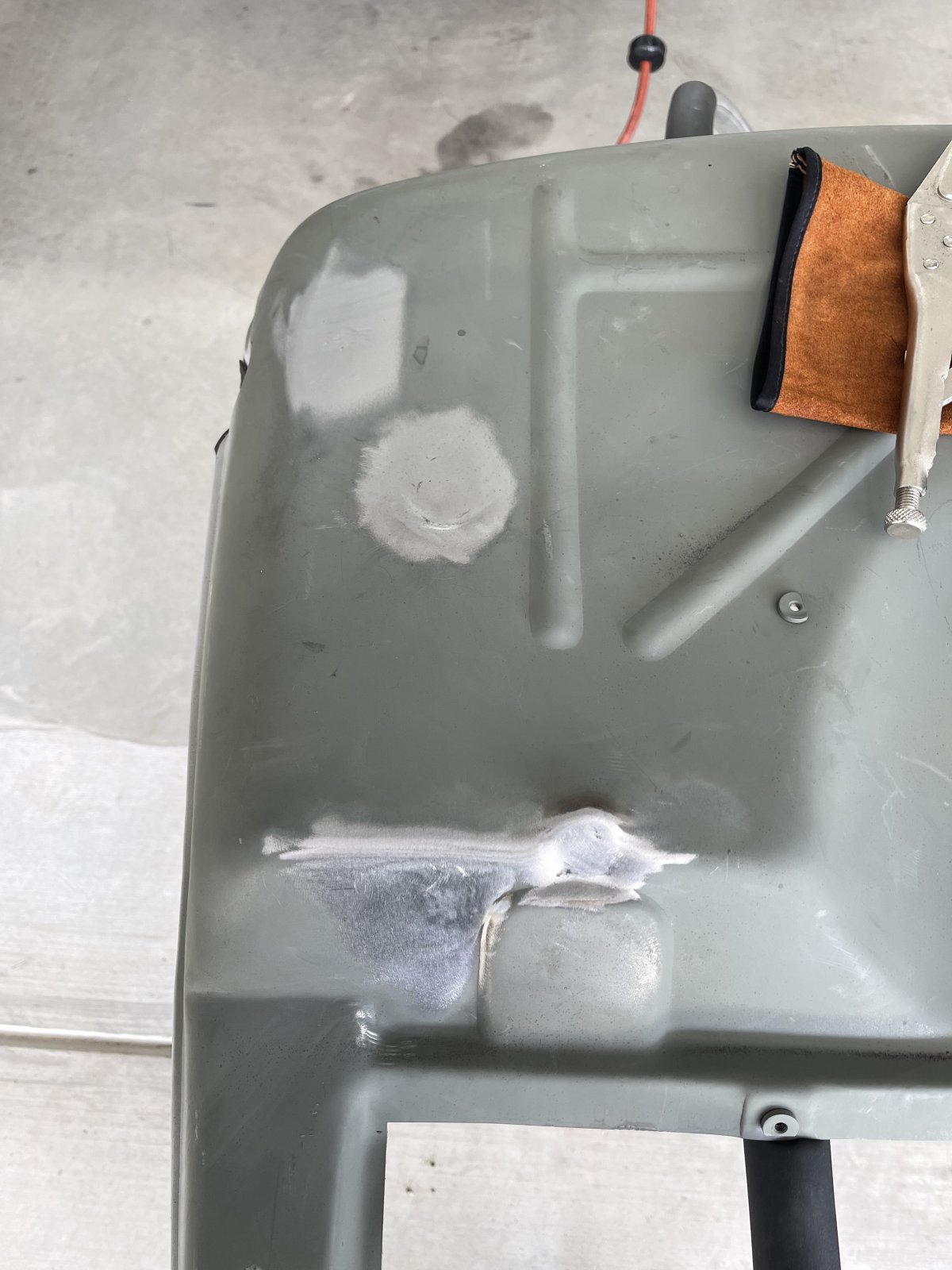

    Been away from my shop. Little work done on the ole Onion.. cut out some janky and hand fabbed some patch panels. I’m getting a little better at this deal, only 3 tries .

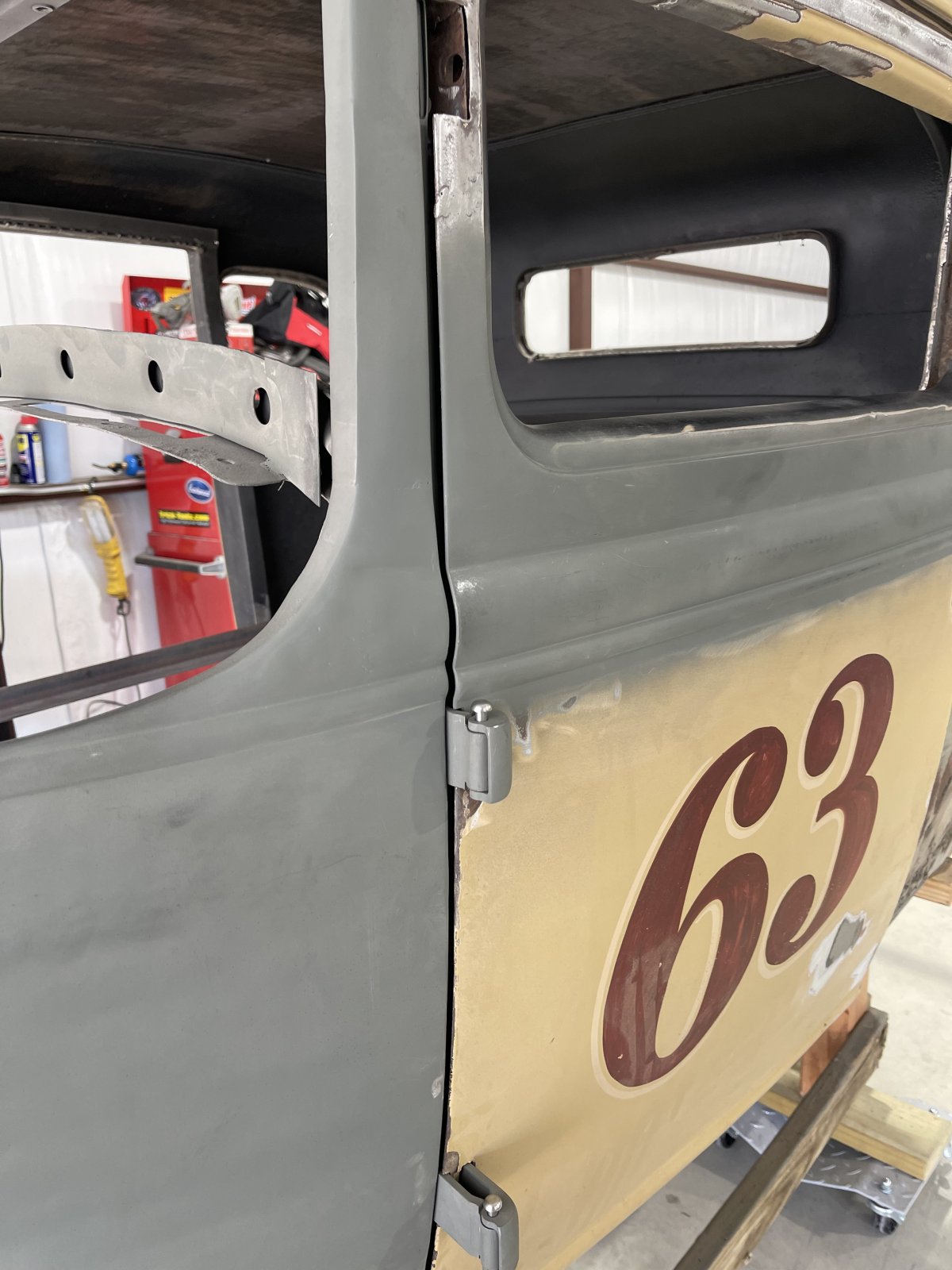

    Door hinges and alignment obviously need work, just checking the body lines in the pic. Believe at this point their filler worthy so on to more door jamb fun! D2E90C77-2947-459C-9B2F-89368AC58904.jpeg B2781D96-D187-418C-B07E-6A0AC6EC640A.jpeg 0A2D2F61-B4EE-466B-9961-7E181C64380E.jpeg D924FE84-81F8-431C-8CD5-54027911966E.jpeg 9FDCD51B-4AF1-4586-8103-AAFF562756ED.jpeg 592E87AD-6383-473B-B0C4-6FD39377C030.jpeg

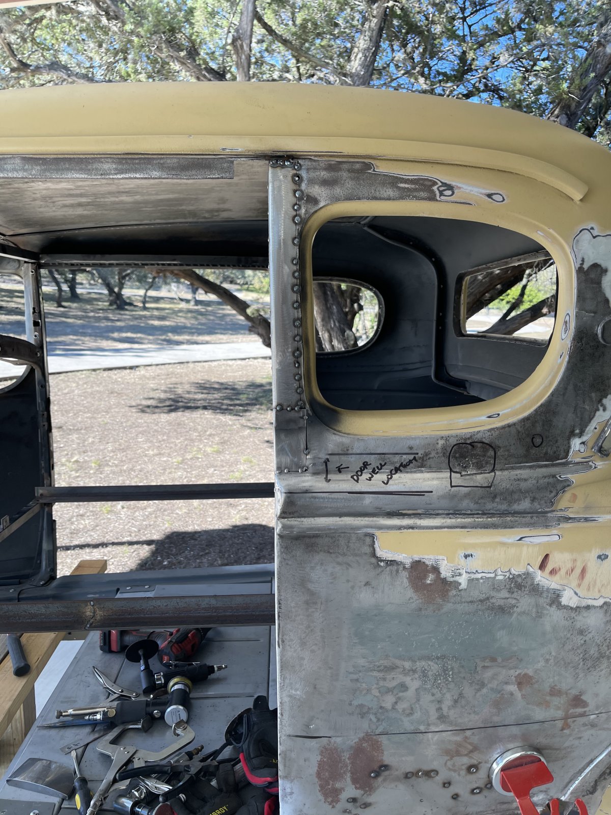

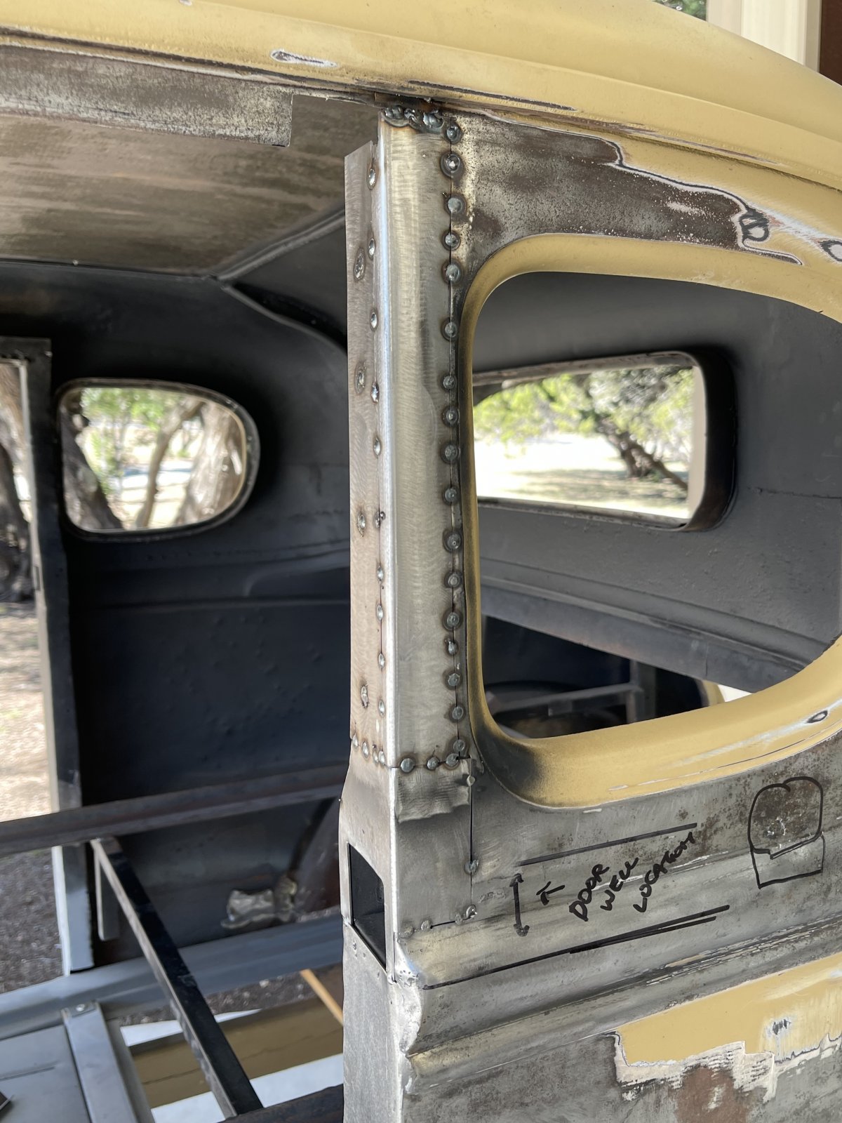

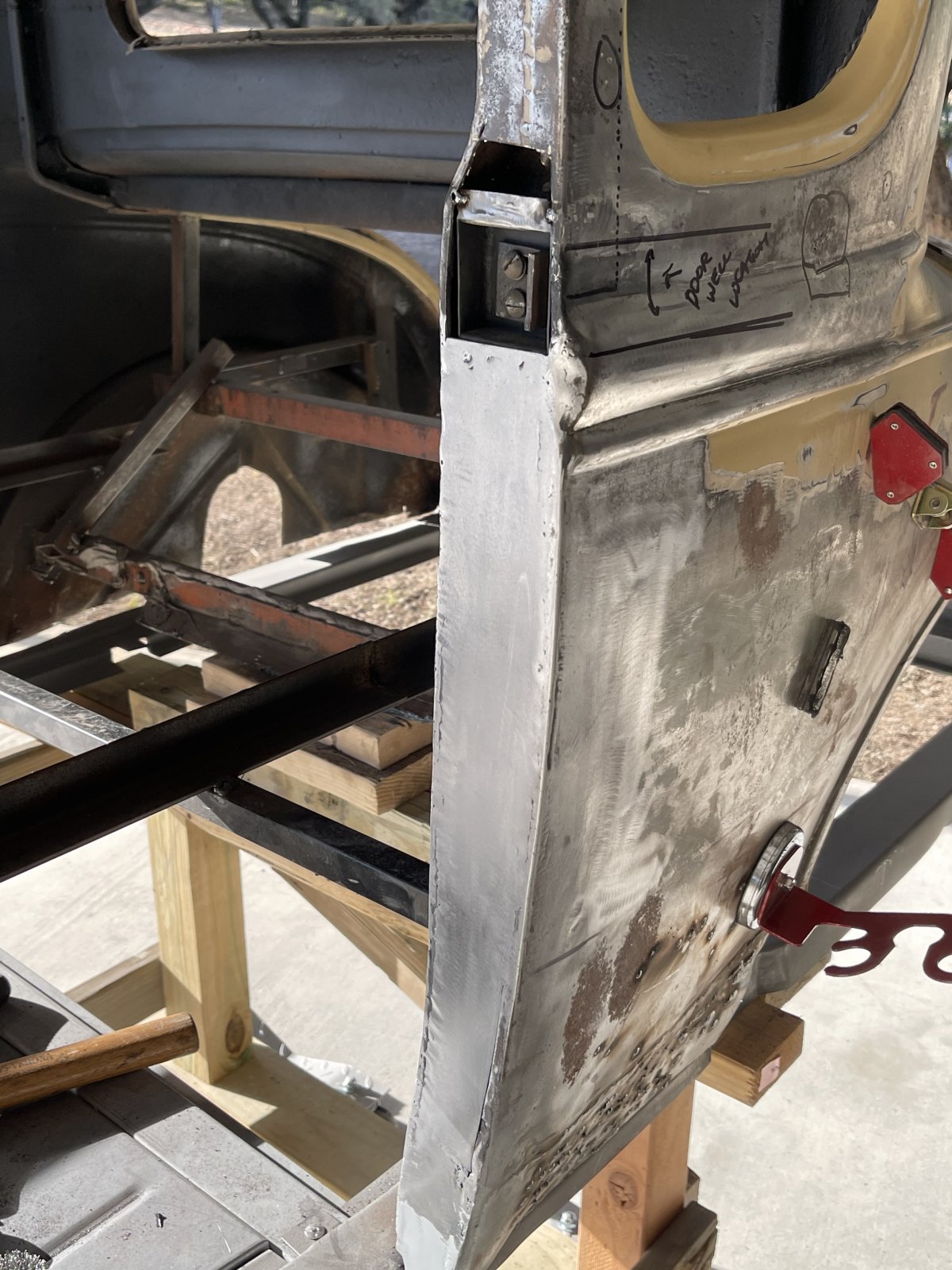

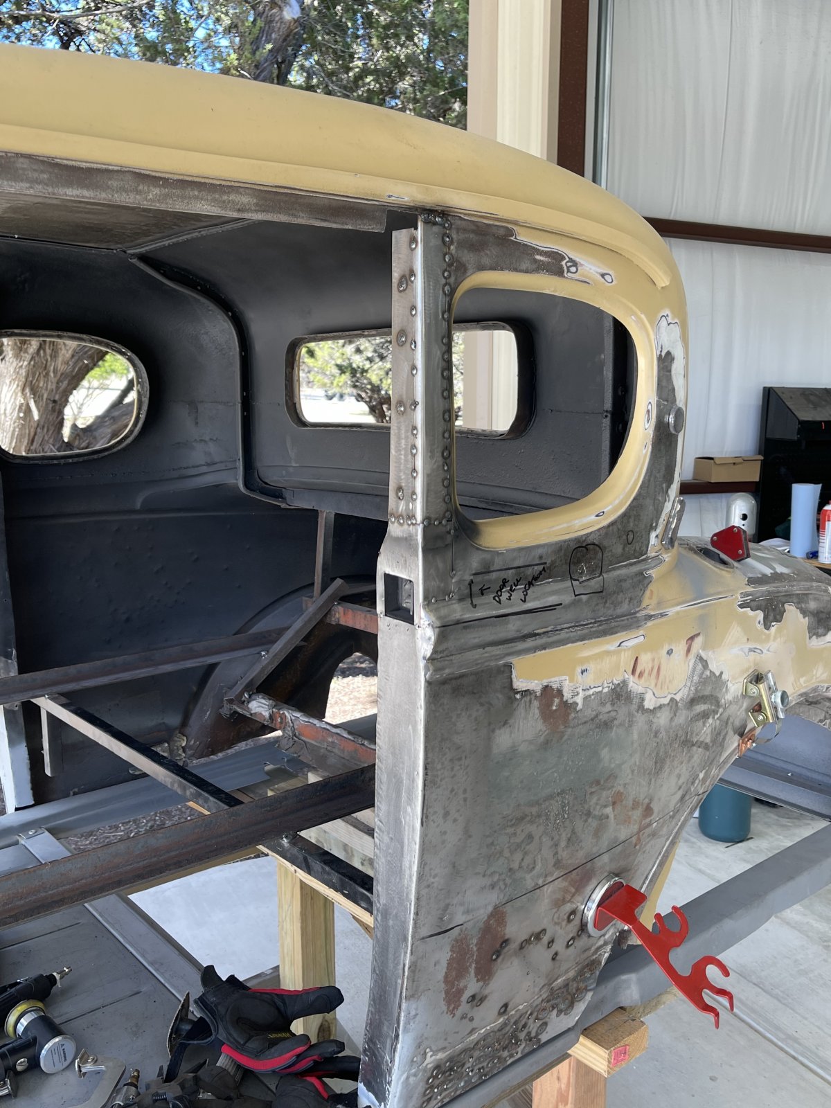

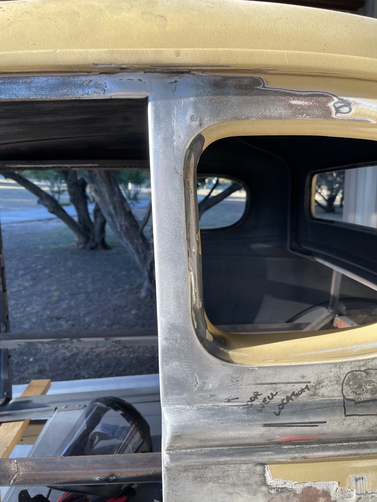

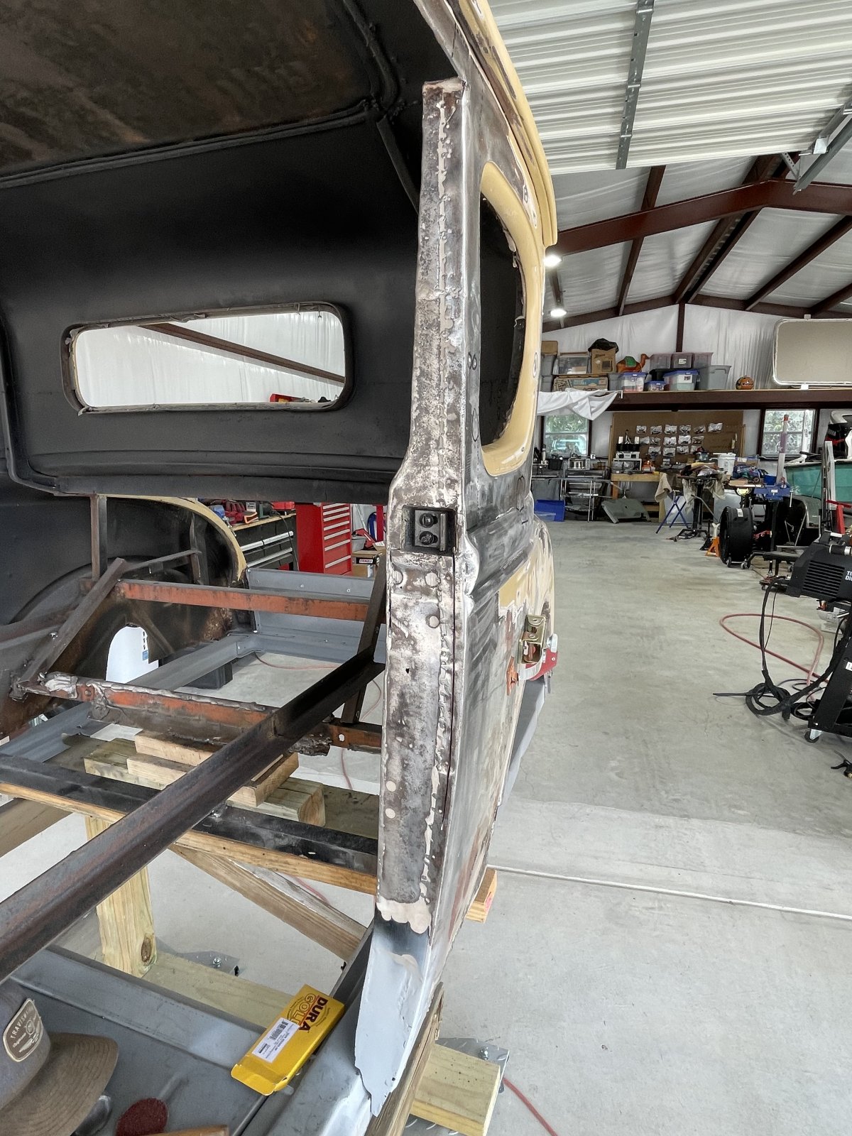

    Making some headway on the door jambs and ran out of weld gas. ****py chop lines , rotted door lock pocket, and butchered B pillar sheetmetal fabbed and replaced. More correct straighter lines and looking like a Model A a little more each time. 3A7FB848-E428-4C5E-8527-13C88D42811B.jpeg 03CC64E9-A115-4917-AE16-A5AA7BA87F29.jpeg 14E303F4-3046-4819-AE60-5FEF46C205D3.jpeg B1E4A422-671F-462F-8898-6C14F7DE89B3.jpeg A62136A3-E767-411F-9CAF-505E490208B2.jpeg 6E0BCC12-DCA3-41CD-80B1-40A34B10A5D9.jpeg 546DC85E-45ED-4C7E-86D4-D5DD115349C2.jpeg 88913FEE-007C-4550-8C4F-78AA03D31630.jpeg 8ECC1F5D-FC9C-47F1-A25B-2050508B9898.jpeg

    I'm curious what is your method for smoothing welds?

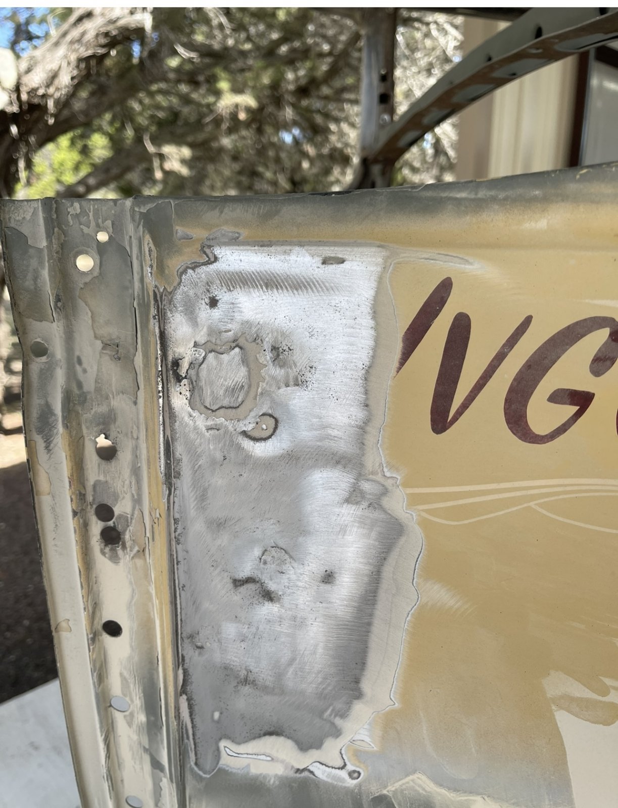

    2 inch 80 grit roloc with die grinder directly on top of weld bead until flat or almost touching panel metal when sanding, finish with 2 inch 80 grit DA.
    If I can get behind the panel, I’ll use a hammer/******* and toe dolly on the low spots and follow up with a shrinking disc if needed.

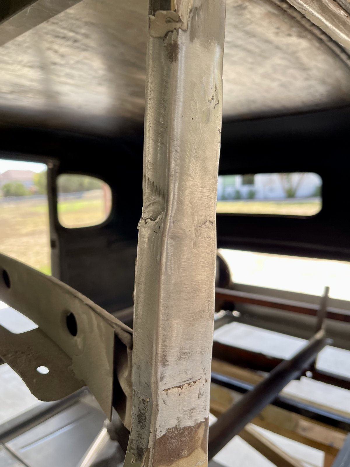

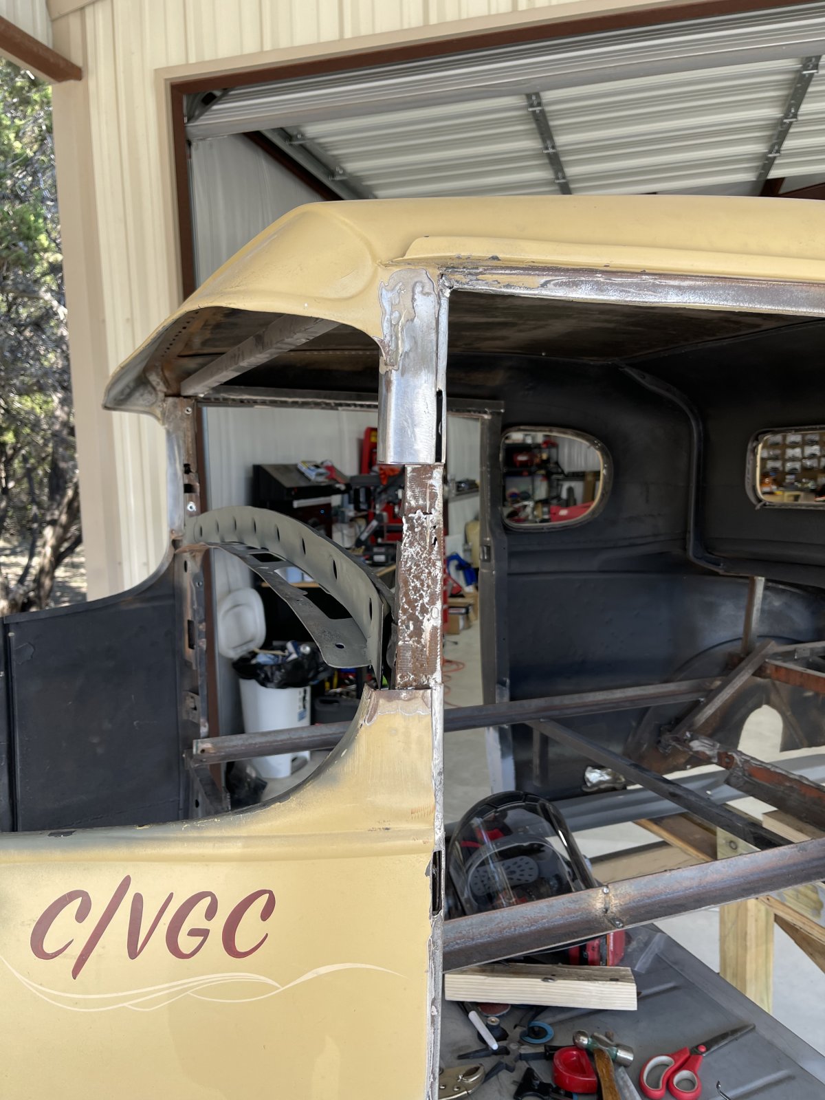

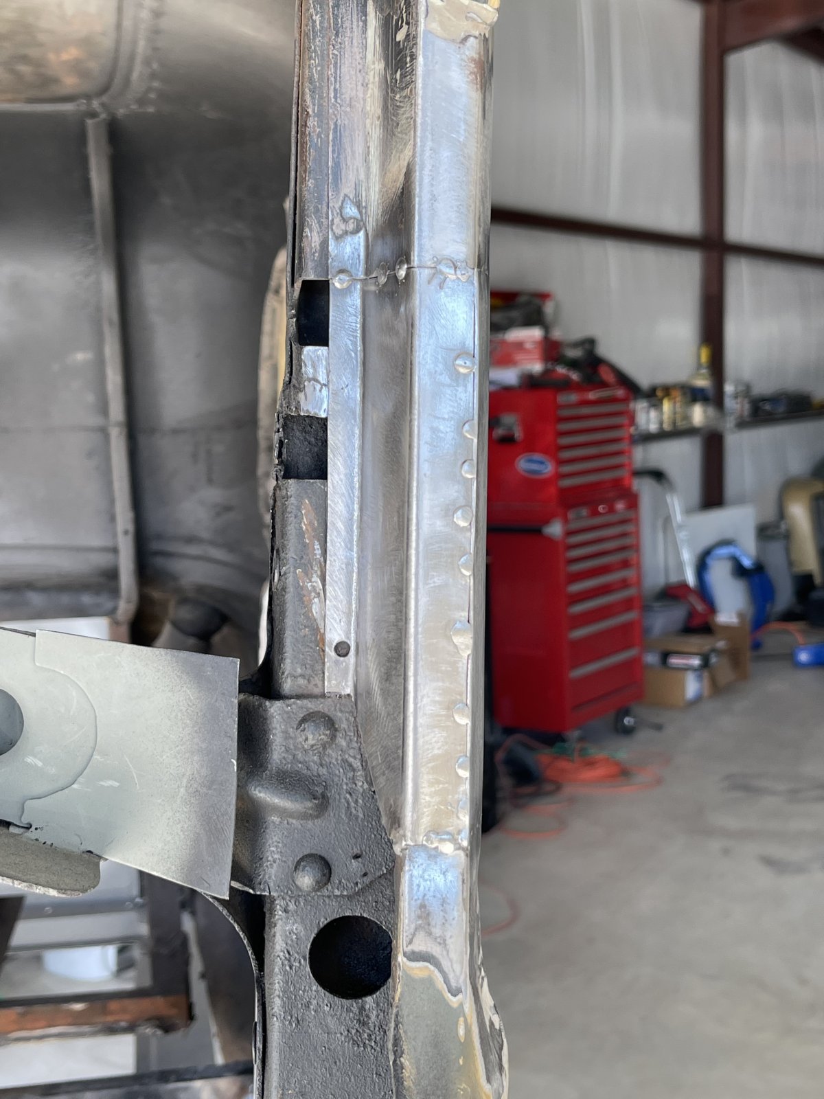

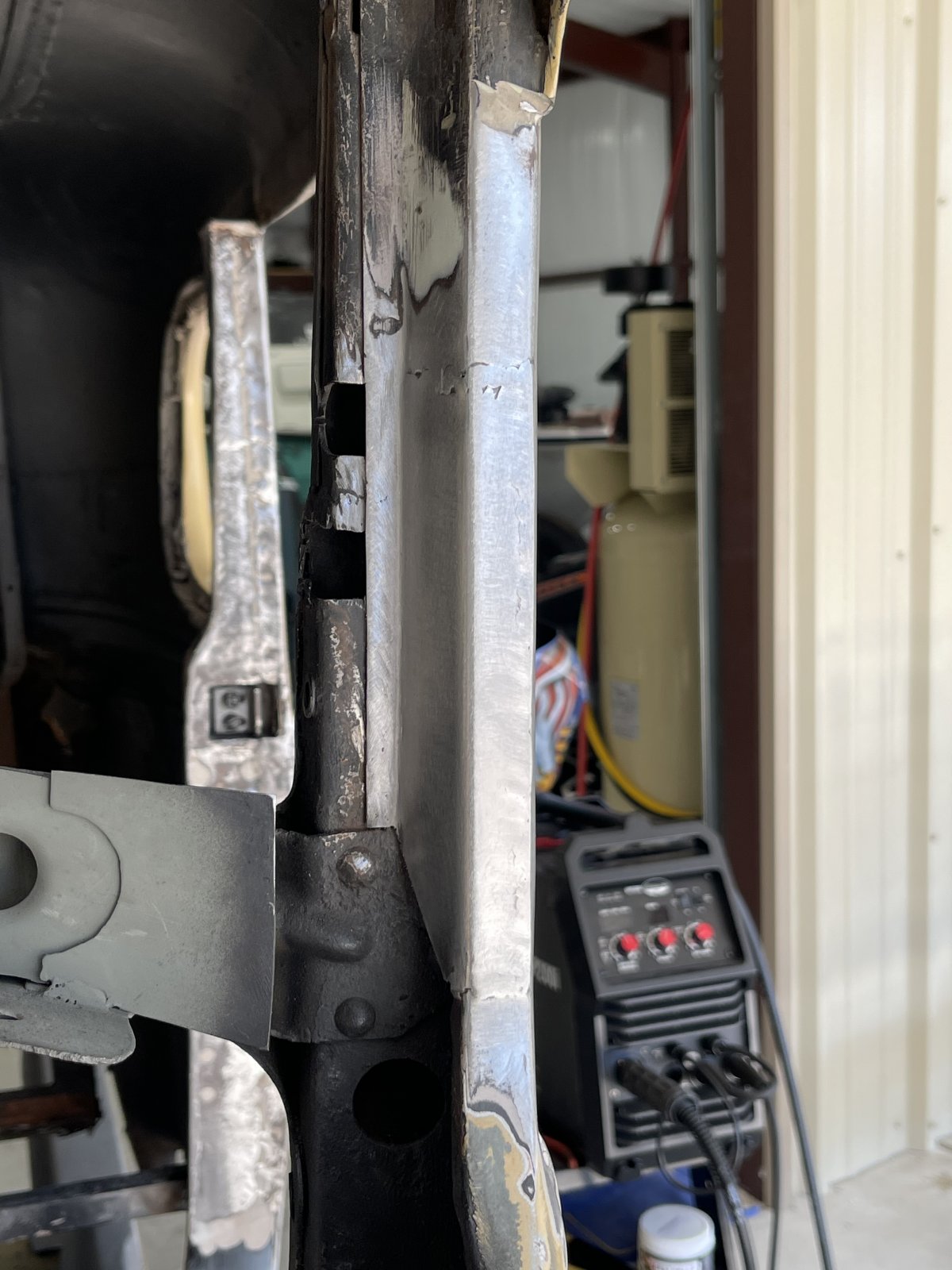

  28. Hotrod31A
    Joined: May 20, 2022
    Posts: 119
    Hotrod31A

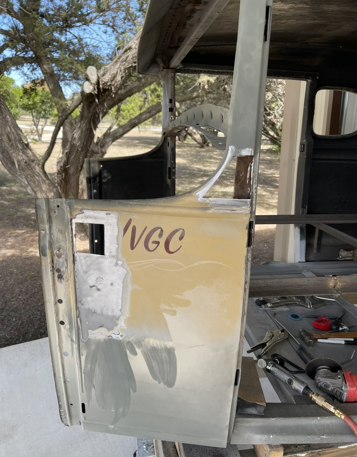

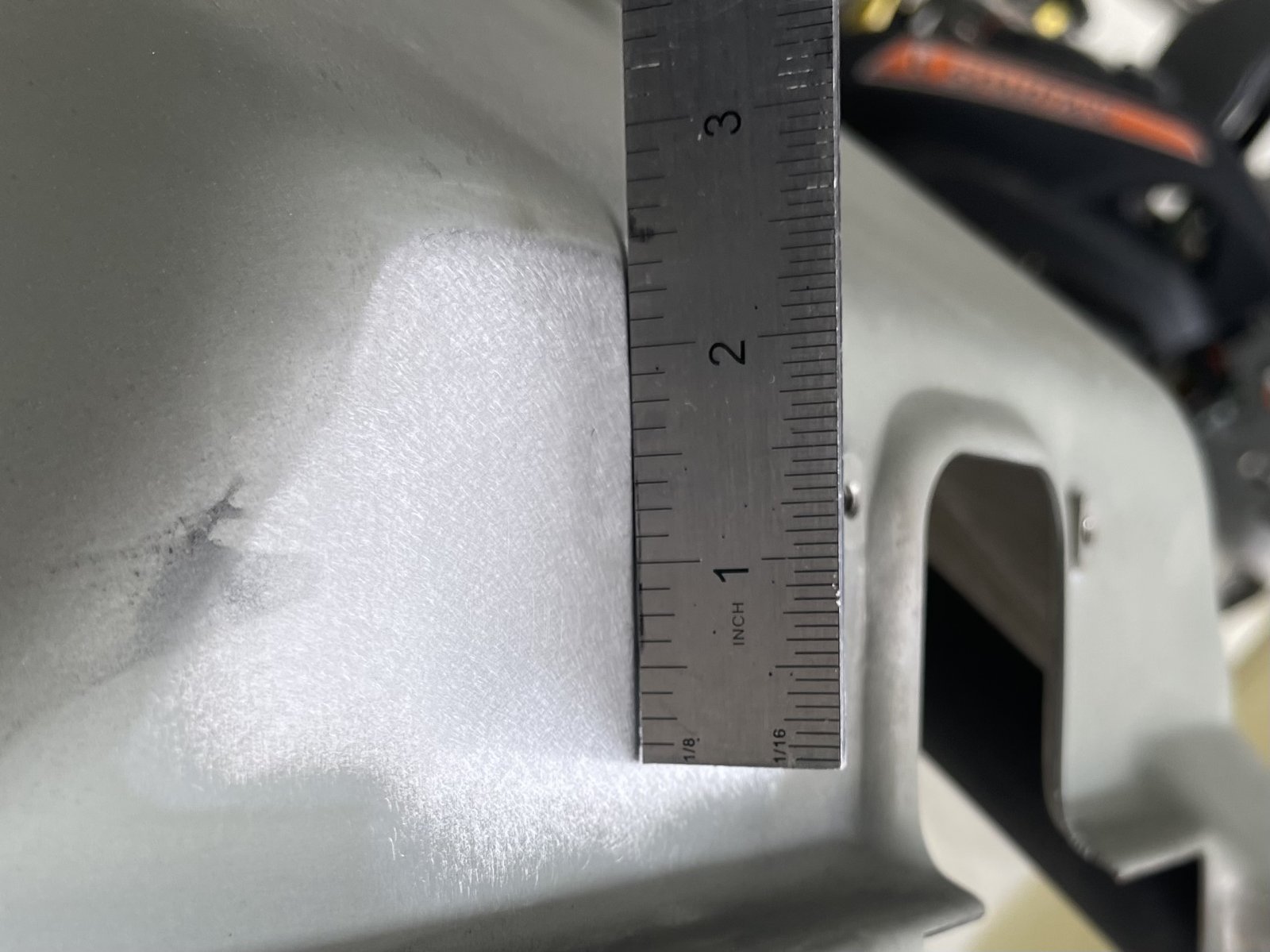

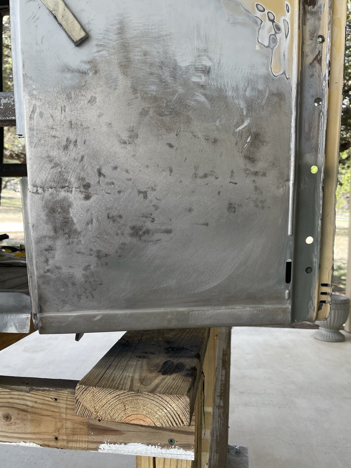

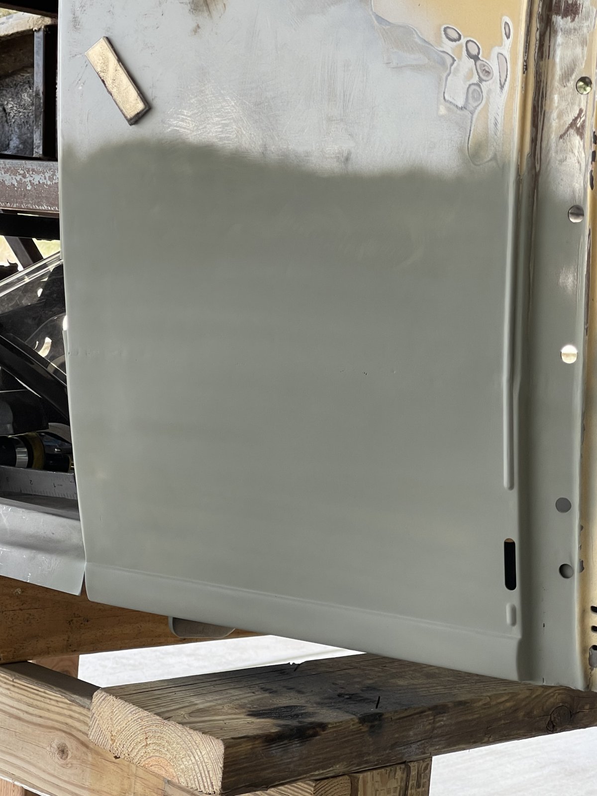

    Quick before and after metal finish. The old sheetmetal sunk pretty hard at the top during welding. Still need to do dolly work to complete before bondo. Moving on to next… 7DDD0D96-923C-4DEE-B49D-1F86EAE754F3.png 54F6F220-7965-4299-8A3E-7CFE5F2BBE46.png 9E97FB4C-20D3-4CF3-96EE-05475AE41DFD.jpeg

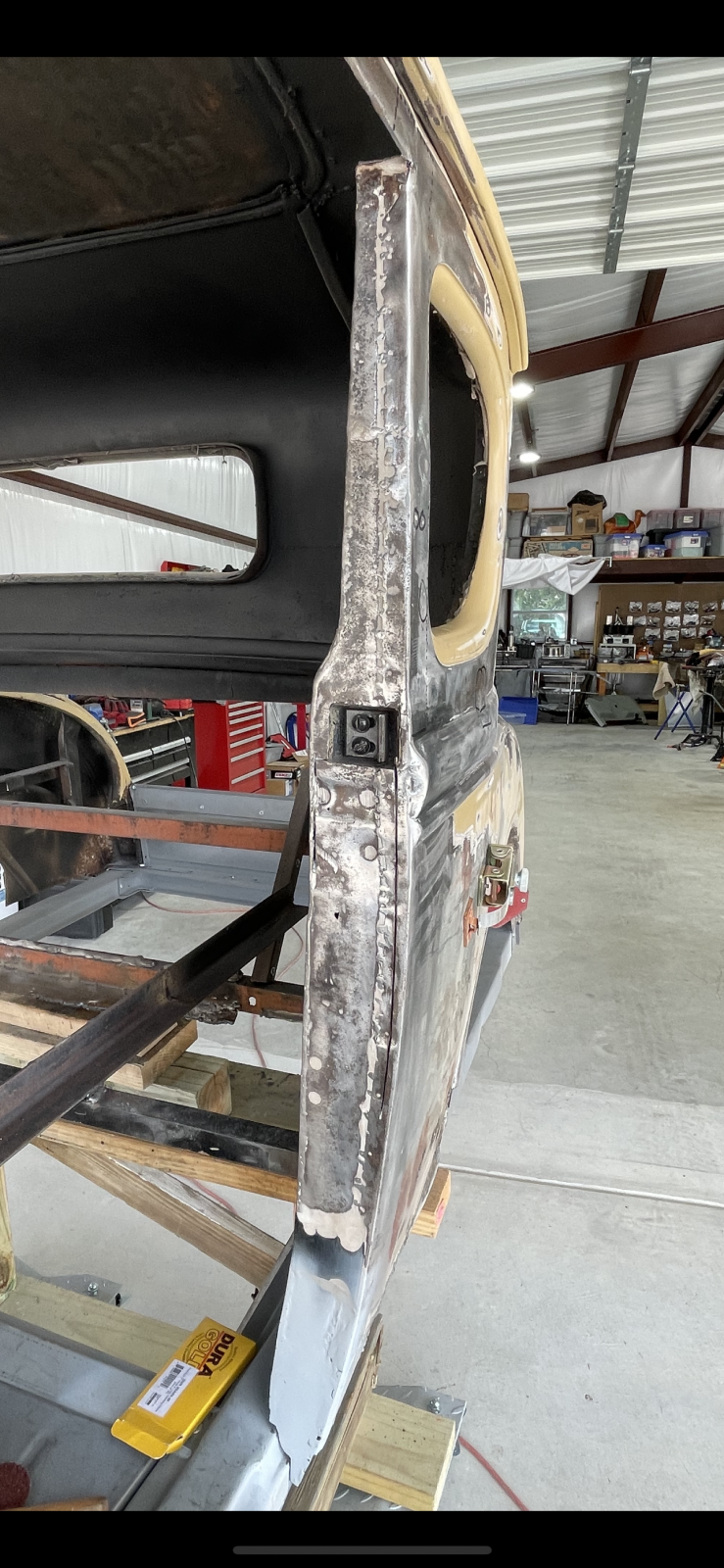

  29. Hotrod31A
    Posts: 119
    Hotrod31A

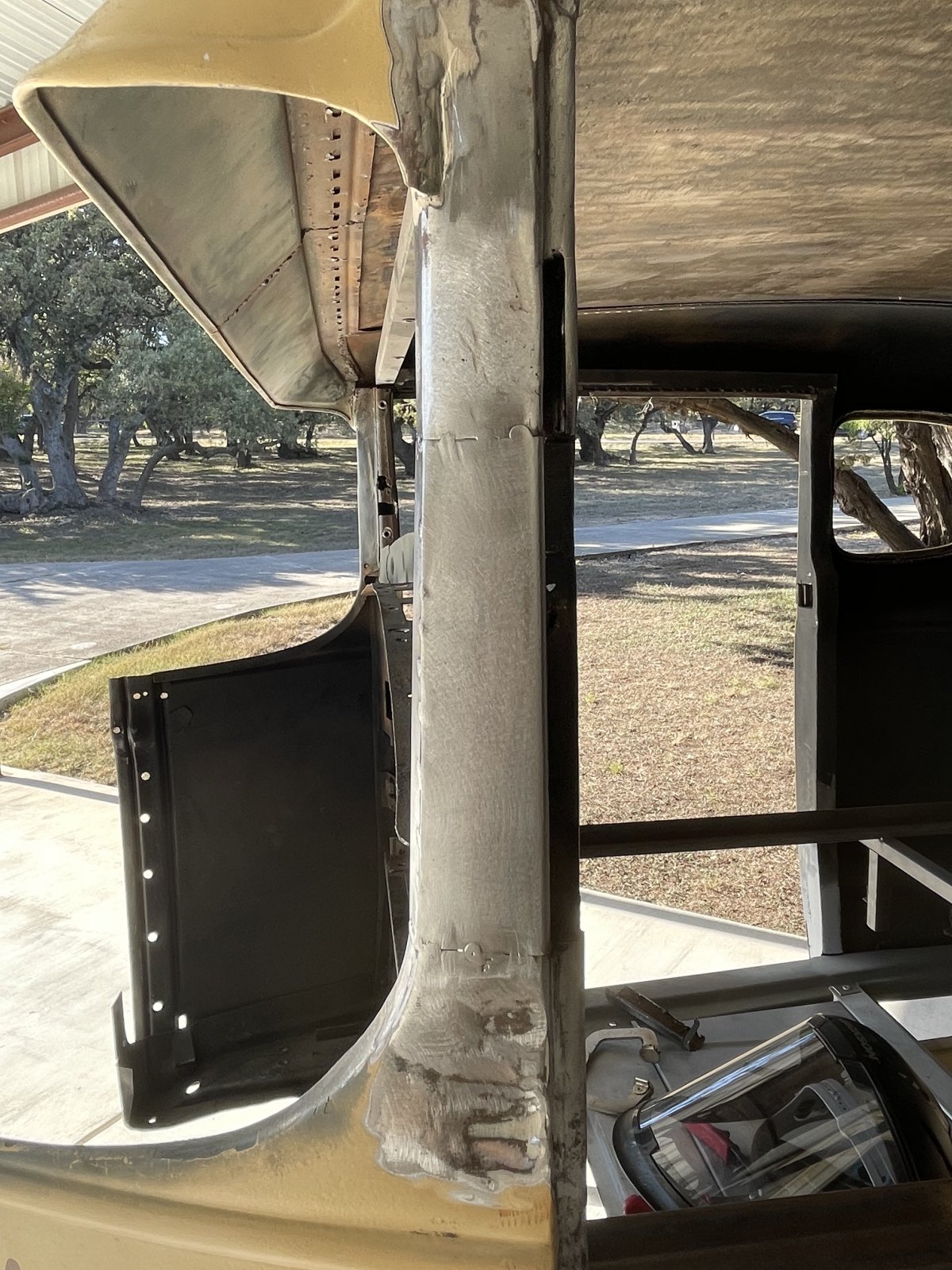

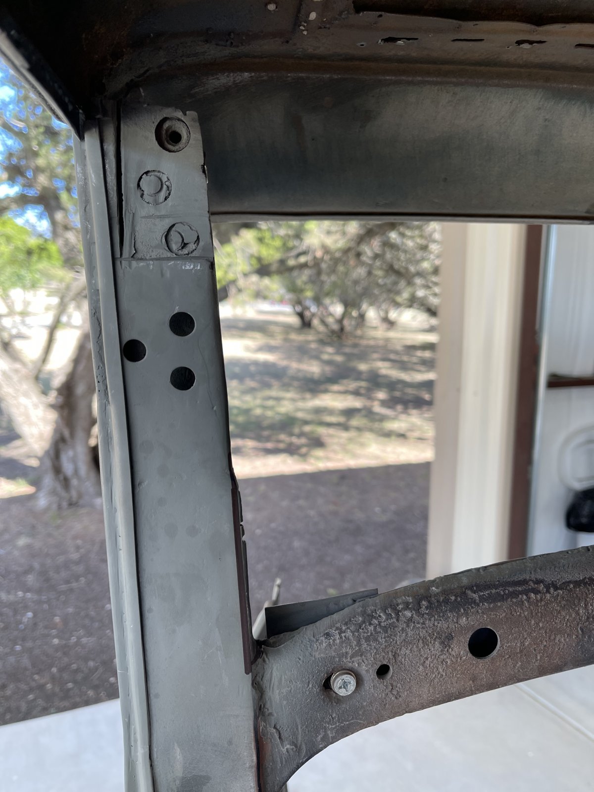

    Finished the inner Driver’s A pillar. These have bothered me for a while and didn’t like the original trim, so I fabbed a piece that will be structurally stronger and cleans up the chop and pillar lines.
    Drivers door is next up, full rebuild planned. Stay tuned. 5538DD05-B6A9-45F3-B3B2-EA3A4B76D6EB.jpeg DF7F03E2-1B8E-4094-A238-BE76839E9F18.jpeg 73415ECC-EEA2-4D77-95AF-DE4857CEEA52.jpeg 84C1C7CE-B357-4AAC-BA0E-23ADB5600246.jpeg
