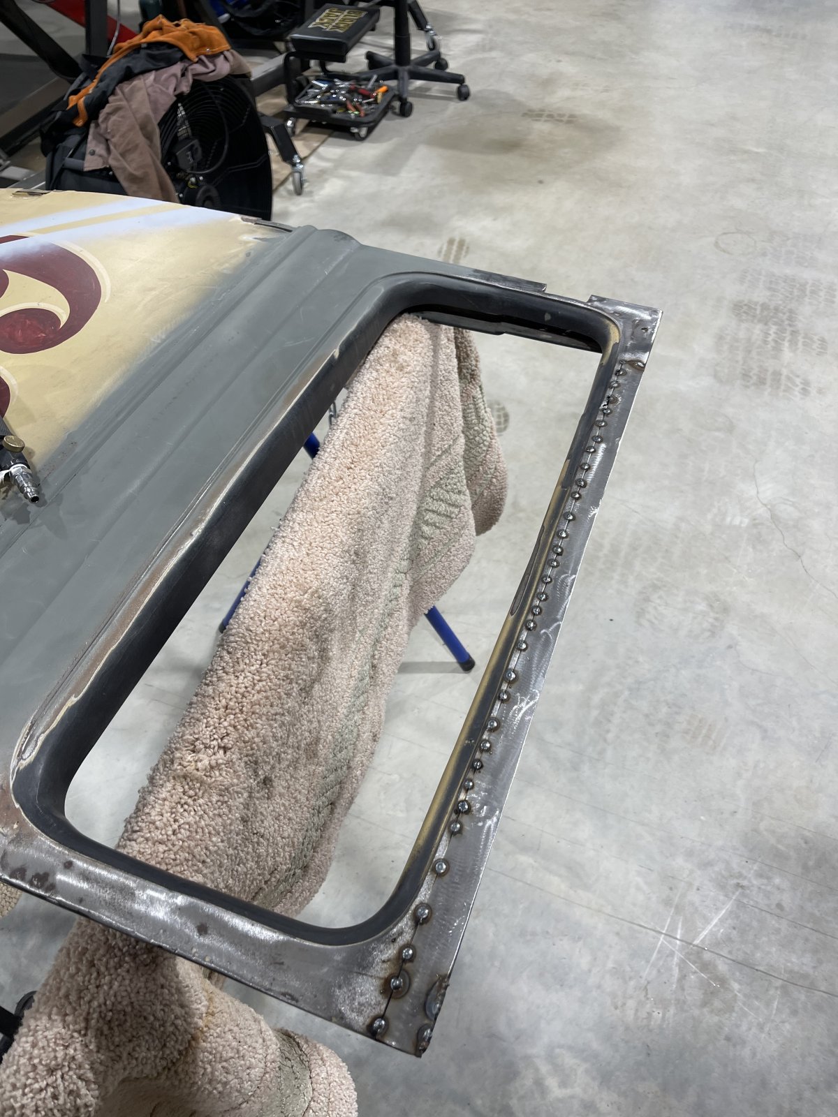

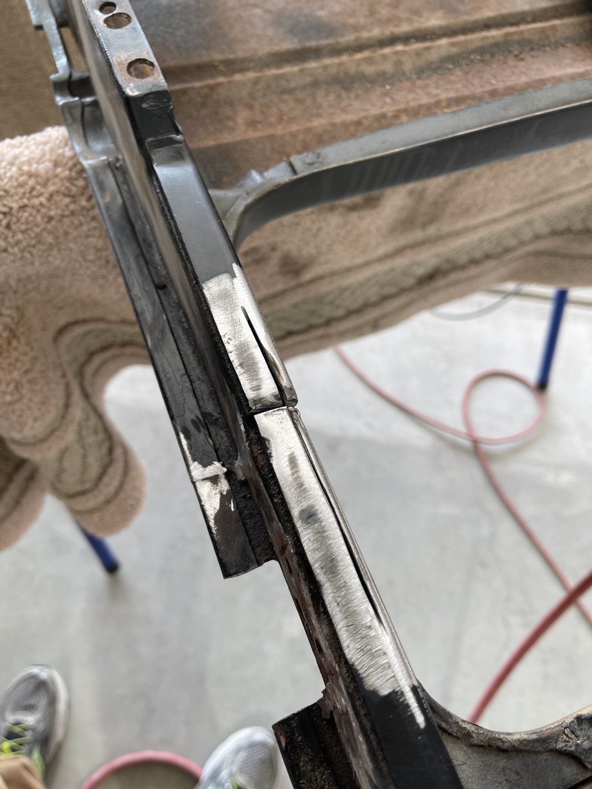

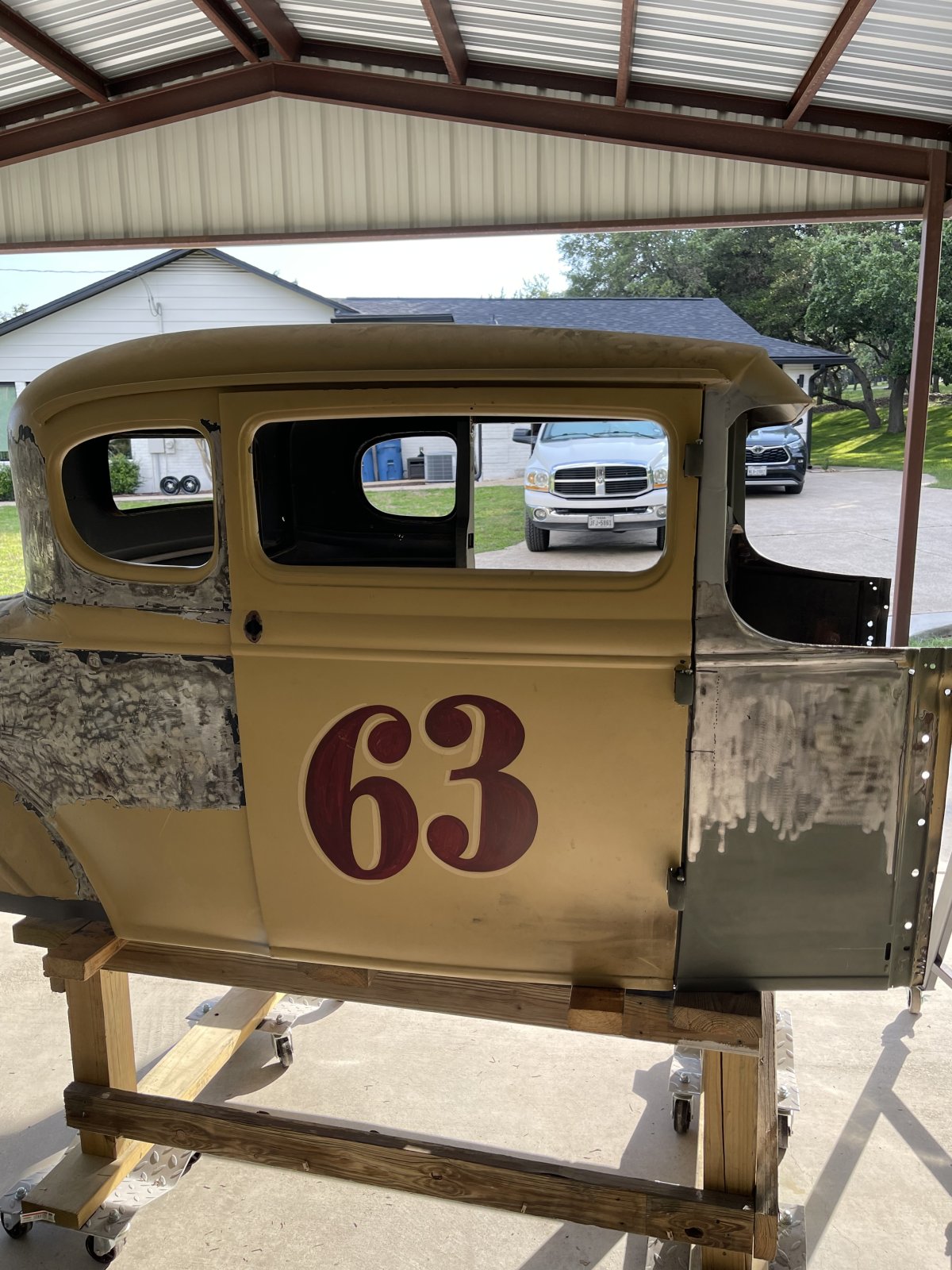

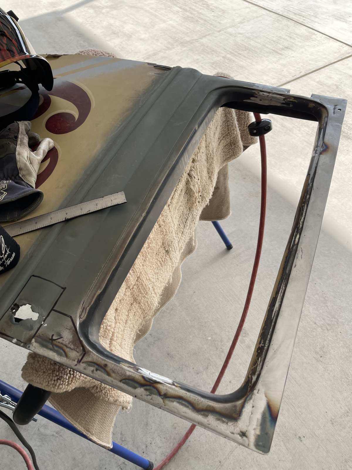

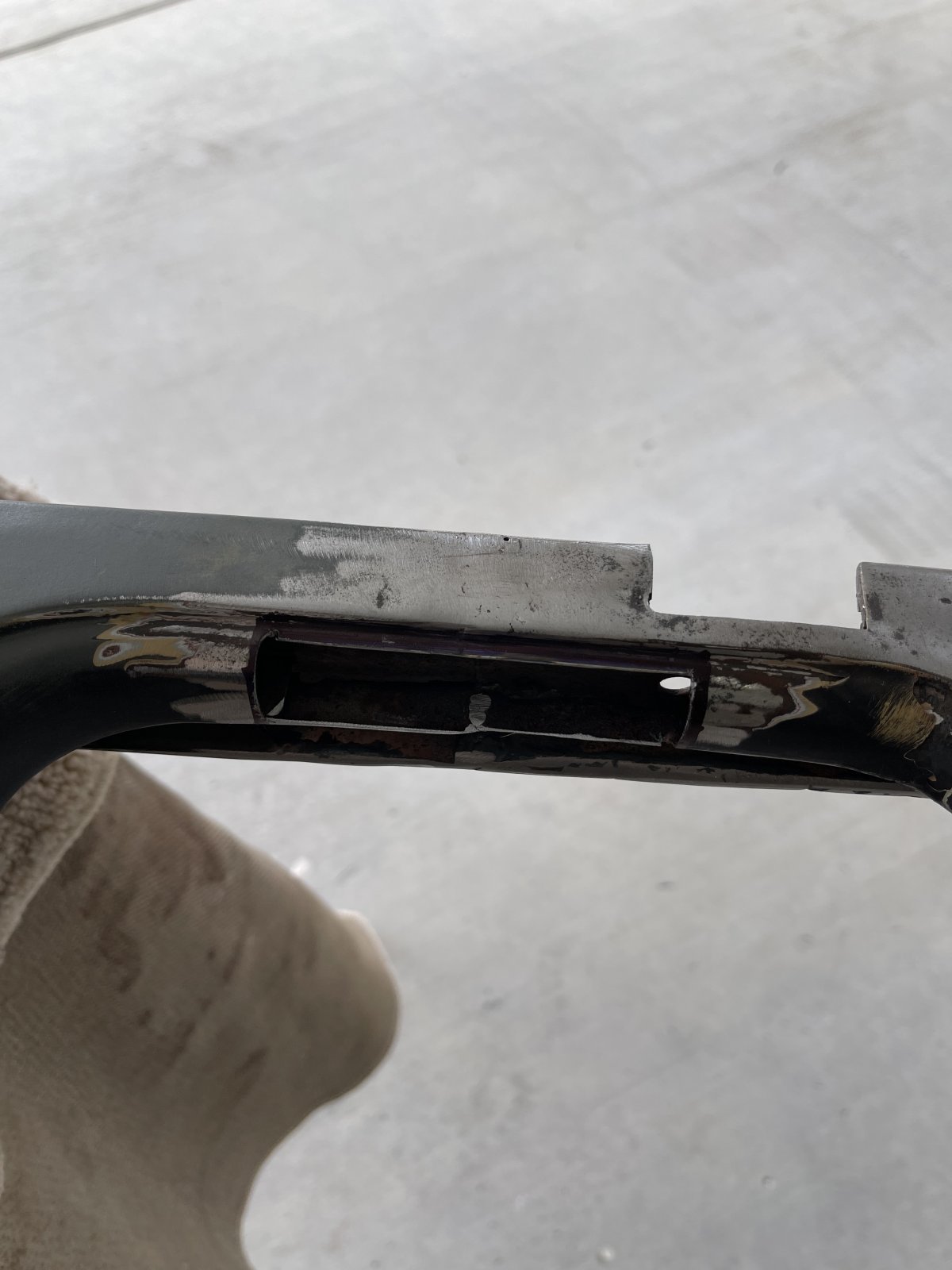

    Spent the week cleaning up the driver’s door chop lines and some rot on the frame. Wasted the past two days chasing paper thin sheetmetal and blowouts on the old chop lines with the tig.
    Finally today broke out the sheetmetal and started cutting the janky out , then things started moving in the right direction , much quicker with better results. slow but steady…. F6AE15CD-3001-4465-8795-16957FFB68F5.jpeg
    84D159BA-6D4C-4846-8AE0-6D1B21D08BD4.jpeg 392A8768-155E-487A-A4B4-762277679FB4.jpeg 1F53D88C-335C-4A1B-B537-C68519181A44.jpeg 93D24004-4306-4294-8EFE-D36FA3300111.jpeg D0D30F57-D743-467A-AE5D-93E617EE612E.jpeg C116FFED-12AF-4335-866E-CE868096ADAB.jpeg

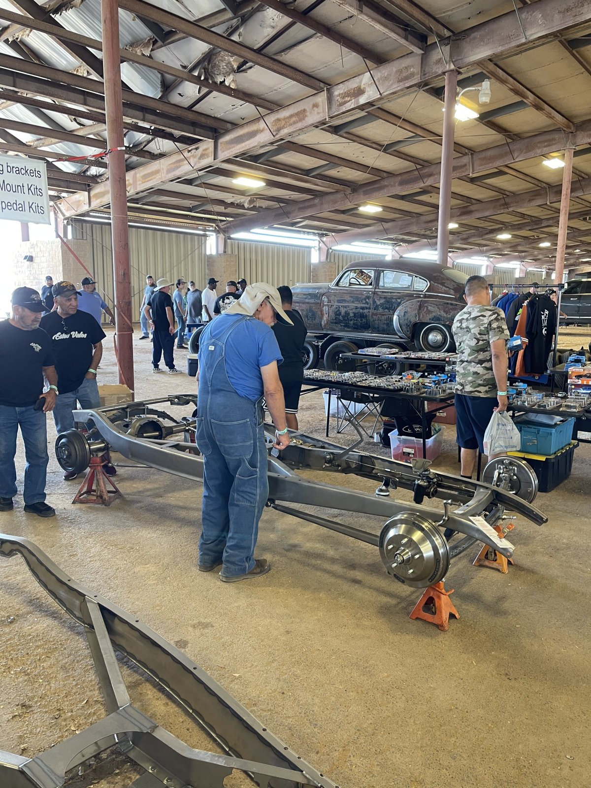

    It’s been a minute, as everyone says life gets in the way.
    Big day today as we finally picked up our Rjays ch***is. I can’t be any happier with this decision as it’s exactly what I was targeting. Cory has been very helpful to offer suggestions and he was spot on, it has definitely been worth the wait.
    Unfortunately we are in the middle of a move from Texas back to Kentucky so the build will be on hold until the new shop is built and everything gets moved. I can’t hardly wait to finish this thing..

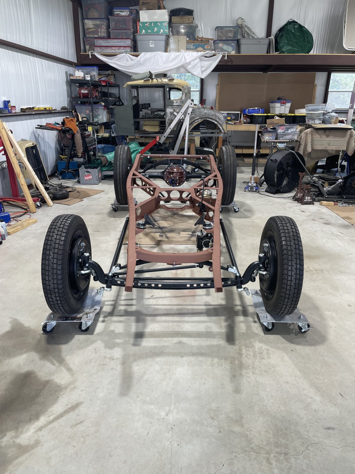

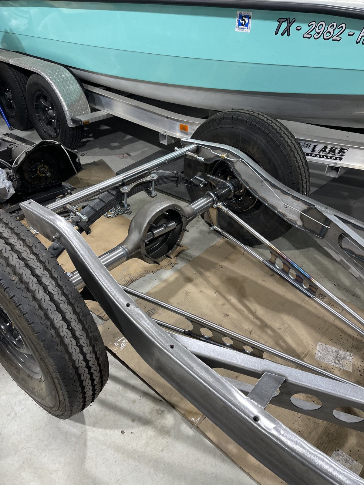

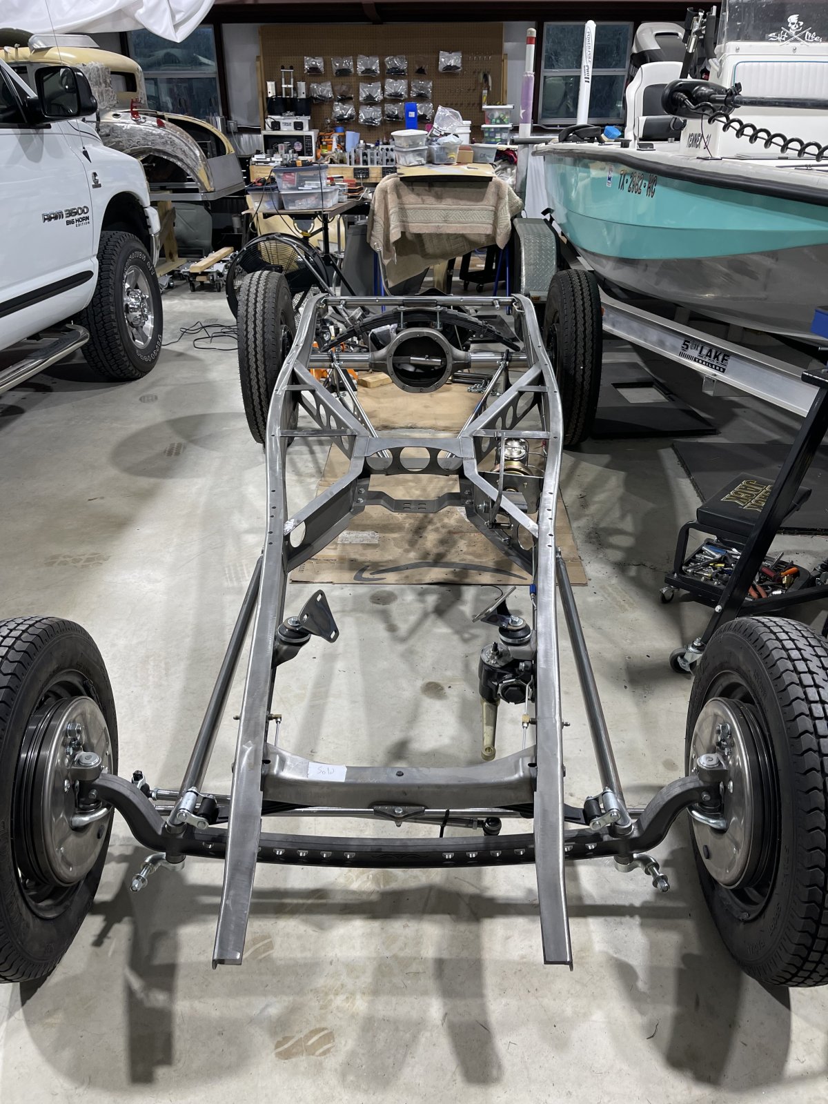

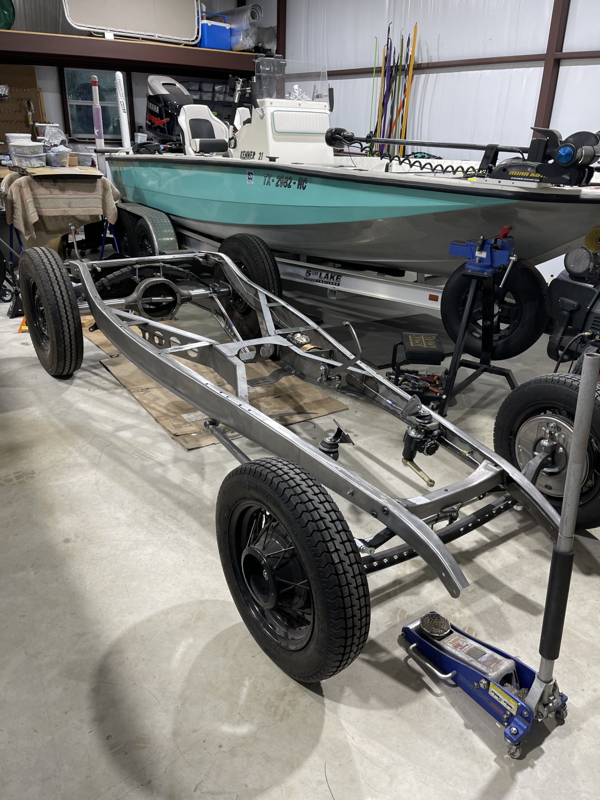

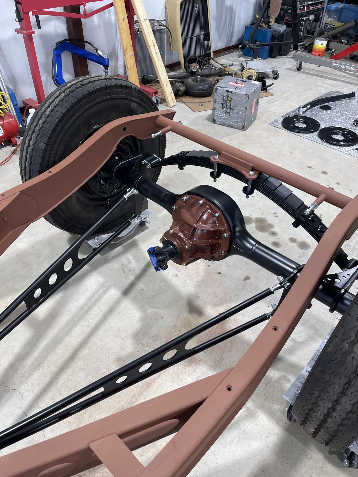

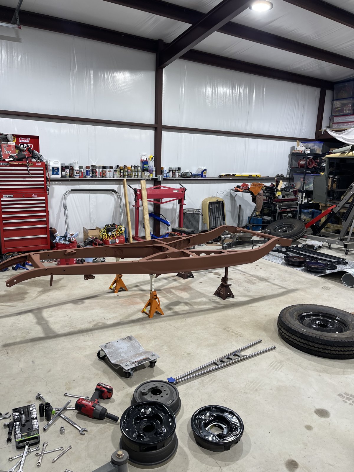

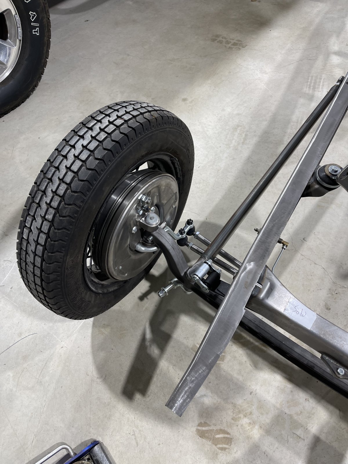

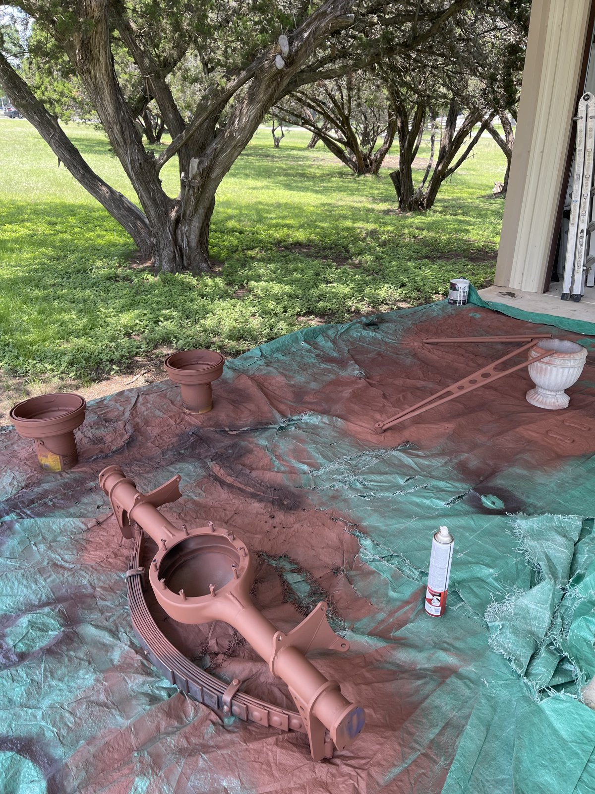

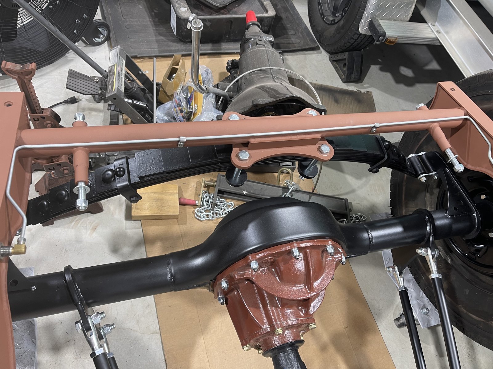

    Running gear paint and ***embly in preparation for the first body fitting. Need it to be a roller so I can move it soon.
    IMG_0274.jpeg IMG_0281.jpeg IMG_0293.jpeg IMG_0279.jpeg IMG_0280.jpeg IMG_0281.jpeg

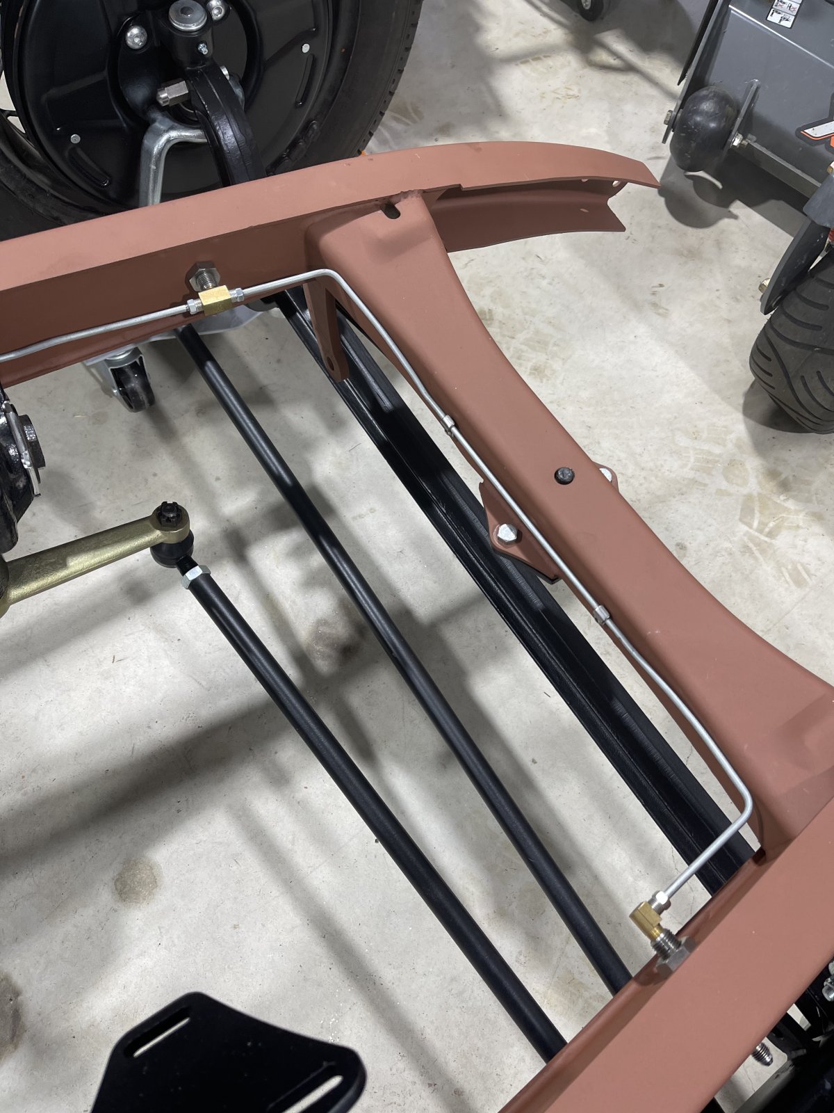

  15. -Brent-
    Joined: Nov 20, 2006
    Posts: 7,894
    -Brent-

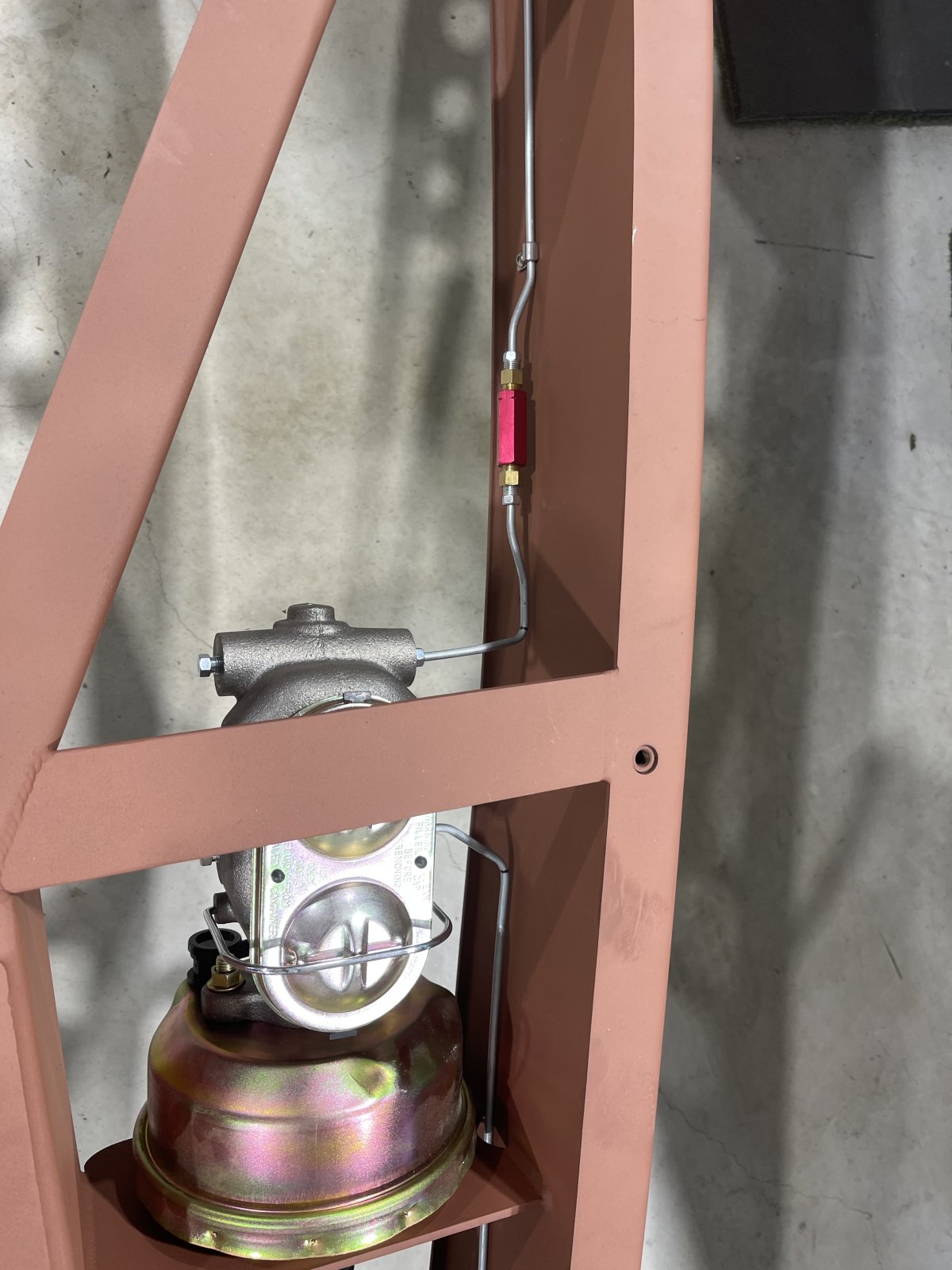

    Everything is coming along very well!

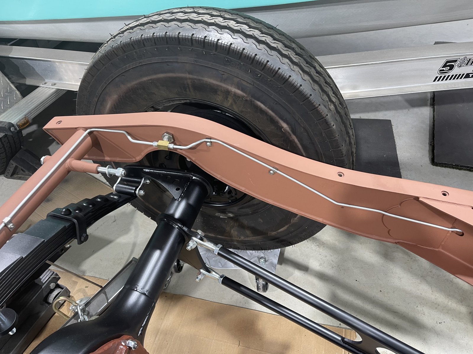

    Brake lines looking good from what I see. Got any detail pics of them?
    Hotrod31A and 31chevymike like this.

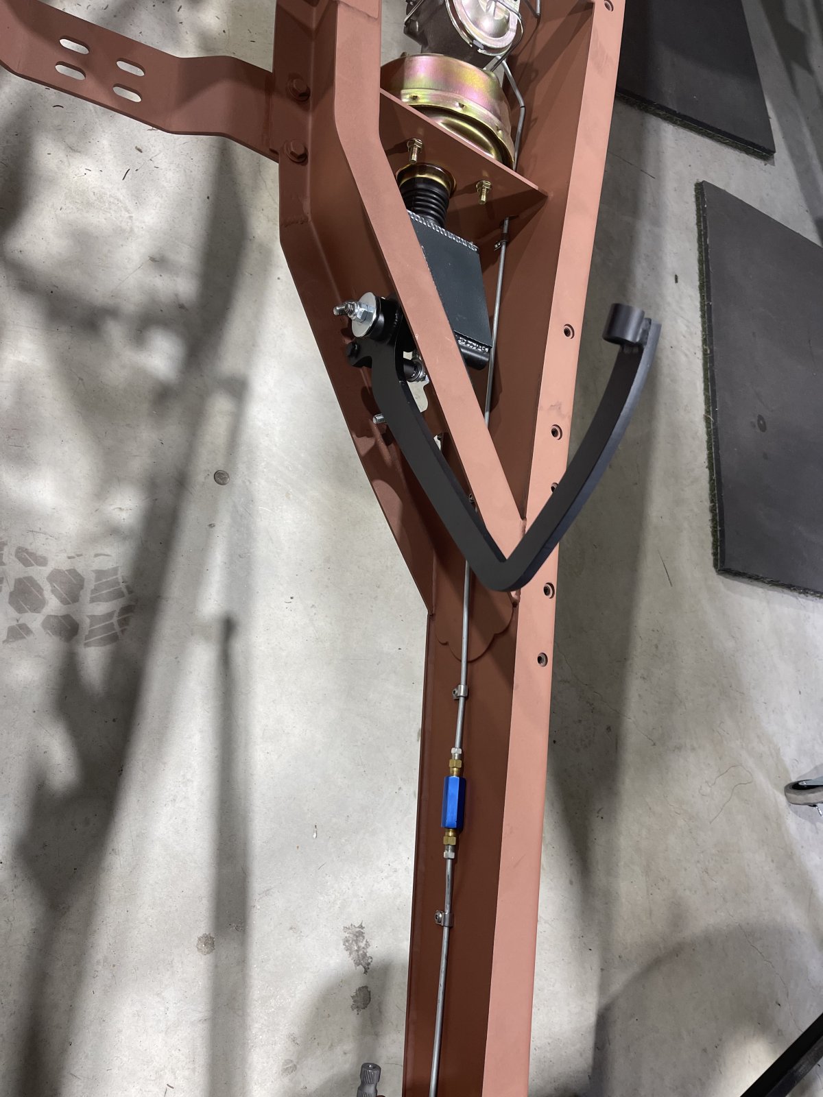

  16. Hotrod31A
    Joined: May 20, 2022
    Posts: 119
    Hotrod31A
    Vic Walter, akoutlaw, 2Blue2 and 3 others like this.

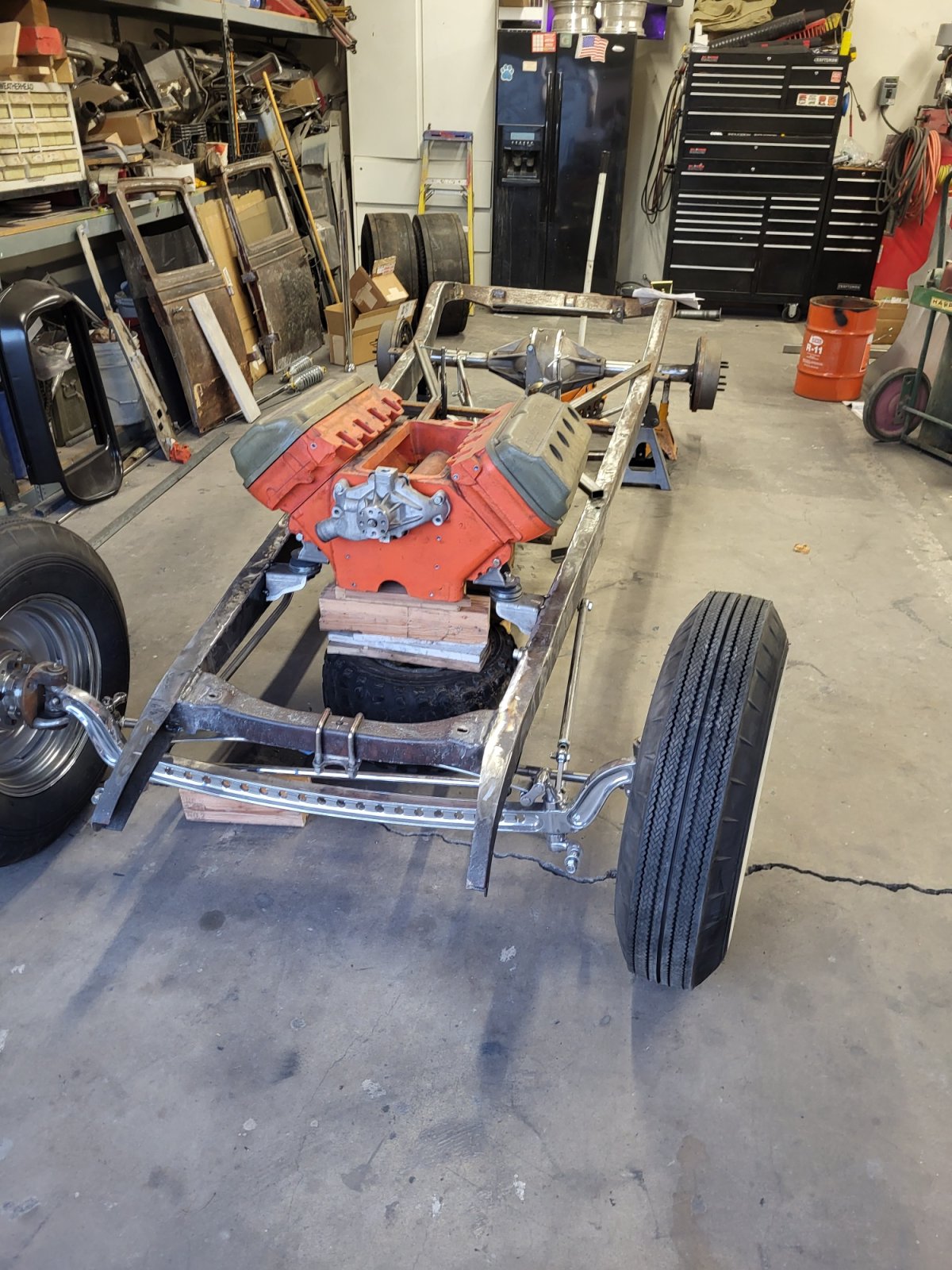

  17. I'm in the same scenario myself - although I have seen others run the brake lines across the rear. But with the movement of the rear, it seems running the brake lines across the shock mount above would be much better and solid. Besides, running brake lines in and around the ladder bar mounts could be a bit tricky... Like Brent, I appreciate your detailed photos as well - thanks alot!

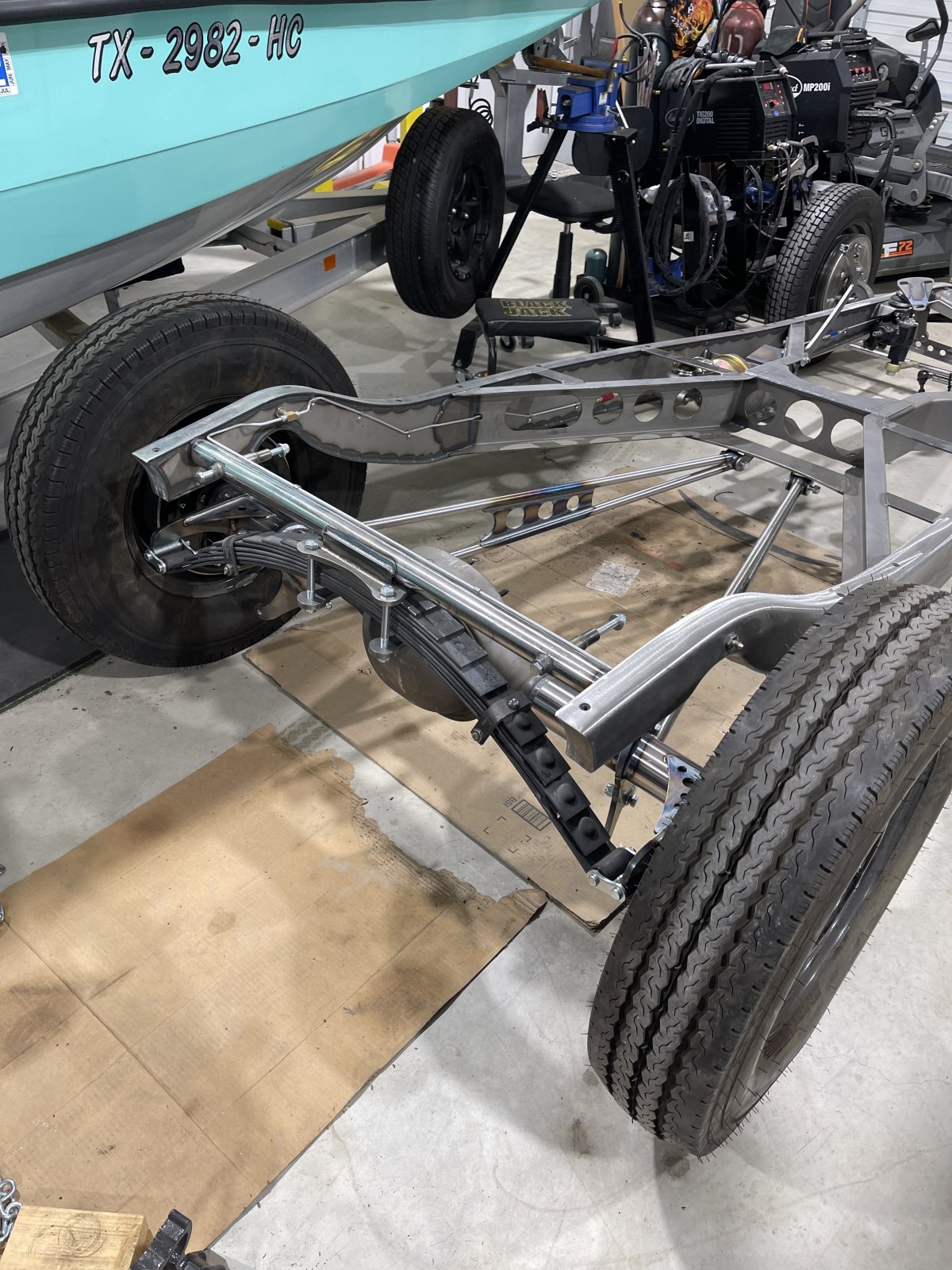

    Just an observation: I hope the gussets on the rear spring hangers don't interfere with the frame rail c-notch at full travel. I've seen that happen when the gusset is welded right at the top of the diff tube.
    They look like JW rails.
  19. Hotrod31A
    Posts: 119
    Hotrod31A
    Maybe a bit of an optical illusion, should have plenty of room for travel.

    Okay, if you're happy, I'm happy. I only mentioned it just in case.:)

    Thanks for the heads up will keep an eye on this during shake down runs.

  22. Hotrod31A
    Posts: 119
    Hotrod31A

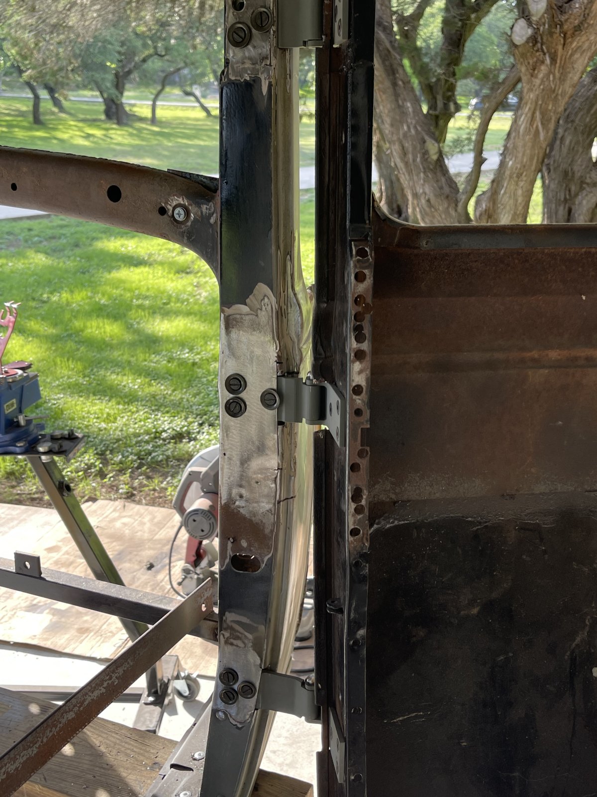

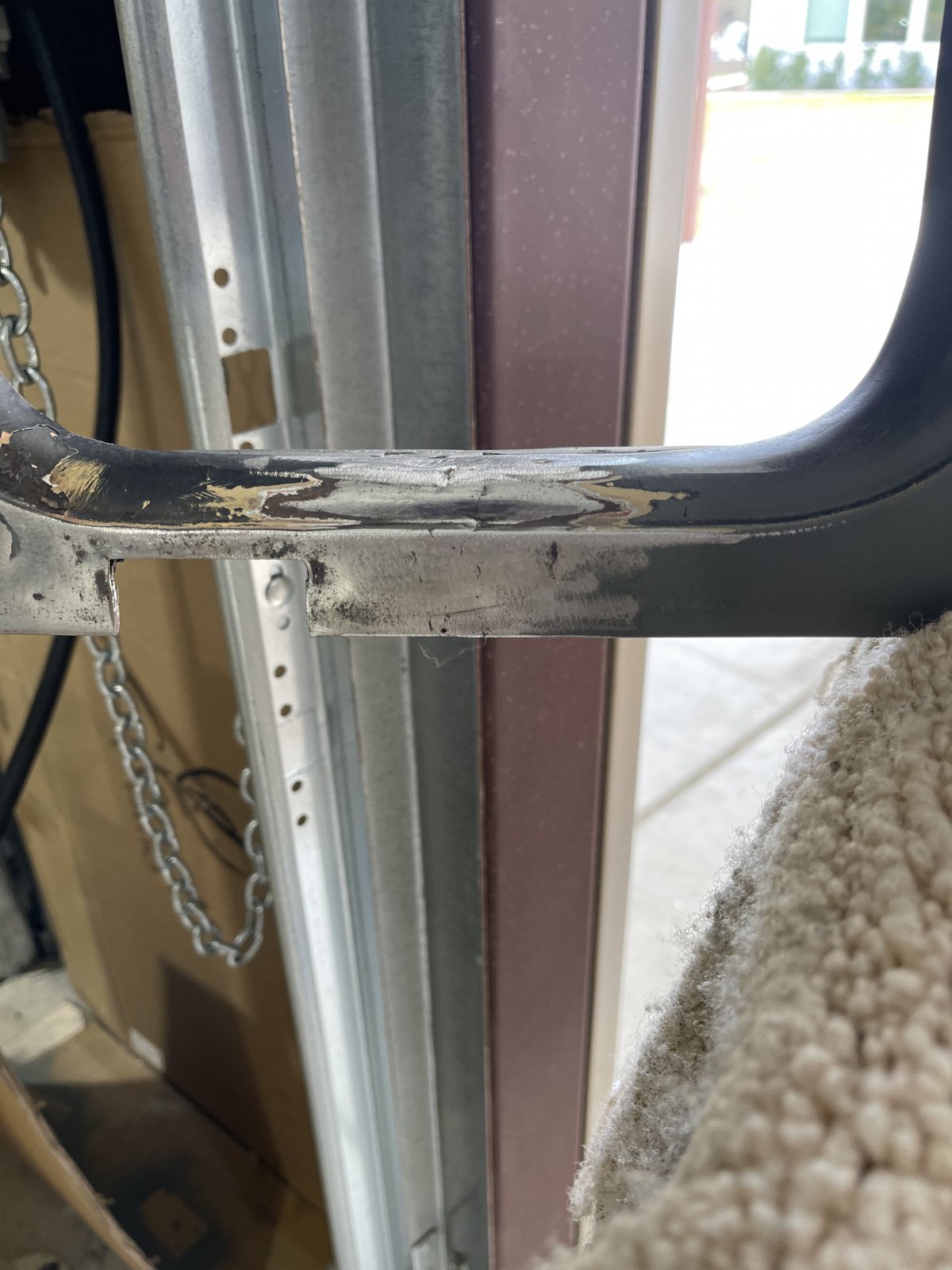

    First progress on the body in many months, p***enger door jamb repaired and fitted with new hinges. Feels good to back at it even though it will be short lived due to the upcoming move to the new garage. Still hinge work left but on the right path.

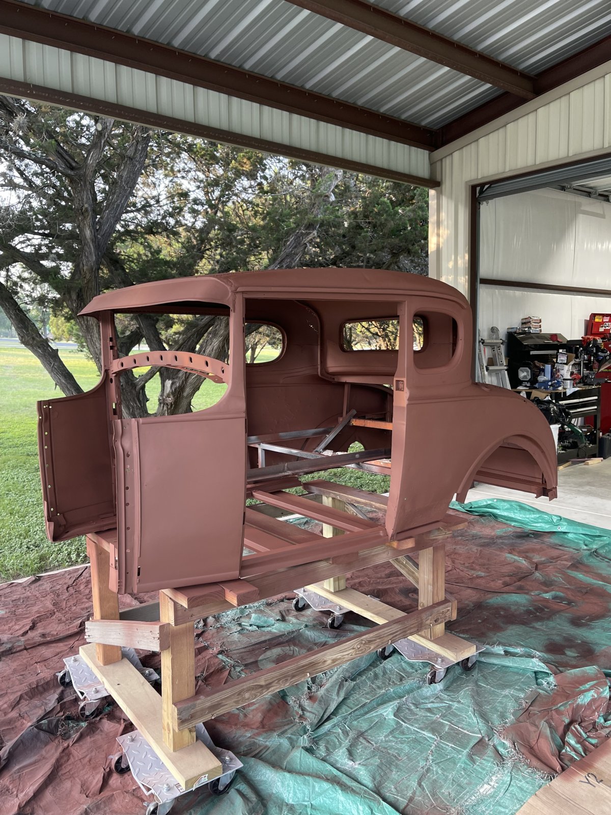

  23. Hotrod31A
    Posts: 119
    Hotrod31A

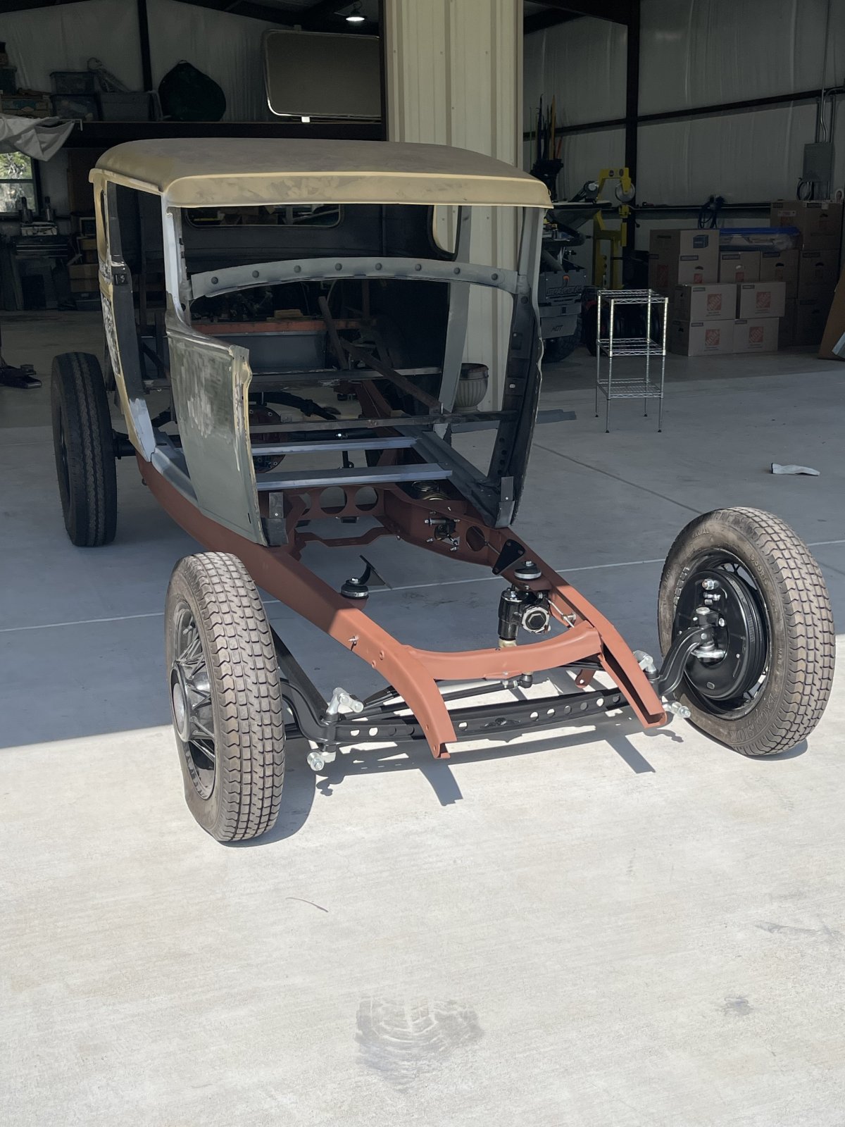

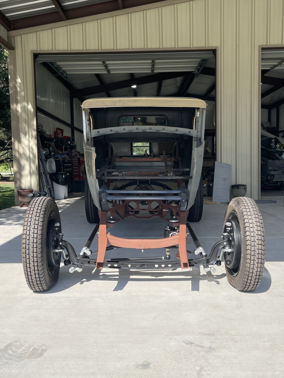

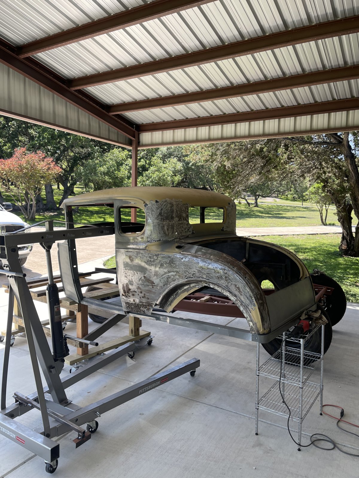

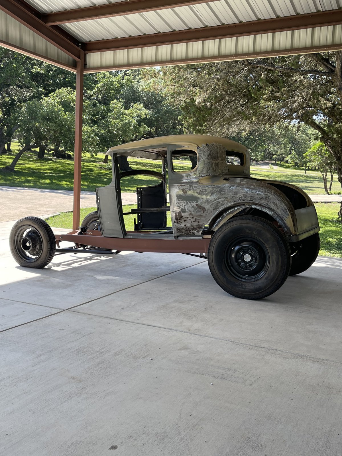

    First fit of the body to frame, good enough to bolt down for the move. Gives me some energy to get moved and finish this thing! IMG_0344.jpeg IMG_0349.jpeg IMG_0351.jpeg IMG_0350.jpeg

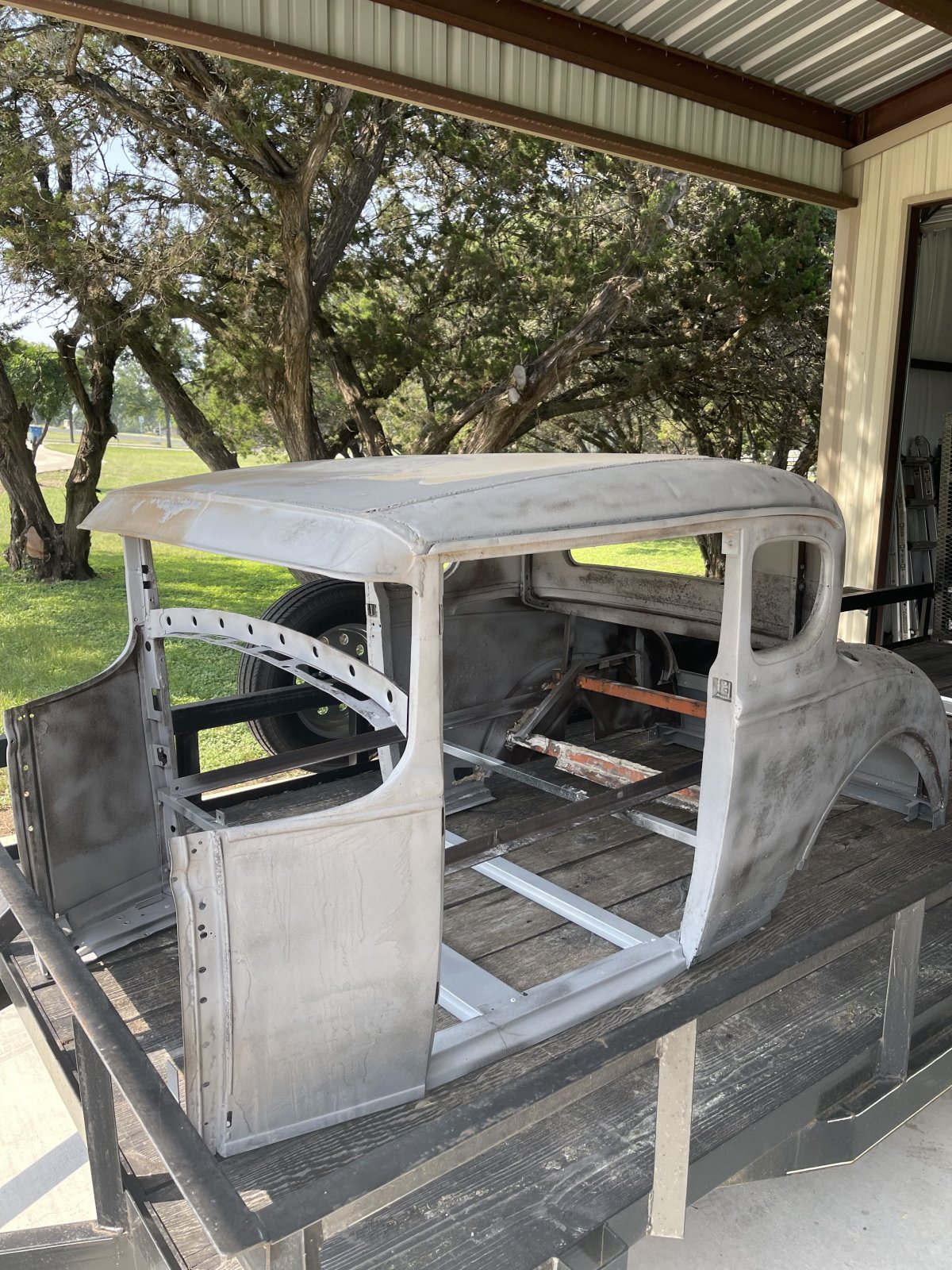

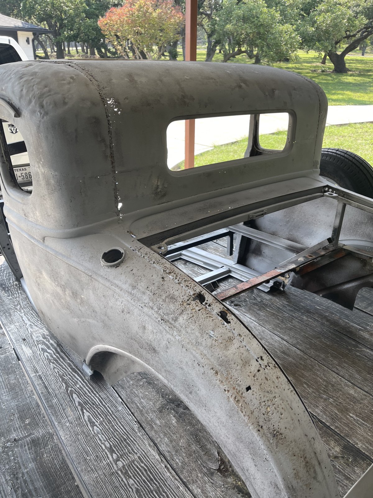

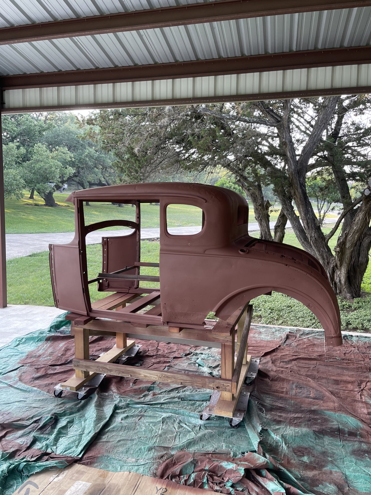

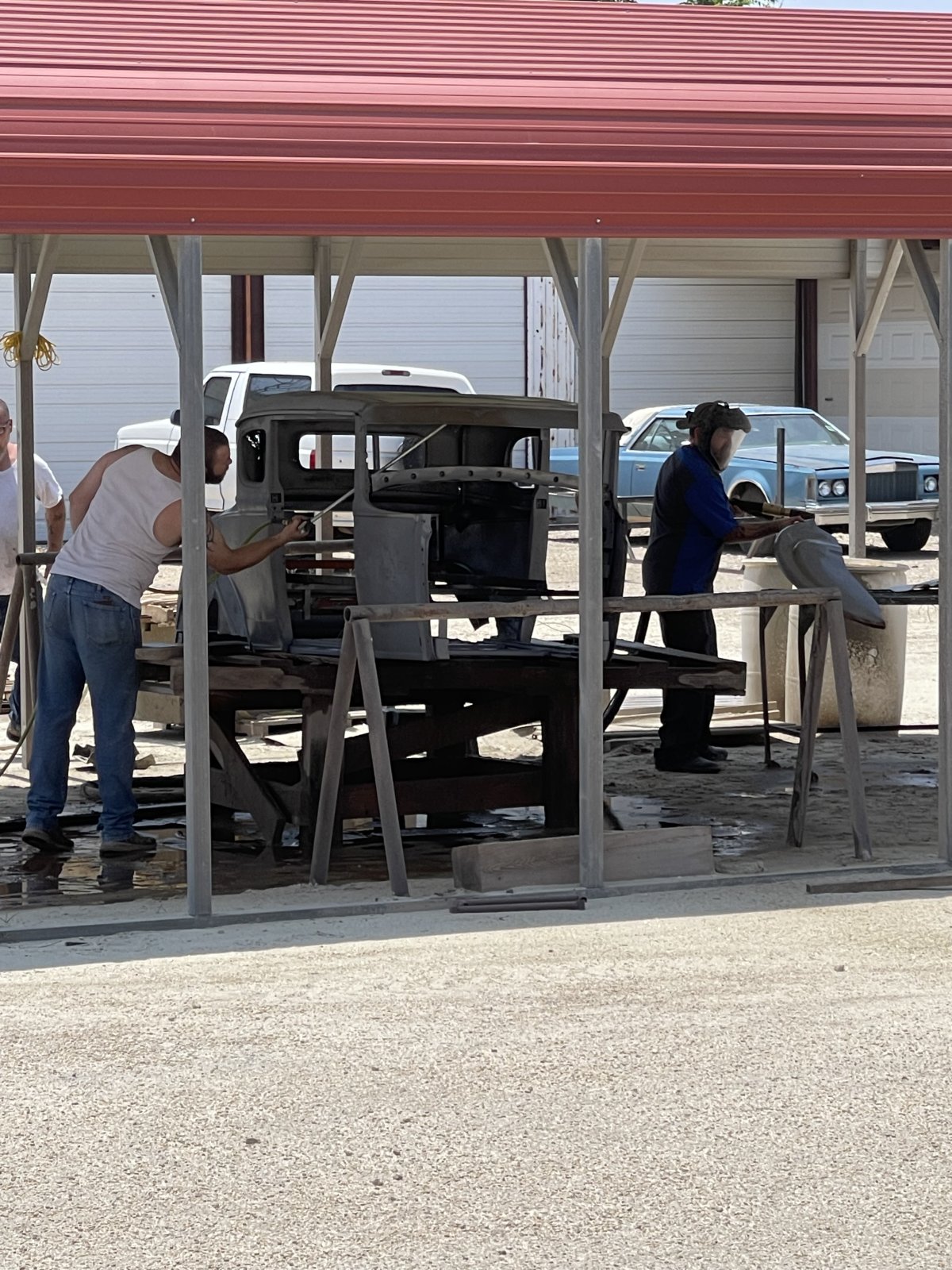

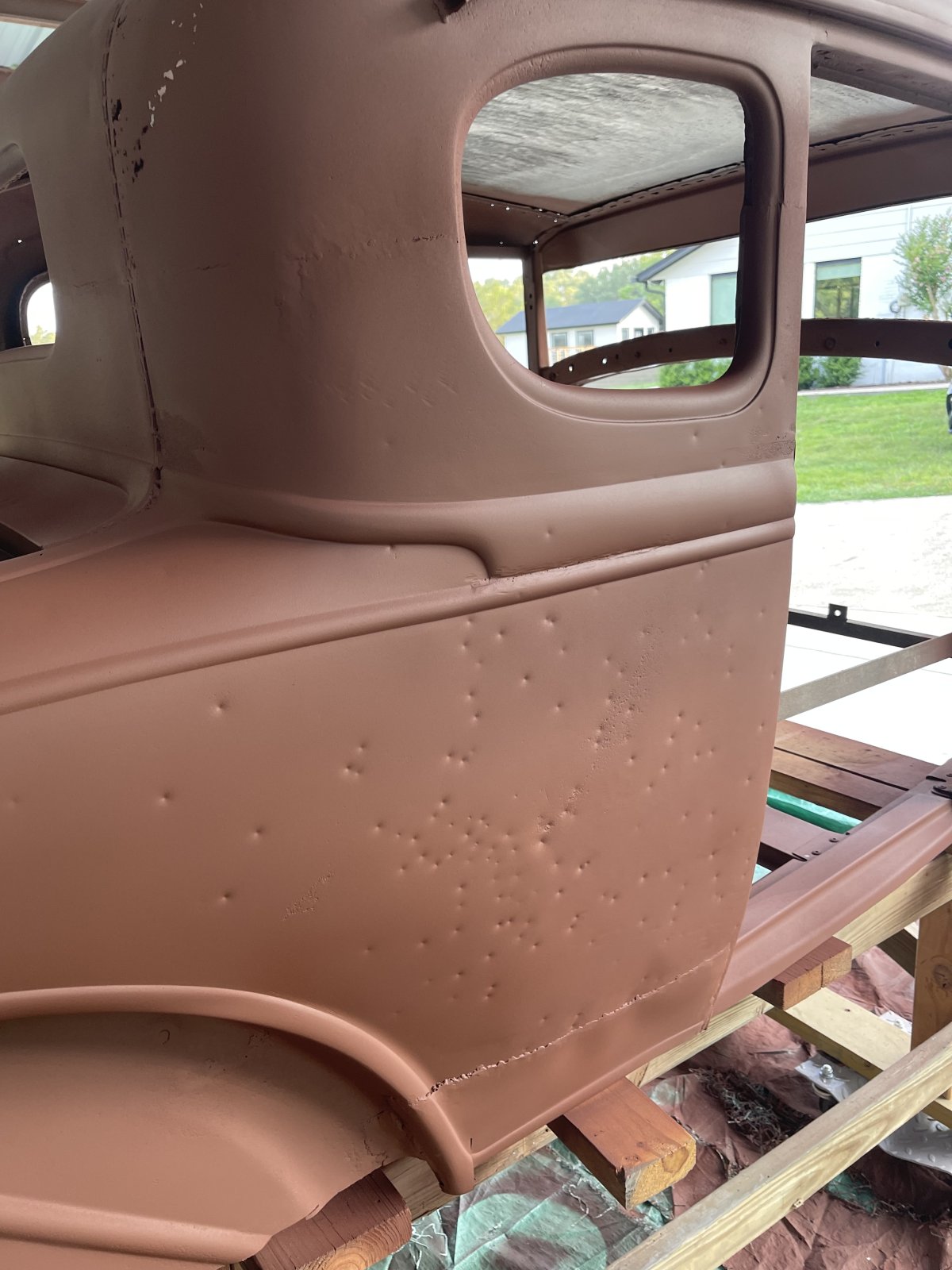

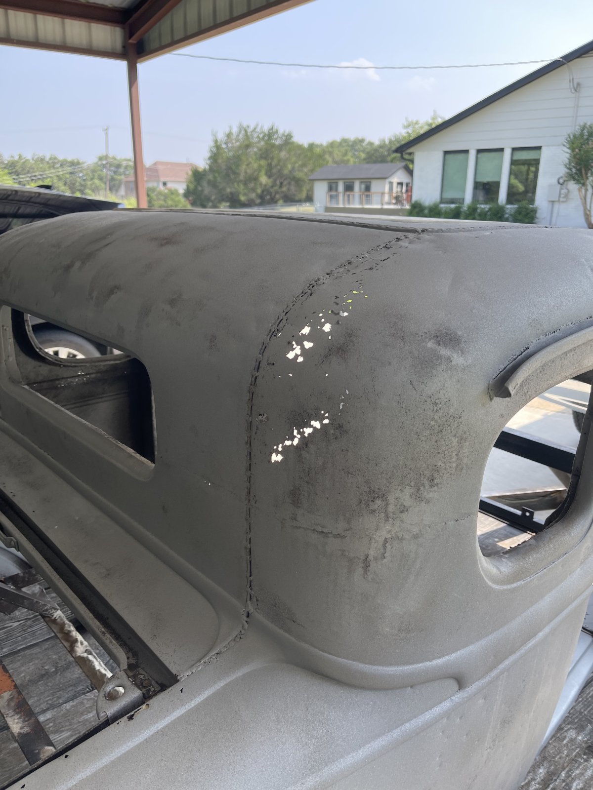

    Another big step today, finally had the ole girl media blasted and primed.
    Holy moly!!! She has quite a story to share, once shotgunned, swiss cheesed by rust and a slew of half ***ed repairs over her life. Many hours of panel beating and welding in our future together.
