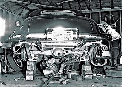

    Doug Cook doing the same thing in exchanging the rear gear ratio third member or working on his muffler system. But, I have to say, the 58 Impala was up on metal jack stands and not 4x6 inch blocks of wood. It was just the idea of actually jacking up the Impala, removing the axles and then replacing the complete Positraction third member with the new Positraction unit and reverse on Sunday. YRMV
