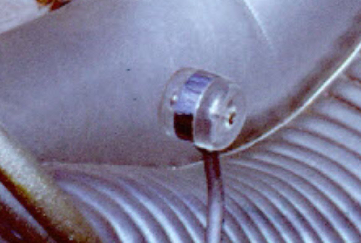

    Can't remember if I posted thsi before here. Couldn't find it in quick scan of all the pages so here it goes (again?).

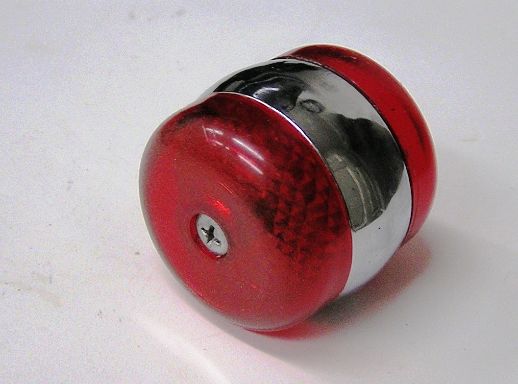

    I needed a clear barrel knob for my Ed Roth Mysterion reproduction. Much searching left me dry for any colored barrel. Finally found one with red ends on ebaY so I decided to get it and make my own clear ends caps.

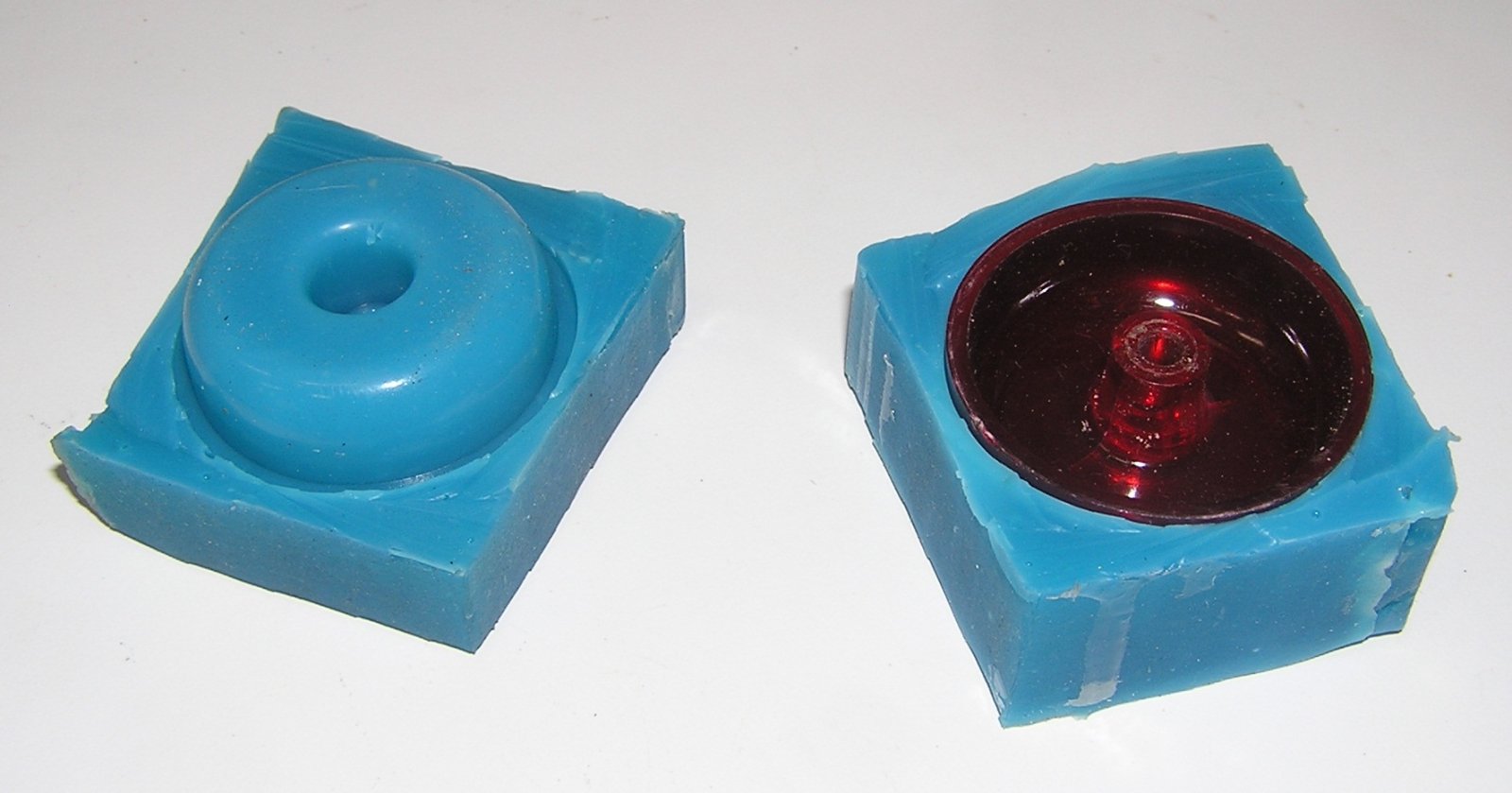

    I cast a silicone rubber mold from the red cap. Then I tried several clear resins before I found urethane made the clearest, water white caps. Worked perfectly.
    Here is Ed's knob

    This is all I could find on ebaY

    This is the silicone mold.

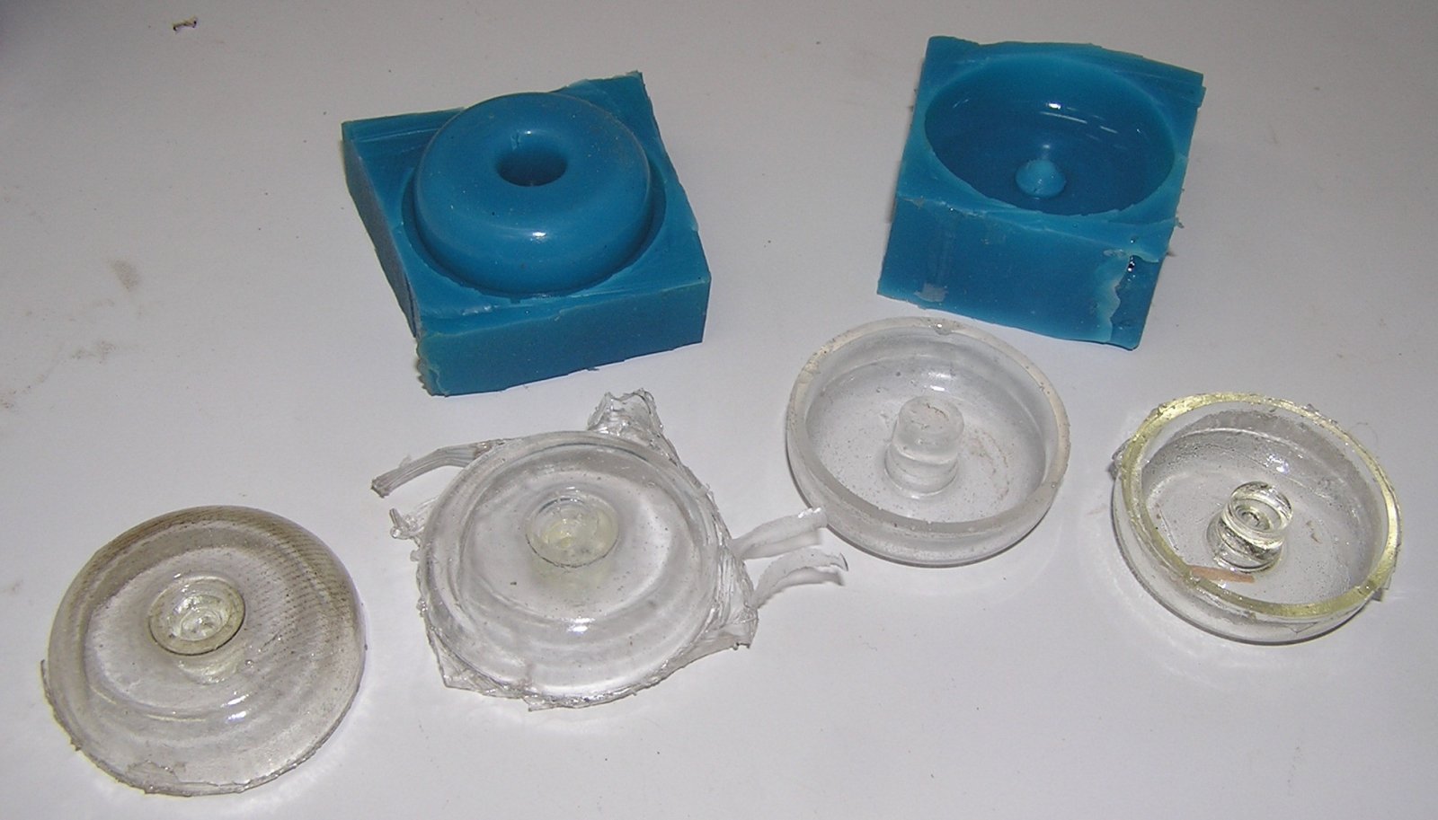

    The outer castings are polyester clear resin castings. Really popular for making those ugly old 60s style clump of g****s hanging lamps. It yields a strong yellow cast. The two inner castings are urethane plastic resin. Just wnat I needed.

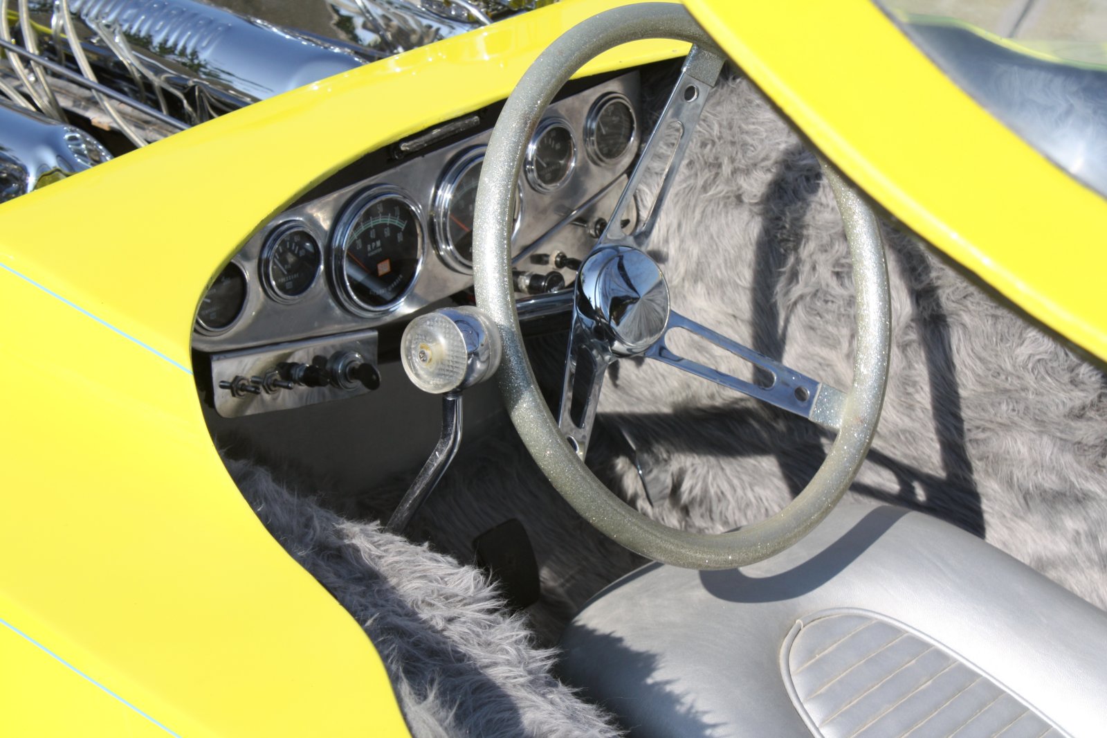

    This is my resulting version. Perfect.

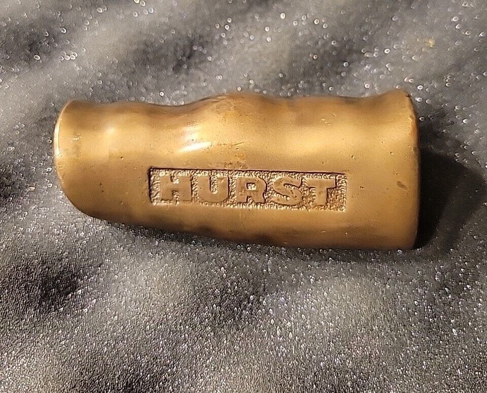

  17. I think Hurst made br*** ones, I've also seen black fuzzy ones, and of course a ton of aluminum ones.

    I would say the br*** ones a pretty heavy......
