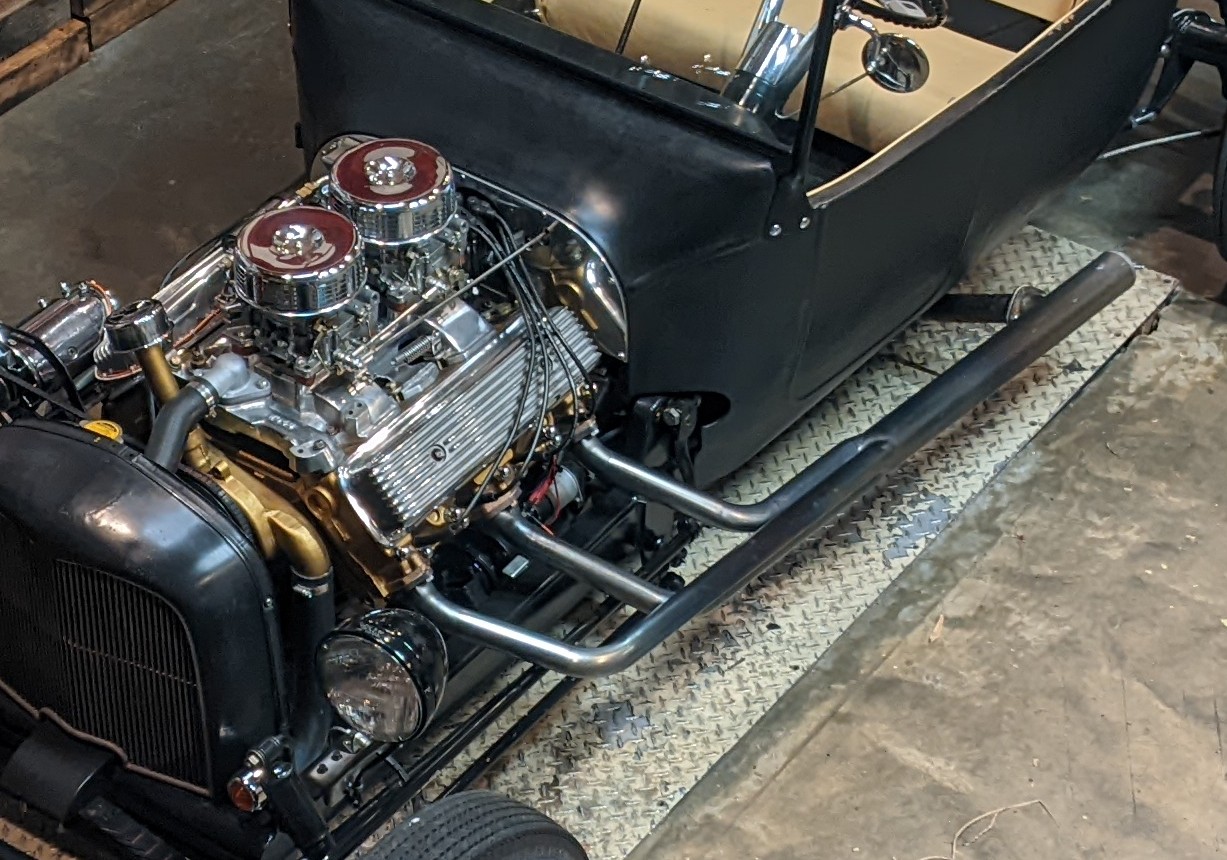

    whatever gets the job done

    Diggin' it, don't know how close to the body I'd want them, seems it might toast paint. Note the pipe coloring.
    That has another thing that I'd want to incorporate into my build IF I did a ground up.
    That super deep dish wheel. Couple that with a quick disconnect and you have lots of room for ingress and exit. Looks cool too.

    The pipes will get hot, but that discoloration indicates the engine was too lean.

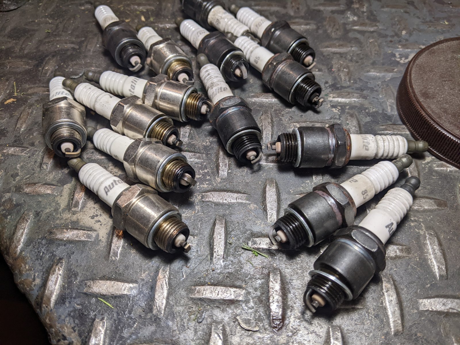

    02 sensor says it lives in the 12 to 14 range mostly mid 12.
    plugs show carbon on body and light tan ceramic.
    the blue is from driving it hard.
    there is 4" between pipe and rattle can paint.

    While mixture & hard running does blue pipes , retarded timing will fry headers in a heartbeat .

    ^ his plugs look like the heat range and timing are right on to me.
