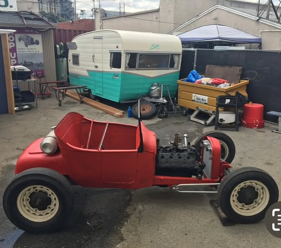

  30. RodStRace
    Joined: Dec 7, 2007
    Posts: 9,025
    RodStRace
    Is this a new build? I saw he had Piero's starting point and didn't do that one.
    EDIT: the pic is on his instagram page and also on FB with this text.
    I'm not signed up to either but was able to see this.
    https://www.facebook.com/lucky.burton/
    Lucky Burton is at Lucky's Hot Rod Shop.
    14h · Burbank, CA ·
    This was my little T project. I gave it to @mad_fabricators and the rest is history now.
