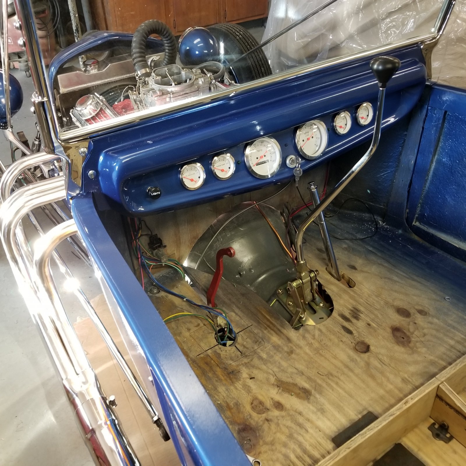

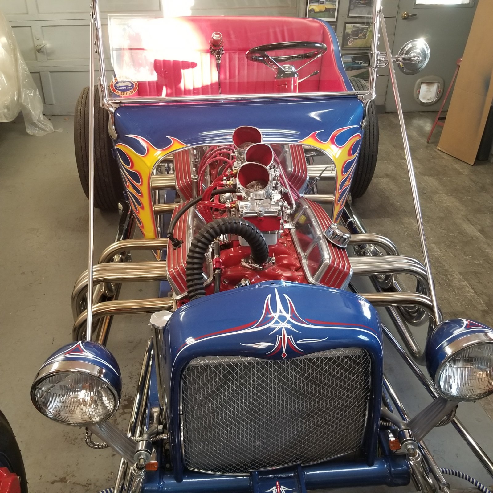

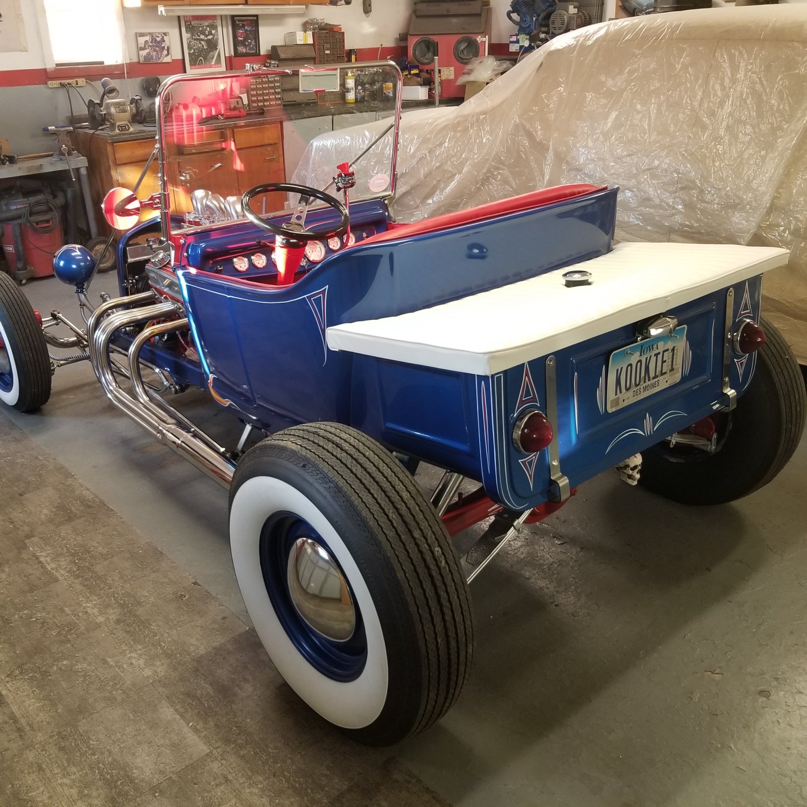

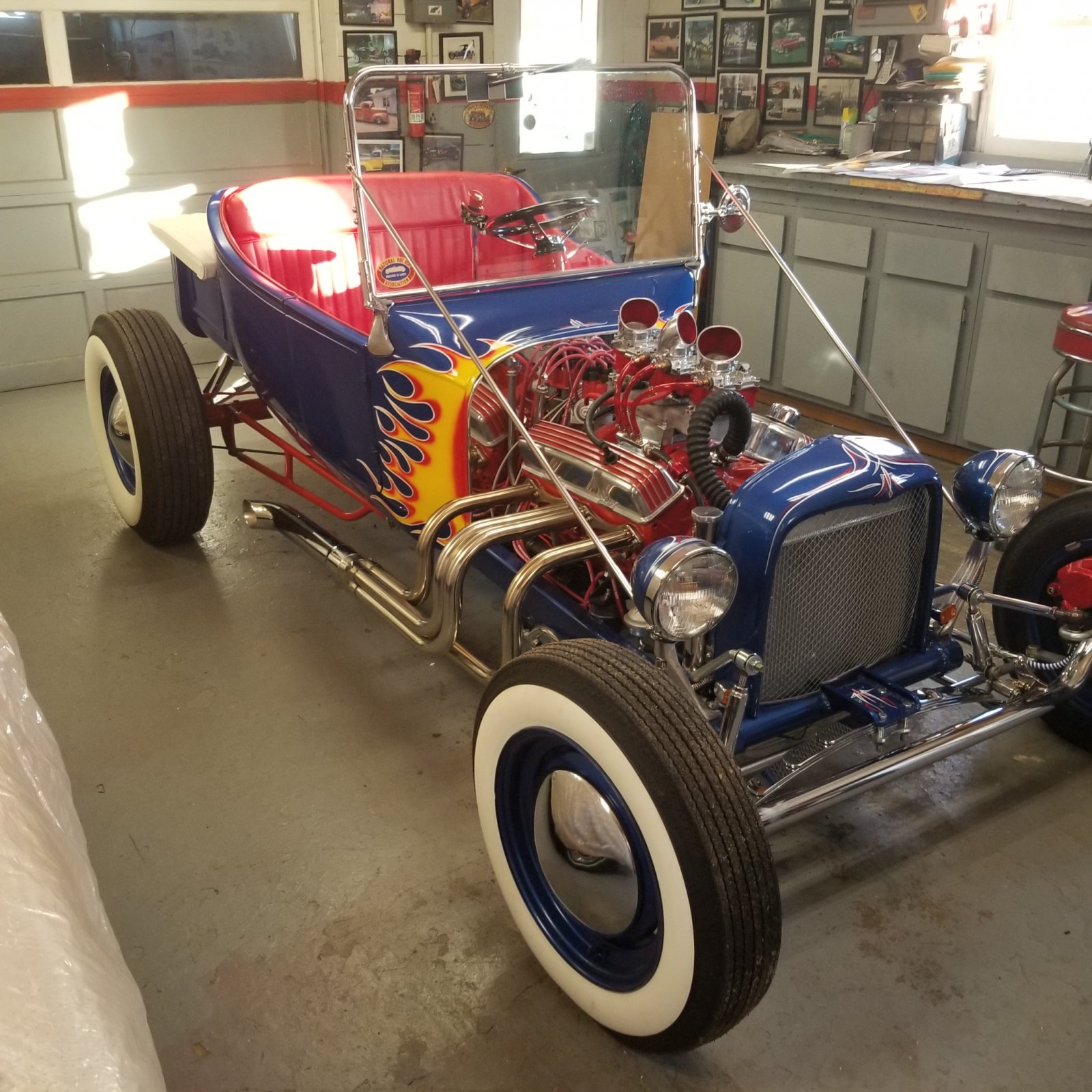

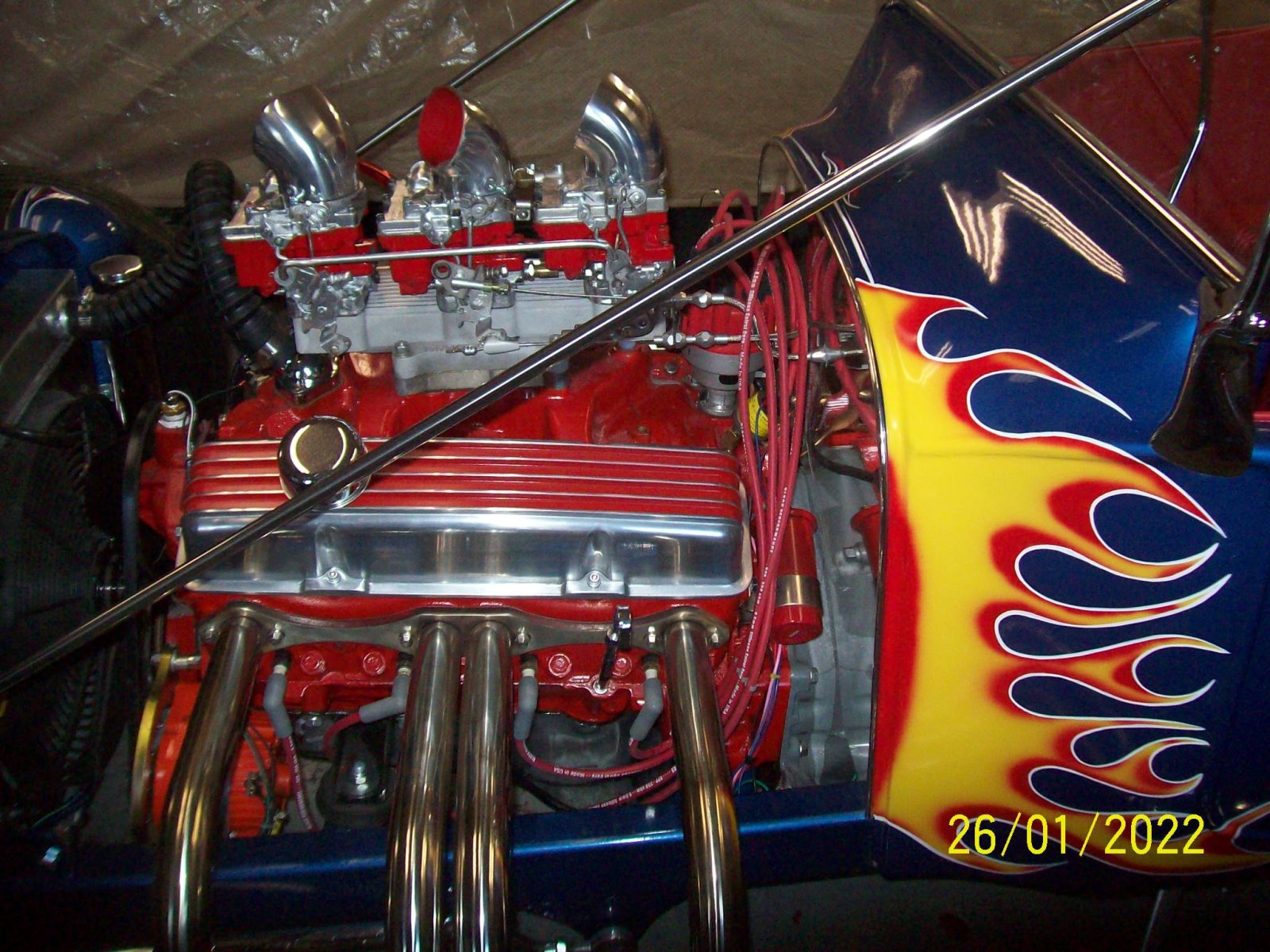

    Well, pinstriper came and so I guess it's finally finished. My 3rd one like this. Can't wait till Spring to show it off. 20220121_160706 (1).jpg 20220121_160748.jpg 20220121_160659.jpg 100_4733.JPG 100_4723.JPG 100_4733.JPG

    Wow...
    We need a build thread...or at least some build pics!

    This is got to be one of my favorite T-buckets. Very cl***y.

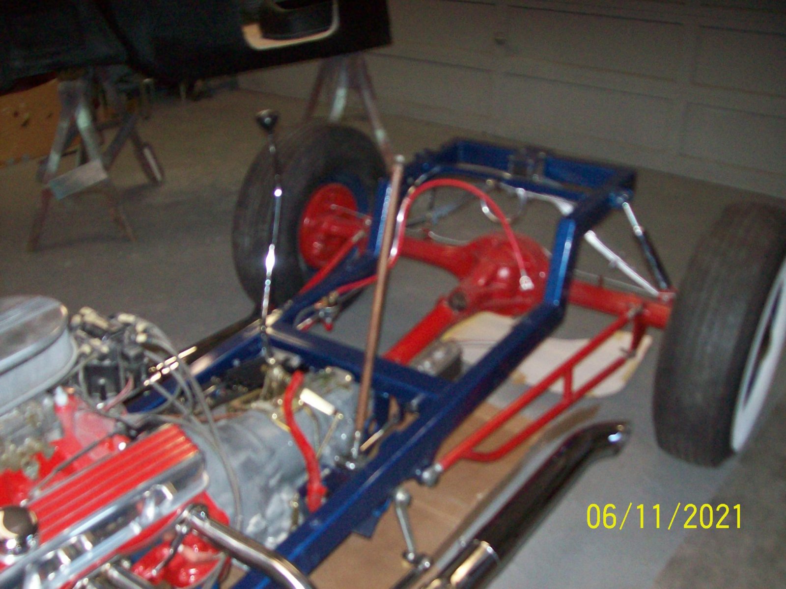

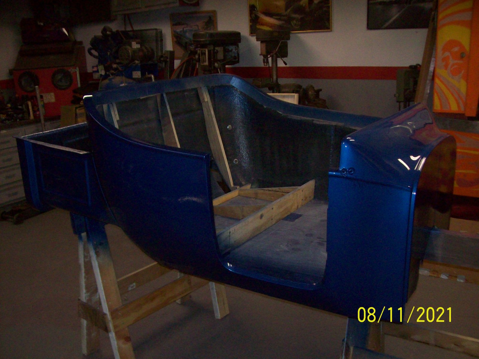

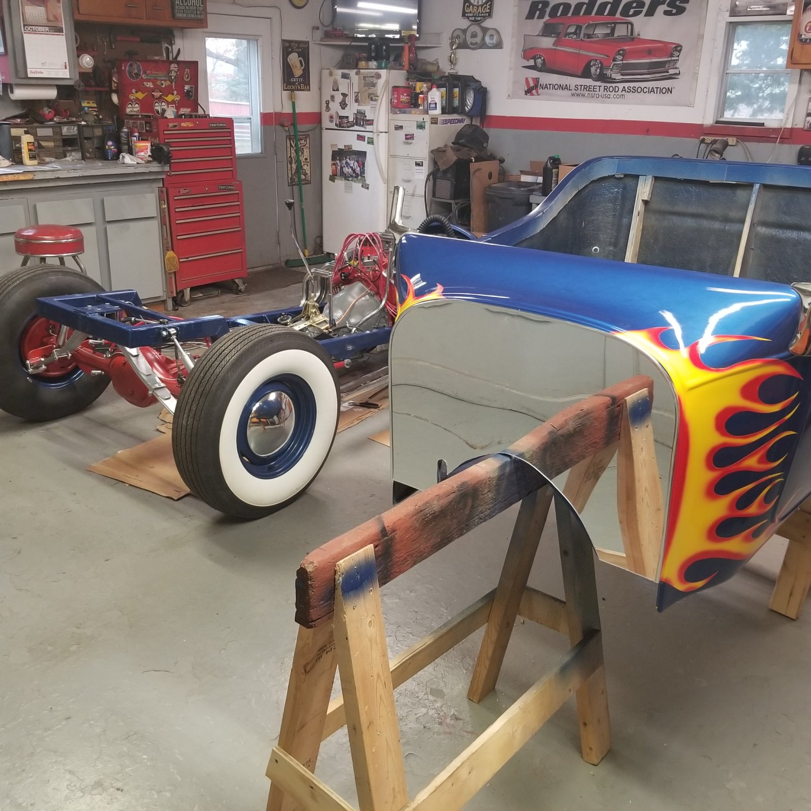

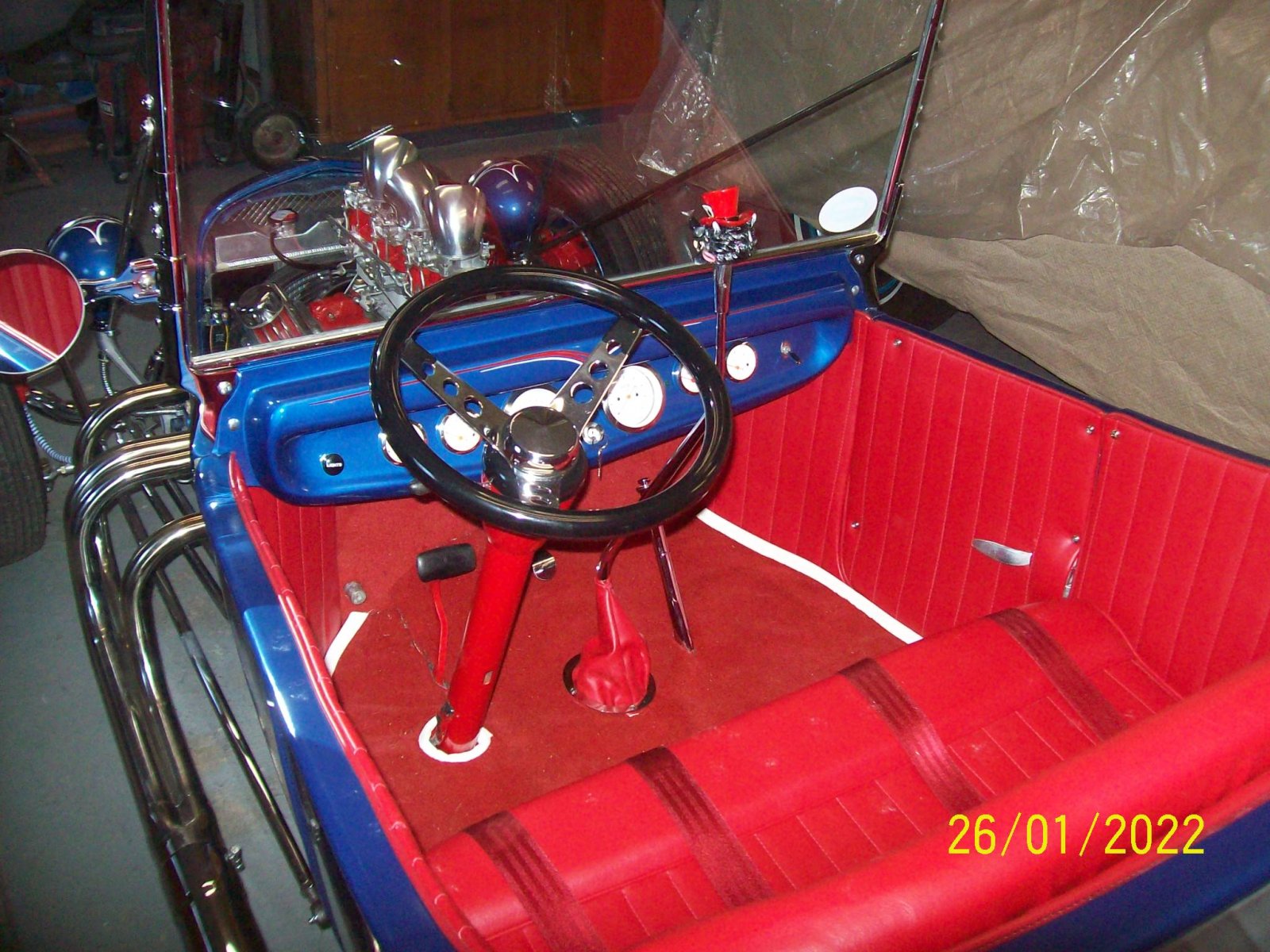

    Ok on the build pics. 100_4708.JPG 100_4709 - Copy.JPG 100_4703.JPG 100_4690.JPG 100_4705.JPG 100_4710 - Copy.JPG 100_4722 - Copy.JPG

    Thanks, cool pics!
    Where is the body from?
    What steering box?
    Is the frame one off, or?

    The body is from Hot Rod Fibergl***, use to be MAS back in the day, best price today. Steering box is Corvair, reversed, And I built the frame from 2x3 steel tubing. Thanks

    [QUOTE="Hot Rod Nut[/QUOTE] wondering how you connected steering shaft to the box.

    Connected with a 3/4 round weld on tube and spleend on other end to fit on tne box shaft.

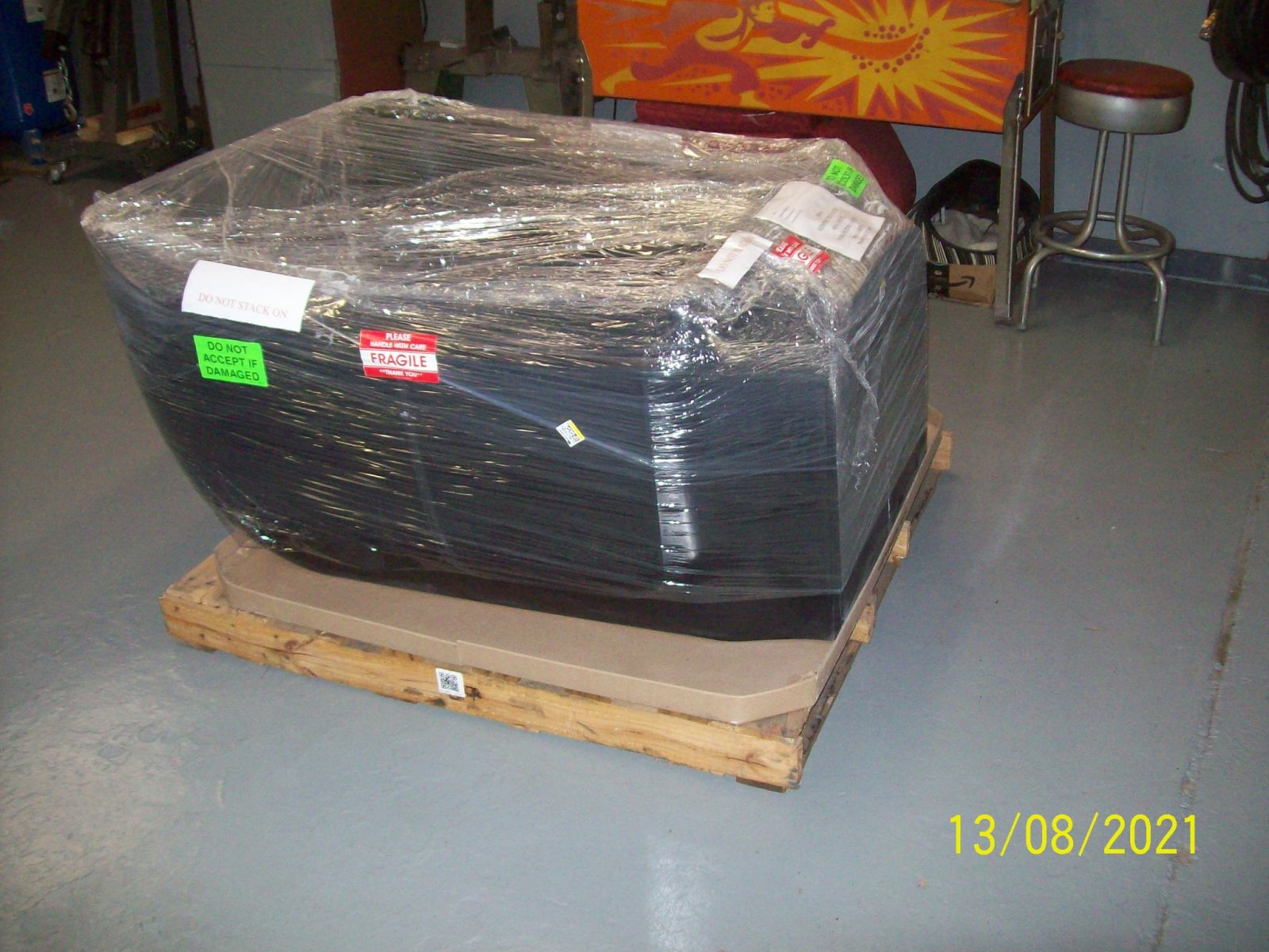

    Wow, you don’t mess around...the “Hot Rod Fibergl***” body was still shrink wrapped last summer!
    Do they still bond the 2 body halves together?

  24. Hot Rod Nut
    Joined: Jul 1, 2006
    Posts: 571
    Hot Rod Nut
    uea, I can build one in about 9 mo.
    bchctybob, A Boner and loudbang like this.
  25. Hot Rod Nut
    Joined: Jul 1, 2006
    Posts: 571
    Hot Rod Nut
    Yea, and you have to sand that smooth.
