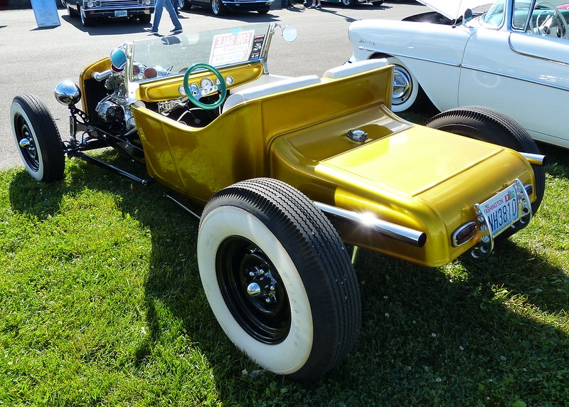

    ^^^^ and with that car, they reached the pinnacle of tasteless and ostentatious. The only thing missing is gold plating….

    The cowl lights look like they might be gold plated!

    Yeah, it is yellow….and brown and black and blue.

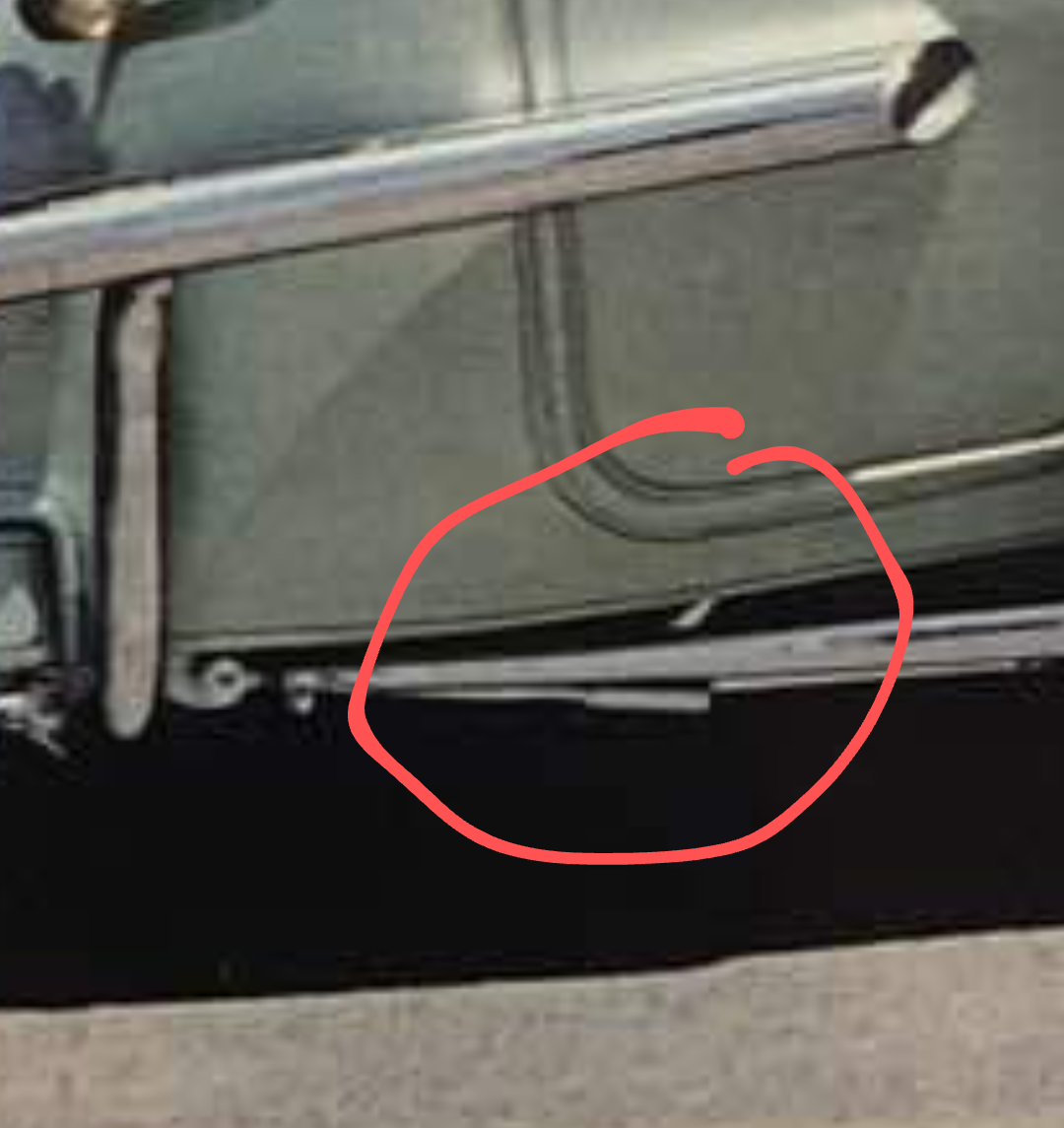

    and you can see the end of the inner drag link behind the rear radius rod

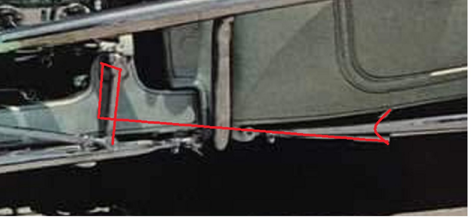

    2 old, lots of possible, but my WA guess is a box under, connected to a link behind, with the rod going forward to an inside drag link hanging down from the pivot, with the pivot transferring the same motion to the outside drag link. tsteer1.jpg
  28. bchctybob
    Joined: Sep 18, 2011
    Posts: 6,039
    bchctybob
    Yeah, the "steering box" ahead of the firewall is really just a heavy-duty bell crank, the steering box is under the floor by the driver's feet.
