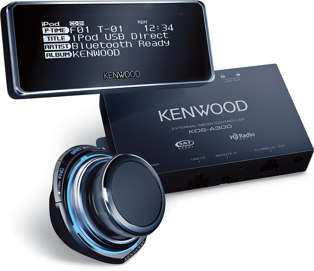

    If you need to have AM/FM/Sirius etc. then add a Kenwood KOS-A300 to the equation. They are down to about $70 and allow you to connect an iPod, USB drive, Sirius or HD radio box. Most of this stays hidden and all you see is a small LCD display and a wired joystick remote. In my '32, I am mounting the LCD behind a sliding panel in the header.
