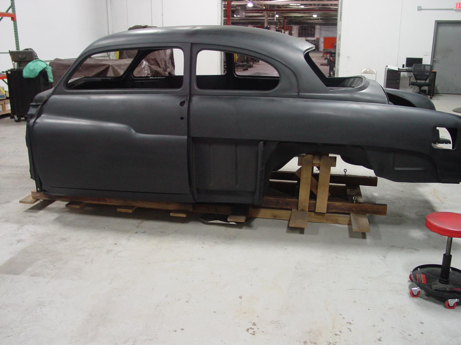

    Ch***is done, getting ready to start on the body. I bought this car for my Dad for his retirement gift. He always dreamed of having one. Best feeling I've ever had was buying it for him. We just started working on the car and 4 months after he retired he past away. I didn't touch the car the a year after that. It's new name is Dad's Dream. I will end up handing it down to my son someday now. Hoping to get to share some good times with my family in it. Hope you enjoy the pics.
    Car is sub framed with a nova sub, power disc brakes, new gm crate engine 350 turbo, nova 10 bolt rearend, The rear susp. set up is from no limit, 9 inches of air ride travel, low low, more to come soon.

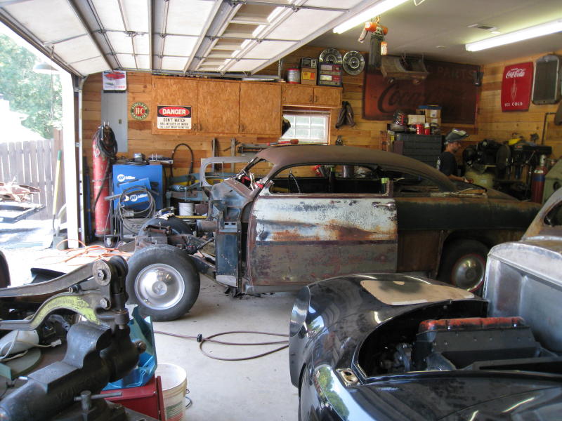

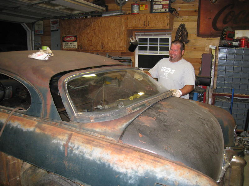

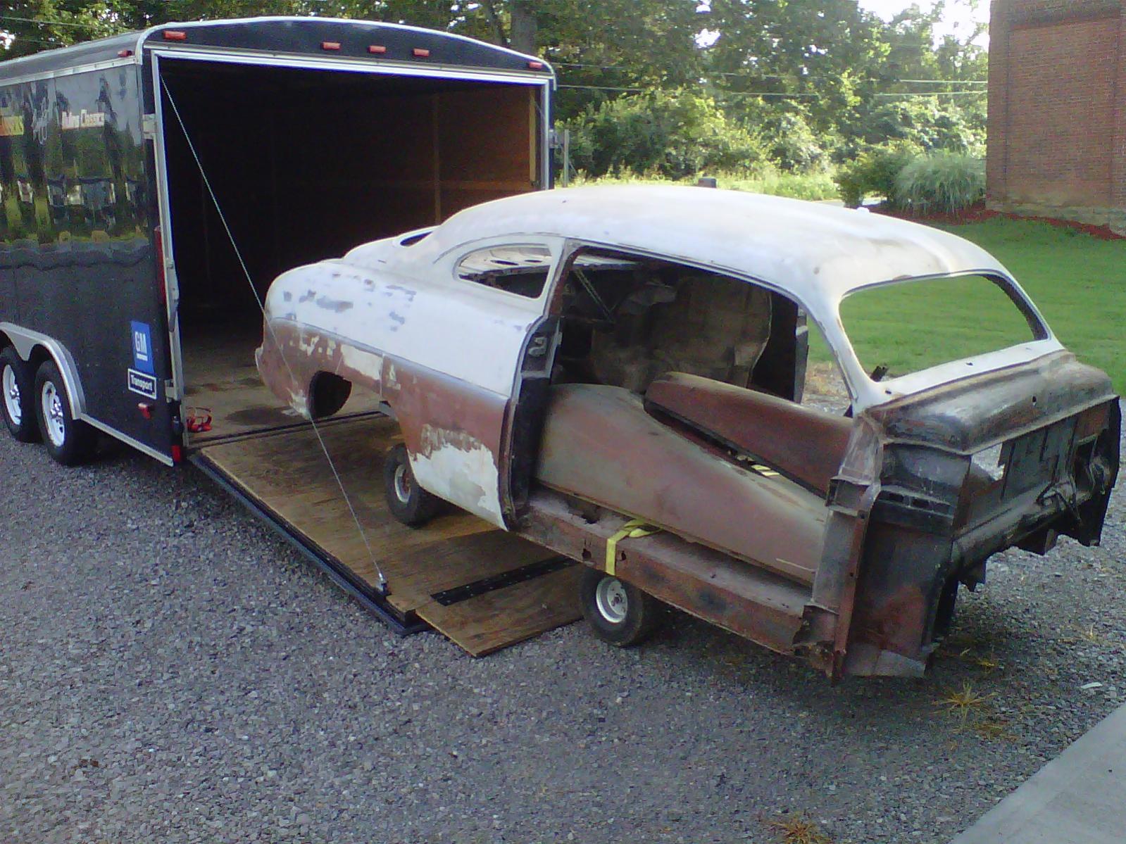

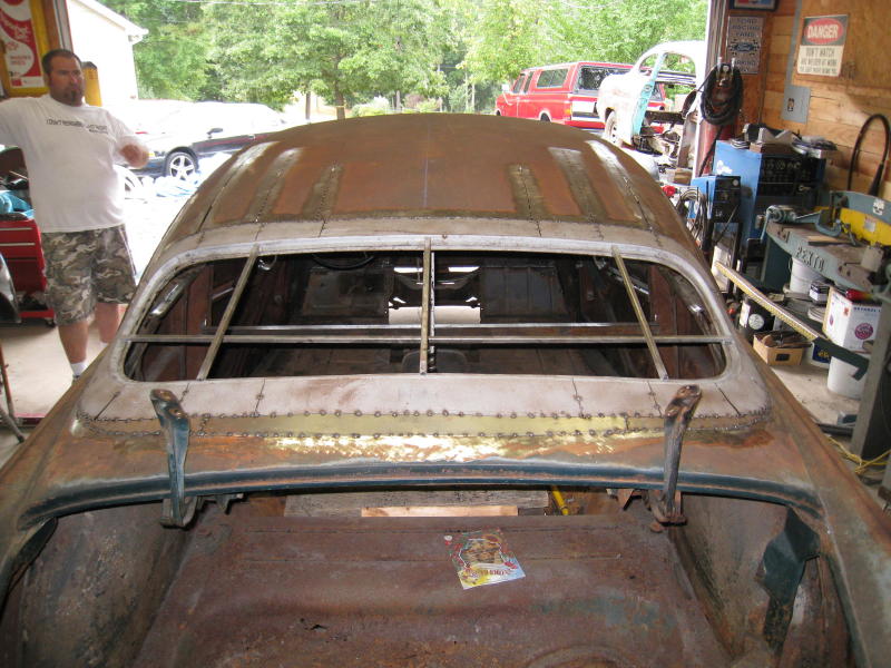

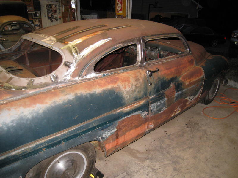

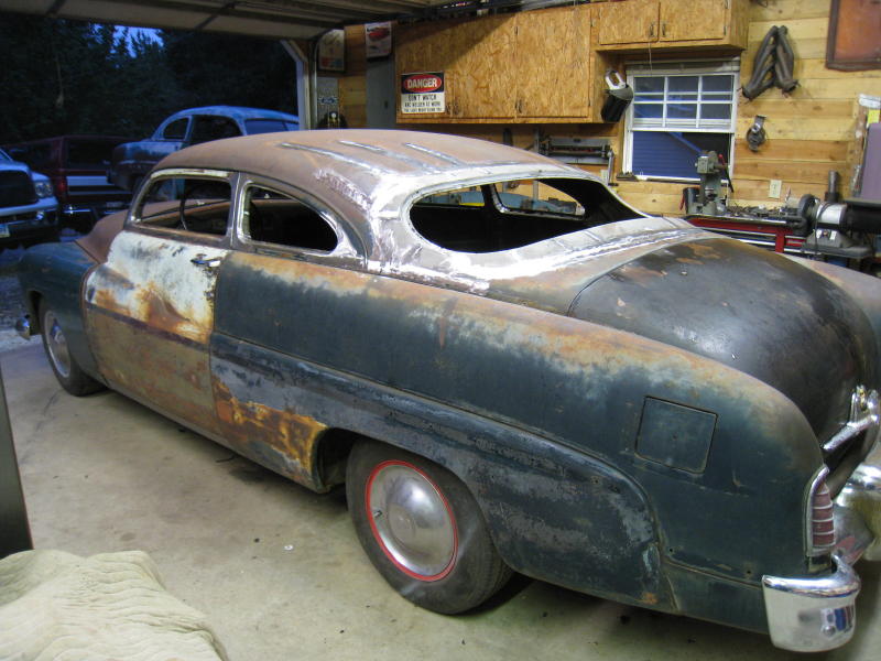

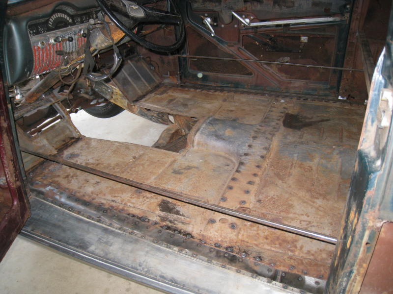

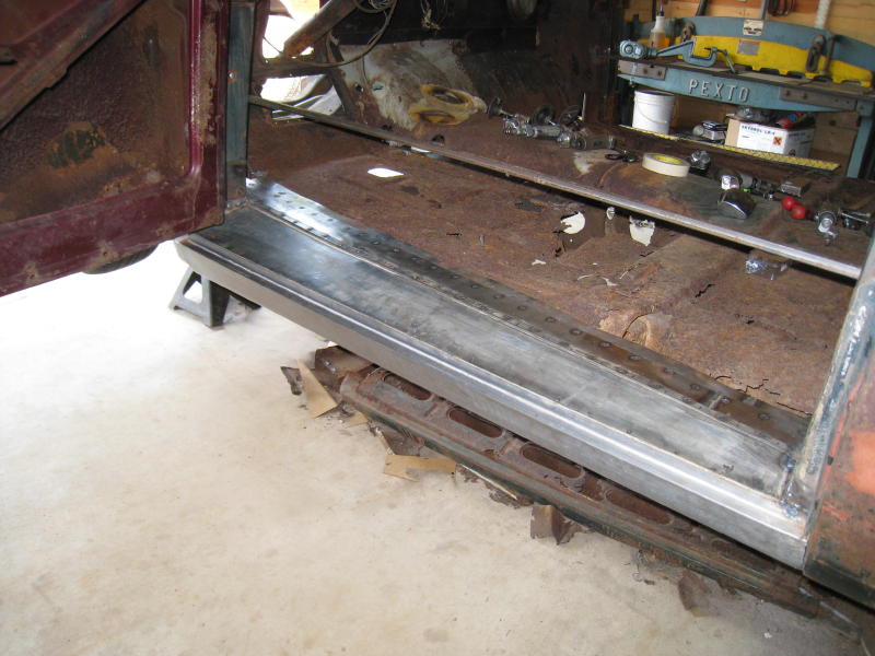

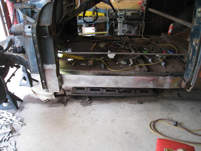

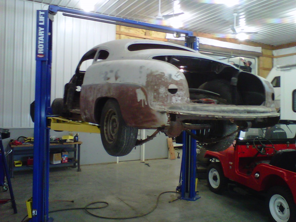

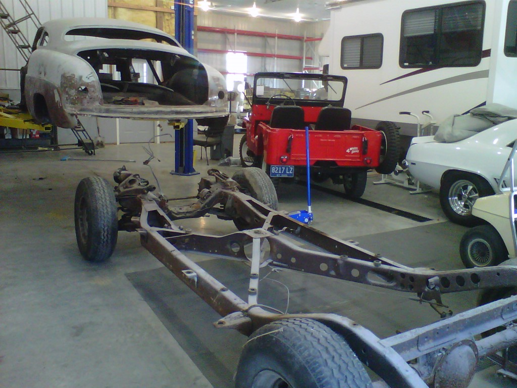

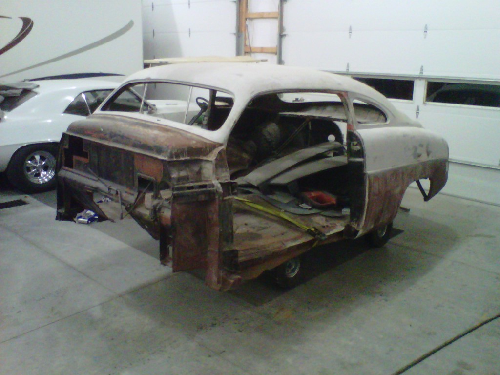

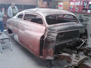

  12. HOLY ****!!! In a 9 day stretch over Labor Day weekend, I drug the 51 Merc out of the ba*****t and put in inner and outer rockers, took the floor out of one 51 Merc and put it in anouther, and if that wasnt enough, chopped it 3 front 4 rear with a 50 back window for my brother (NEWBOMB)!!! Yep he did help too, I mean he should, it is his Merc now!!! We all need to help him stay on track to finish it!! Its on its way home to North Dakota on Friday so look for it! IM GOING TO SLEEP!!!! Somebody PM him and make sure he starts a build thread so we can tell him what hes doing wrong, he's a LURKER!!!!

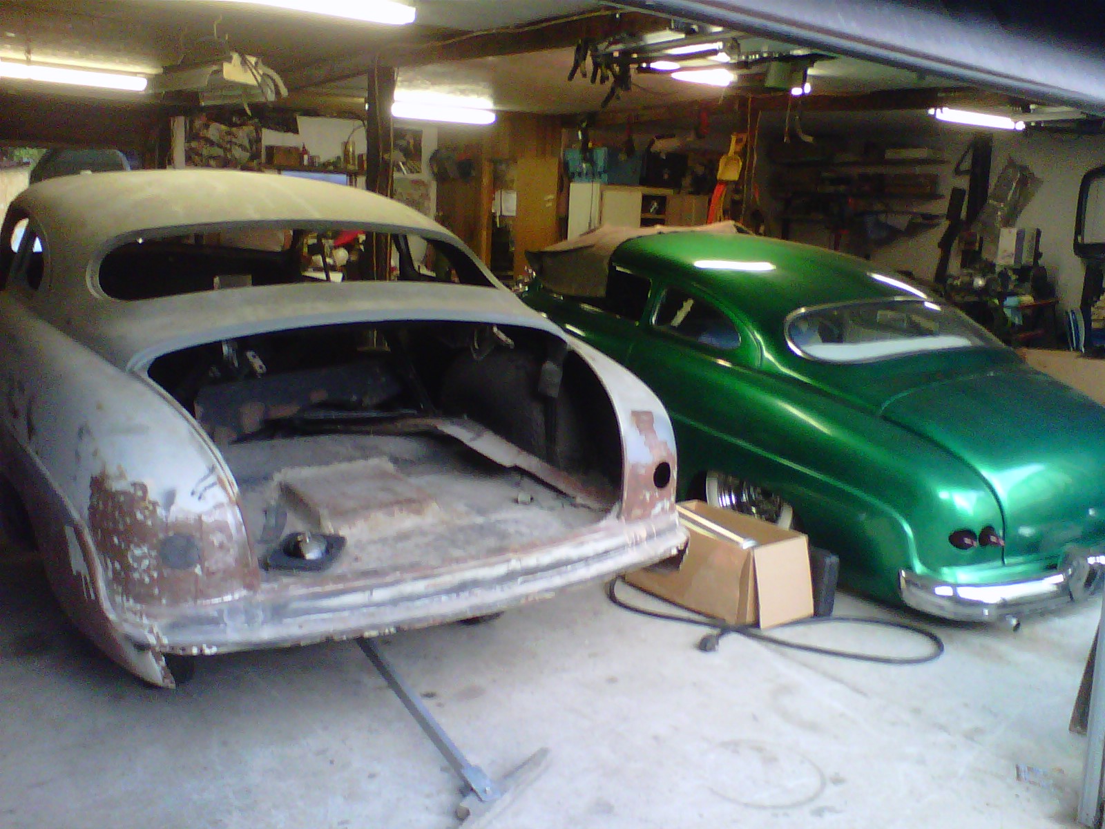

  13. A few more for those who arent bored yet!!!! Now come on, some of you need to get off the couch and go out and do something, it can be done!!!

  14. I dig the pics, is that more chop than your car?
  15. Same chop but ended up, in my mind, a little better! Guess ya learn a few tricks as ya go!!!

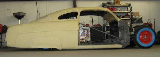

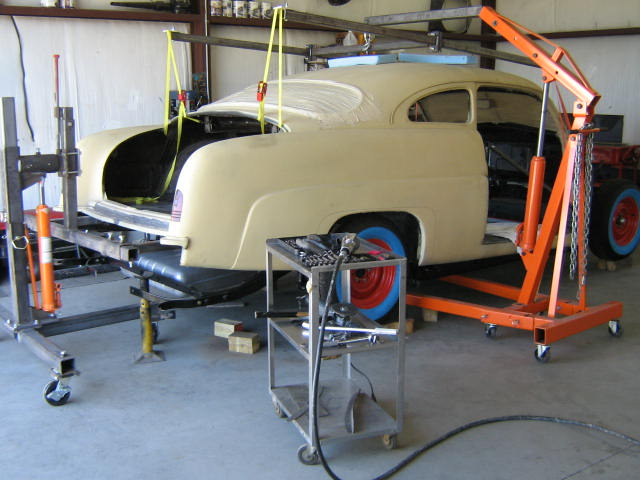

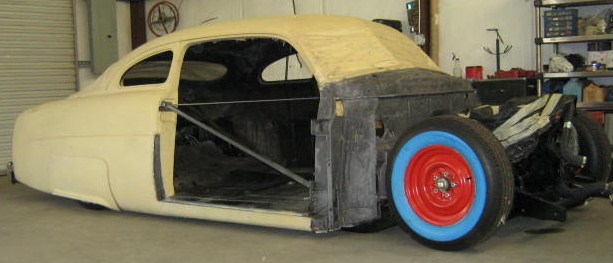

    Finally installed the Merc body on the custom ch***is for the first fitment check. Had to modify the under-the-rear-seat floor to fit the modified 4 link rear suspension.

    Now that's a sled! Way to stick with the build Joe.

    That is looking great Joe!

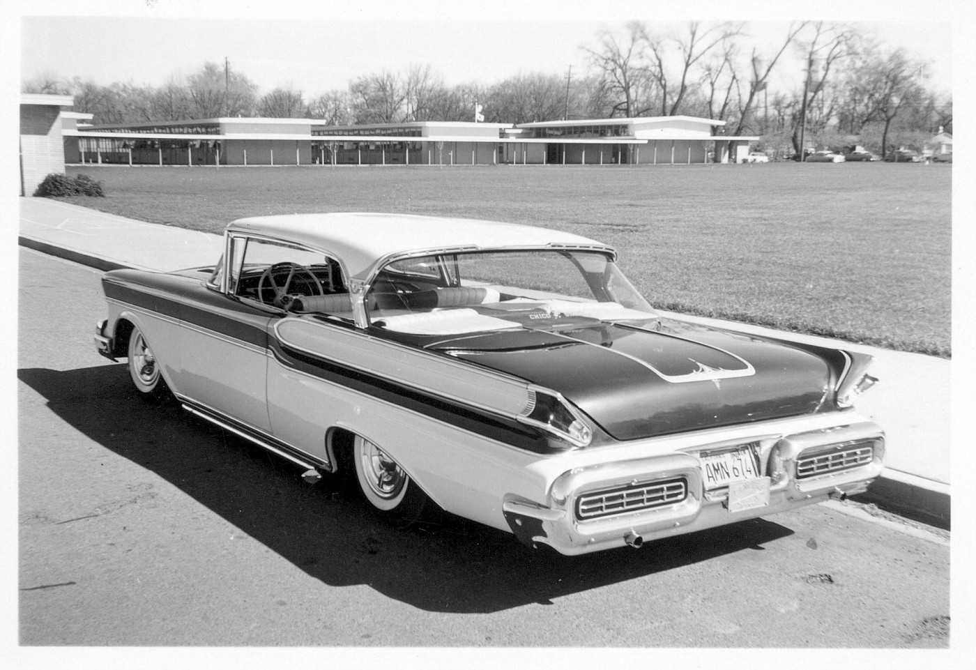

    My '57 Merc is currently on blocks in the middle of a dual exhaust with smithies installation. It's destined to be no other than a traditional mild kustom, and I am particularly intrigued by the few '57 Mercs that Watson was involved with during the great years.
    Something along these lines....
