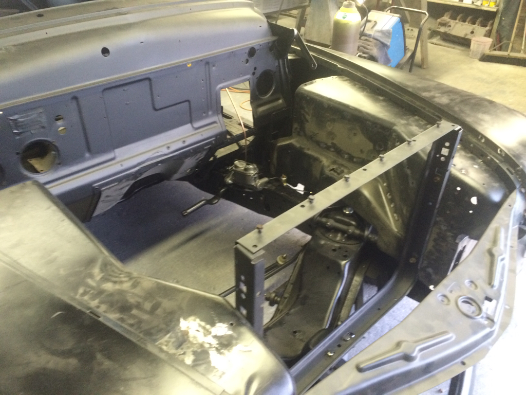

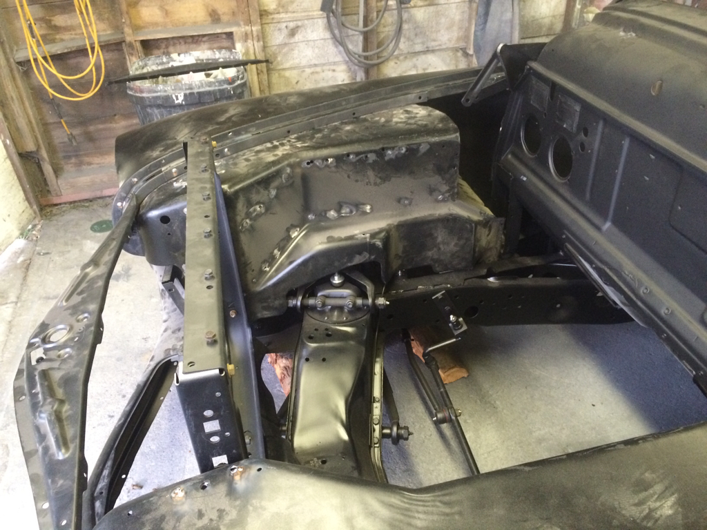

  20. ImageUploadedByH.A.M.B.1443286412.383582.jpg ImageUploadedByH.A.M.B.1443286443.282497.jpg ImageUploadedByH.A.M.B.1443286462.224026.jpg
    Got the front mocked up to see if it all lines up.

  22. No I haven't. All the marks are from the air vents that got took off to fix all the rust, going to put them back on. Might fill some holes if I'm not going to use them.

  25. Everything is going to be stock if I can. Just some mods to the body & I lowered it.

  27. I have one that's been all gone threw thanks. I just need to figure out what rubber piece goes under the radiator can't find anything in the books.

    Under it where? It does not sit in that U support channel, it goes in front of it.
  29. I was wondering about under the U, if anything goes between the U & the frame? the radiator bolts behind it. Thx

    The radiator bolts behind the U not in front of it. There is a little rubber pad that goes under the U about the thickness of a tire and the mounting tab at the front crossmember with those two carriage bolts. You may have to shim for proper fitment if that's not thick enough.
